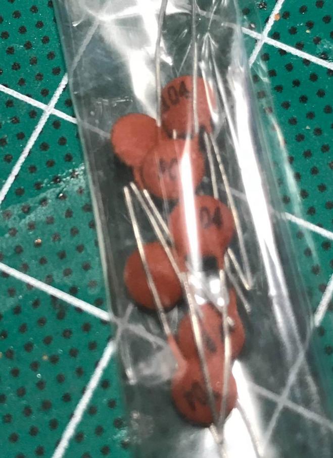

    So here is my first of what will be many questions, I suppose: I got these cute little electronics with the motors (I supposed they are resistors, but I'm no expert) and I suppose they should be soldered onto the motors' plus and minus poles, but I'd really like to hear from somebody who knows, what to do with them. The manual is completely blanking on them.
    BTW: I tested the motors with a battery and they run just fine. So I'm guessing these things are needed to prevent a spike in current or something. Maybe they are not needed? I remember having seen similar ones in a Caswell kit a long time ago.
    Anyhow, your help is greatly appreciated. The countdown clock to Carmel is ticking in my head and I'm starting to slowly panic not to be ready for the big event (wanted to be there last year but you all know what happened).

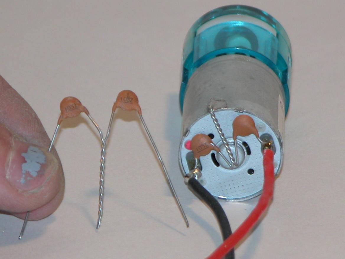

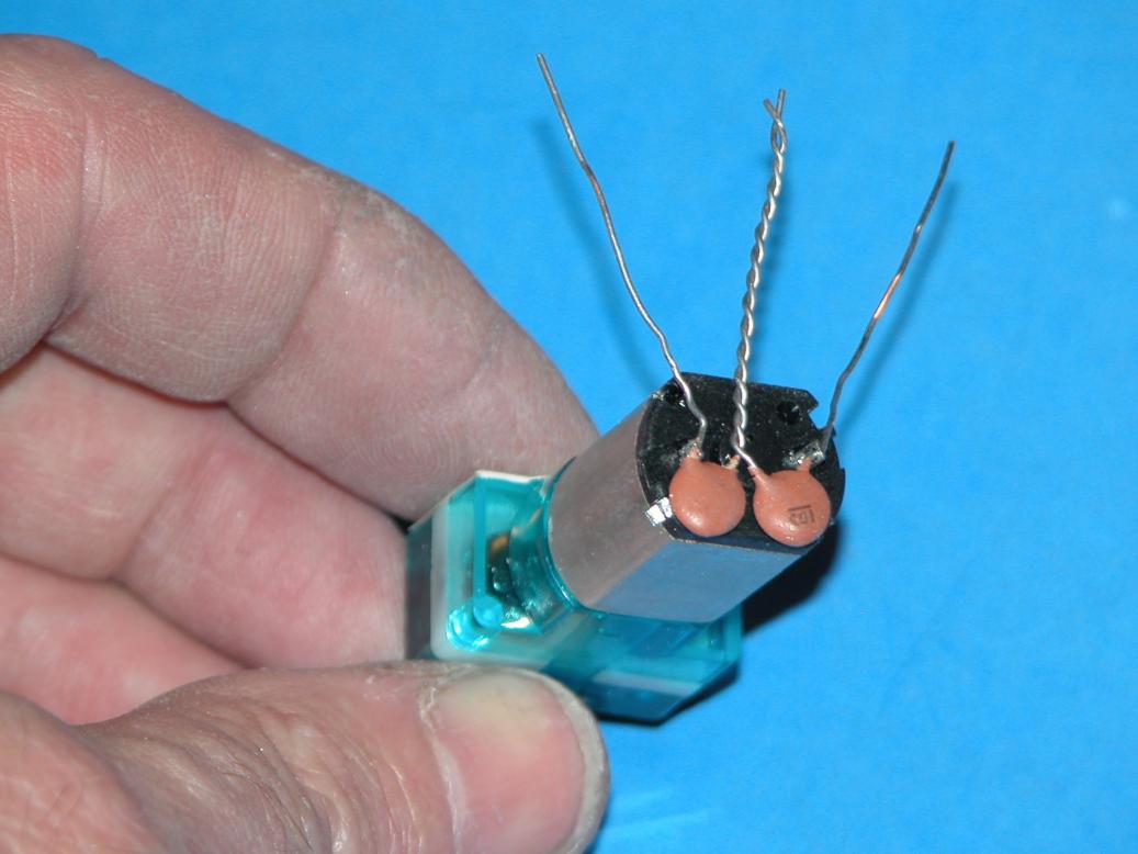

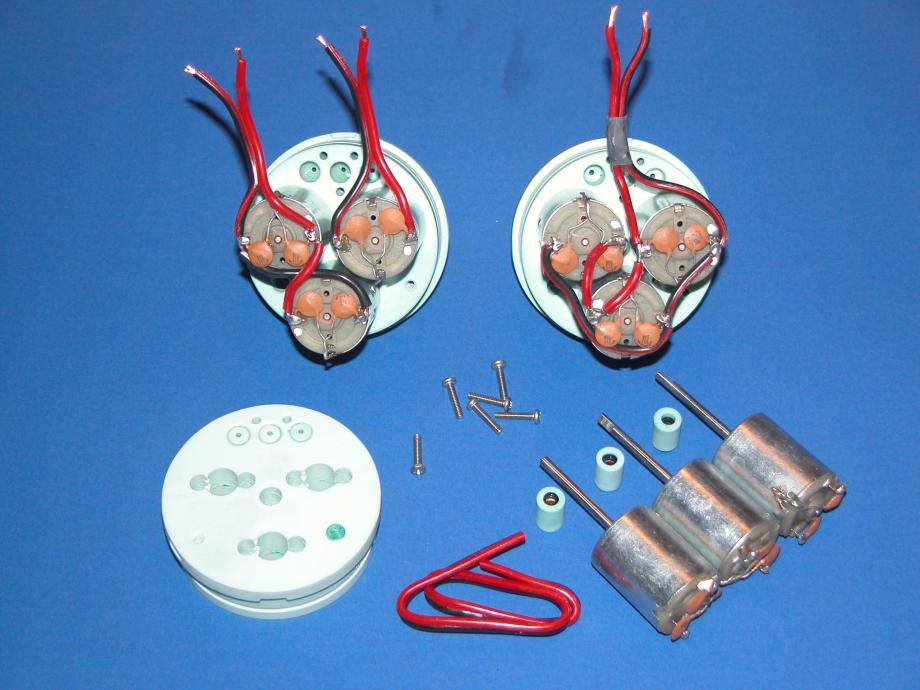

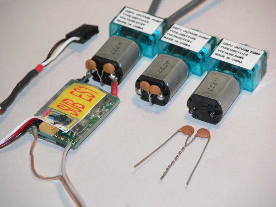

    Those are ceramic capacitors, and they suppress (by smoothing out) the voltage spikes common with motor that employ a commutator (mechanical switch). Typically you have one between motor case and one pole, another to the other pole and motor case, and a third between the two poles -- but I find this third capacitor to be redundant and usually don't bother with it. This arrangement is called 'spark-suppression'.
    Unfiltered, a brush type motor (of which you have) will send those voltage spikes up and down the circuitry and fox both receiver and other devices sensitive to such RF noise. The capacitors prevent most of that noise.
    Your talk'n to the guy who made the Caswell SD's. Here's How I connect the cap's to the motor poles and case (ground):
