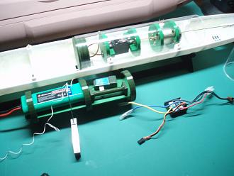

    Originally posted by tifosi12
    Actually after my first attempt with the XXIII I built a rig even you'd been proud of (see picture). Problem was that the hull of the boat is so think, it starts to flex and warp once the Dremel cutter puts pressure on it. Then the cut is no longer a perfect line. My other issue was that the little plastic sticks you made for the fittings kit didn't stick to the boat. I used a gazillion ton of Krazy glue and Epoxy and made them stick somewhat but that was still no clean way to mount the top part. That said your other parts from the fittings kit were excellent, I got the dive planes and the prop to work just fine but could never cleanly close that hull. So yes, that's an abandoned mine at this point.
    So I'm using your Caswell WTC for Ota's 1/12 Seehund. Fingers crossed. I'm in the honeymoon phase of a new sub project. Haven't reached the 7th year itch yet.
    As for your kind offer regarding the 1/72 Type VII. Yes, I'd love to get some input from you for that. My feeling is that its a bit of a lost case at this point. I think I drilled too big of a hole for one of the rudder anchors and that's why it is unstable. And honestly once I get the 1/48 Type VII to run, my interest in the smaller boat will likely be eclipsed. It was my first boat and I learned a ton. I don't even know whether I'd be willing to take it as is to Carmel. People would probably just laugh at me and it.
