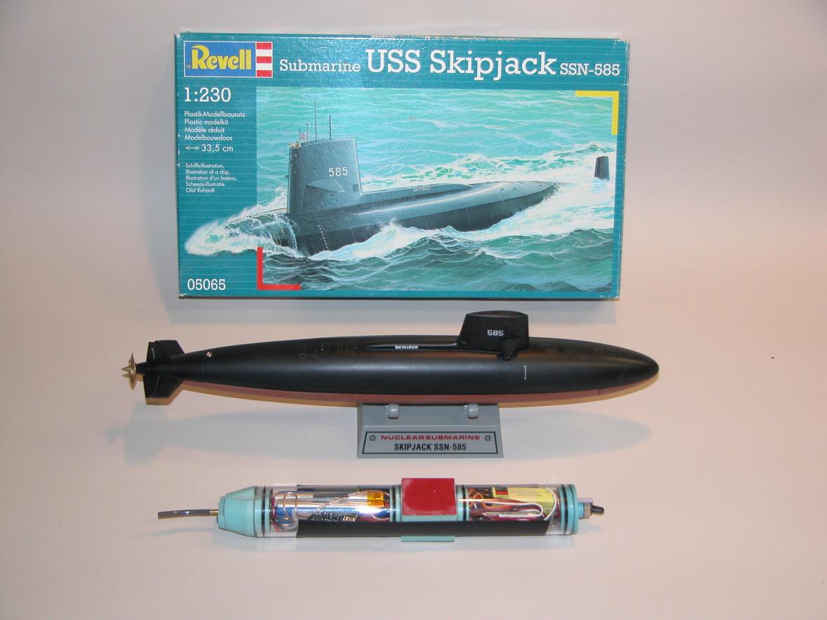

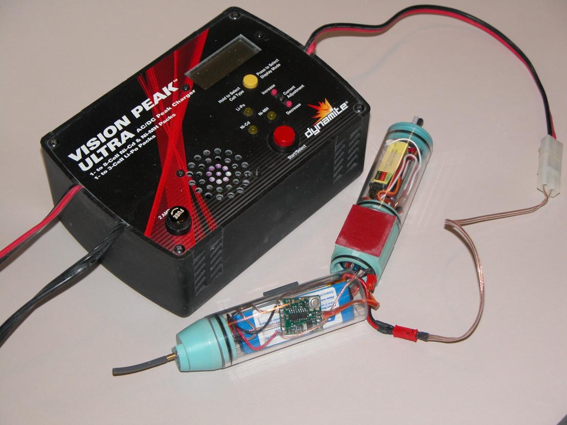

Today's work on the little Revell SKIPJACK fittings kit

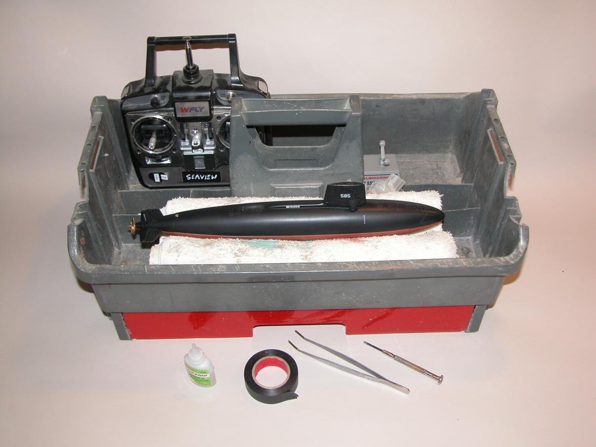

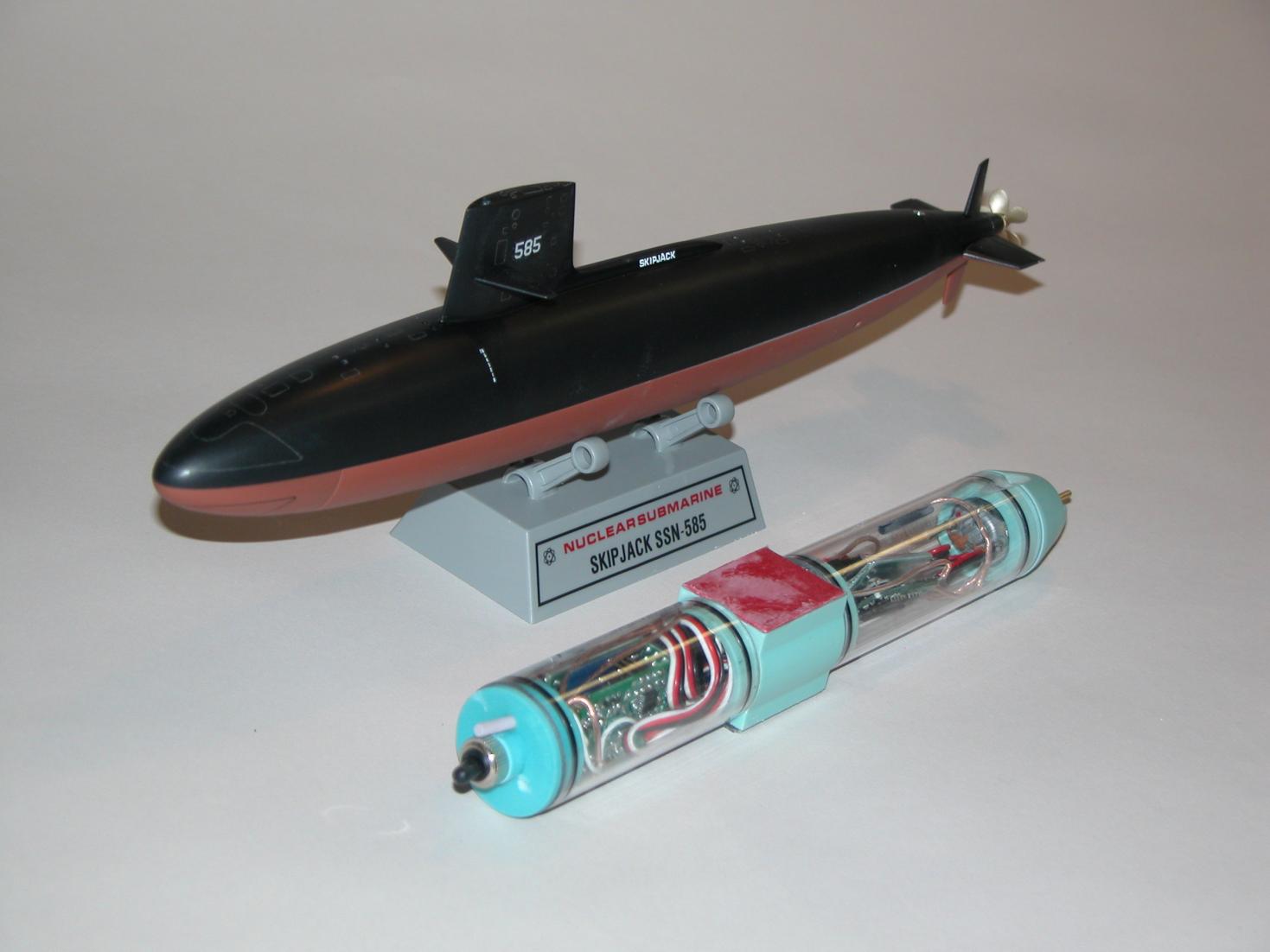

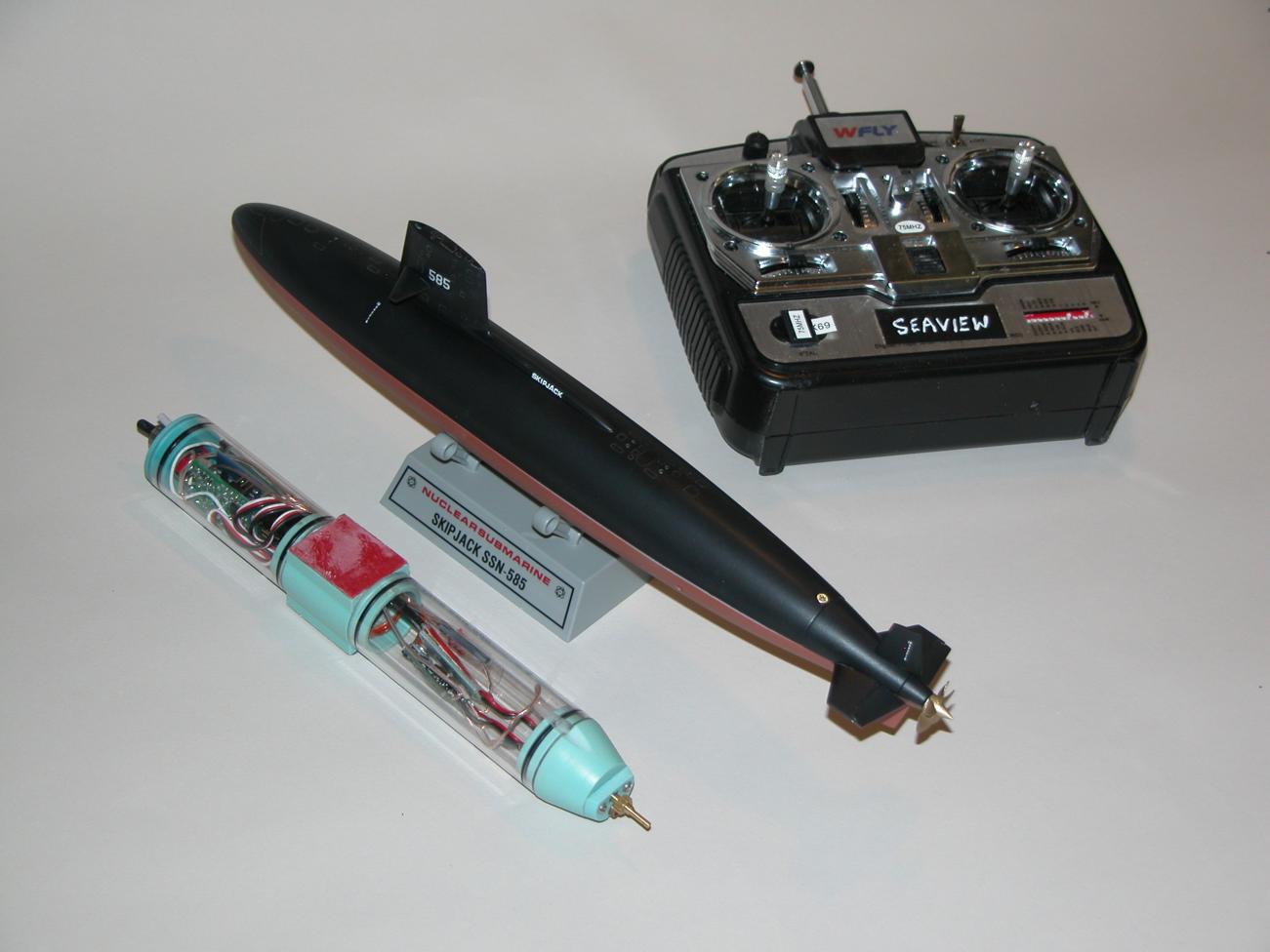

            More pretty pictures:
