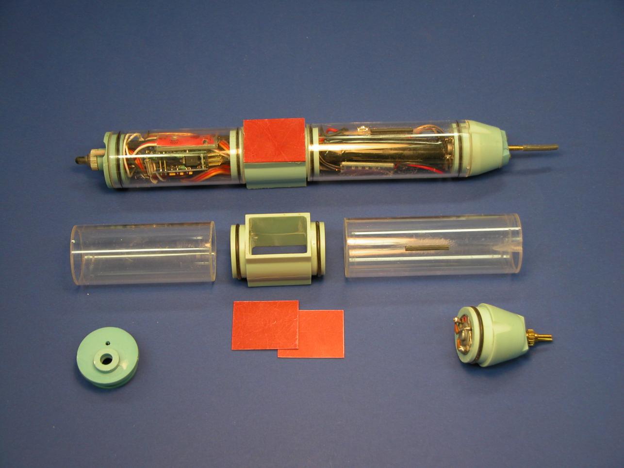

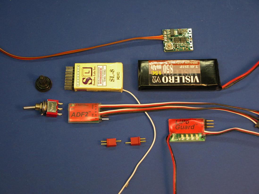

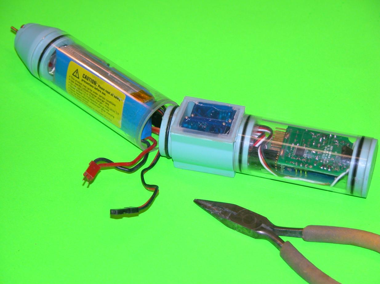

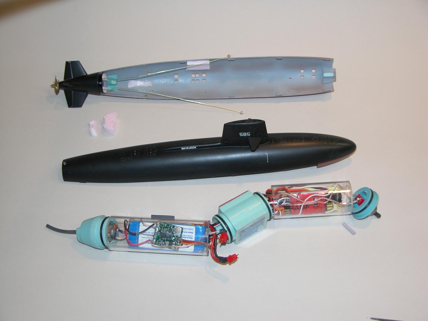

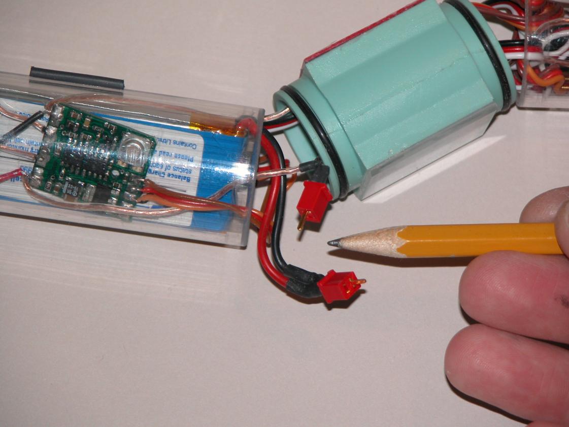

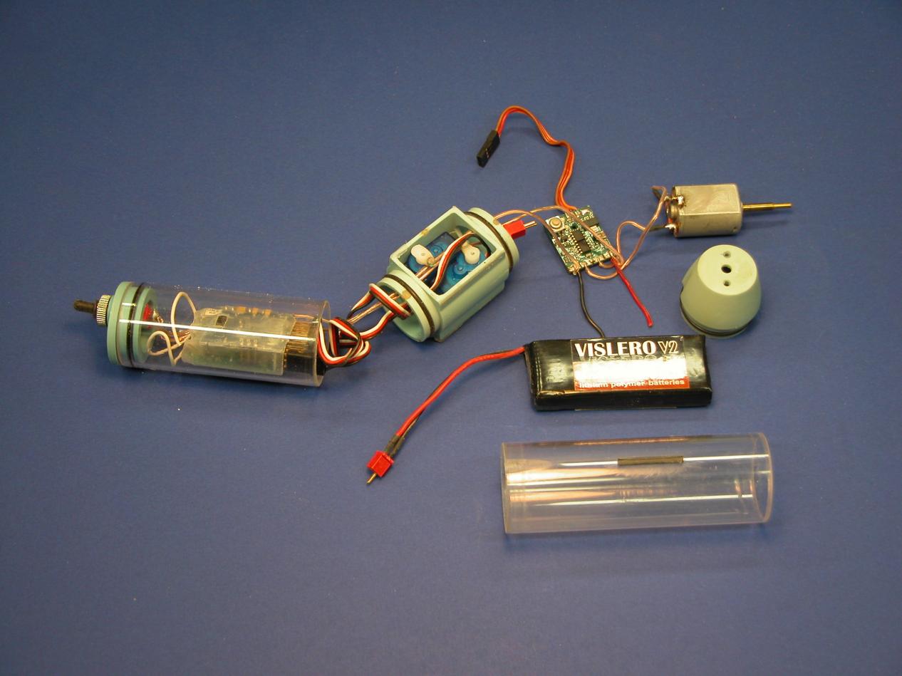

          Yet another dumb question.............Do you have any photos/drawings of the electronics connected together? Thx again

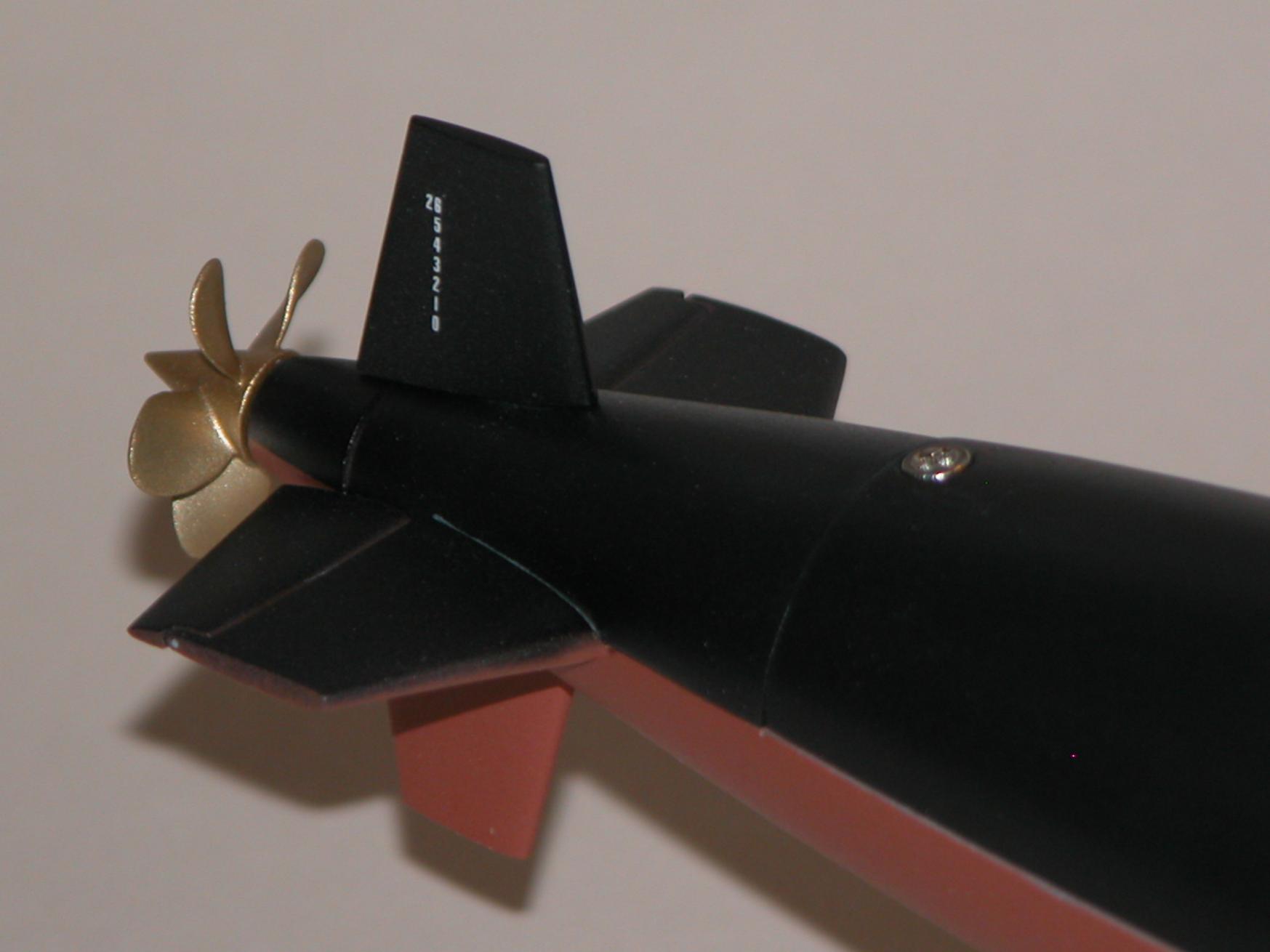

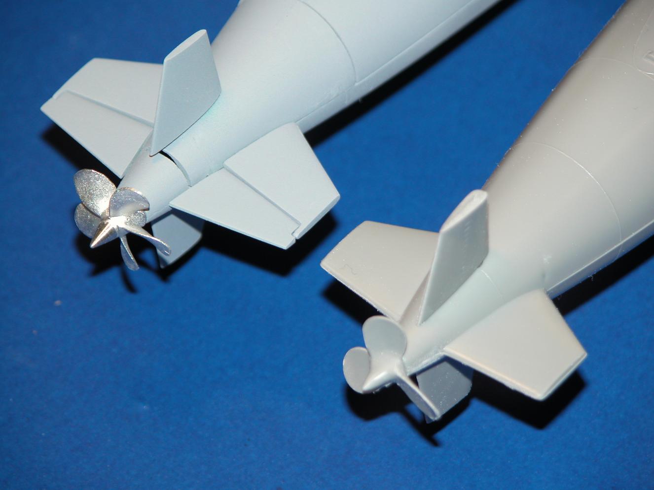

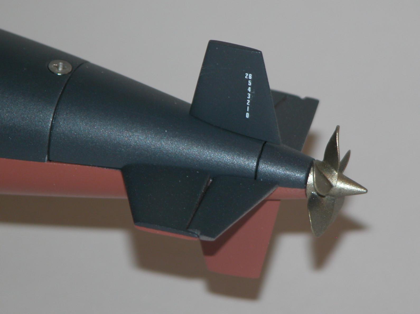

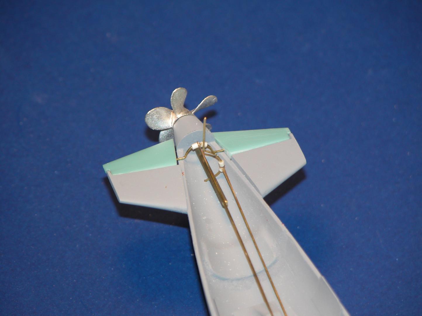

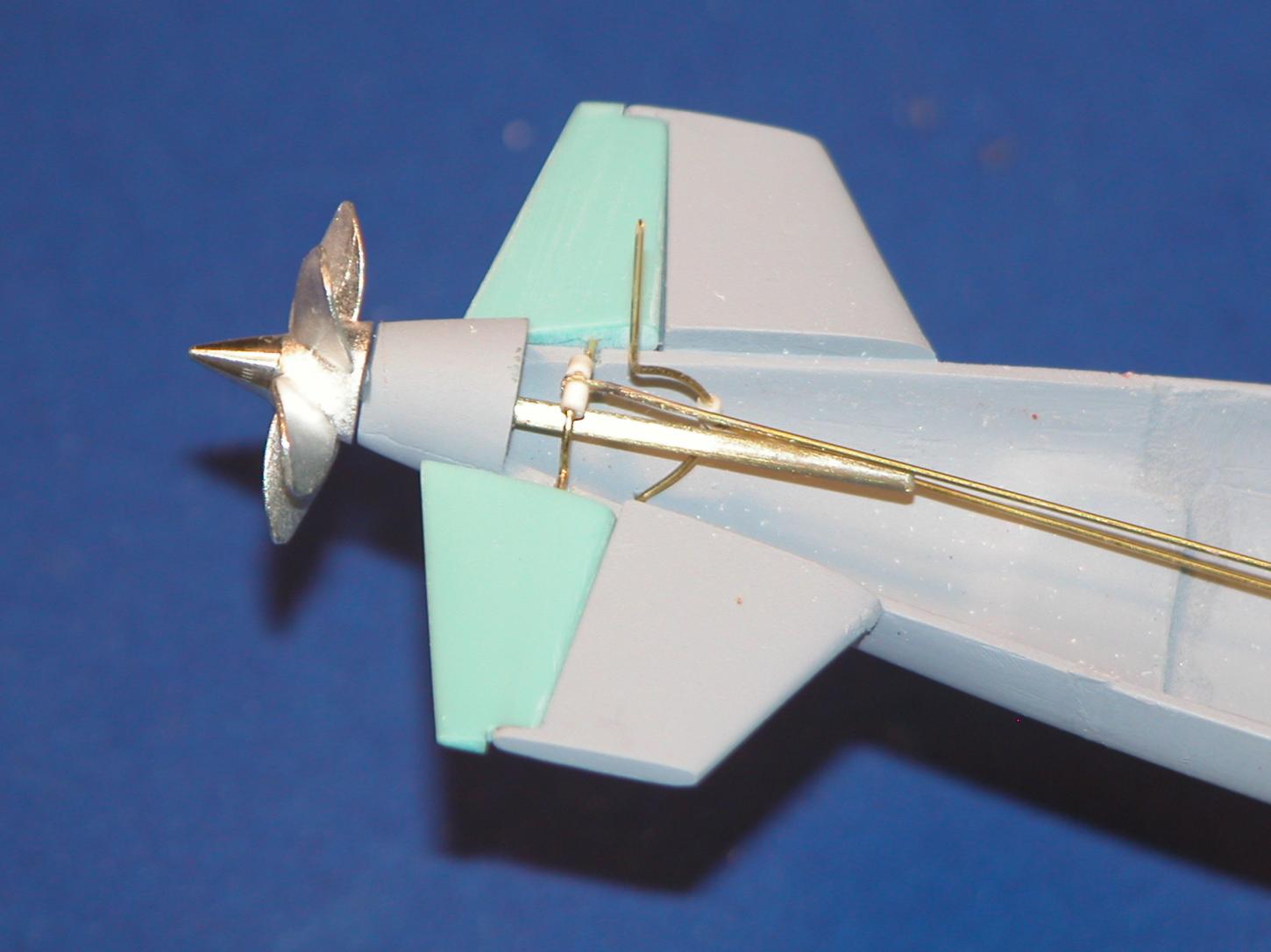

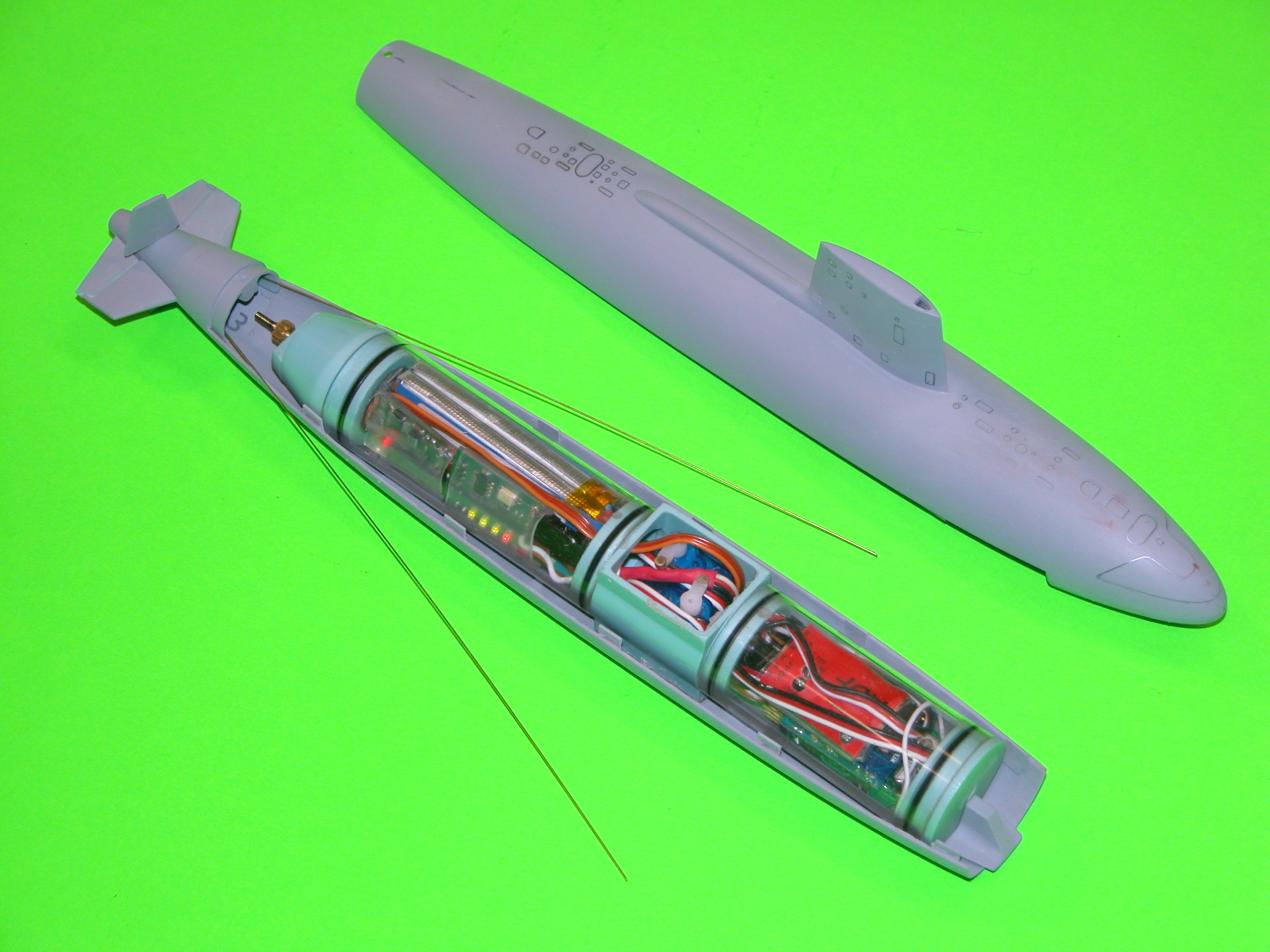

            Still another...............How does the aft movable hortizontal diving plane attach to the non-moving part? (besides the wire attaching to the inner part)
            Thx again

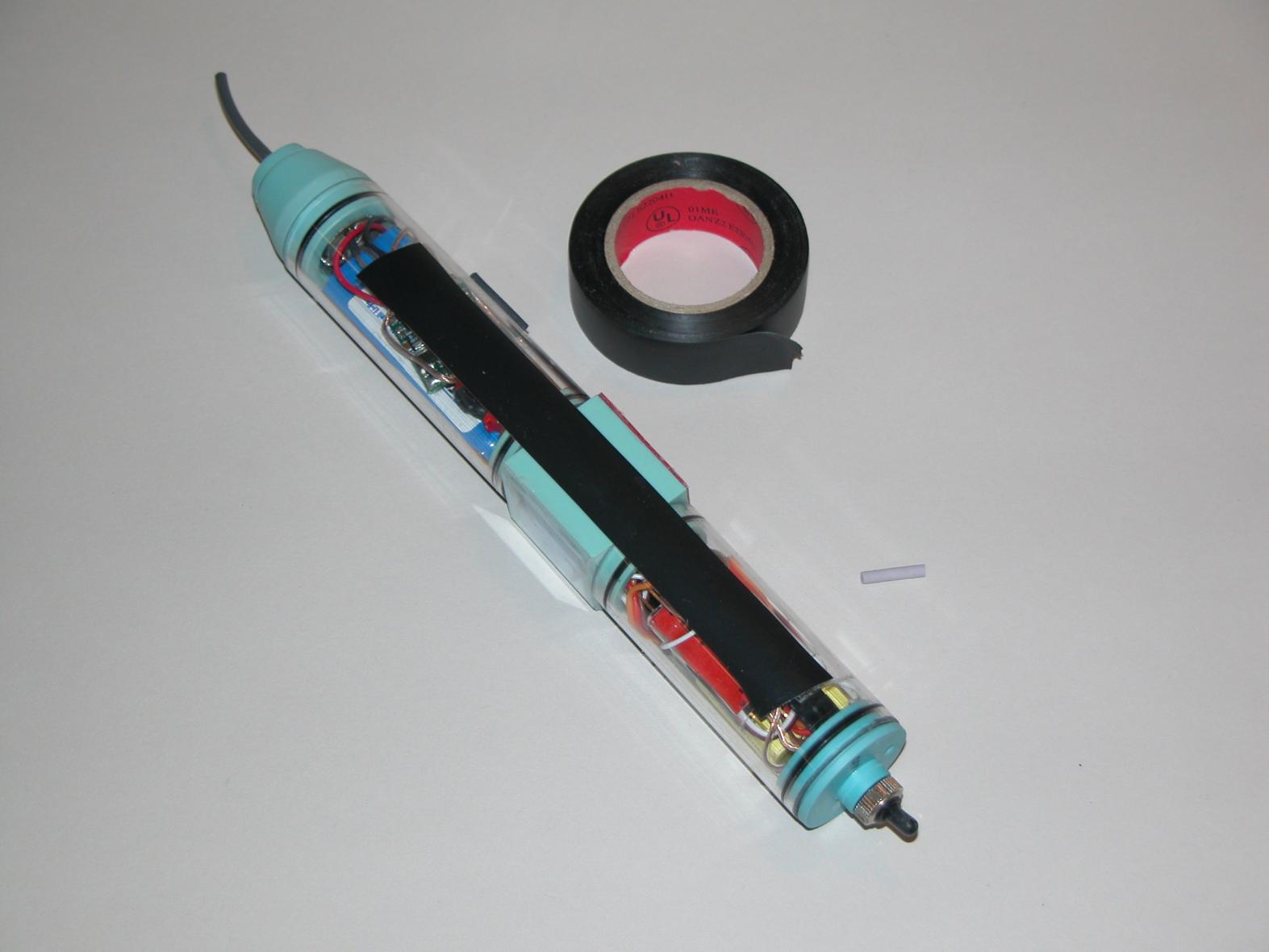

              • 13982
              #156

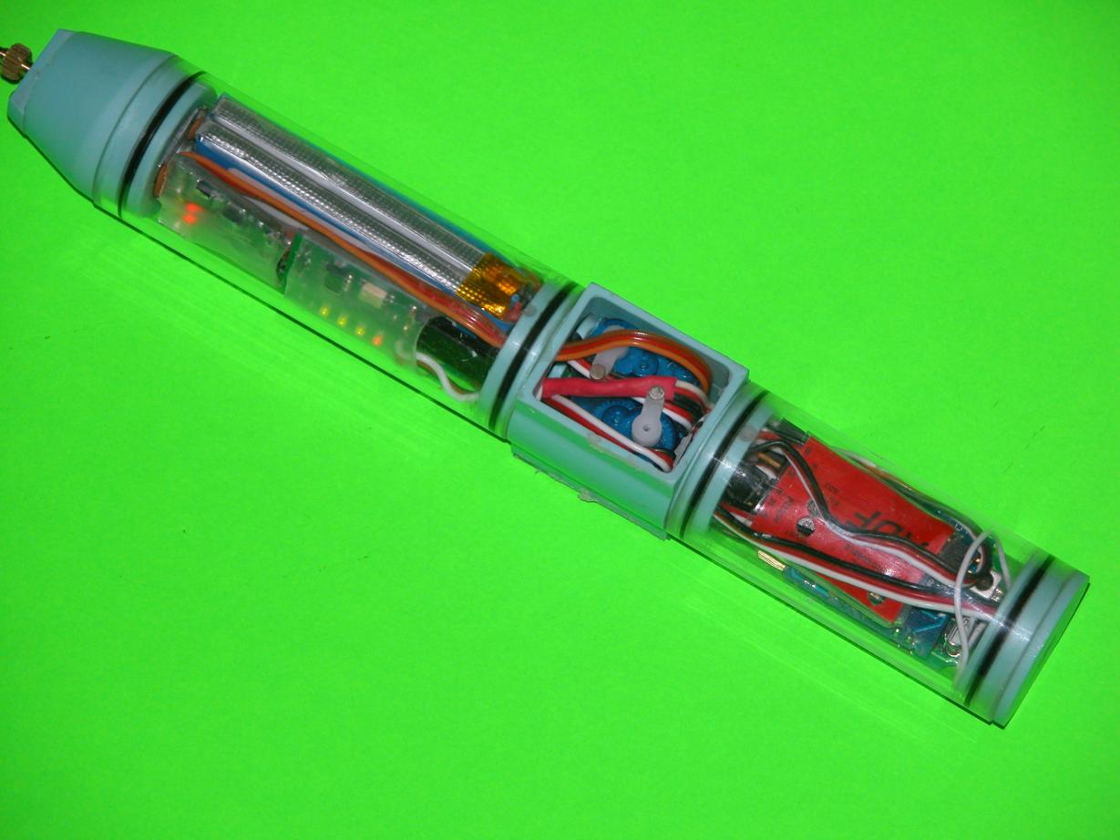

              Thx again
              Here's how I hook things up:
ID:	68443Click image for larger version
ID:	68444Click image for larger version
ID:	68445Click image for larger version
ID:	68448Click image for larger version
ID:	68449Click image for larger version
ID:	68450Click image for larger version
ID:	68451Click image for larger version
ID:	68455Click image for larger version
ID:	68456Click image for larger version
              As to the means of holding the outboard ends of the stern planes to the outboard bearings of the fixed stabilizers: two short lengths of teeni-whincie-mini diameter wire (.010" or so) or streached-sprue.
ID:	68439Click image for larger version
ID:	68440Click image for larger version
ID:	68441Click image for larger version
ID:	68442Click image for larger version
ID:	68446Click image for larger version
ID:	68453Click image for larger version

                  #158
                  What adhesive do you apply to secure the Lexan cover to the servo box? Thank you.

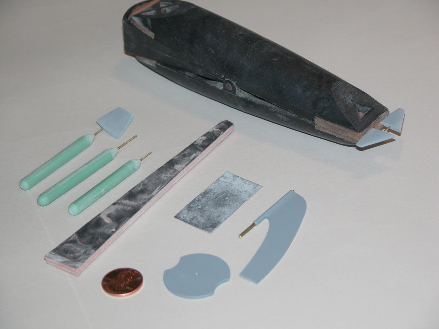

                      RTV.......................
                        • 13982
                        #161
                        Originally posted by small sub guy
                        Is there a scribe templete for the mini SkipJack???
                        Yup. Mine. Not available. Make your own.
                        • vital.spark
                          • May 2010
                          • 312
                          #162

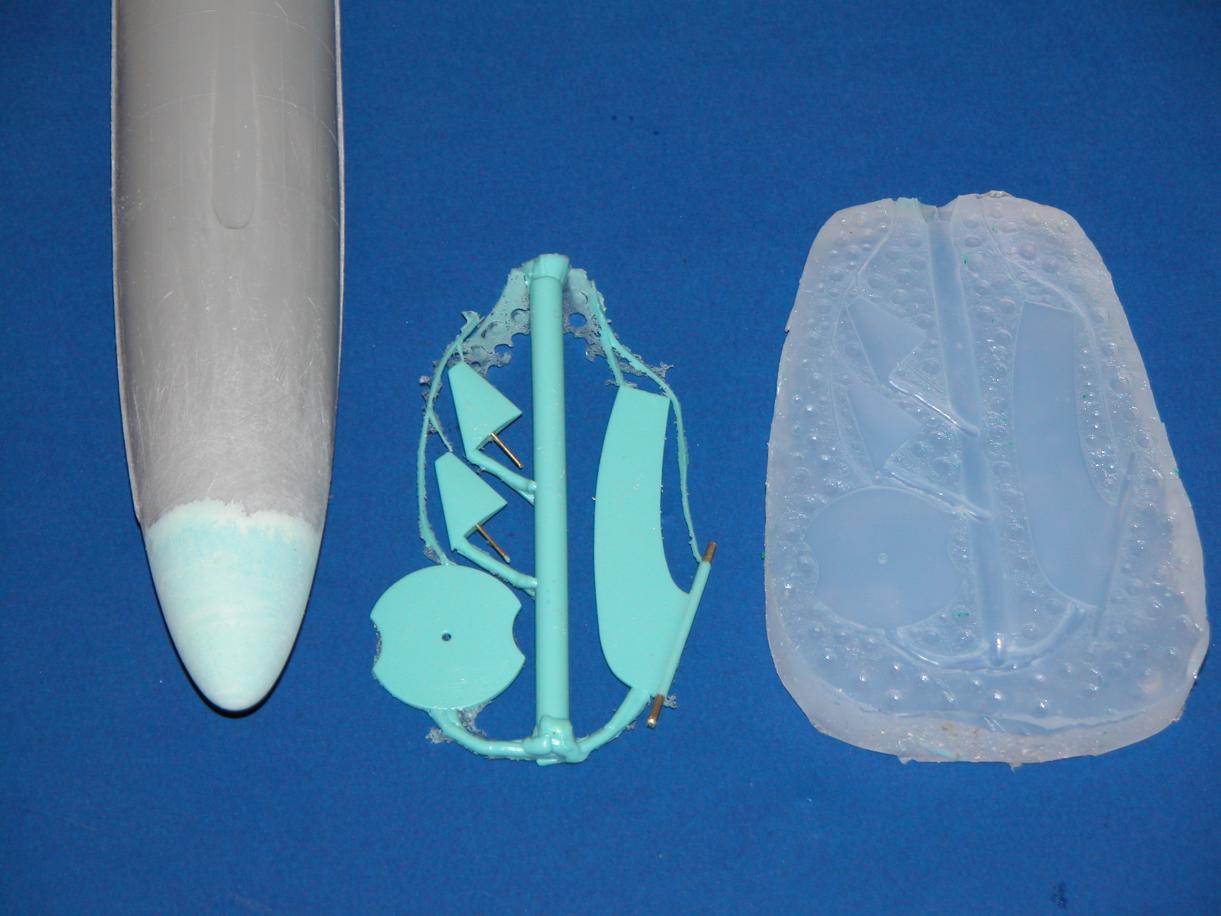

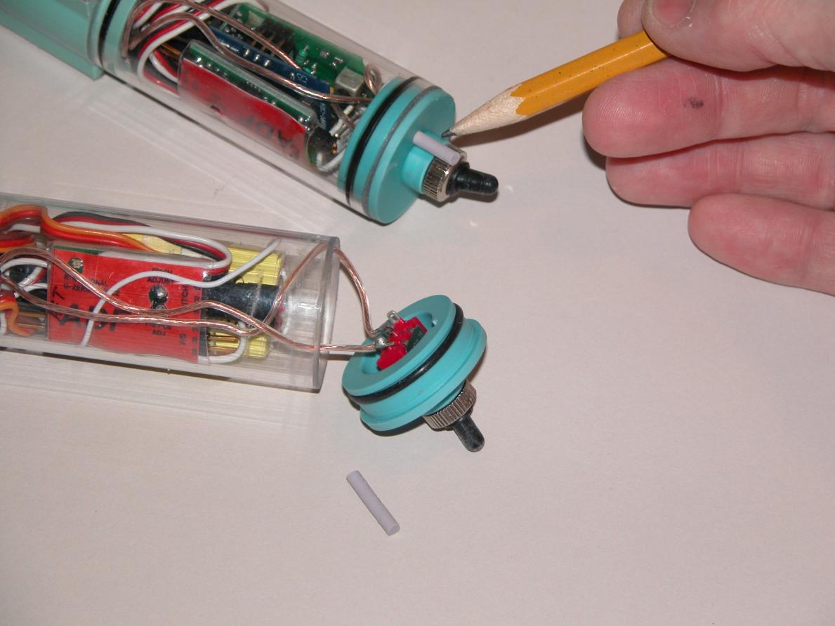

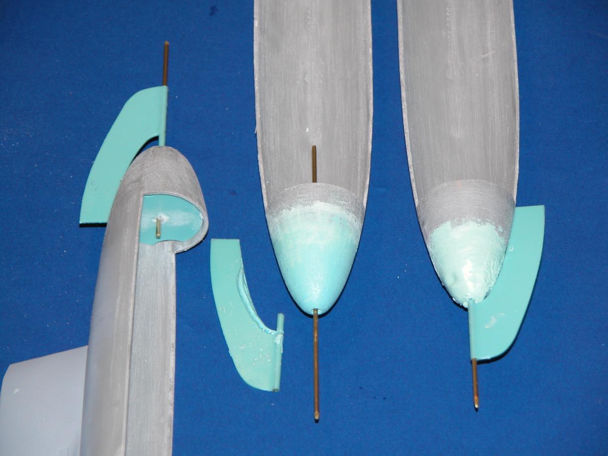

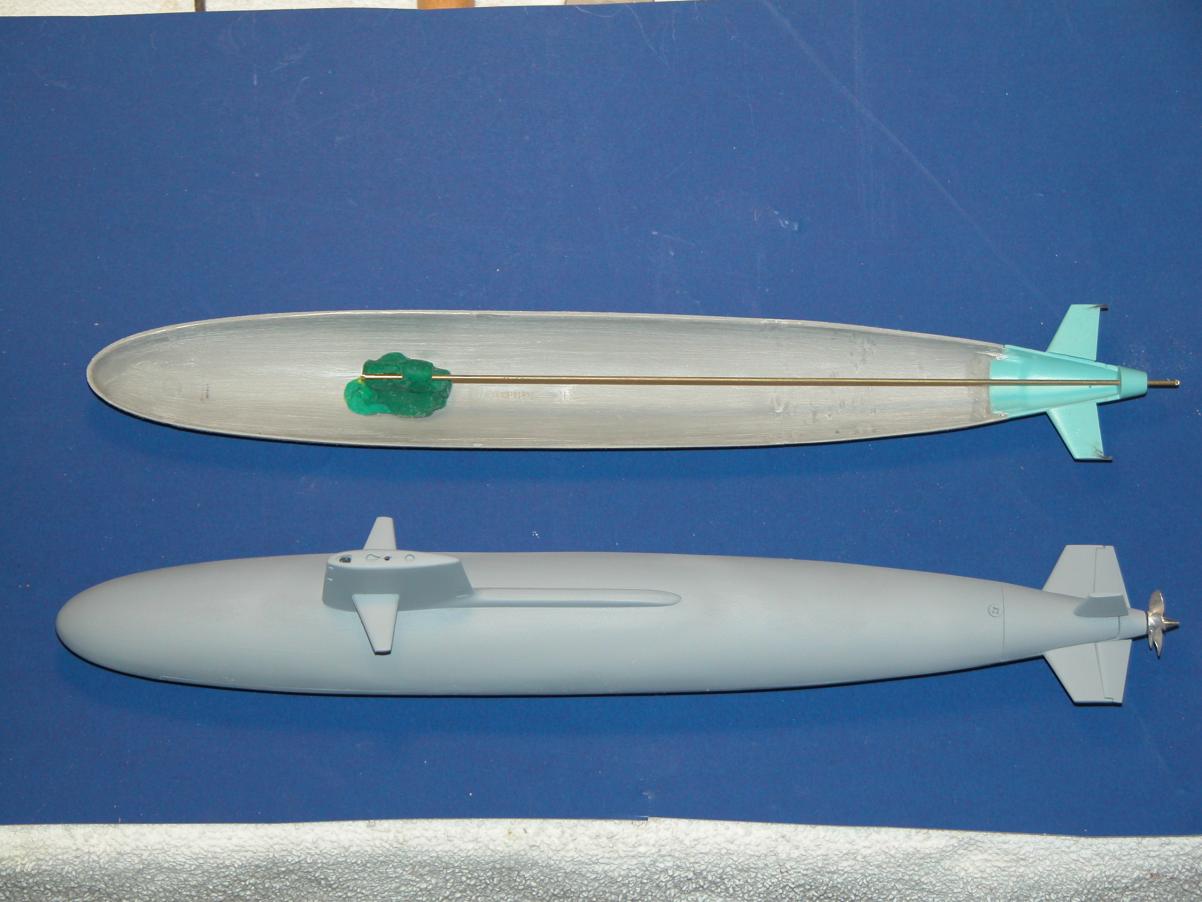

                          In post 156, one of the pictures shows a hole drilled in the Fwd bulkhead and a small tube in it. Could you explain what tis is for and how to use it?
                          This little subdriver is giving me more headaches the the other 3 I have. This thing is tighter then OJ's glove!!!!!!! I finally found a battery that would fit!! Now I'm waiting for Kevin and the upgraded ADF 2 which will work with the 6 Channel Synthesized Corona Receiver.
                          Regards,
                          Myron
                            • 13982
                            #163
                            Regards,
                            Myron
                            You install the bulkhead with the 1/16" hole in its center, then equip the screeding blade with a four-inch long length of 1/16" brass rod. Drill a 1/16" hole in the bow of the hull. You run the rod into the bow, and into the bulkhead -- two-point bearings that keep the rod oriented longitudinally into the model. The screeding blade rotates around the boats longitudinal axis as it scrapes away uncured two-part automotive filler re-contouring the models too blunt bow.
                            We having fun yet?
ID:	81238Click image for larger version
ID:	81239Click image for larger version

                              David, I finished the sub about a year ago and I'm referring to the Sub-Driver in this post. (Re: post 156) On the forward bulkhead near the switch you show a hole with a tube in it. Could you tell me what this is and how to do it?
                                • 13982
                                #165
                                Oh! that! Sorry, Myron.
                                It's a test fitting, used on the prototype to vent the cylinder whenever I pushed a bulkhead into place. The tube is blanked off and serves as a plug.
