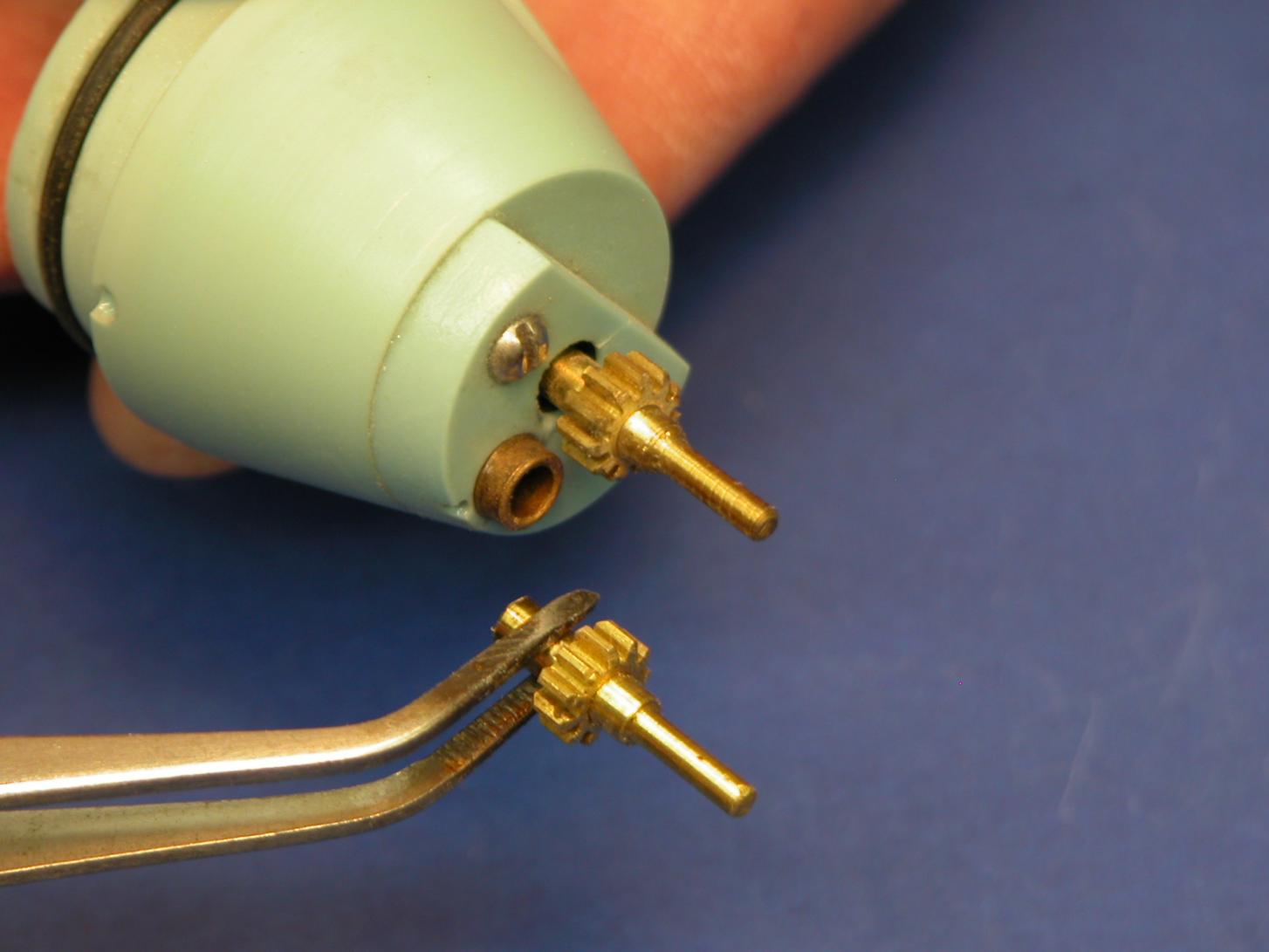

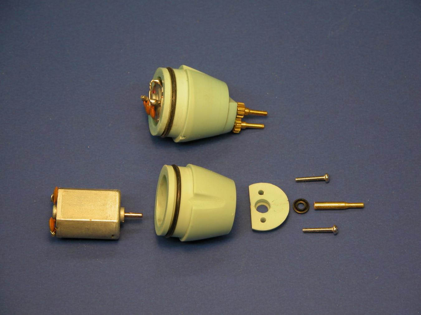

            Hey Dave,

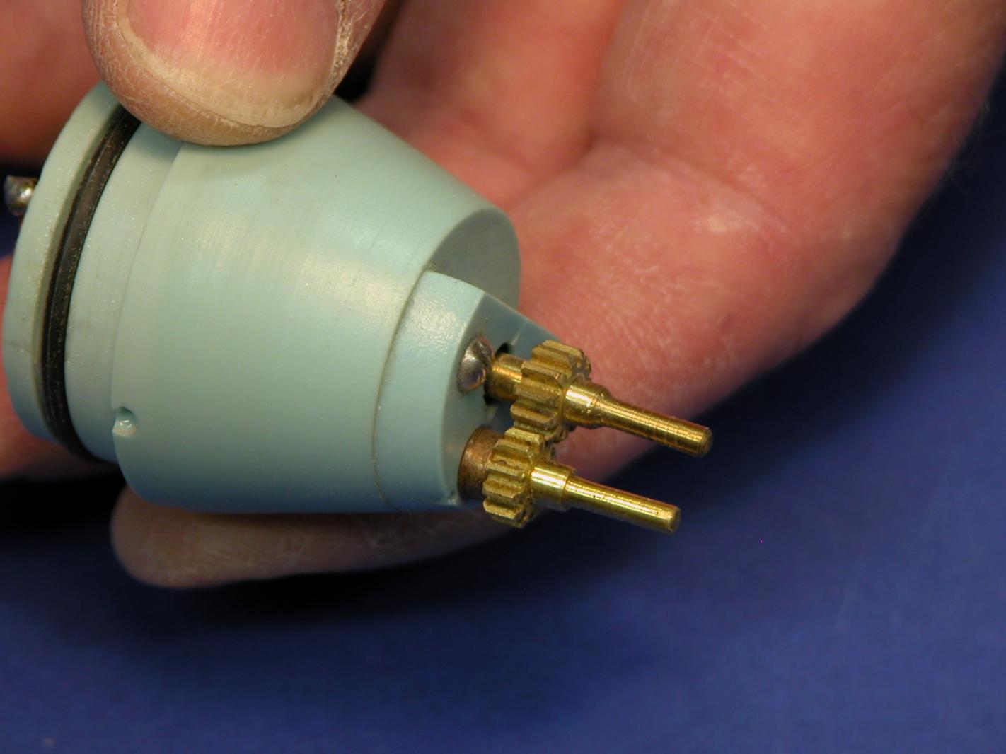

            I would like to install the mini sub driver into small subs with two screws, are the gears available to convert from single screw to two screw???
              • 14010
              #141
              yup.

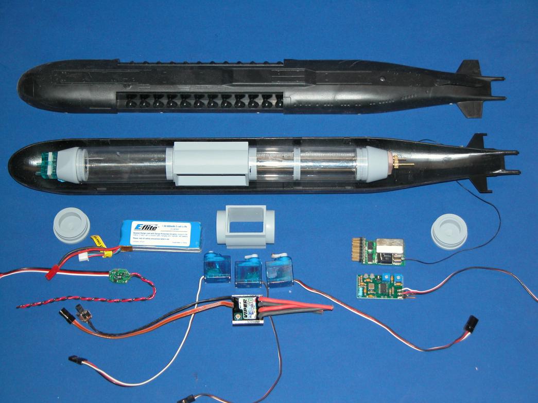

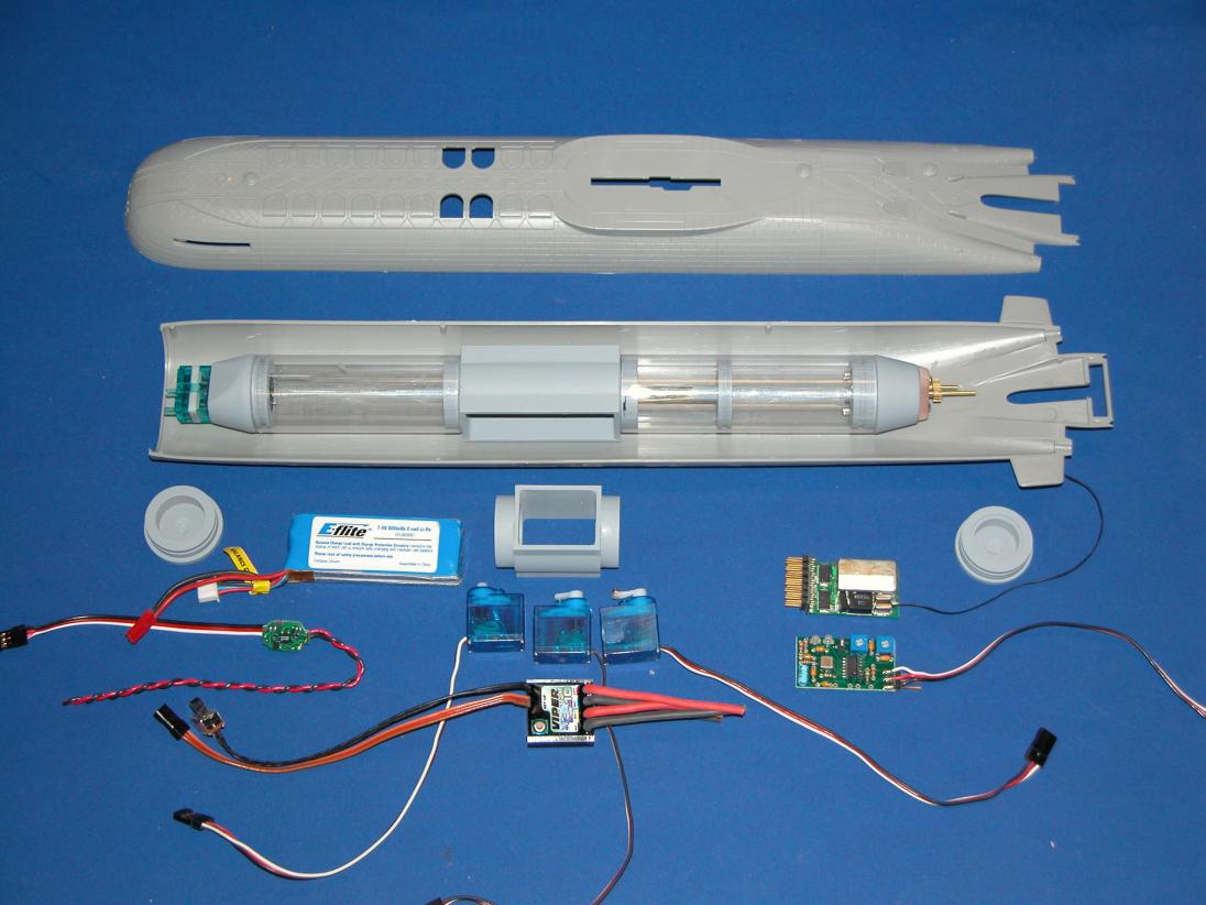

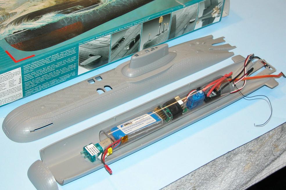

ID:	68205Click image for larger version
ID:	68206Click image for larger version
ID:	68207Click image for larger version
ID:	68208Click image for larger version
ID:	68209Click image for larger version
ID:	68210Click image for larger version
ID:	68211Click image for larger version
              • small sub guy
                • Dec 2009
                • 45
                #142
                Thanx how do i go about ordering two of these motor end caps.
                  • 14010
                  #143
                  E-mail Mike Caswell (or call him names on this thread .... that'll get his attention!). Tell him you want three of the little 1.25 motor bulkheads, equipped with counter-rotating outputs. He'll bill you, bother me, and we'll get your product underway.

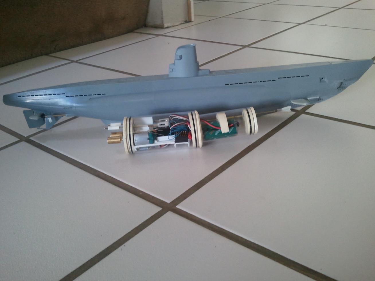

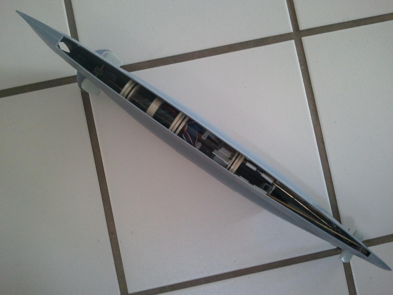

                    In my collection I have:
                    1/144 Gato, 1/350 Kursk, 1/350 Typhoon, 1/230 Lionfish and the 1/72 Type IIA.
Name:	2012-06-05 17.34.50.jpg
ID:	68213Click image for larger version
Name:	2012-06-05 17.29.07.jpg
                    Working too many subs need to focus on one.
                    this one is based on your Type VII. Yes that wtc fits in that 1 inch opening.
