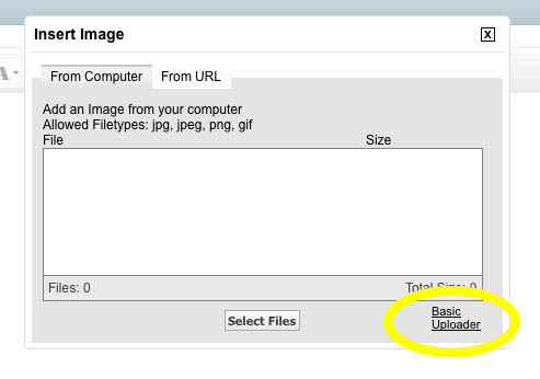

                Did you try the basic uploader?
Name:	Posting Error.jpg
                You can select one picture then click on upload, go back and add the second and so forth and so on

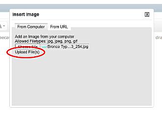

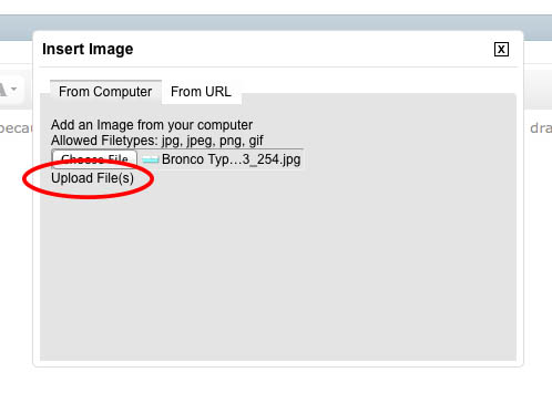

                      When you click on Basic Uploader does this come up?
Name:	Posting Error2.jpg
                      Can you select a photo? (only one)
                      Then what happens when you click upload files circled in red?
                      Want to see your sub, so let me know.
                      Peace,
                      tom

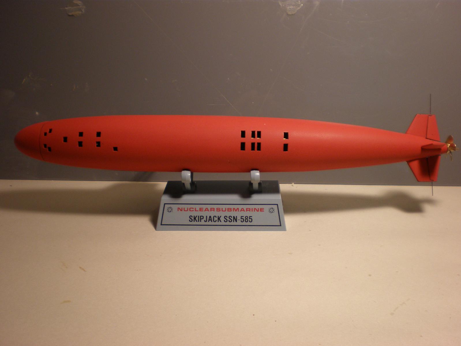

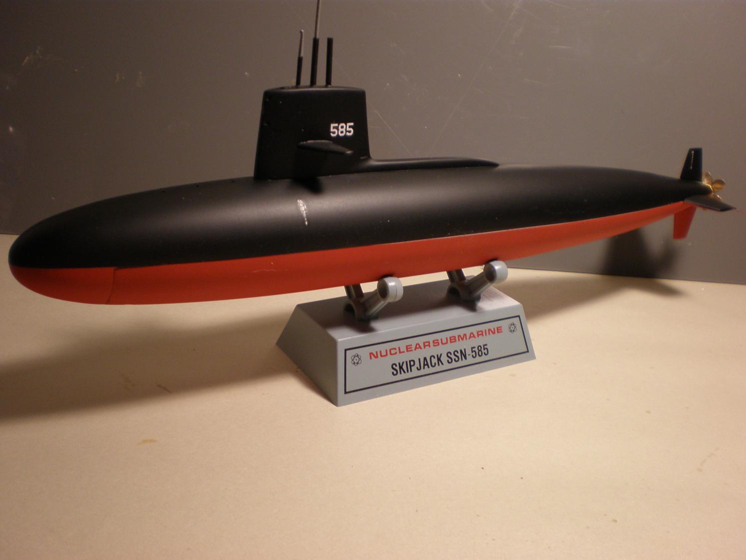

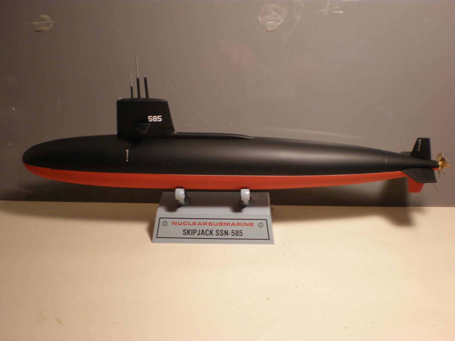

                            Anyway, there she is! Waiting for one more electrical component to arrive, then I can proceed!!
                            For anyone noticing them, the outboard pins on the aft diving planes have yet to be trimmed!!

                              Finally! Got those pictures up. Thanks for working it till it happened. That determination is needed in this game of ours.
                              Very nice job on that little model kit. Don't you just hate water-slide decals!!!!! Next time apply them over a gloss finish (well polished), accompanied by a vingar soaking -- that will snuggle the little *******s down tight without 'silvering'.
                              Love that you pined the stern planes outboard bearing points -- you are the complete model kit assembler, aren't you?!
                              Now, the fun part: getting that little go-getter just a tad on the light side of neutrally buoyant. And before you do anything else, dial the transmitters throttle channel (should be channel-3) end-point down to 30% ahead, and 30% astern or you will poke a hole in your tub!
                              Keep at it, Tiger! This thing is a real fun ride.
