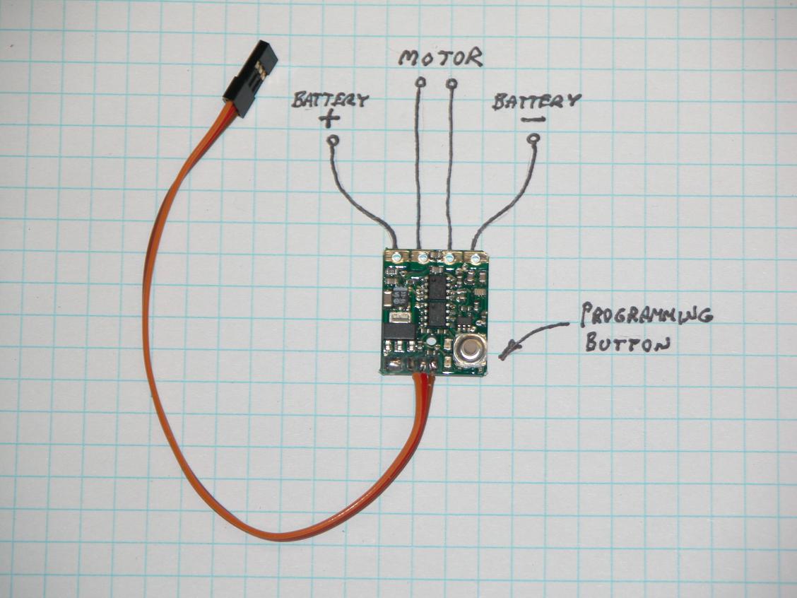

          Just received my Vislero LiPo and Nano ESC from Mike, and need to ask for your valued assistance.
          It appears that the "engine room" is a bit crowded with both of those items, but they fit fine. The pushbutton on the ESC, if laid on top of the battery, touches the i.d. of the tube. Is there a chance that this could be problematic? I can flip the ESC over and let the button hang down off the end of the battery!
          Also, the ESC has 2 sets of motor connectors. One pair are individual, and the other pair terminate in a 2-pronged connector. Which ones get connected to the motor, and can the other pair just be de-soldered so as not to take up any extra real estate within the wtc?
          Many thanks for your input, as is always appreciated!

            If you have too, shave the button back so it won't hit anything when you cram it in there.

                  #203
                  Oops!!
                  Also, thanks for the diagram!!
