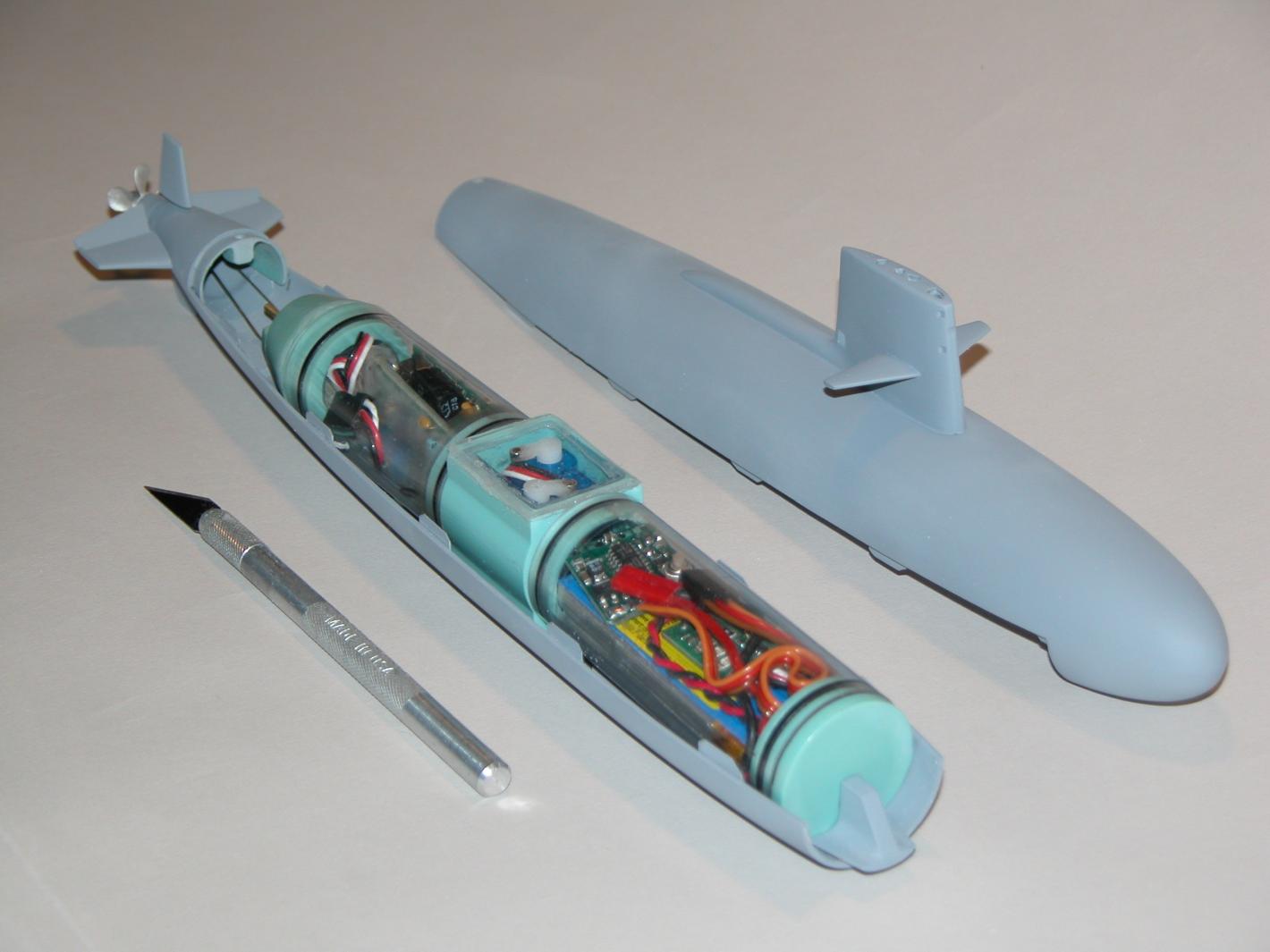

        Can you tell us something about the electronics you're using on this pocket rocket?
          • 14011
          #34
          I for one would like to see either an RCed Revell U-99, Trumpeter Gato or Romeo class.
          They're all in the pipeline. As soon as I get the little SKIPJACK and its SubDriver into production mode I have to work on the big 1/72 Type-7 fittings kit, after that, it's whatever Mr. Caswell assigns me.
          But be assured, I've got just about every plastic model kit of a submarine that is currently available commercially -- and each and every one that will accommodate a 1.25 SD has been targeted for the fittings kit-SubDriver treatment. So, that should make you Happy. Only problem is, there is one of me and a seemingly endless list of things to do here.
          A long-winded answers, but there you have it.
            • 14011
            #35
            All stock stuff: the little WFly receiver, Kevin McLeod's excellent ADF for angle-keeping chores, and his little Lithium-polymer battery protection circuit, a little 240 can motor, a 'special' MTronics ESC we had made to fit the small cylinder, two mini-servos, and a little helicopter Lithium-polymer 7.4-volt battery.

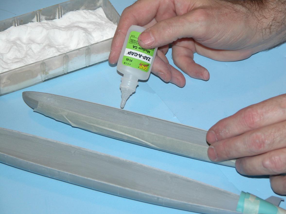

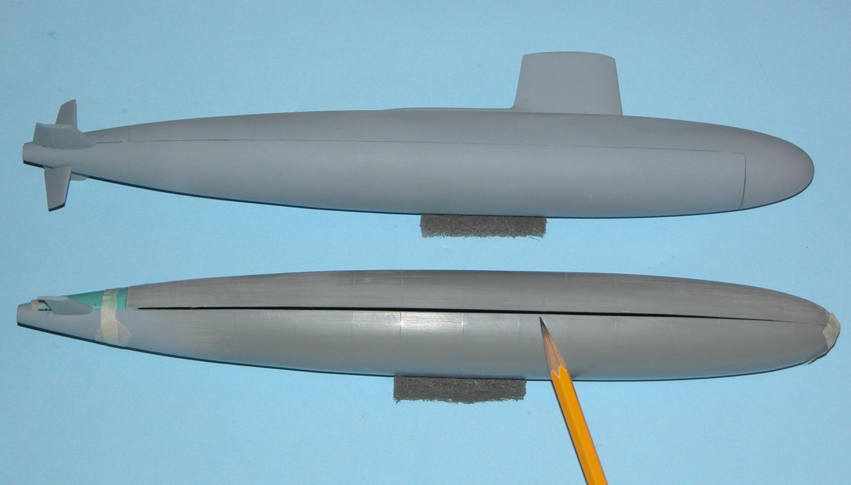

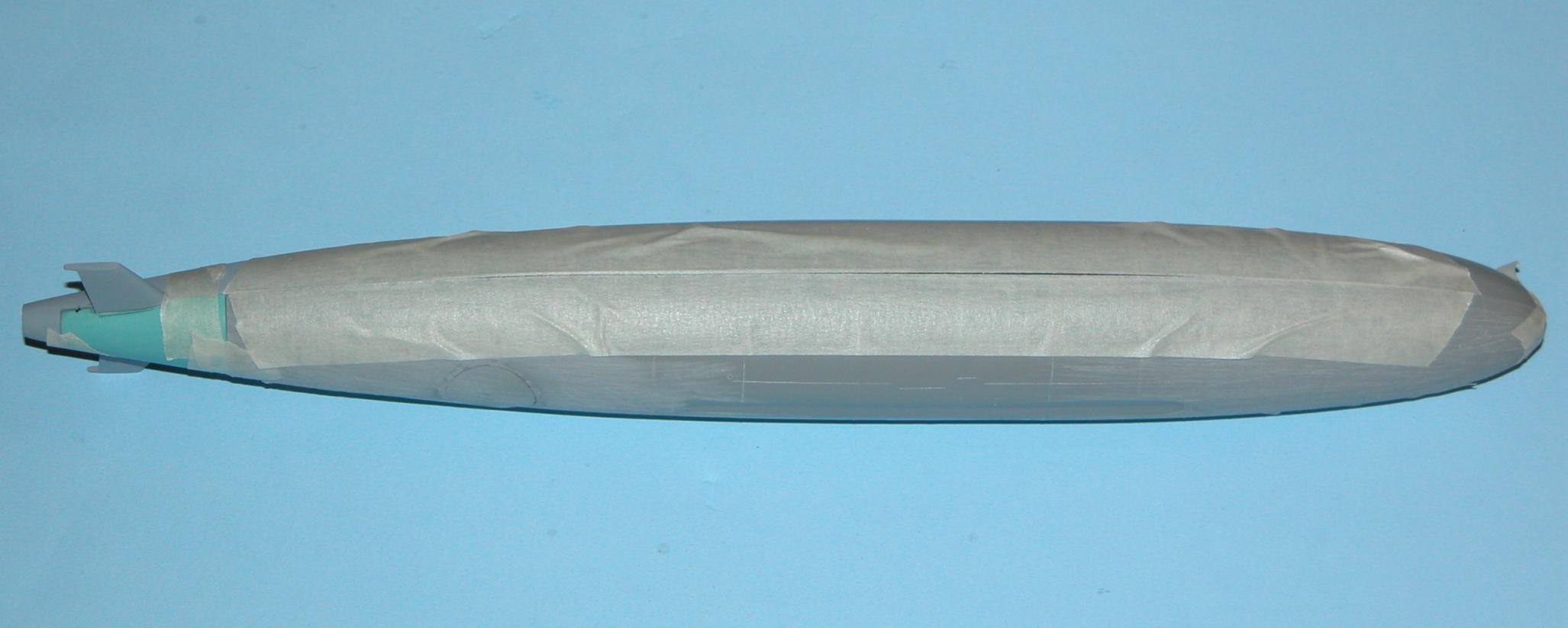

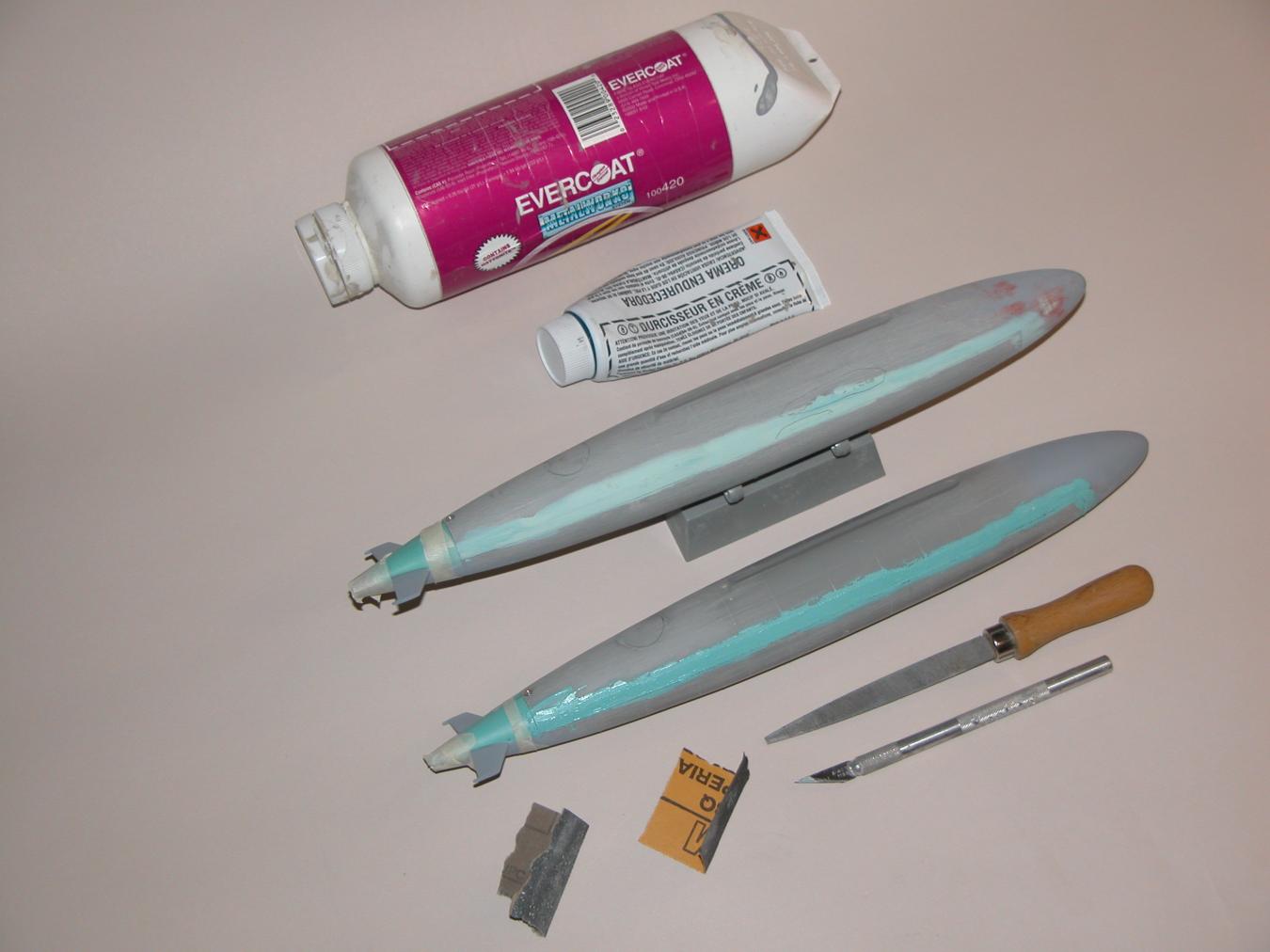

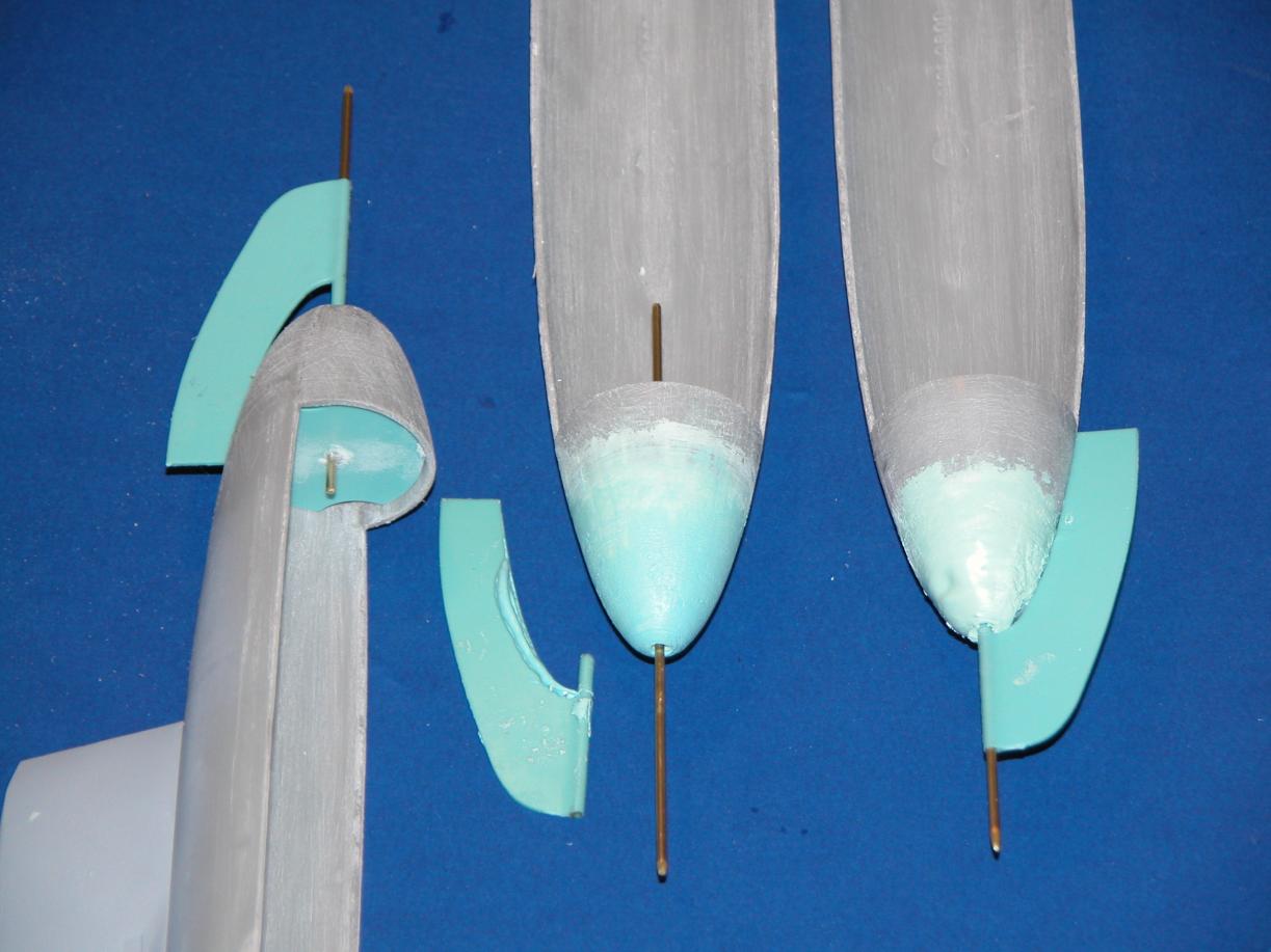

              Three specific chores are addressed here: removal of the bow piece from the lower hull and bonding it to the upper hull half; filling up the gap between the two hull halves when joined; and re-contouring the bow employing the screeding technique.
              First, I identified the gape between upper and lower hull by loosely holding them together, I then placed masking tape on both halve so that the edge of each (one on the upper half, and the other on the lower half of the hull) would meet. The hull halves were taken apart and thick formula CA applied to the area inboard (sticky side) of the tape and atop the hull flange/edge. I then sprinkled on baking soda to build up and harden the fill. This repeated till top and bottom hull halve had their edges built up, eliminating the gap when the hull halves are assembled together.

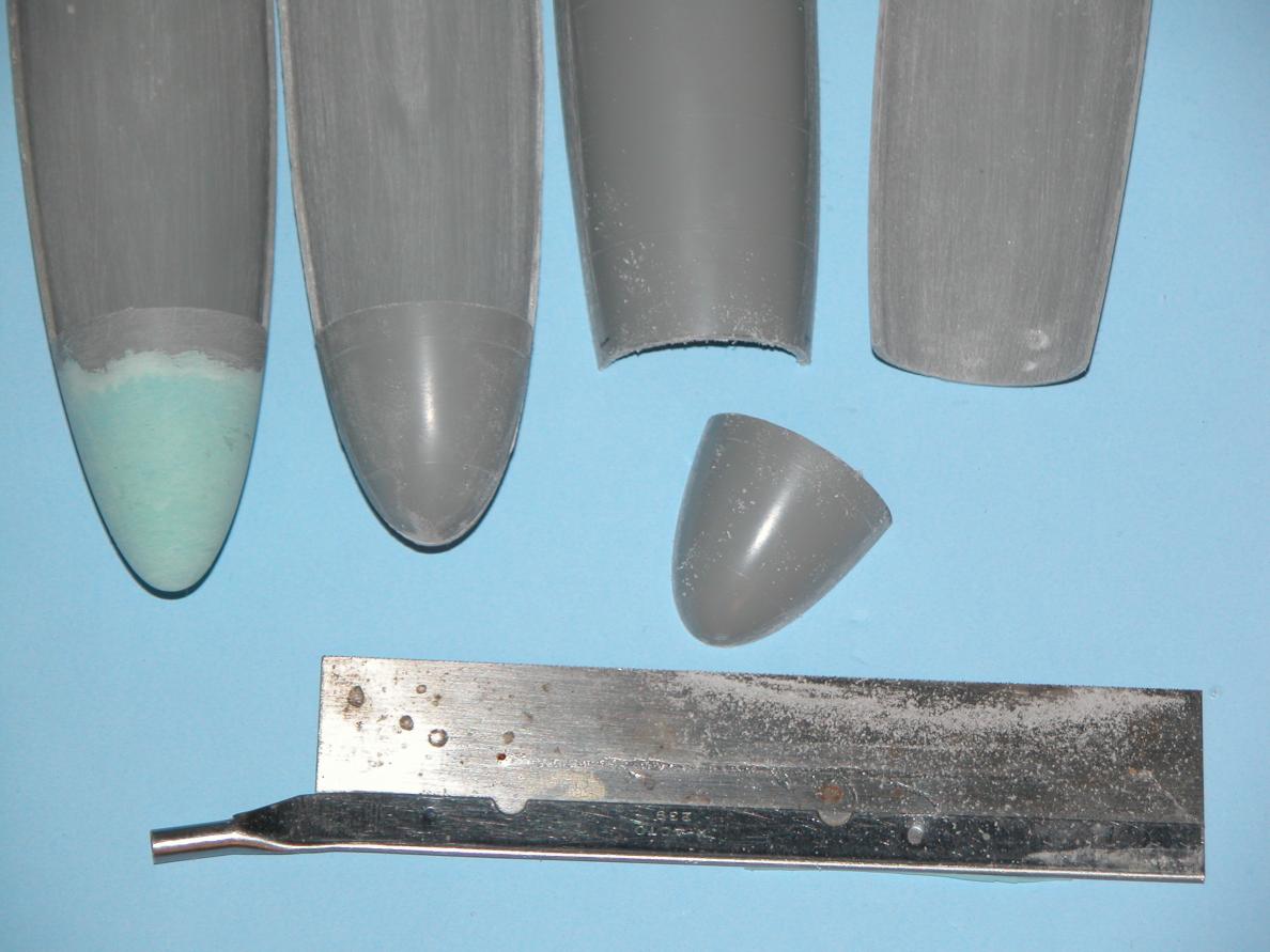

              Once the longitudinal hull gap was tightened, I chopped off the forward bow from the lower hull and bonded that piece to the upper hull. The forward edge of the internal foreword SubDriver back-stop formed the radial flange that captures the upper hull, holding it down on the lower hull when the two halves are assembled.
              I then employed the fittings kit provided screeding tool to re-contoured the bow of the model to more closely match that of the prototype -- the kits bow being much too blunt. Evercoats Metal Glaze filler was the build-up material of choice here. About five layers of filler and I had a new nose on the submarine, changing the entire character of the display!

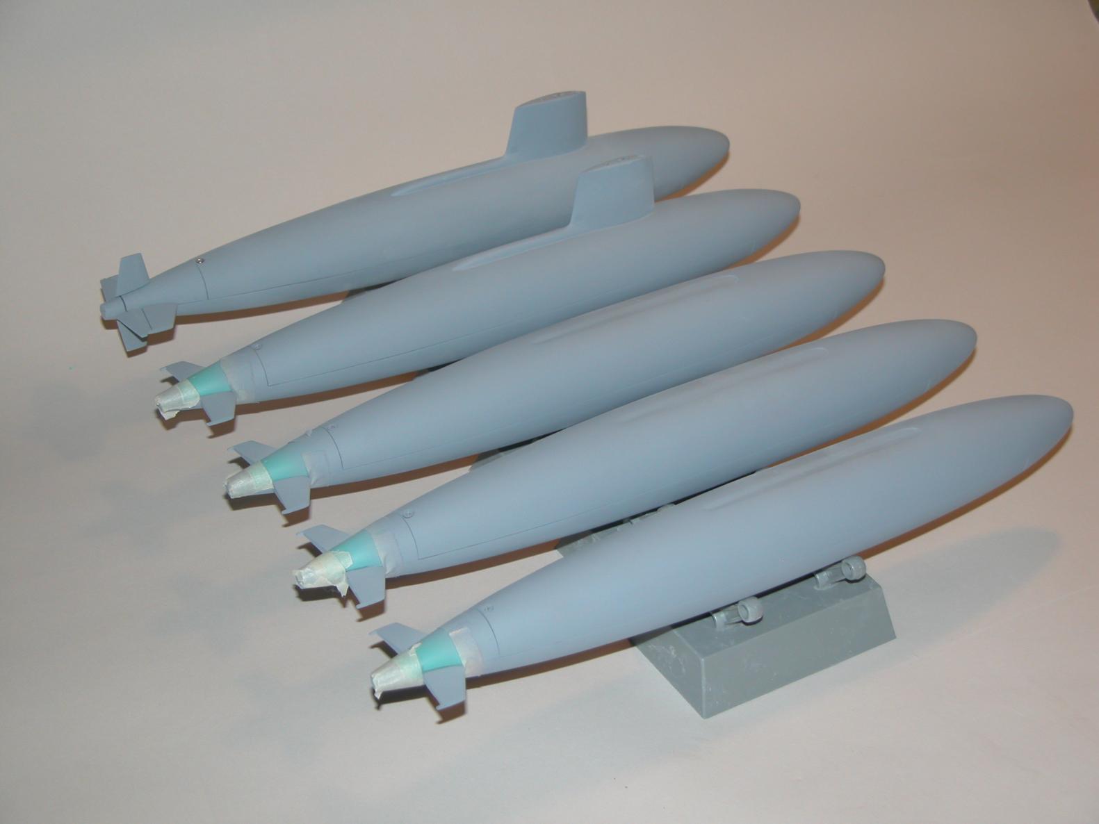

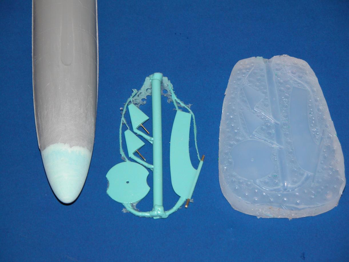

                #37
                Some more shots of todays work. Note that this second production tool not only produces the screeding blade and screed blade centering disk, but also a replacement set of sail planes.
                Sharpening the leading edge of the kit provided sail and re-contouring of the bow makes this model almost a dead ringer for the prototype SKIPJACK submarines. Revell was close; those little refinements I've come up with get it almost perfect.

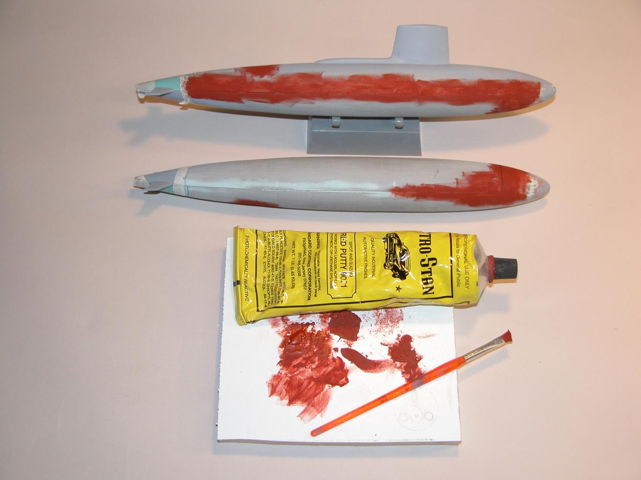

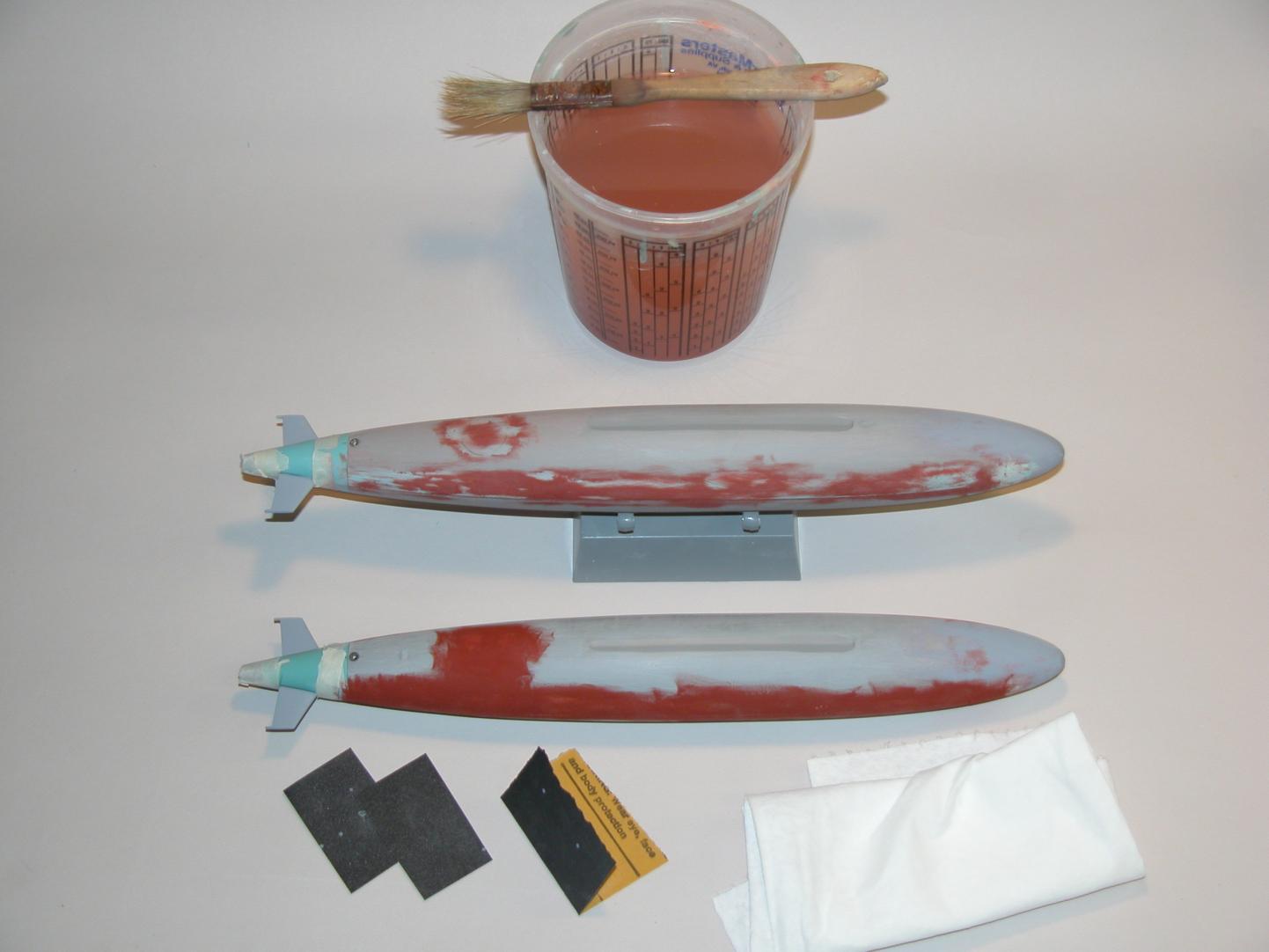

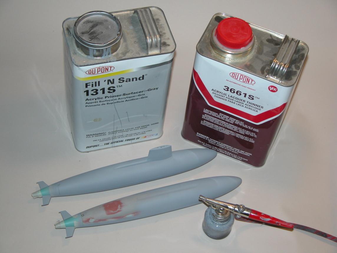

                            Once I had built up the edges between the two hull halves, to narrow the gap, a chore done with CA and baking powder, I cut out a bunch of narrow strips of .020" polystyrene sheet and glued them, stagger fashion, within the hull halves, inboard. These served as indexing tabs to pull the two hull haves into alignment when assembled.
                            To get the two hulls even on the outside I initially used Evercoat two-part filler. The final spot filling of scratch-marks and remaining dings was done with air-dry Nitro-Stan putty which was wet-sanded smooth. The a heavy application of primer finished the days work.
