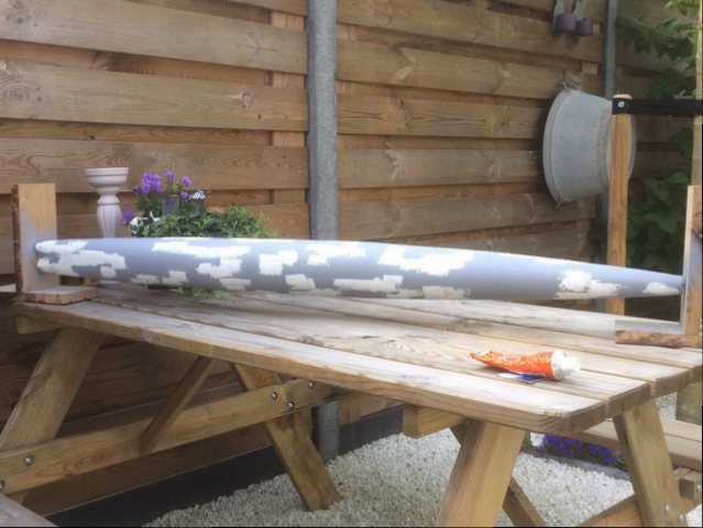

            Still on the move with the Ko Hyoteki, wanted to make some big steps accourding the hull build, this is where i stand now
            First i had to skin the hull with glass to protect the styrodure against the filler and paint.
            In general i apply one extra coat of epoxy to fill most holes, believe me, after spraying some primer i found a lot more, had to make about six runs of filler and wetsanding to get her right.

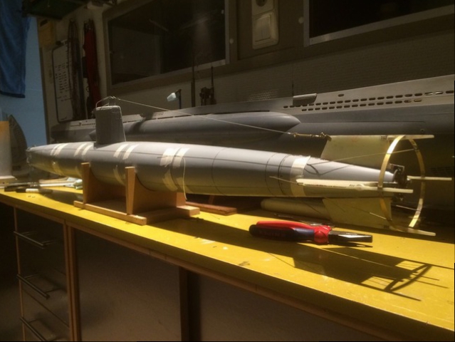

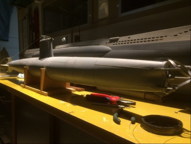

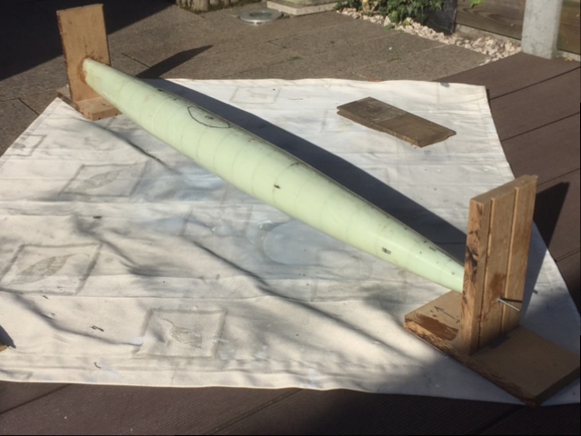

            After this hurdle was taken the fun started, applied all weldinglines with a laser, and started to add the fishingline for imitating the weldinglines.
            It took a week or so to get all lines glued down, sniffed enough CA fumes for months.
            It was worth the effort, she finally starts to look like a sub, next time i will enjoy you guys with rivets-time.

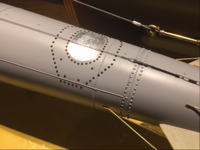

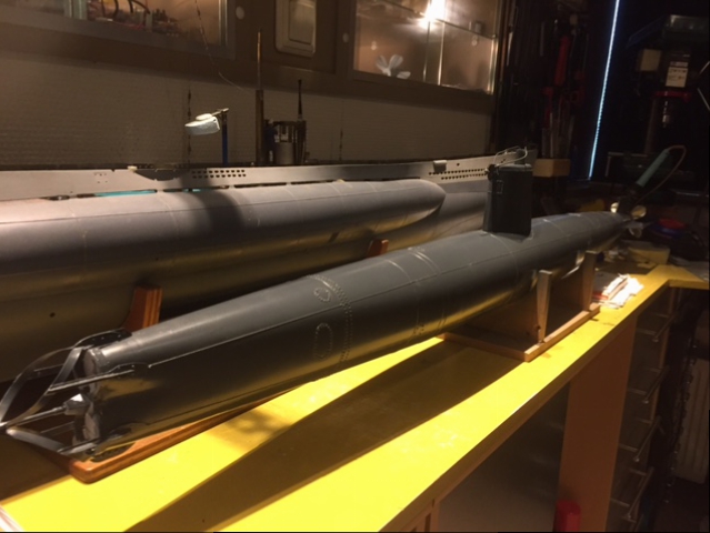

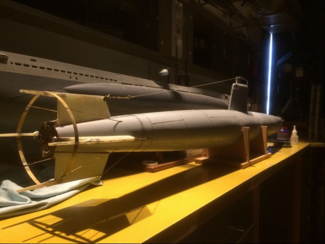

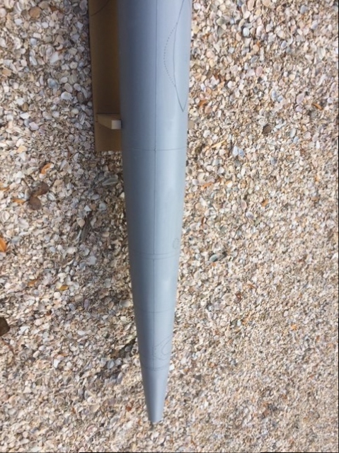

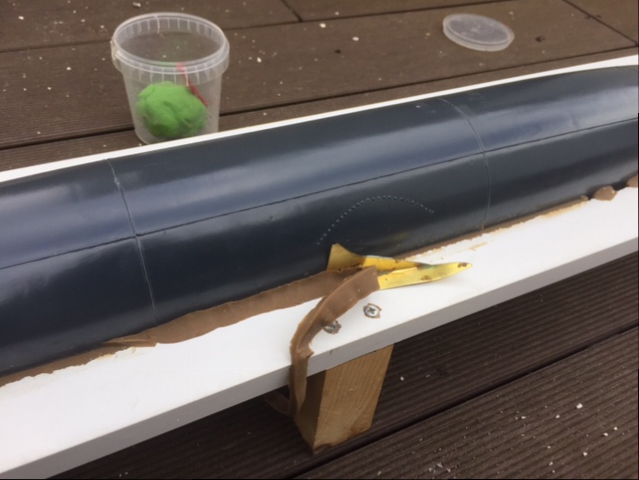

                        As promised the rest of the story, after placing the weldinglines i had to move over to placing the rivets, used the laser again to mark out the places of the rivets, started with the easy one's at the bow and the stern, a job pretty straight forward.

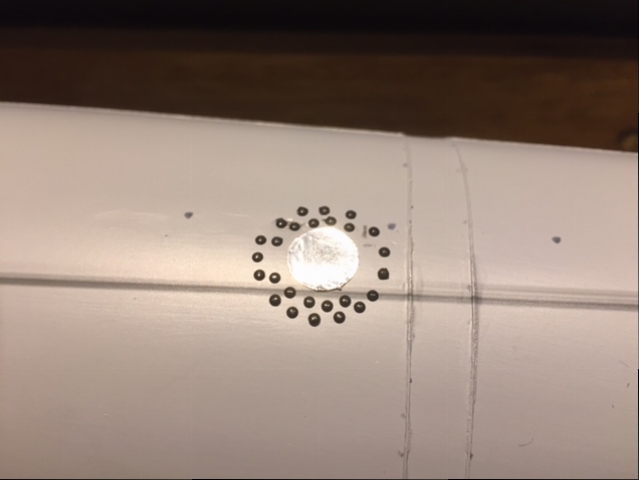

                        The more difficult one's where the ventholes for the batteries, made a template and drilled the holes, inserting the rivets to finish it up.
                        This one was more complex, luckely i had some documentation profided by David and Gene, together with a book from this sub i went making the templates for making this, you also can see the double row of rivets at the stern.

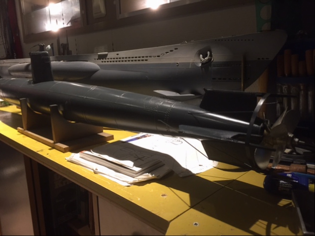

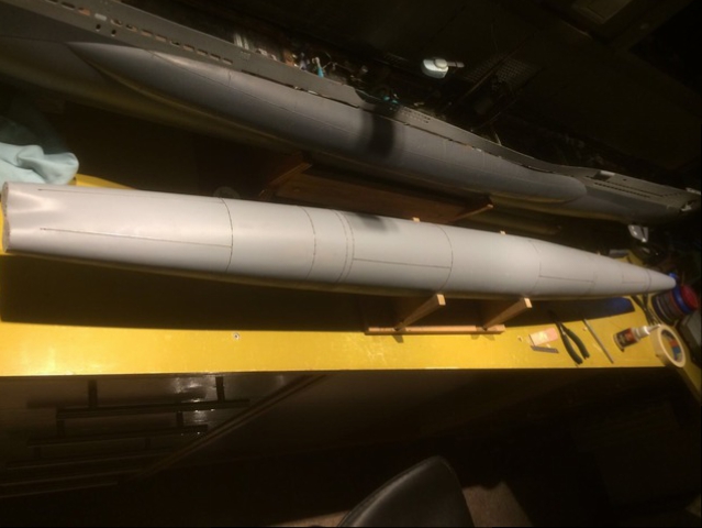

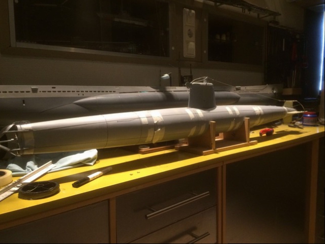

                        I decided to use primer instead of glue for locking up those rivets, this way i get nice sharp rivets without the trouble of removing the excess glue, gave her a total of three layers of primer, more to be sure that those rivets stay on their place.
                        Last but not least the final layer of paint, done this to get a smooth surface for making the mold, for now i have to make the bracket for holding the plug and prep her for building up the actual epoxy mold, this would be my first in adding all details on the plug itself, to get all the details i'm going to use a gelcoat at the first stage of building the mold.
                        I took me a few months to get to this point, running the gauntlett between the honey-do list, my house, the bikes and some other minor things, normally i prefer to build the mold during the spring because of tempartures.

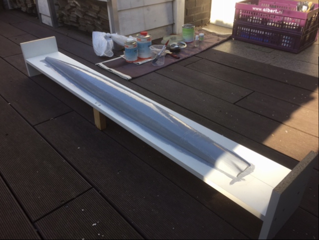

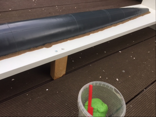

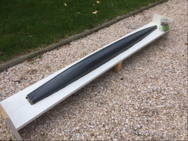

                              First i had to follow the drill of building a jigg to hold the plug.
                              Playing around with some clay to patch up the void between the jigg and the plug.

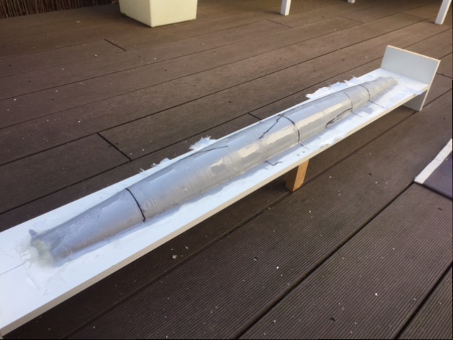

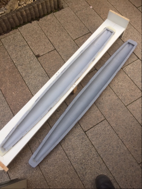

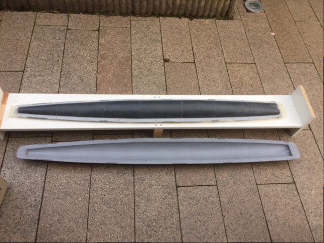

                              Prepping the other side for the next run, yet again it took me a week to complete the other side. Click image for larger version  Name:	IMG_1352_zpsf0eqezgk.jpg Views:	1 Size:	222.7 KB ID:	124062

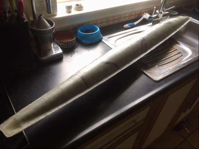

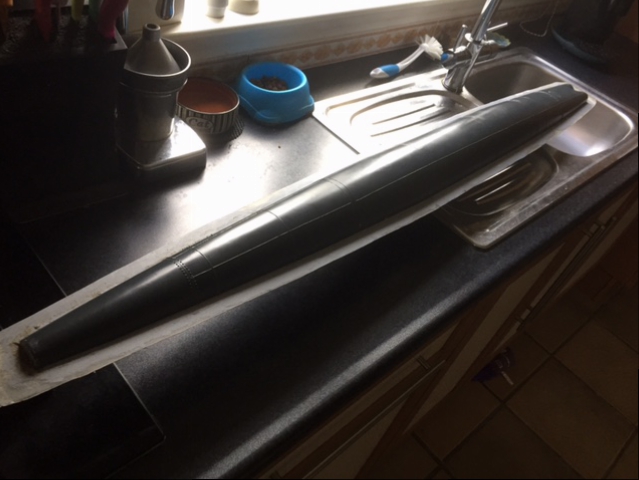

                              The fun part after a few weeks, splitting the mold, due to the simple shape it came loose without any efford. Click image for larger version  Name:	IMG_1354_zpsoiz2pumn.jpg Views:	1 Size:	228.4 KB ID:	124063
                              The other side also loosened, with this mold i made it with fewer layers as with the V80 and the type 17, this gave me some flex for loosening the plug, it worked out well. Click image for larger version  Name:	IMG_1353_zpsal9szdvy.jpg Views:	1 Size:	155.1 KB ID:	124064

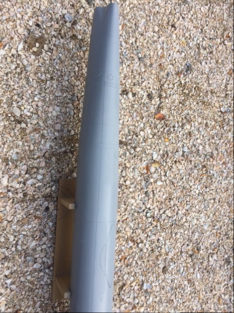

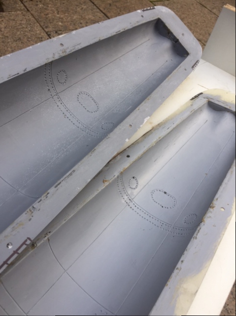

                              As for the details, they came out well, the plug was only slightly damaged, lost some weldinglines as some rivets, but nothing what can't be replaced on the plug, one big hurdle taken. Click image for larger version  Name:	IMG_1355_zpsvvgztfbz.jpg Views:	1 Size:	180.8 KB ID:	124065

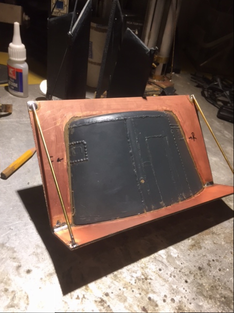

                              Right now i'm in the proces of making the mold for the tower, making this jigg was a differend story, i followed the path used on the balconygerat of my type 17, stiffened the jigg with some copper rods, for now i'm playing with this, to be continued.
