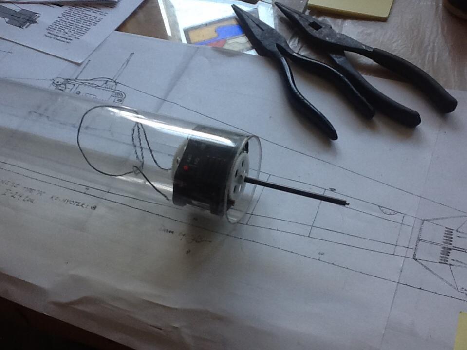

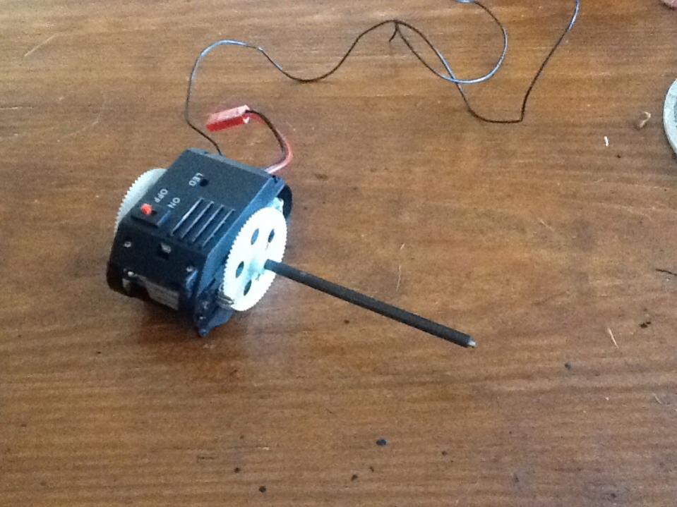

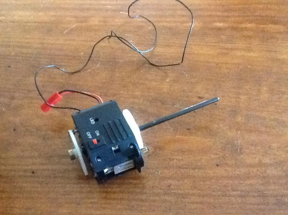

            OK Manfred, thats impressive. I like the simplicity with the pinion gears of your design. I have been fooling with the motor and mast section of a Venom helo which has counter rotation. Its rarher complex with two motors, but it gave me the idea of a two shaft single motor output, that I already have. only need one gear on each output shaft and a recpricle gear on the inner and outer shaft. Its not that complicated but I like your Idea better. My big question is, what your gear supply source? Also, if water is a problem with the gear tollerance, seal the box and fill with ATF. Small cap, tapped into a fill hole on the top plate. Like a full size transmission, you dont want to overfill. Leave some air space, for relief from expansion of the volume of fluid, due to some small heat that is generated. Viscosity changes but no pressure build up.

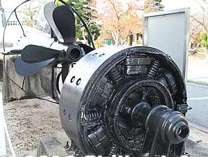

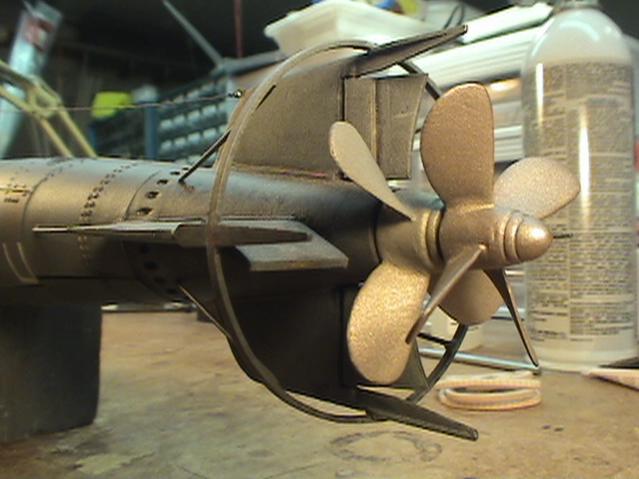

              While attending Torpedoman A-school I learned that the counter-rotating propellers on the MK-37 family of torpedoes used a motor whose field winding assembly, as well as the armature, was free to rotate within the motor case. The after propeller was coupled to the armature, and the forward propeller was coupled to the field assembly. Not only does this arrangement eliminate the counter-rotation gear-box, but reduces noise, and assures perfect torque balancing so that net torque presented to the vehicle is a big, fat ZERO! Neat.
              I'm thinking of taking a motor, put the entire motor case on a bearing so the motor can rotate. Then it's a simple matter to couple the motor to the outer shaft (forward propeller), and drive the after propeller from the normal motor drive shaft. The motor would sit in the wet (good for one season, at least). Slip rings and brushes would get power to the rotating motor assembly.
              If I ever work out how to transfer a stock motor armature-commutator assembly onto a hollow shaft, then I would be able to use two motors in tandem -- The forward motor driving the after screw, the after motor driving the forward screw.
              Ah ... the posibilities!

                Looks like an armature inside an armature here Click image for larger version

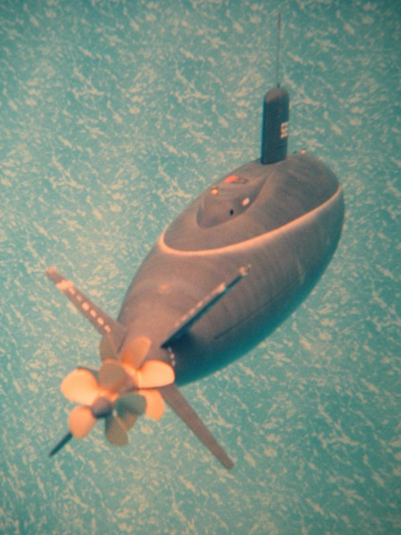

                  1/20 scale torpedo with counterrotating props

ID:	97703I can replace the plastic outer shaft with brass tubing and replace the mainshaft with a longer rod, to suit the LOA to the hub carrage bearing at the cone.

                      • 13976
                      http://www.pt-boat.com/torpedo/torpedo.html
                      Good catch, Romel. I'll see if I can punch out a 555's motor-shaft. Film at eleven!

                          Romel,
                          A good catch, i've seen this site before, but had lost the link to it, that guy uses two motors in tandem also a interesting way to get those props counter rotating.

                            just rwalized the correct term for this set up , it should be contra rotating props not counter rotating. Contra is used for 2 props on a single shaft turning in opposite directions, counter is 2 props on 2 different shafts turning in opposite directions.
                              Tecniclly you have two props on a centerline shaft in a shaft that rotate in opposite directions Its called LCT( limited to centerline thrust) so since you designed it you can call it anything you like. but it sure is cool. Your prototype gadjet could make a nice soufle' or crepe'. I should rip into my wife's, mother's old Hammelton Beach portable cake mixer for the gears inside there.
