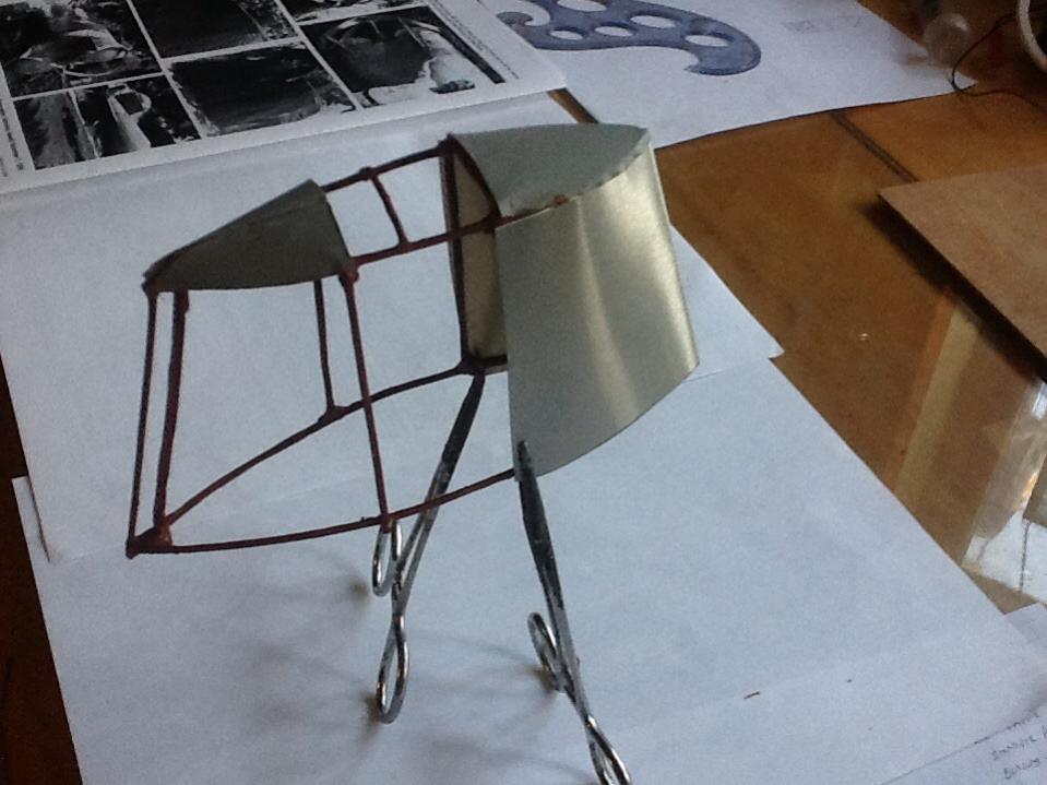

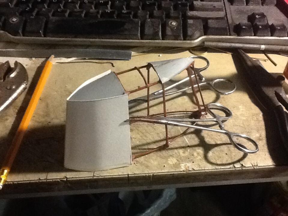

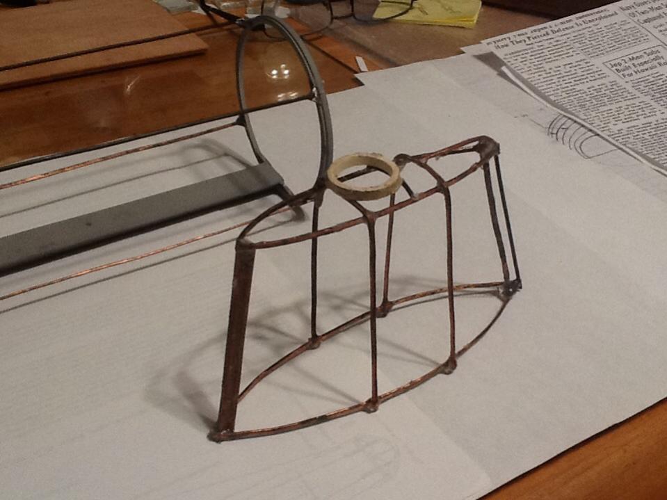

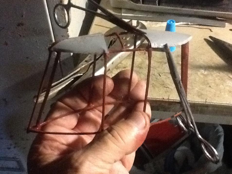

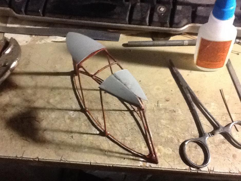

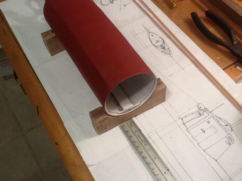

    I to, have started the framework for the tower. The crews compartment below is intigrel to the tower, as the periscope housing will be secured to it an will be lined up with the towers hole. Click image for larger version
ID:	97931Click image for larger version

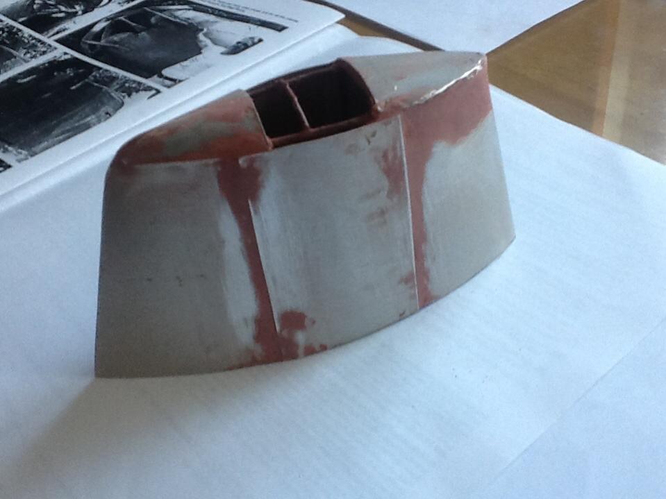

      Today's tower work.Click image for larger version
ID:	97935Click image for larger version
ID:	97936Click image for larger version
ID:	97937Click image for larger version
ID:	97938Click image for larger version
ID:	97939Click image for larger version

        Wow Von,
        You are fast !!!!, what kind of plating did you use?, and what is the total weigth of your tower.
        Me on the other hand, still on the hunt for the right tube, searched inside the local stores, nothing, only 100 mm, i need 106 mm, if i don't find the right diameter i'll end up with 100 mm and will fill it up until 106.

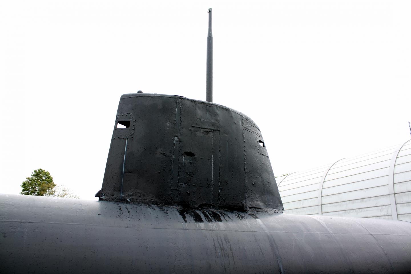

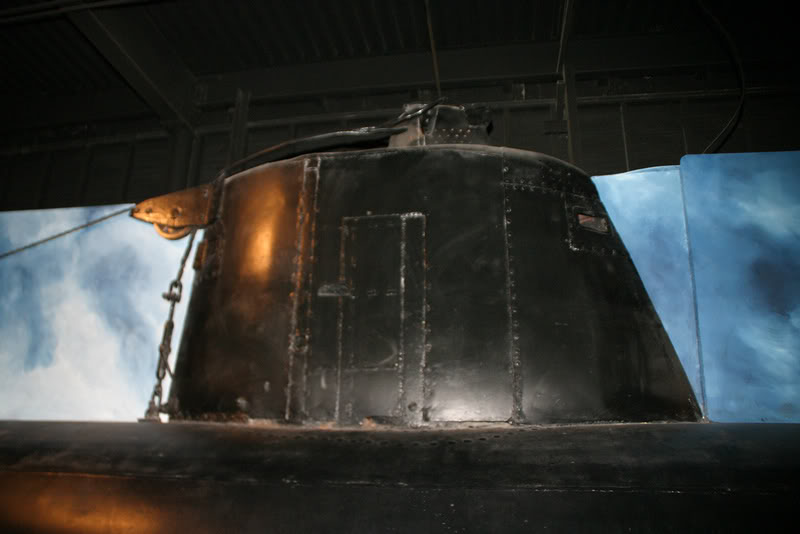

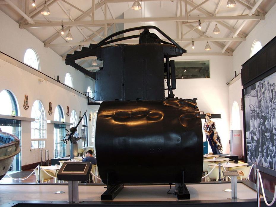

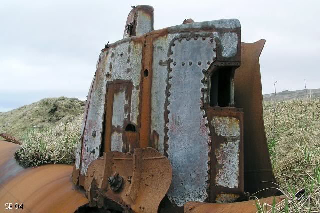

        Still searching more pictures about the tower, like to see the details, i'll show you my lastest harvest,
ID:	97946 Click image for larger version
ID:	97947 Click image for larger version
ID:	97948Click image for larger version
ID:	97949Click image for larger version

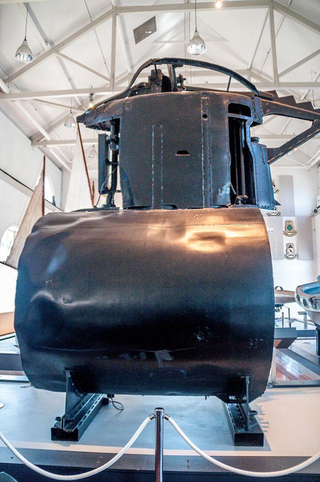

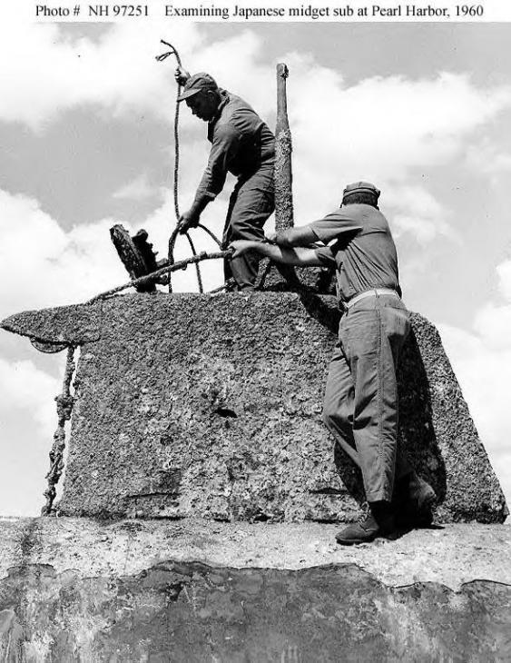

        The other one's are from a Class B type, but it seems that the tower is nearly the same compared to the Class A,
ID:	97951 Click image for larger version

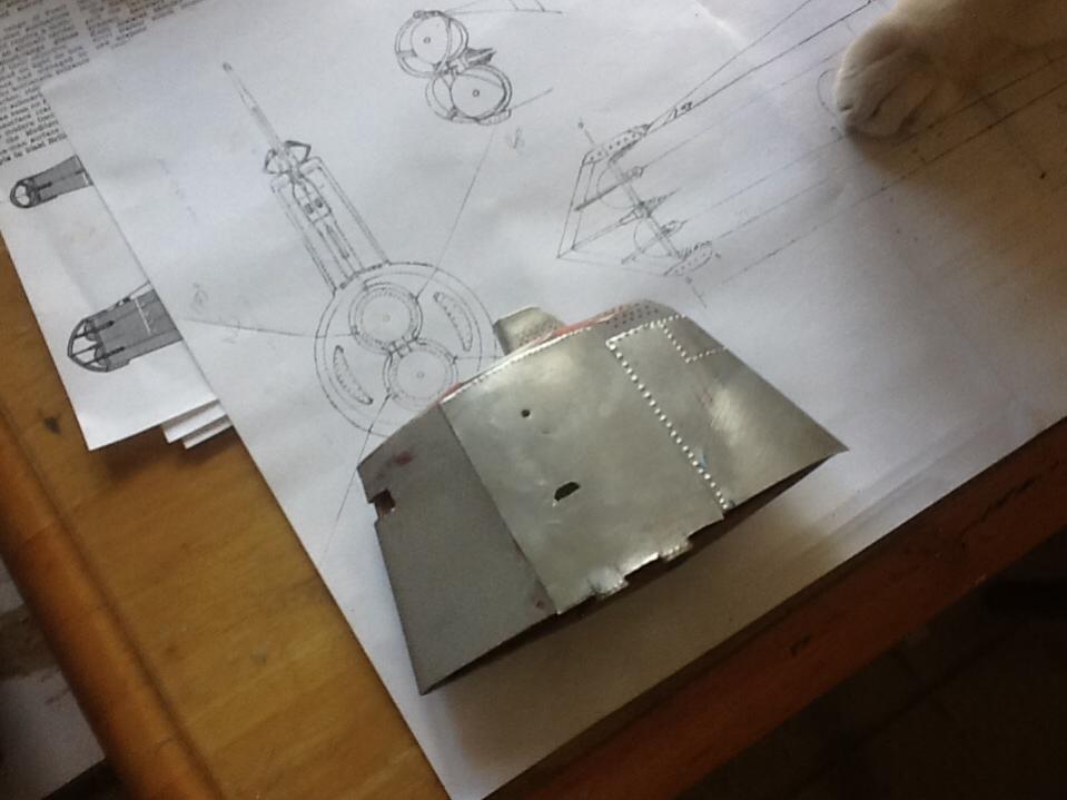

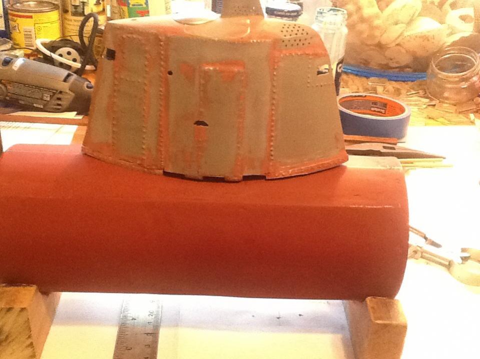

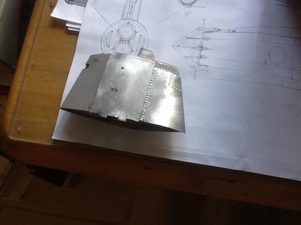

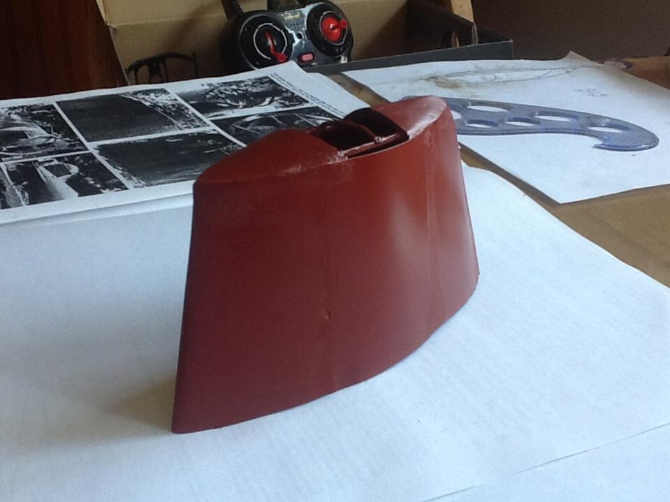

          My tower weighs 44grams right now, but there will be more weight with the anti fowling guards and the pully system. I kind of have to keep it light because of no external keel to put weights in, and it may tip over. I sheeted it with different gauges of aluminium sheet as well as trusty old beer can, in a few places.Click image for larger version

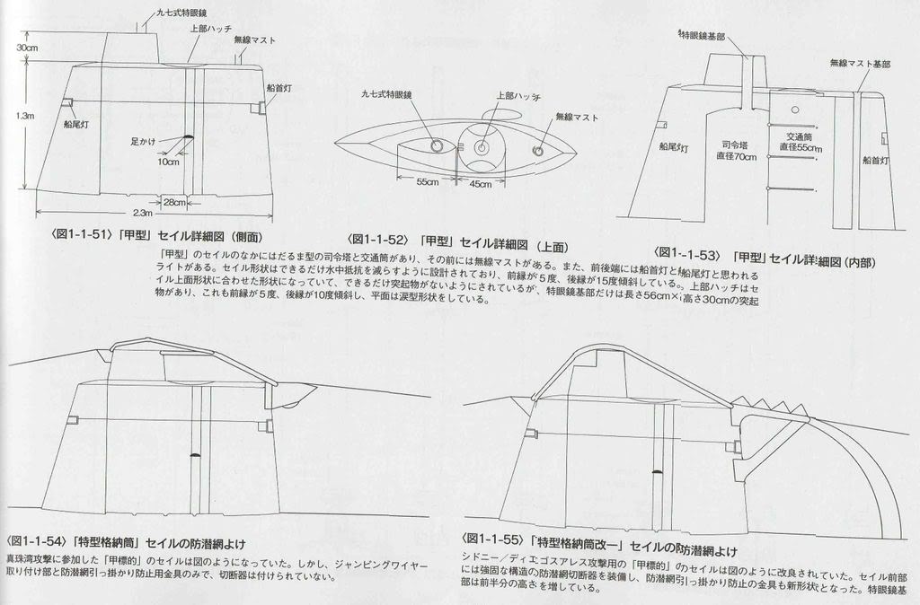

ID:	97953You will notice that the drawing, is different than the pictures of the Ha19. Periscope is slightly forward on the real boat, and not centered in the middle of the fairing, like the picture. BTW, the 19 is the boat in the Washington DC picture on the bond drive, and again, the color pic at the Nimitz museum. The crusty tower is the 8 boat, the one In New London, also the other black and white pic, being raised. Another issue, is the scupper holes, or slots at the skirt of the tower. Rivets and weld seams are well defined on the photographs, some are not included in the drawings. Im thinking of leaving the imperfections, like the voids and pits dents ect. When it gets the black It will look like the real deal, dented and dinged. 105mm just a bit over 4". If you can get pvc 4'' id that should get you close on the outside dia. Is that what you are going to use to make the plug mold?

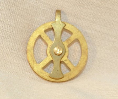

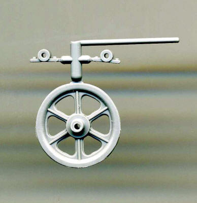

            Manfred, Look what I foundClick image for larger version
ID:	98019HO scale and O scale railroad accessories around $3.50 each, I orderd one of each. 10mm-15mm for the antifowling cable pulley. Also found a small pulley in brass, but jewelry, 25mm $35Click image for larger version
Name:	brass pulley.jpg
ID:	98020 I'll go with the resin, but I had thought of making one from brass, if it were to function, with a miniature turnbuckle, but that would not be the case in the 1/24th model.

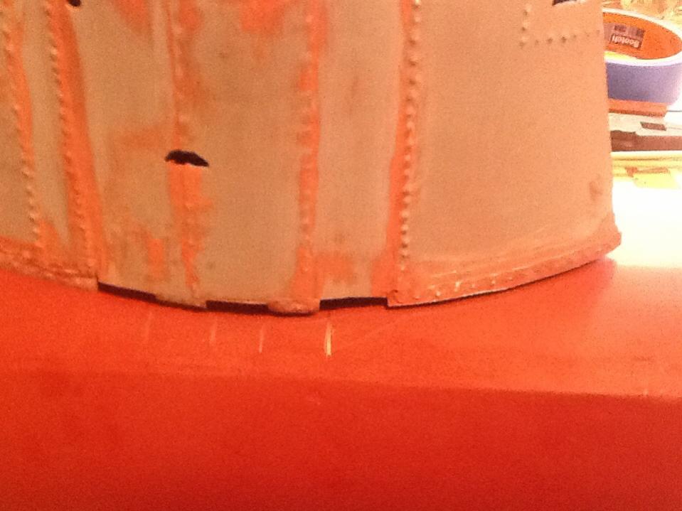

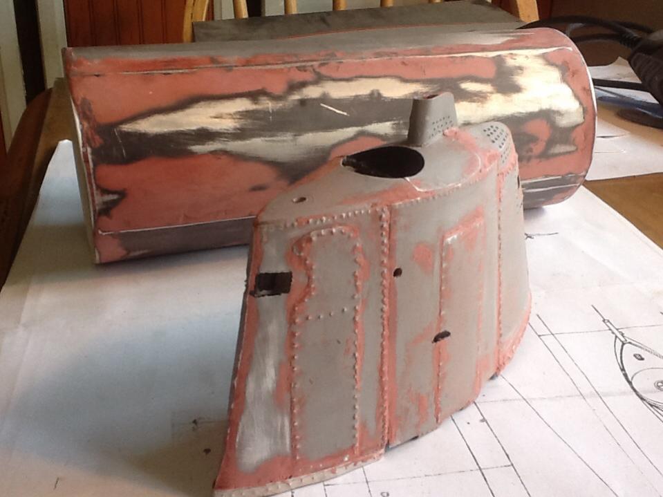

              Sheeting the riveted,armor plating to the tower.Click image for larger version
ID:	98021Click image for larger version
                here is a big picture of the port side step position. left foot step. starboard side is for the right foot, and is more forward position. this boat is the 18. it does not have the scope fairing or the anti fowling rails, which double as grab rails for climbing the tower. They were not put on that display, altho they were on it when she was raised. note the layers of the plating lateral to the officers position. the alaska boats show the plating clearly. side peep holes, are not oppositely concentiic either. They are slightly asque. port side is aft a few mm. Pilot sits eye level. Looks port with left eye and right with left eye, for lateral vision.Click image for larger version

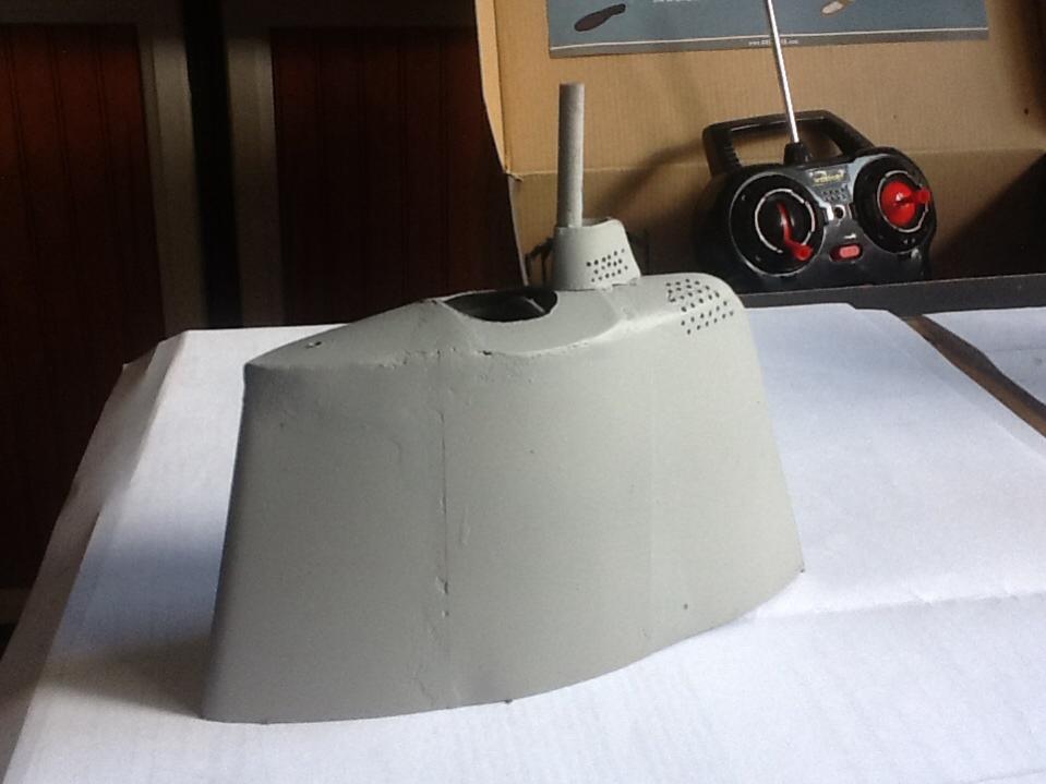

                  Some more on the towerClick image for larger version
ID:	98040have to figure out how I will mount it, before I go much further.

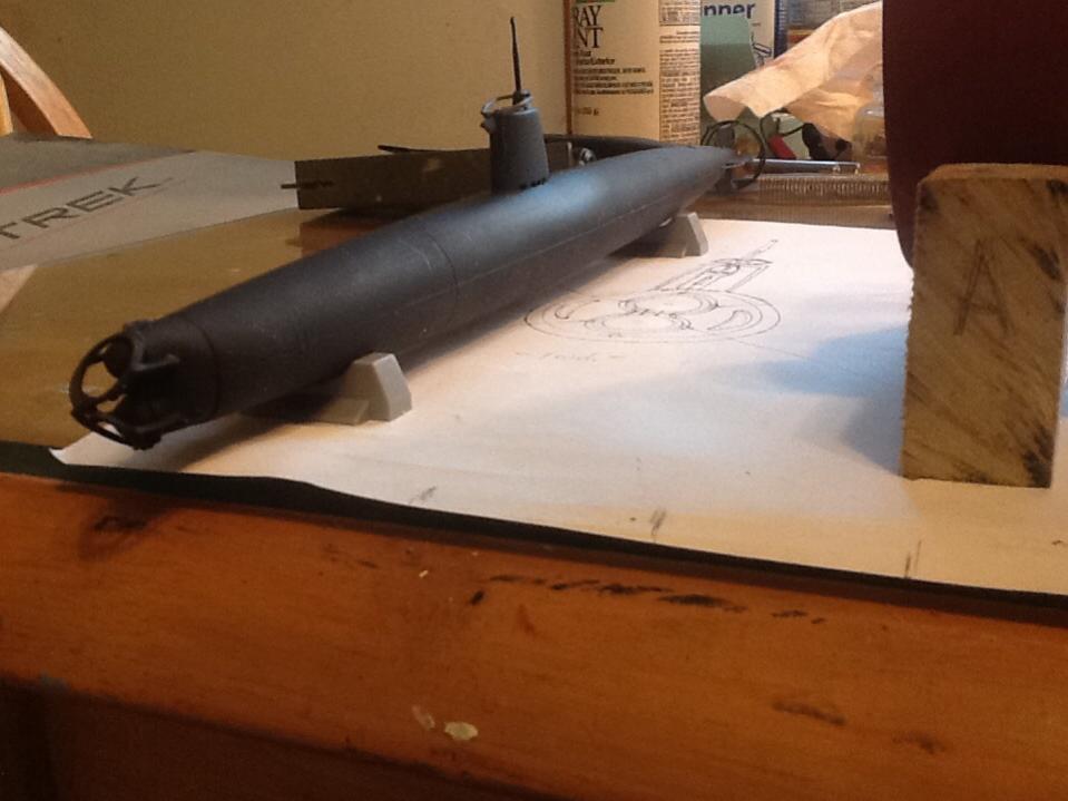

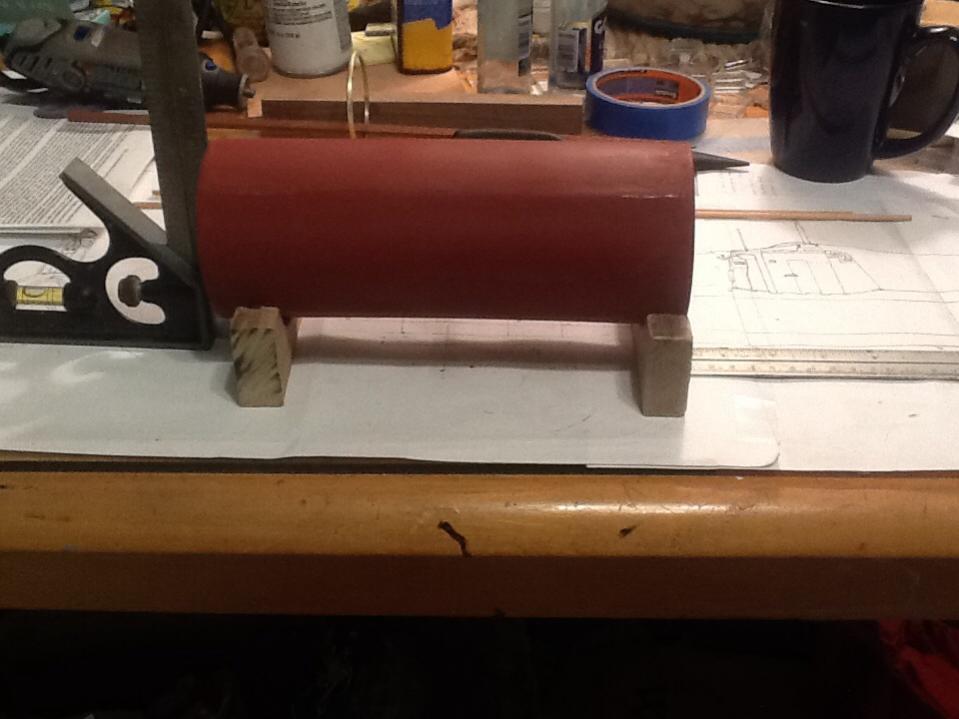

                        When Mitsubishi, got the word to build the two "target" boats, they took a storage tank that the shipyard had already been producing. Basically found a big steel can about5 meters by2 meters, large enough for a man to stand in, and stuck a tapered front section( built in a different part of the yard) and a tapered motor section, built separately, as well. It was for opsec, as well as convienience. They were suppose to be target vessels, and were expendable, hence the rugged craftsmanship, and less than esthetic appearances. Here at the Yokosuka shipyard on Little Torch, we like to keep in the tradition, and follow the legacy. The Can Click image for larger version
ID:	98045Click image for larger version
ID:	98046Click image for larger version
ID:	98047Click image for larger version
ID:	98048I have to build a jig today, then it's time to switch Navy's . It's raining radios here, the back orders all caught up. Now I have more than I need. It's almost May, and the Germans need attending to. They are going to loose the war, 70 years ago.Click image for larger version
ID:	98049Click image for larger version
ID:	98050The dremmel died, so is hand file time for this puppy. Time to step away for a bit. I ordered another, and have three to send into Dremmel, for worn out slider switches, and cleaning. PIA to do it myself anymore.

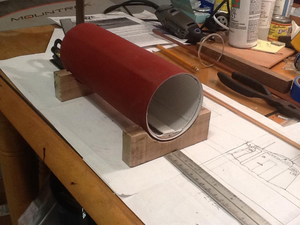

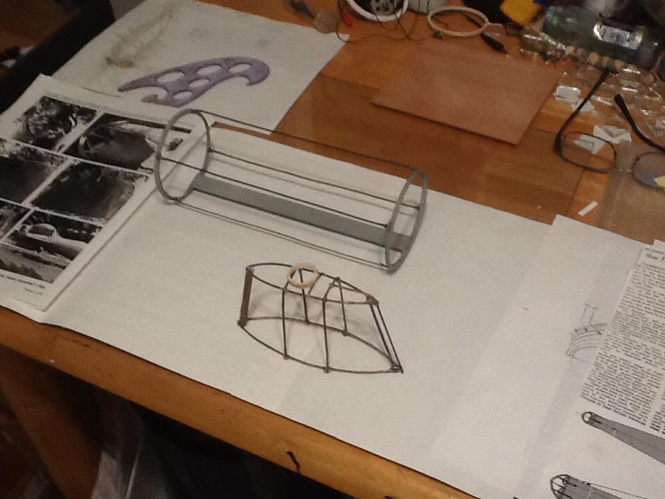

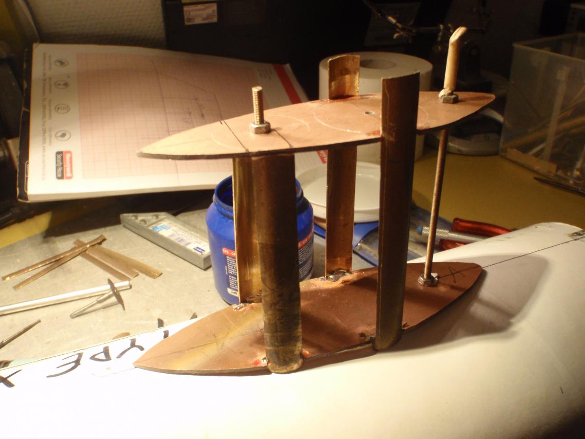

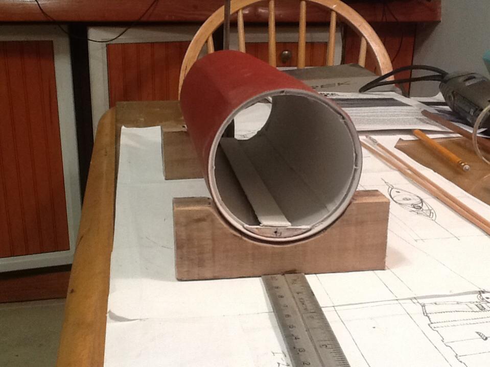

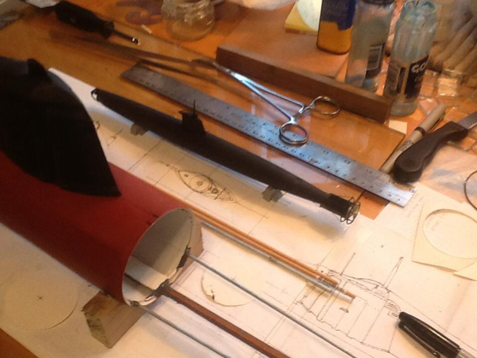

                          Von is running ahead of me fast, his advice for searching a 4" tube helped, i even found it on the attic, those cardboard tubes which David uses to send off his SD's, argghhh, all the time under my grasp, never thought about it.
                          And then came the Flue, last week i was knocked off my feet with fever, today i feel good enough to start up the computer, i'll show you what happened before the Flue.
                          First i scooped up this drawings from the web, some one took the effort to take some measurements, greatly appriciated.

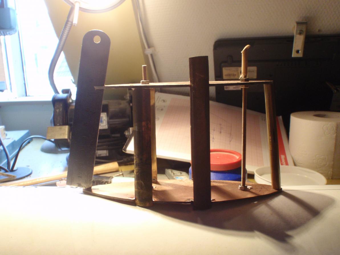

                          Fastened the tower to the tube and started with imitating those tubes from both the access hatch and the scope, cutted some big diameter tube into pieces to get me the rounded parts.
                          At this moment the Flue got me, just started with making the reinforcement rod to get me a rounded front of the tower, still have to place the strip at the back.
                          Using this as a startingpoint for cladding the tower with sheet copper.
