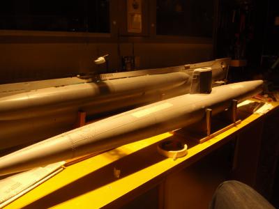

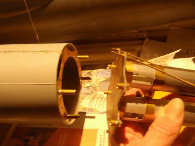

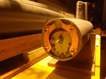

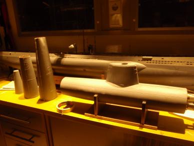

                Time to make a new update, i've cutted the hull into 4 parts, initially i wanted to make two cuts, but the conical rearpart gave me some trouble, since i have to place all moving parts into this part, and i've got big hands, i decided to make the third at the double row of rivets, giving me room to play inside the little conical part.
                Next task was to make all connections for the hullparts, i seems funny, first make one hull, cut it into four parts and rebuild it back into one hull, pictures. Click image for larger version  Name:	P1070017.JPG Views:	1 Size:	16.8 KB ID:	124620
                At the end i've got me this, working on this every day into the weekends. Click image for larger version  Name:	P1070018.JPG Views:	1 Size:	17.5 KB ID:	124621
                The two-shooter, temporarely fixed with bolds to the forward bulkhead, still have to make the provisions for making it removable from the bulkhead. Click image for larger version  Name:	P1070019.JPG Views:	1 Size:	14.4 KB ID:	124622
                The studs that will keep the conningtower to it's place, it will be secured with some neodyne magnets. Click image for larger version  Name:	P1070020.JPG Views:	1 Size:	15.8 KB ID:	124623
                The frontpart can be placed without taking off the two-shooter, have to make the pin-connections on the frontpart, made this such way so you can tinker with the tubes without taking the complete model apart, no king of complexity this time. Click image for larger version  Name:	P1070021.JPG Views:	1 Size:	14.7 KB ID:	124624
                Rearpart number one, same method as the frontpart, securing it yet again with magnets. Click image for larger version  Name:	P1070023.JPG Views:	1 Size:	13.8 KB ID:	124625
                The last rearpart which gave me some trouble, with this configuration i can reach inside to get the moving parts working, the gearbox can be placed inside with plenty of room for the steering rods, same trick with securing it with magnets. Click image for larger version  Name:	P1070024.JPG Views:	1 Size:	16.9 KB ID:	124626
                This was my aim, getting one hull again, for now i have to order my magnets, they will be different in strenght and sizes, i mostly need round one's, probably some rod-type one's, still have to make my wishlist, for now it's looking good, most of the components are pre-build so i can speed up the pace.

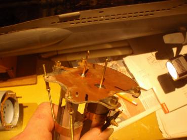

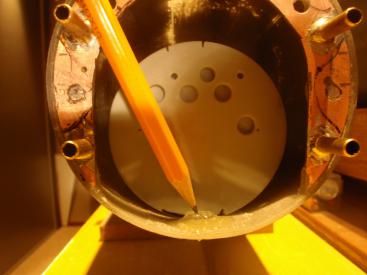

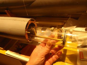

                      This is the endplate i modified for holding the launchsystem, one tiny problem, in this configuration it's blocking the way of inserting the subdriver.

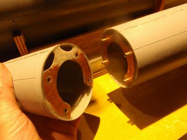

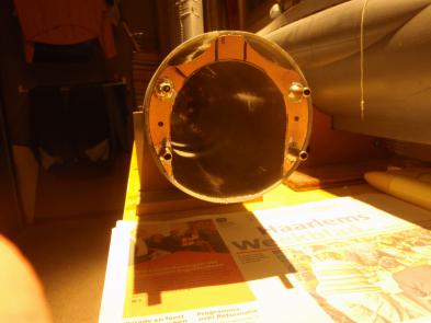

                      This hurdle was taken by making a tube and plug system, it looks like the connections i've made for connecting the hull parts, it's a snug fit, but you can pull it off by using both hands.

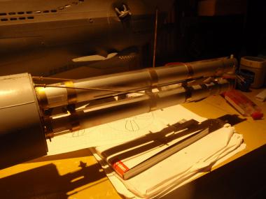

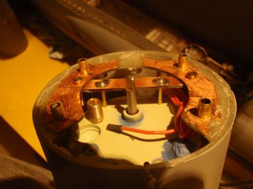

                      At the back you've got the drivingshaft and all connections for the rudders, divingplanes and emergency bouy.

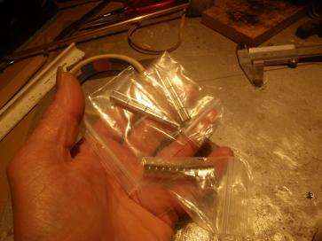

                      Yesterday those guys arrived, magnets in different sizes, i figured out at which place i can use each magnet, you guys have to wait for that, first solve some other issue's.

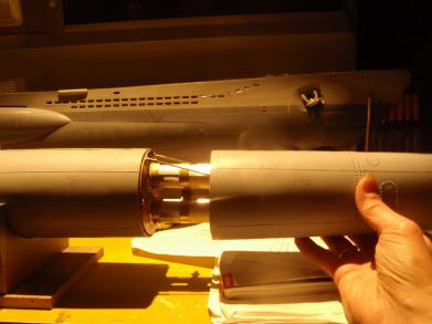

                          Finally all magnets are glued down with epoxy glue, tested the hull and found me a solution to keep the SD kiss inside the hull, pictures

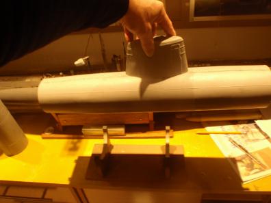

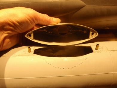

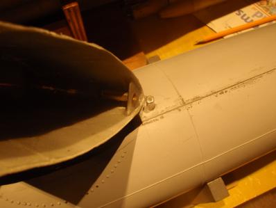

                          Those little gritters are strong enough to lift part of the hull with attached tower.
                          On one side the magnet sticks through the hull, the one inside the tower is glued down inside a little tube.

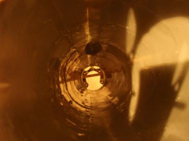

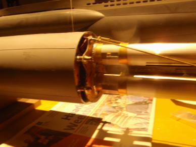

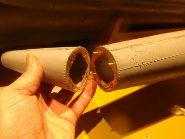

                          A peek inside the tunnel, at the end you can see the five magnets i used to keep the rearpart together,

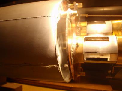

                          I used this pin connection as the solution to keep the SD inside, on the pins itself there is a small tube placed, simply to give me each time the same distance when placing the SD.
