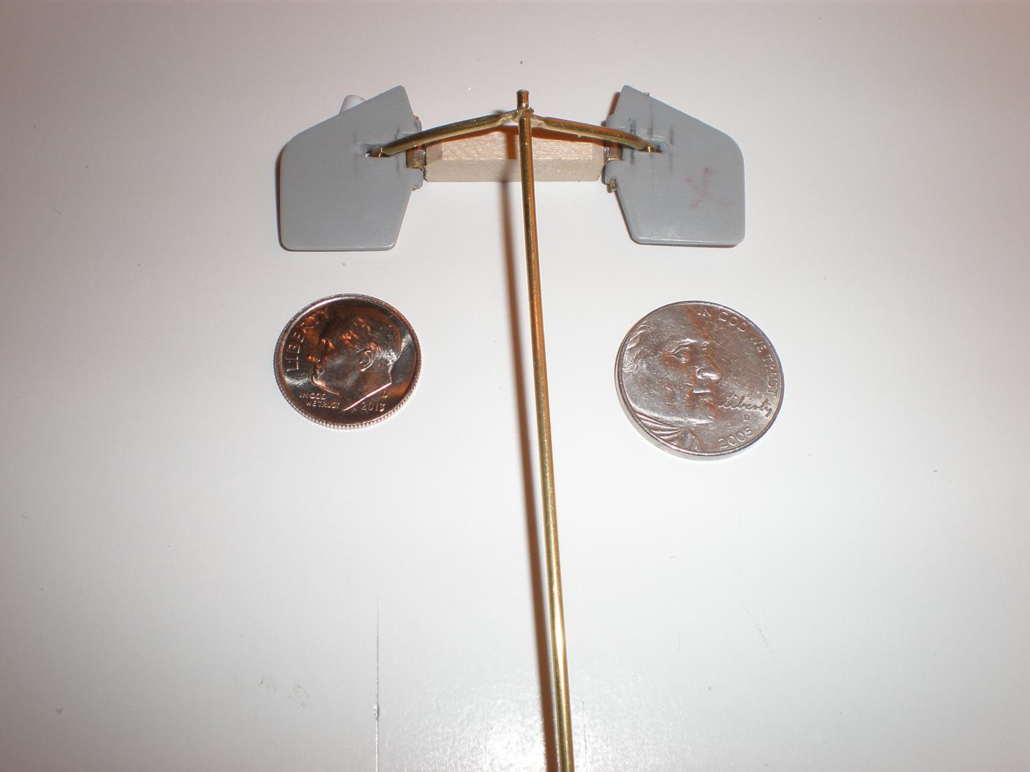

        Gary, could you place a 10 cent coin next to your work so most can get an idea on how small the bits are that you're working with. I have one of these kits so I can really appreciate your work!

              Happy to oblige, Myron!
              Here is the last photo from yesterday with a dime on one side,
              and a nickel on the other for size comparison. Relatively small parts, to say the least!!

              If at any time you should require further clarification on anything I'm doing,
              please ask! Always happy to be of assistance to a fellow modeler!

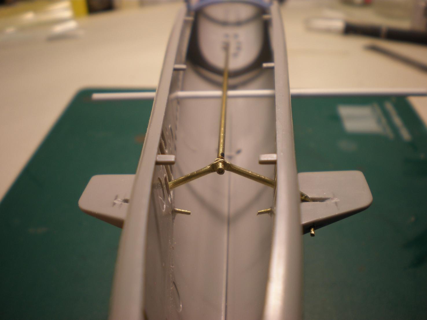

                Houston, we have retractable forward planes!!!
                Here they be in dive mode...
                In this position, the float would have raised up, and forced the operating arms down to deploy the dive planes.
                The piece of white plastic you see a couple of inches aft of the hinge points is a temporary "pivot point", until
                I figure out exactly how I'll finish it! At the aftmost end of the brass tube is where the float will be attached.

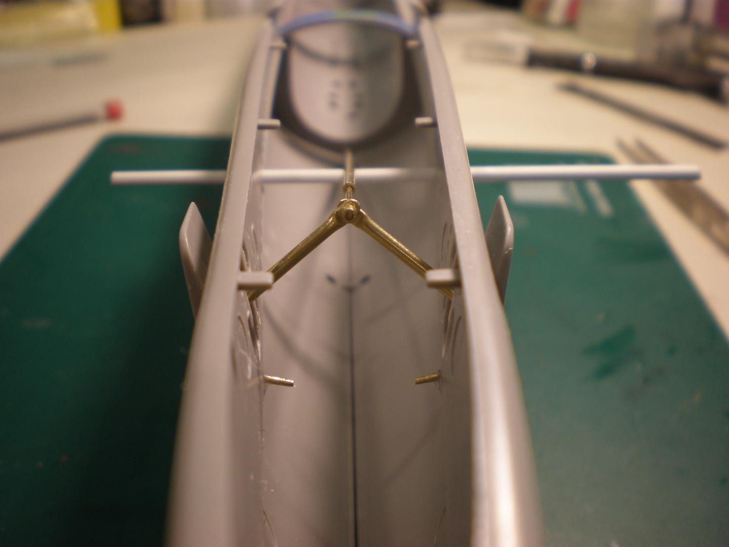

                Here they are retracted...
                It's pretty doubtful that they'll retract alot while on the surface, but certainly
                will when she's back on dry land! Also notice that they don't retract all the way against the hull.
                This was due to a necessary "trade off"! It was either let them retract as far as they can, or cut a hole in the deck
                and put some sort of really strange, bulbous thing up there to cover the linkage!! Not happenin'!!!
                May do a bit more "tweaking" on the control arms. If so, I'll post the final results!

                  Amazing. I reiterate "You are a watchmaker!" Will the Sub-driver still fit in there without interfering with your float?

                    Thanks, Sublime!!
                    Appreciate your comments!! About the closest I'll ever get to being a "watchmaker" is if I "watch"
                    somebody else do it!! Hah!!
                    Many years of being a machinist, tool maker, modelmaker, moldmaker, etc., have
                    taught me pretty well! Just a mater of knowing which "of the above" to choose from when doing the R&D stuff!!
                    Anyone can do it!! Just gotta put your mind to it, and not be afraid to disintegrate a few brain cells from time to time!
                    If I can do it, you can do it!! Think it through alot, make sketches and lotsa mistakes. Only then does the confidence come
                    that'll let ya do it right!! Kick butt, and take names!!!! Above all, have fun and make every adventure a learning experience!
                    You heard it here, folks!! (LOL)
                    Right, M???
                    And yes, the little 1 1/4" subdriver will fit really well! There'll be plenty of room in there for it!

                        Good stuff, Gary. You made it work and with less Rube Goldberg than I initially thought it would take.
                          #117
                          Just wondering, how would your bow planes react to wave action while the boat is surfaced. Would your bow planes start flopping up and down everytime you pass through a wave?

                                G'Day, redboat219!
                                When surfaced, they may well want to flap around like a crazed albatross, but won't really
                                know until she's in the water!
                                I'm guessing that the float, itself, will be the determining factor there! A heavier float might
                                help fight the flapping, but buoyancy may be a problem. Also, I don't want to add too much
                                unnecessary extra weight to the bow!!
                                Any suggestions would be appreciated, as I was thinking about using the bulb end of
                                a pipette as a float. Pretty lightweight, but would certainly create enough buoyancy to
                                keep the planes fairly rigid when underwater. The downside is that, on the surface, things
                                could get a little "out-of-control"!! That would be where the "Rube Goldberg" scenario may
                                come into play!
