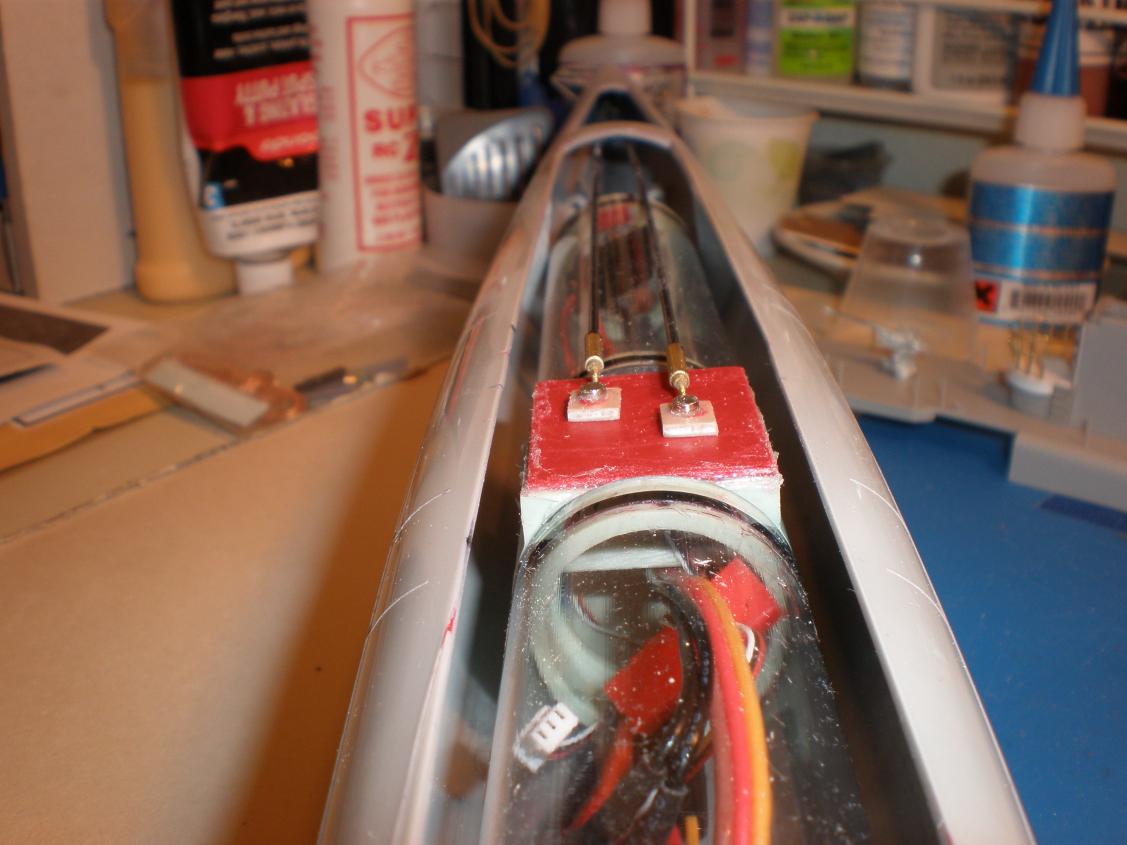

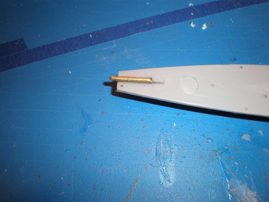

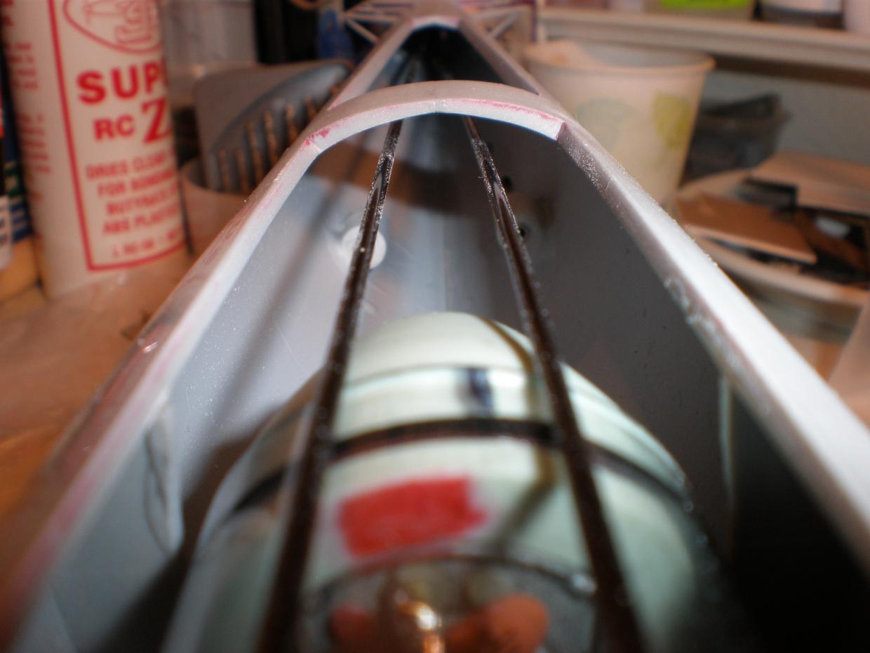

              Carbon fiber pushrods are made up and installed:
ID:	90828Click image for larger version

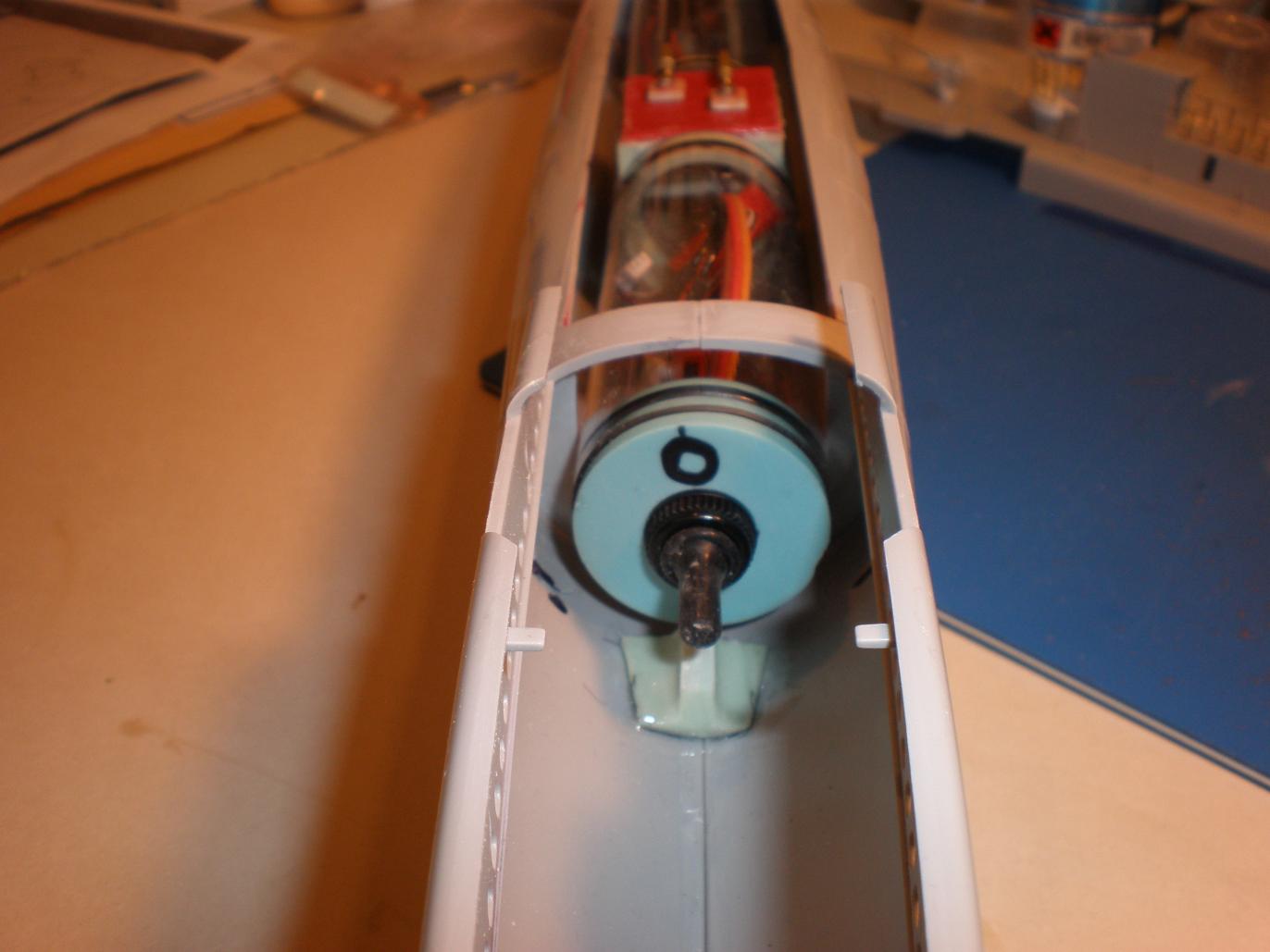

              I went with 1/16" diameter carbon fiber because it can handle a little bending
              with no ill effects, as both of the rods hang over the motor end of the SD. The ends of
              the rods are CA'd into 3/8" lengths of 3/32" o.d. brass tubing about 3/16" deep.
              The magnet holders on top of the servo box, are 1/16" thick styrene with a piece of
              1/32" diameter brass wire CA'd into the ends. They, in turn, have 1/16" o.d brass
              tubing CA'd to them. The whole magnet assembly gets CA'd into the remaining 3/16" of the
              tubing in which the rods were glued. Pretty strong, and hopefully will stay together
              for a long time to come!!
              This last shot is showing the inside of the hull, which also got assembled today. The hull halves were
              "tacked" with thin CA, and after setting up, the inside seam of the hull was given a heavy coat of
              epoxy.
              That's the "on-off" switch end of the SD!(duh)
              Will be fitting the deck to the hull tomorrow and rigging up some small "Gaussboys" magnets
              to keep it in place!
              All for now!!
              crazygary, out!

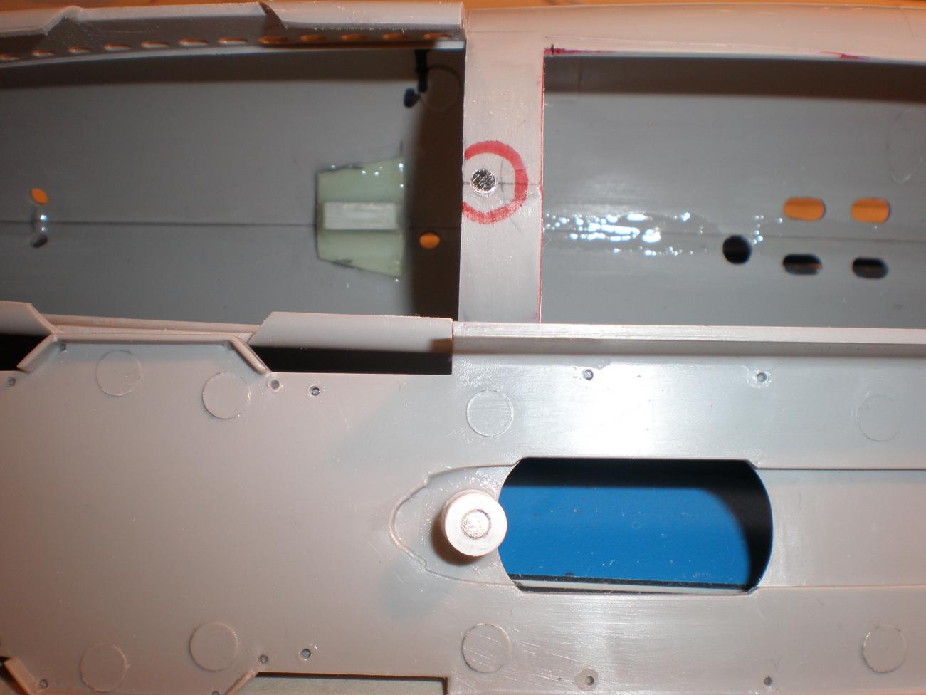

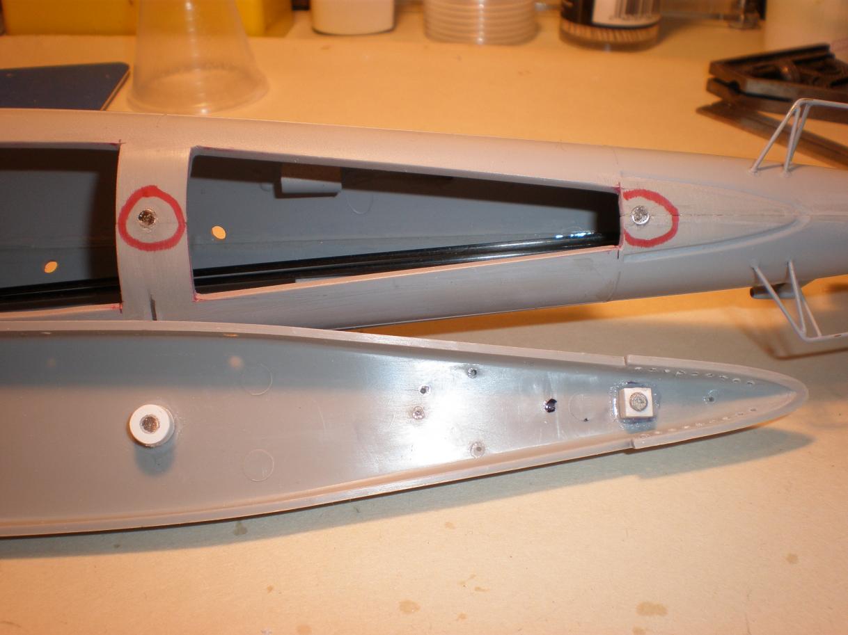

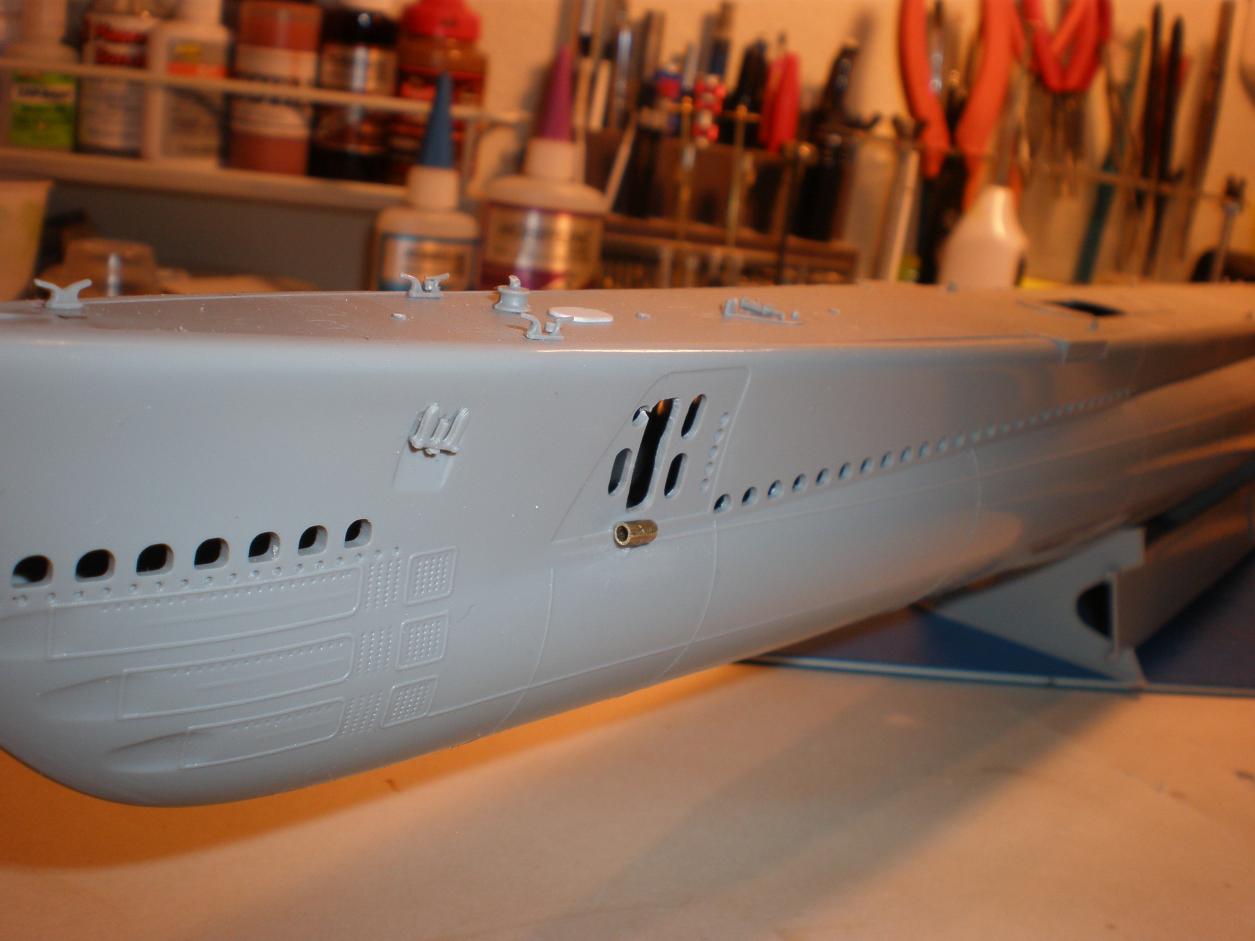

                      Got the deck secured to the hull, thanks to those great little "butt kickin'" magnets from Gaussboys!!
                      A couple pix of the results:
ID:	90867Click image for larger version
                      A few bits of styrene and a little CA did her up nicely!
                      The 2 "straps" are backed up with .020" styrene for rigidity purposes as well as to keep the magnets
                      from ever dropping down into the bilge!!

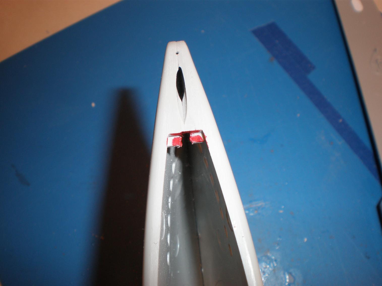

                      The forward most part of the main deck was "awarded" a little 1/16" diameter brass pin to hold her in place:
Name:	fwd deck pin1.jpg
ID:	90869Click image for larger version
Name:	fwd deck1.jpg
ID:	90870Click image for larger version
                      The pin slips under the forward deck into the little cutout, highlighted in red.
                      Not enough room for a magnet up forward, so.....Git 'er done!!
                      Lastly, a few pix showing the fit of the deck with the magnets holding it in place:
Name:	bow deck1.jpg
ID:	90872Click image for larger version
Name:	ctr deck1.jpg
ID:	90873Click image for larger version
Name:	aft deck1.jpg
                      Pretty o.k. for a little 1/144 scooter!!
                      Not sure what's next?? Ahhh!! Maybe deck stanchions (.015" brass wire) Yeah!! That'll work!!
                      crazygary, out!

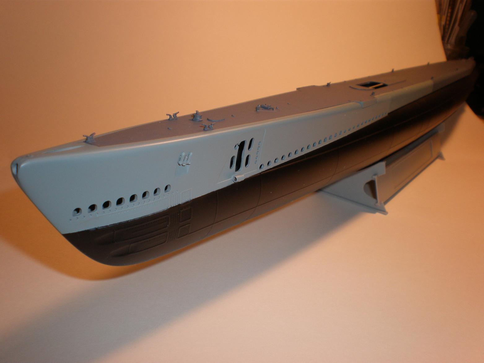

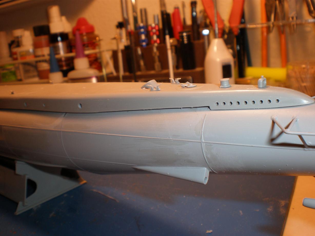

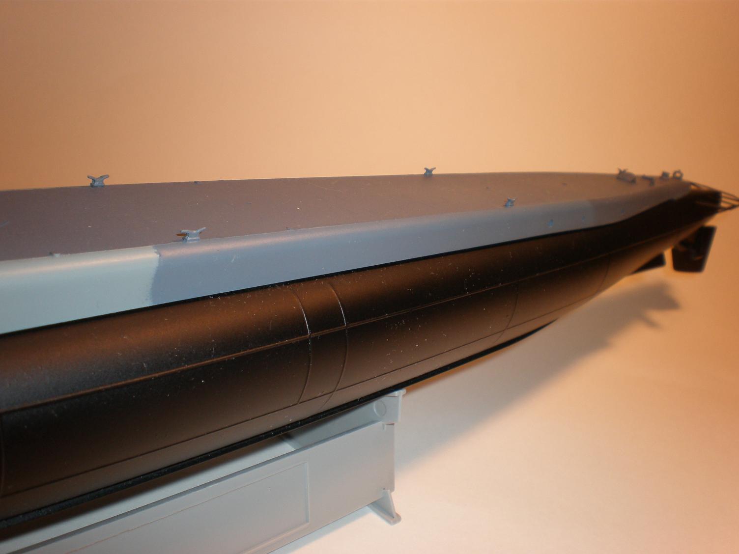

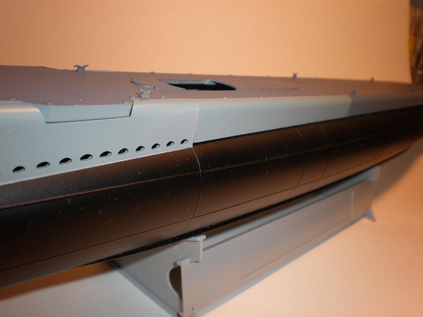

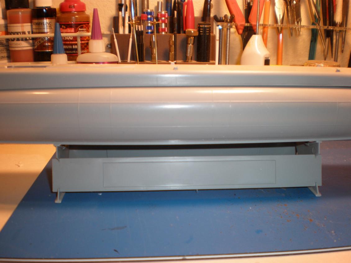

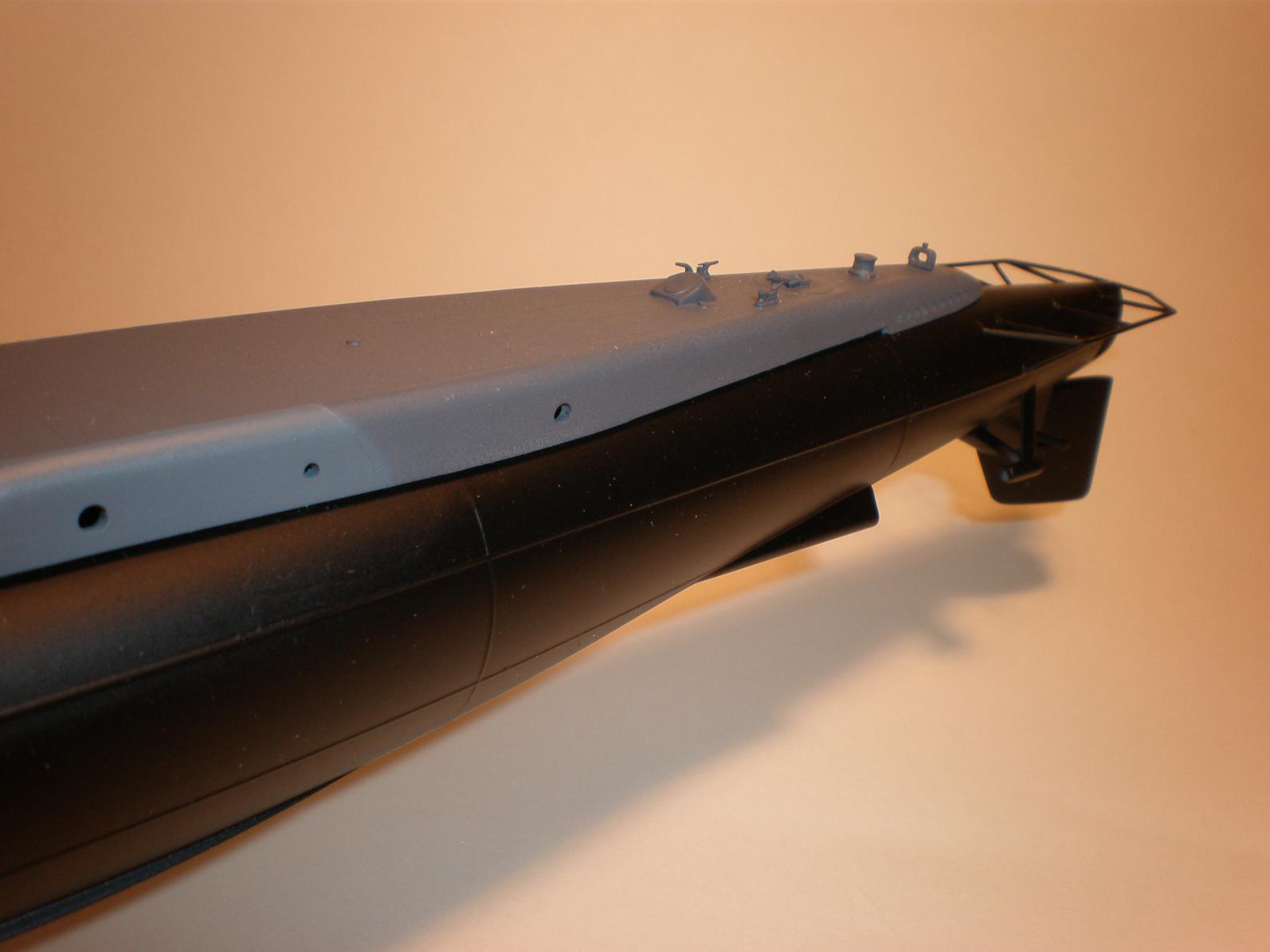

                                Finally able to get back to her for the time being!! Many projects on my plate lately!!
                                Well, her hull is painted and I'm going with the MS32/9SS paint scheme! Pretty "interesting" masking work
                                for this one!! I'm pretty pleased with the way it turned out!!
ID:	91460Click image for larger version
ID:	91461Click image for larger version
ID:	91462Click image for larger version
                                A bit of cleaning-up here and there, then off to the dive planes, the con, and her guns, followed by
                                a coat of matte clear to keep her looking "fresh"!!
