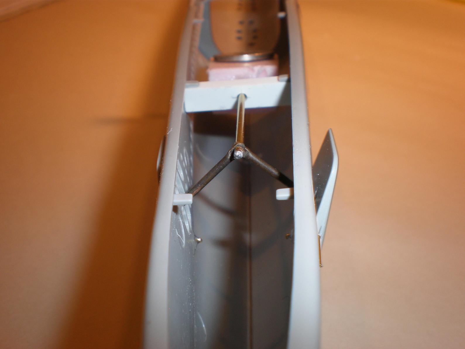

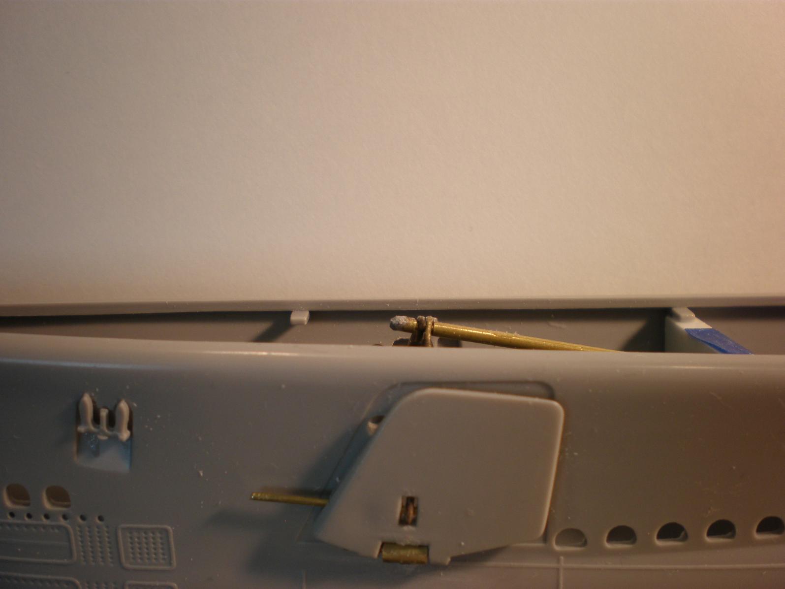

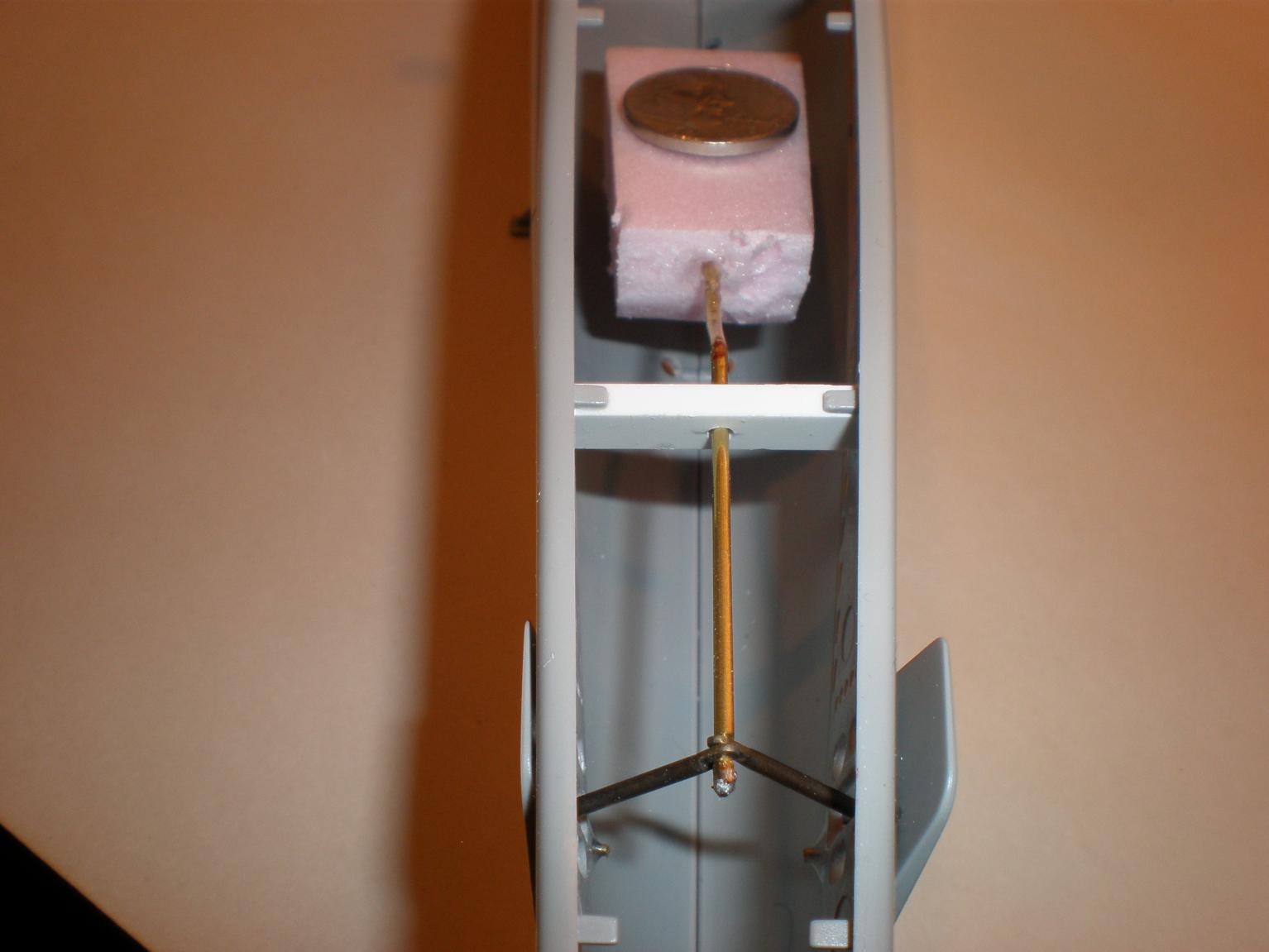

    O.K.! We have forward plane retract float in place.
    I drilled a 3/32" hole in a piece of 1/8" x 1/4" styrene and temporarily anchored it in place.
    In hindsight, I should have drilled it a little smaller, but this will work fine!
    The float itself is a piece of closed cell foam that was leftover from my little Revell 1/230 Skipjacks'
    1 1/4" SD. That's a nickel sitting on top of it for size comparison.
    The float is a little too light to retract the planes, but I'm considering adding a bit of weight to it by
    sticking a penny(?) to the bottom of it with a little silicone, which should help considerably. ( or not??)
    This photo was taken at the bow looking aft.
    As is clearly visible, the port plane doesn't retract all the way against the hull.
    I'll have to shorten the operating arm to correct that. The starboard plane "pegs" before the port side is all the way in.
    Should be a "no-brainer" fix!
    As there's not a whole lot of room in this area (Really?), the planes will still be in "dive mode" when she's at the surface,
    but at least they won't be flapping around like some crazed seabird!! From the outset of the "challenge",
    I was pretty sure that this would be the case! Oh, well!! I gave it a good shot!! Once back on her stand though,
    they'll be folded in all the way! I'll take the little victories as they come!!
    But just the fact that they work at all, in such a small model, got me pretty "stoked"!! The "old fart" here
    still has "it"! (Wonder if antibiotics will clear it up? LOL)
    Next up, I think, will be a shot of primer inside the hull, after a little clean-up sanding! Then I'm "goin' in"!!
    Gonna "bite-the-bullet" and glue the hull halves together! Arrrgh!!! Pray fer me, y'all!!
    That is all!
    crazygary, out!

      That is so slick! Wonderful job. Hey ... I was just kidding, but you made it work. You've got all the linkages so tightly done and hid from view -- you've done everything right so far. You got good hands, pal.

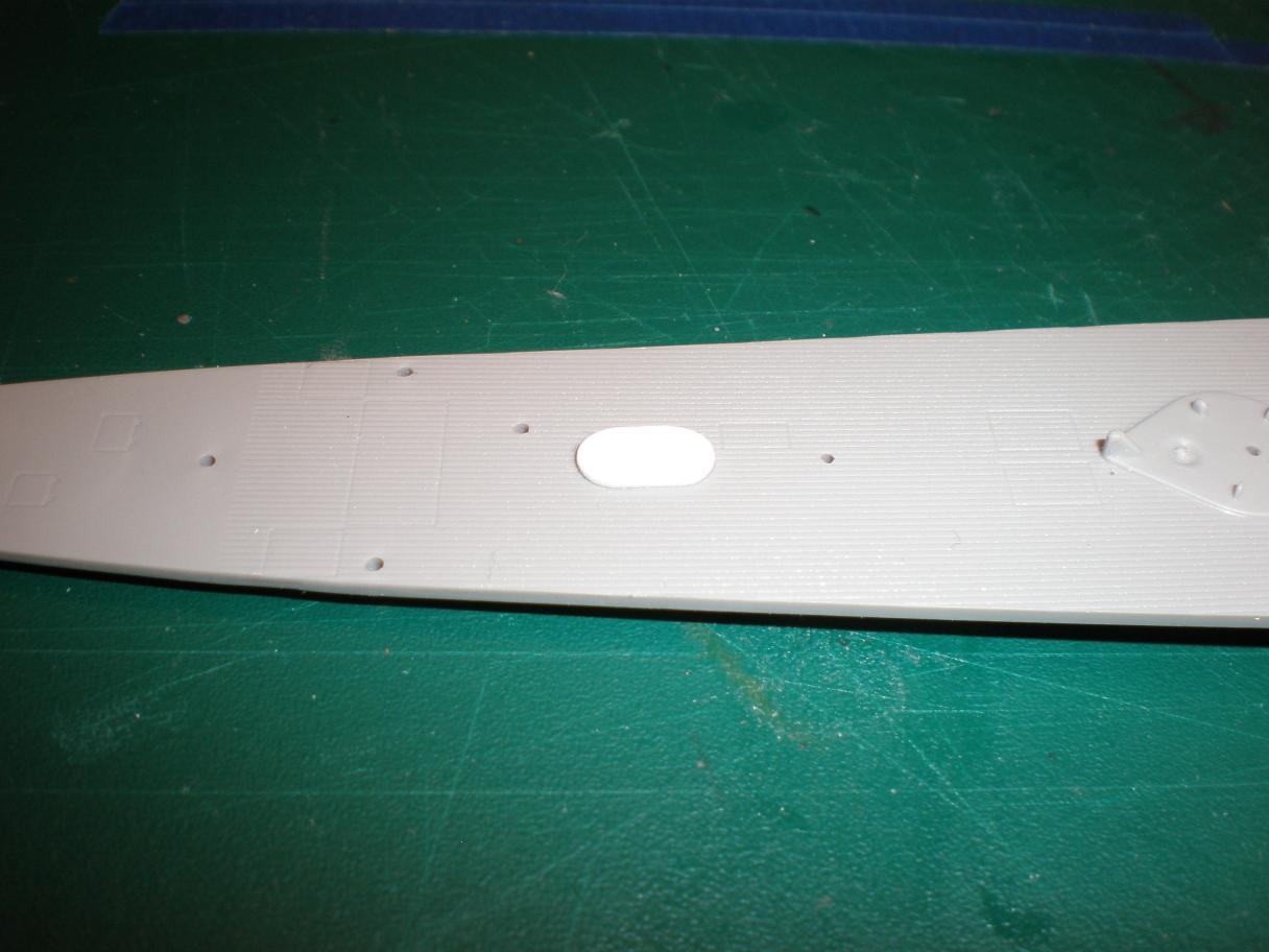

          Happy Sunday, fellow "bubbleheads"!!

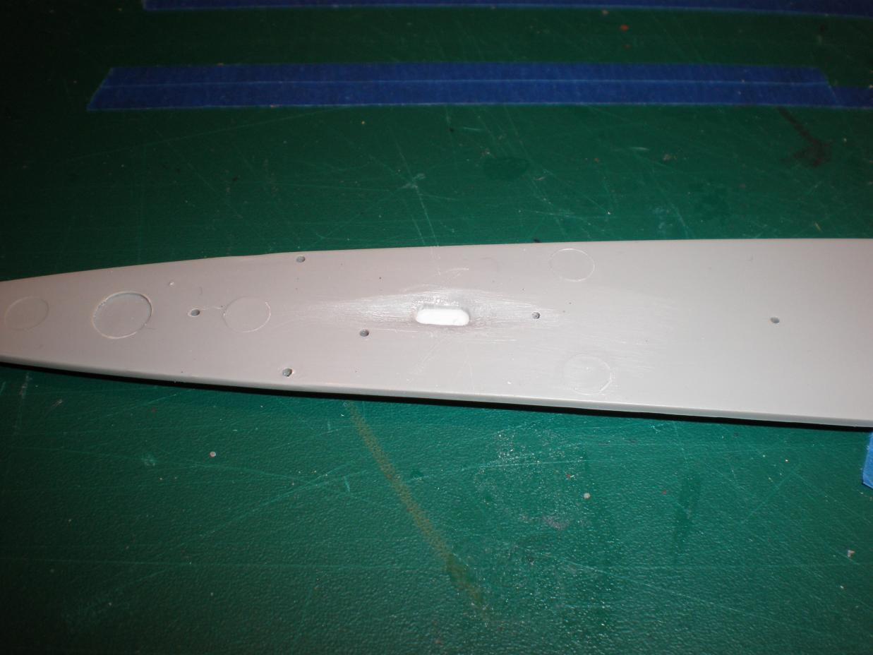

          The reason for the "hole-in-the-deck":
          The linkage sits up just about even with what would be the top of the deck.
          This is looking at the bottom of the deck. The hole through it is about .100" x .200",
          which is enough room for the linkage to sit as it should. I beveled the area around the
          hole with a small file and a little sanding stick for good measure!!

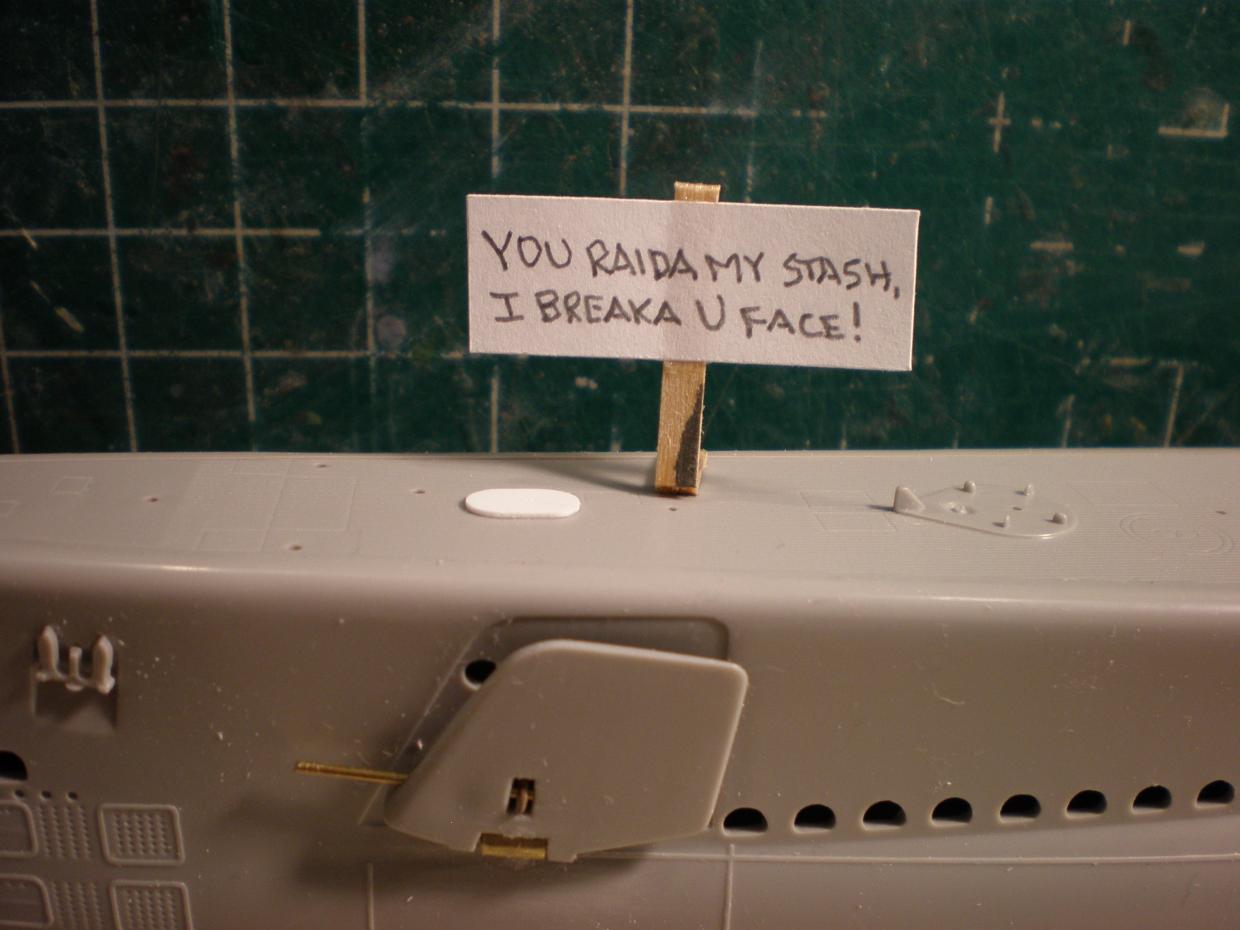

          Here's the top of the deck with the "auxiliary hatch cover" in place!
          It's cut from a piece of .010" thick styrene and measures about .200" x .300", and
          once painted should hardly be visable. This is a good thing, so that maybe Capt. Guidos'
          crew won't be snooping around it and "wondering" what it's there for!!
          In assuring a strict "no-pilfering" policy, our crazy "Eye-talian" skipper has posted a fair warning
          for those who may dare to pursue their curiosity:
          Have a nice-a day!!
          crazygary, out!

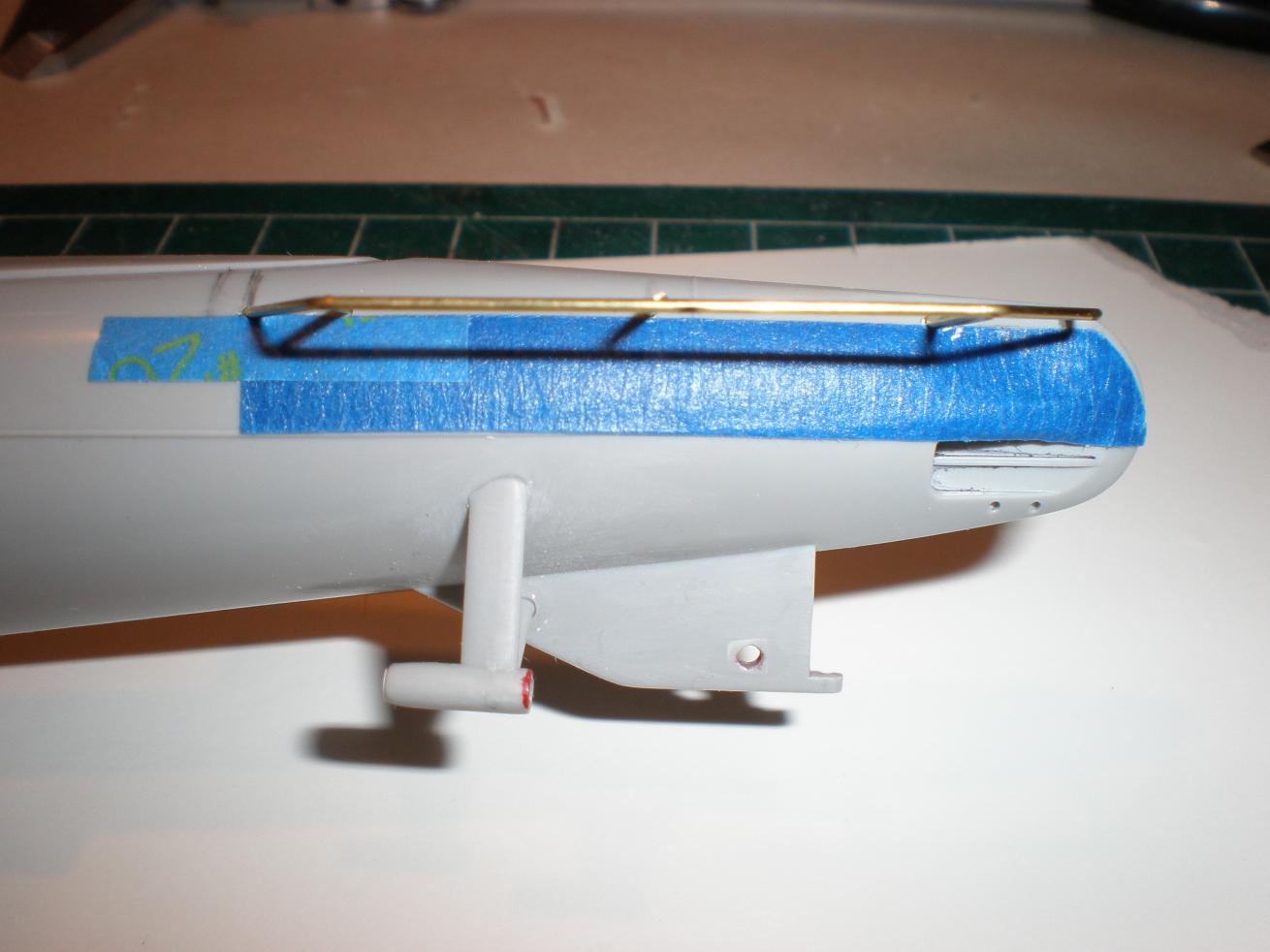

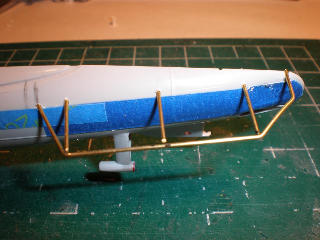

            I made up some prop guards based on photos I downloaded. Bent up some pieces of
            1/32" diameter brass rod to look like this:

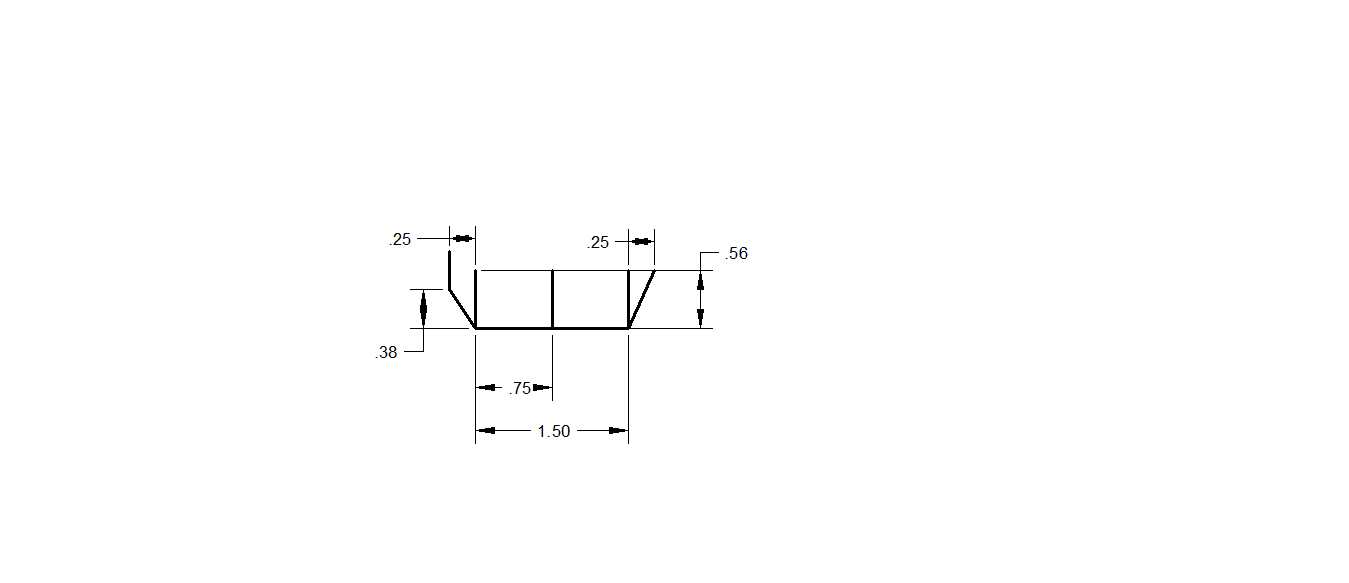

            Here's a dimensioned CAD drawing of what I came up with, which looks to be pretty close
            to what it should be:
Name:	prop guard.jpg
            Oops! Sorry, it's inverted from the real deal photo!! The end with the "compound bend" goes aft!
            This is what it looks like attached to the hull, with the additional stiffeners:
            They're mounted parallel with the molded-in waterline, which is defined by the
            bottom of the masking tape. The guards are 5/16" above the waterline.
            Once my little aluminum heat sinks arrive, the components will be soldered together, and the joints
            cleaned up. Also left to make, and install, will be the angled supports which will tie into
            the cross pieces, and into the hull, to provide structural support to the whole assembly!
            I'm outta here for now! Must observe the fact that "it's five o'clock somewhere"! (Jimmy Buffet fan, here!)
            Y'all have a great evenin'!!
            crazygary, out!

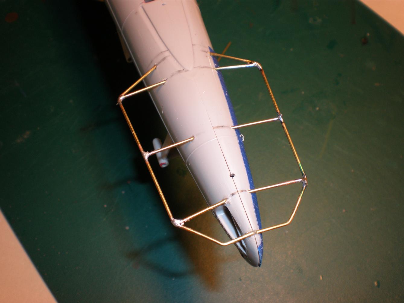

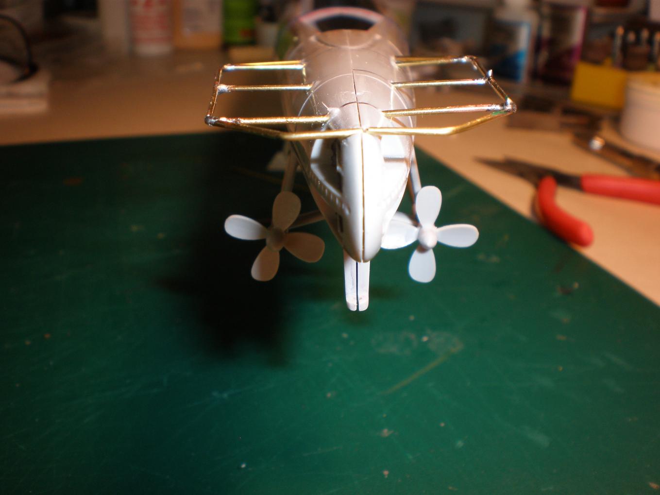

                        Prop guards are soldered and installed! Just finished soldering them,
                        so they're "in-the-rough" right now.
                        I'll clean them up in the morning, and add the angled supports under them
                        and into the hull.
ID:	90356Click image for larger version
                        Look, Ma!! I didn't melt the hell outta the hull!! WOOHOO!!!!!
                        crazygary, out!

                          Well done, sir. You want fillets in there anyway. A little file work, a rub-down with some '000' steel wool and you're good to go.
