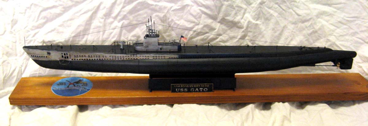

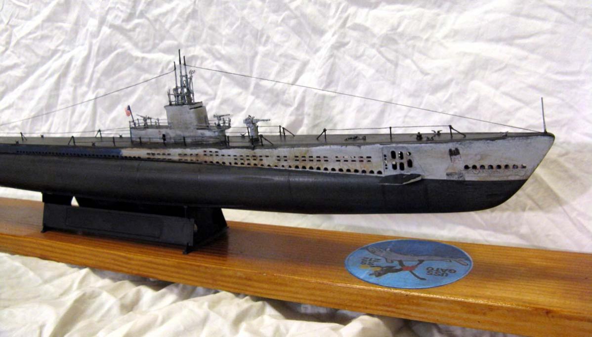

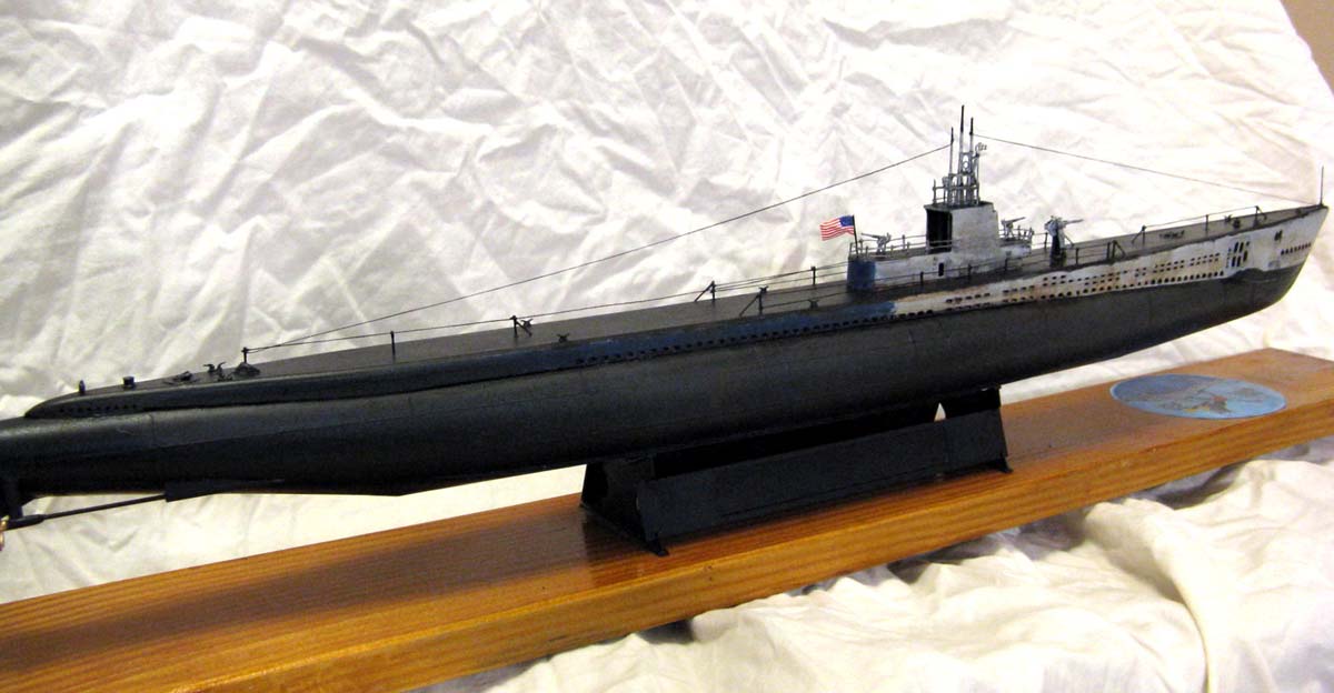

        I stumbled upon these photos on line, on a model builders forum, and are supposed to be
        a late war (1944) paint scheme. MS32/9SS-B, is what it was designated. I kinda like it, a lot!!
        Apparently, shipcamoflage.com says it's correct for 1944.
ID:	90430Click image for larger version
ID:	90431Click image for larger version
        It looks like the light gray on the upper hull goes into a dark blue about even with the aft end of the con, then
        gradually blends to black all the way to the stern??
        Also, the rear of the con, where it radiuses, goes from the light gray to a dark gray?
        Looks like she'd blend in with the ocean, water, and sky pretty well!!
        Gonna go for it!!
        CG

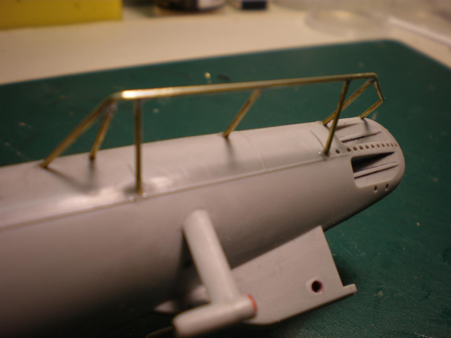

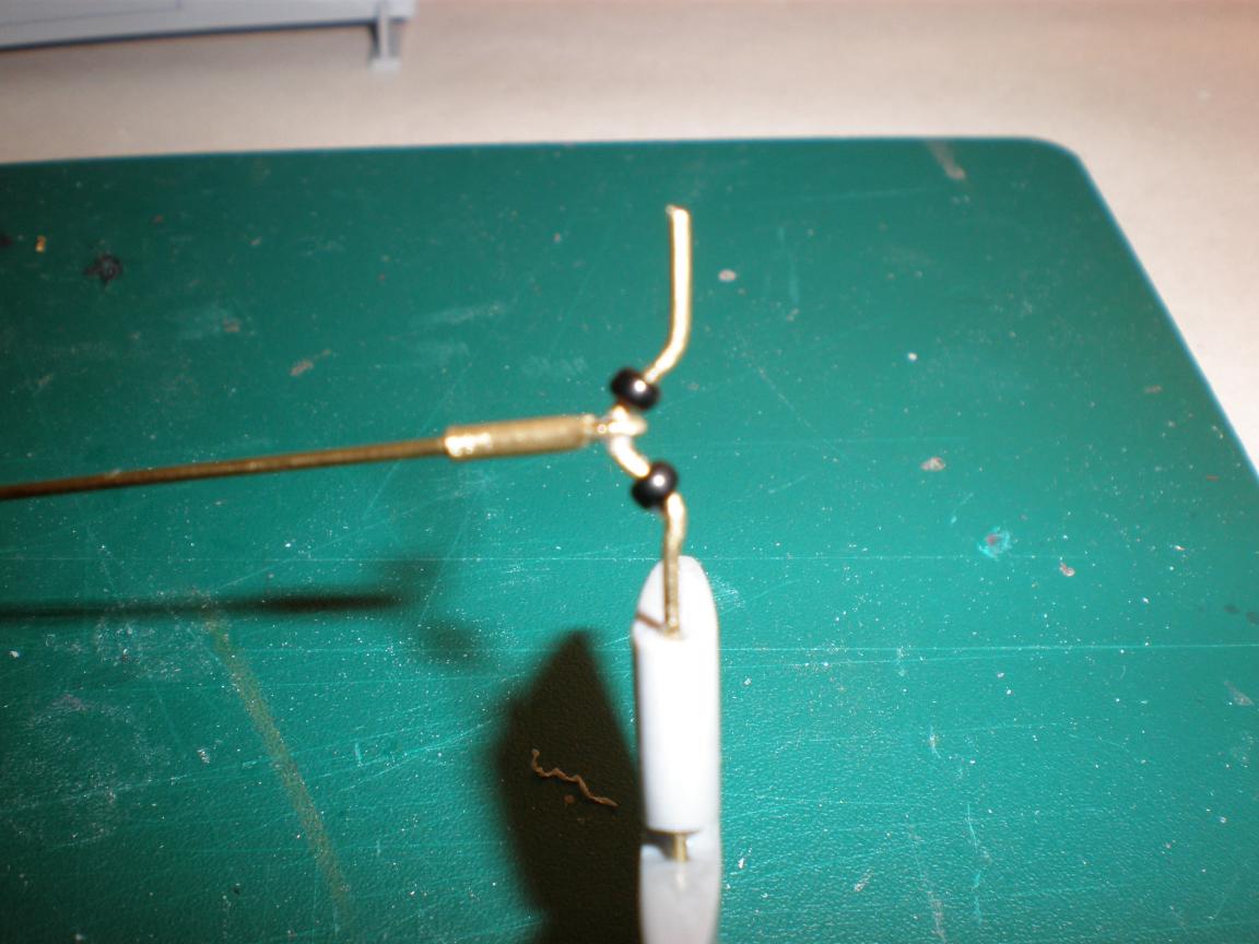

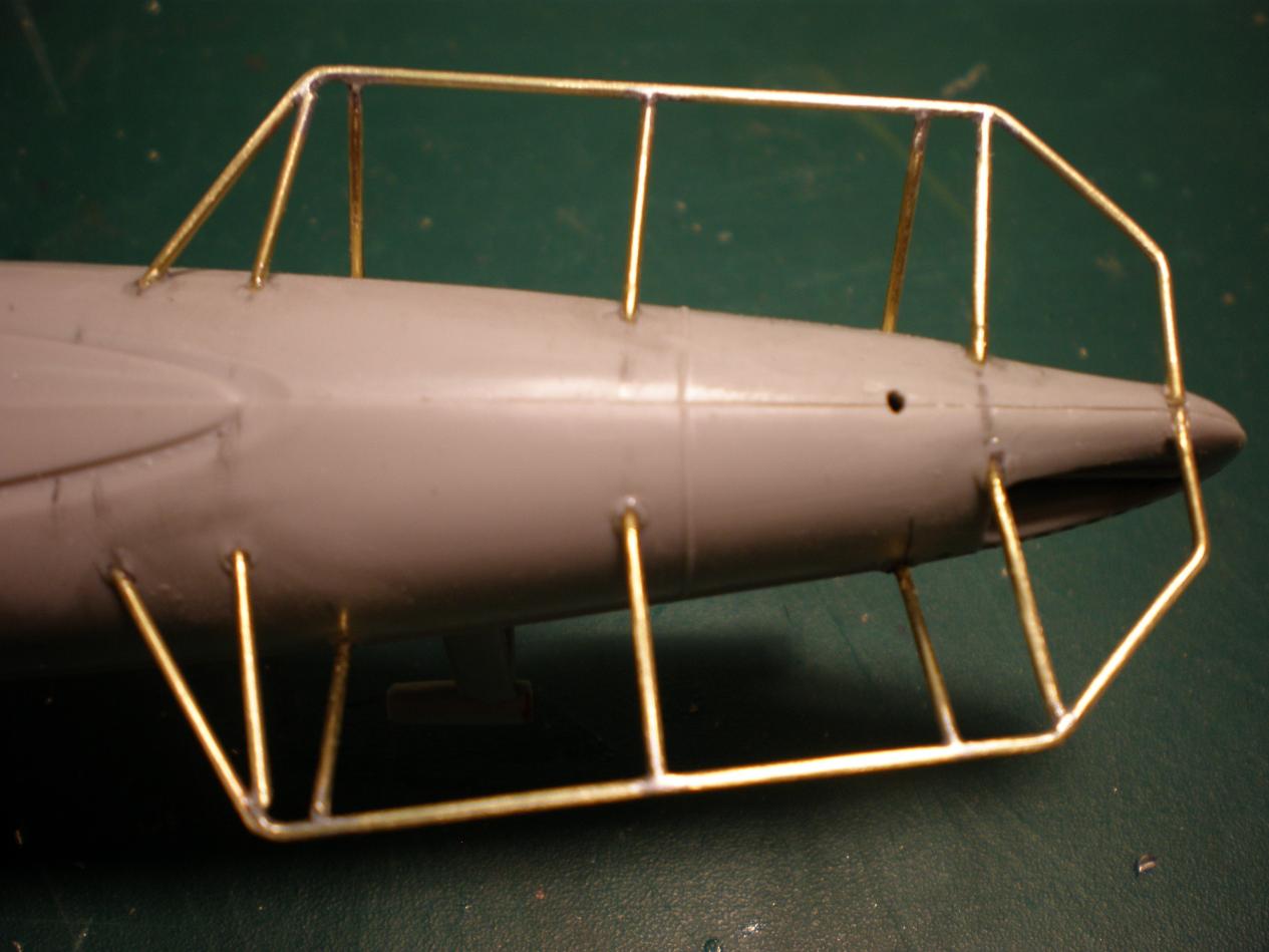

              Prop guards are finished and solder joints cleaned up.
              Just noticed that the forward most upper bars of the guards are not quite mated right!
              I'll build up that little mismatch with a couple of dabs of thick bodied CA, and sand them a bit!
              Also did a little rework on my rudder operator. Made the loop a little bigger to give me more
              rudder angle without "pegging" the linear servo! That's a good thing!!
Name:	new rudder arm.jpg

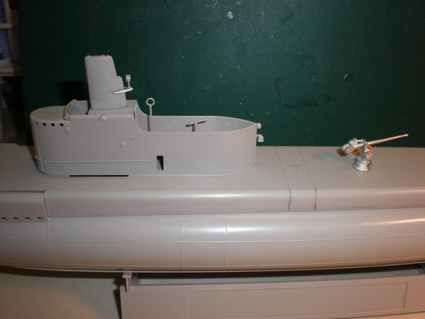

              Nothing anchored down here, but I just had ta have a "visual"!!
              The deck gun is a White Ensign 3" 50, without all the flimsy, P.I.T.A. photo etched foo-foo!! Hah!!

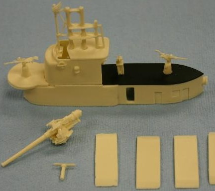

                                #165
                                Just a few progress photos. I decided to go with the USS Thresher conversion.

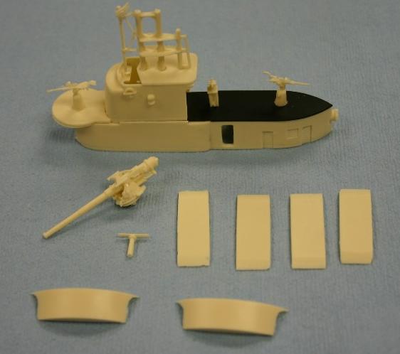

                                This is the $45.00 conversion from Nautilus Models:

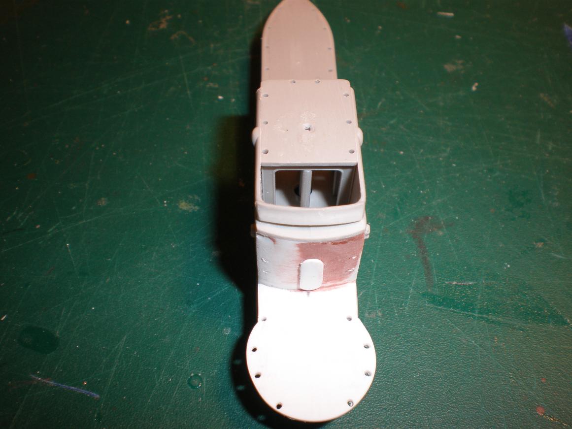

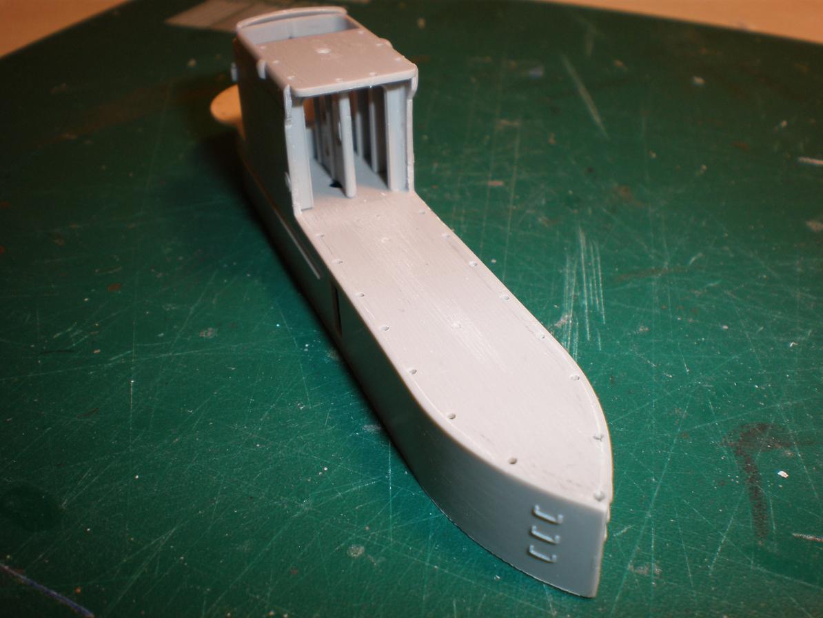

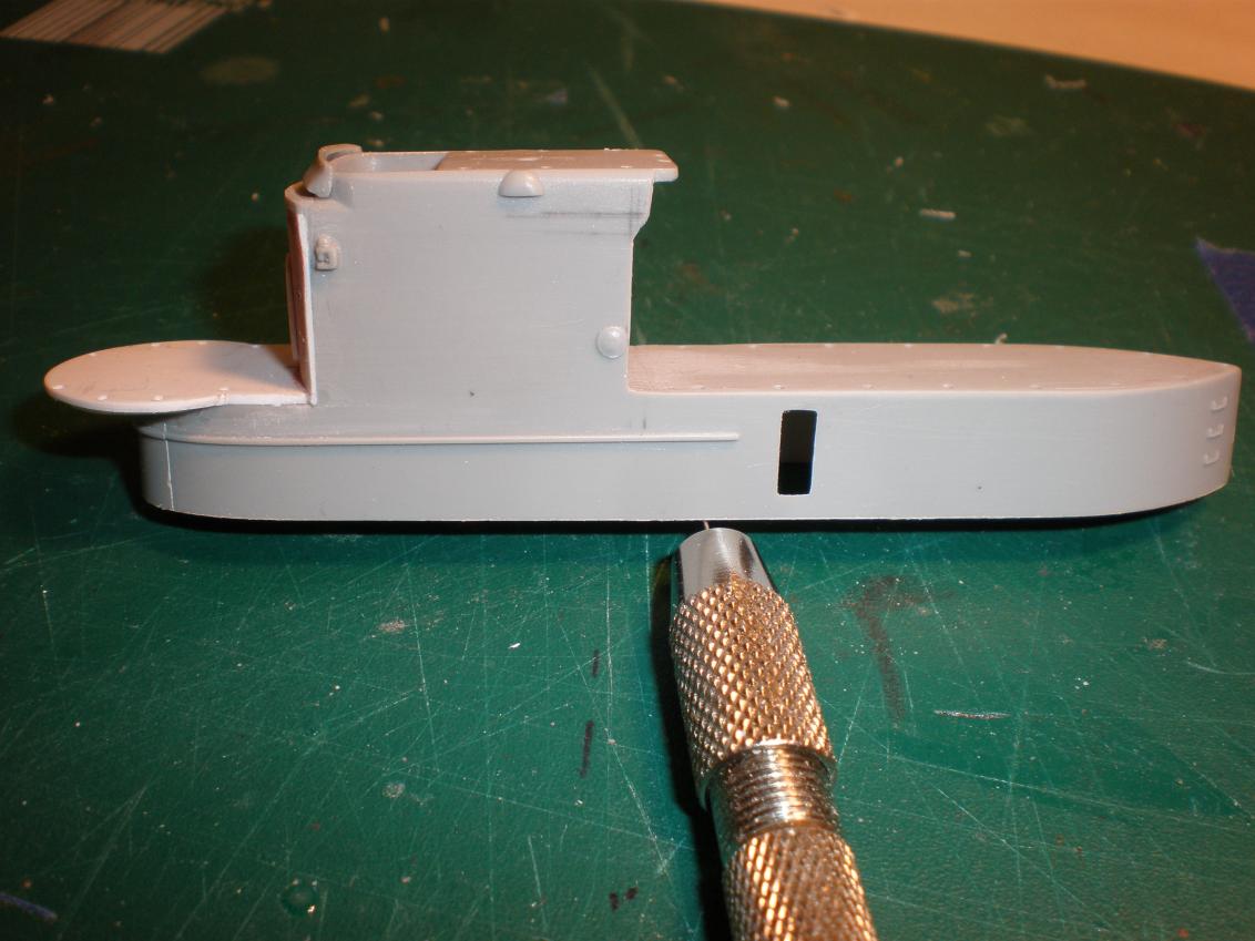

                                This is my "freebie" conversion, so far:
ID:	90466Click image for larger version
ID:	90467Click image for larger version
                                The forward gun platform is .020" thick styrene, as is the platform access hatch. A little hobby saw work, a little filing
                                and a little sanding and thar she be!! Arrrgh!! Still a little filler work left to do!
                                The forward platform will be fitted with a single 40mm. Bofors, and the rear gun platform will have a single 20mm Oerlikon.
                                The main deck gun will be the 3"/50, probably mounted forward of the con.
                                Masts are on order and are the photo-etched set from White Ensign.
                                Not quite sure just what the heck the other "gizmo" is on the rear platform of the Nautilus conversion?????
                                I know one's a gun (duh!), but the tuther'n....Beer cooler?? Vertical microwave?? Johnson rod support??
                                Any clues would be appreciated!!
