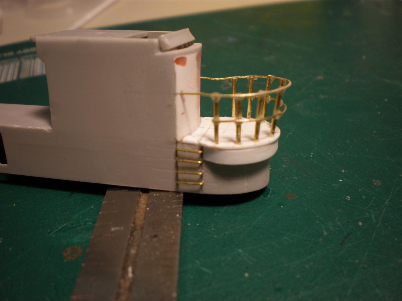

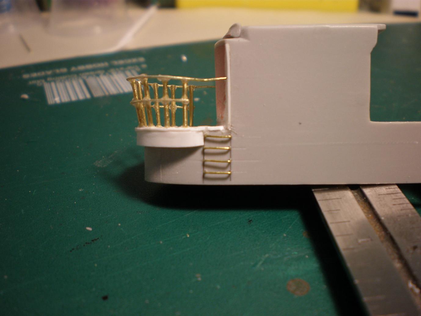

      A couple photos of the forward gun deck on the con:
ID:	90525Click image for larger version
      The stanchions are .032" diameter brass wire, and the railings are .016" brass wire,
      as are the ladders on both sides of the con.
      The railings are attached with CA adhesive and once set up well, will be cleaned of
      all the "goobers" at the joints!
      Still need to put an access hatch to the gun deck from the con. Will probably make that from .020" styrene, with hinges
      and latch made from .016" brass wire!
      Y'all have a nice, relaxing Sunday evenin' now, ya hear!!

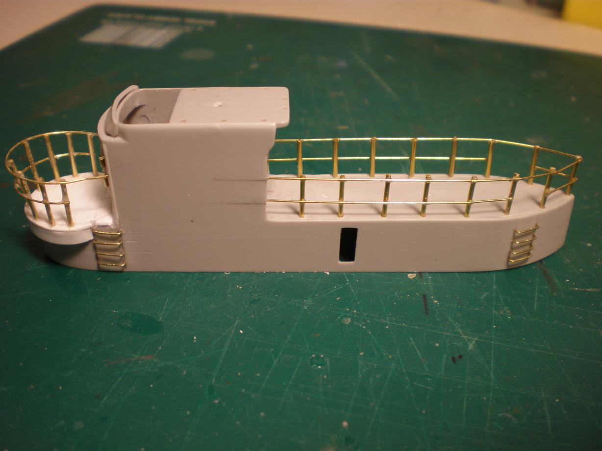

          Railing and ladder detailing is finished! CA is doing the job pretty nicely! Paint should help tighten up the joints.
Name:	con railings.jpg
          Slow going here lately, as I'm waiting for ordered goodies to arrive! (Still waiting!)
          Need carbon fiber rod for control surface pushrods, so I can glue the hull halves together!
          Once I can get that done, things should pick up pretty briskly!!
          Photo etched brass radar and mast assembly is "out there" somewhere! May even be on the way??
          While waiting (Still!! Hah!!) I can add details to the main deck.
          i.e.- hatches, bollards, etc.
          Oh, yeah!! Gotta make up some watertight doors to cover up the "doorways" on the
          sides of the con! Can't imagine why it was molded this way!?
          All for now, sports fans!!
          crazygary, out!

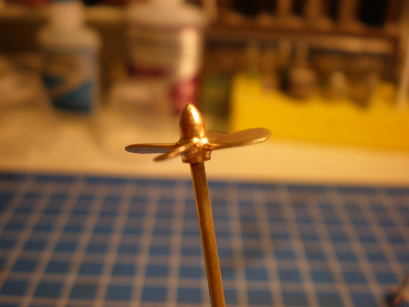

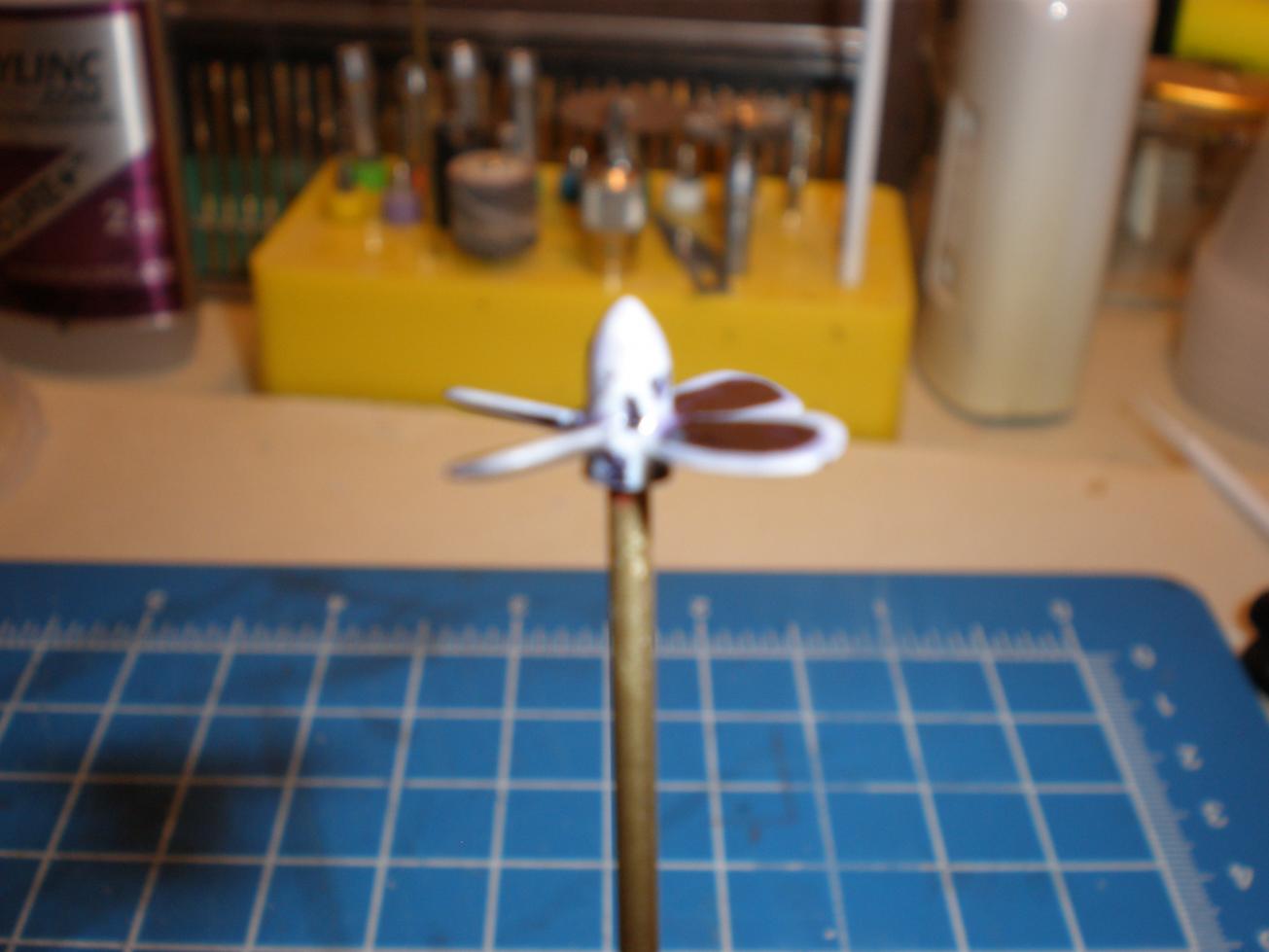

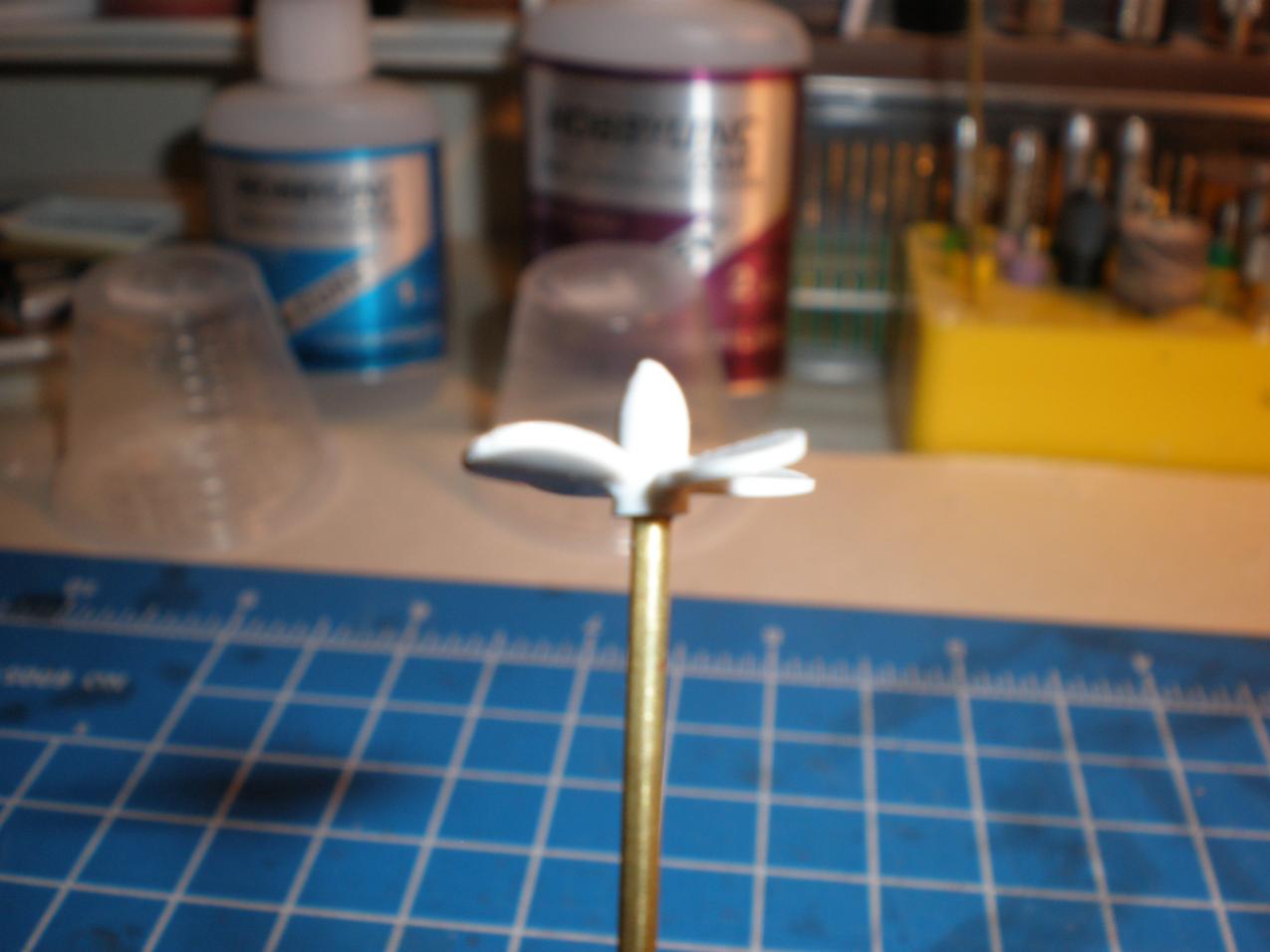

                          The kits' molded props are "ca-ca"!!
                          They will require a little rework so that they can effectively
                          "bite-and-spit" water!!
                          Here's one right from the sprue:
                          Notice the "flat" around the entire perimeter of the blades! Not good!!
                          Here's the same prop after a bit of "massaging":
                          Oops! Sorry about the focus, or lack thereof!!
                          The edges, all around, were tapered so as form a bit of a "knife edge"!
                          Should be quite a bit more efficienter!! Yep! E-fish-en-ter! You heard it here!! (LOL)
                          Same prop, different color:
                          Mo' bettah!!!
                          Back to "da bench"!!
