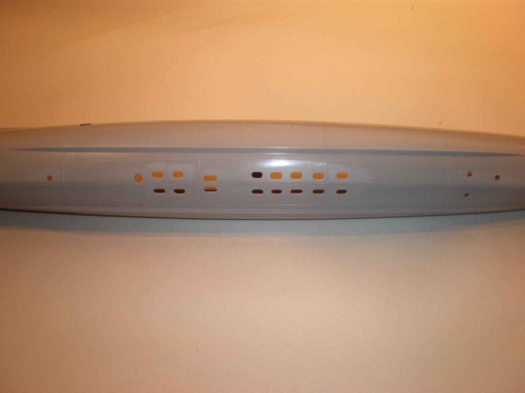

                  O.M.G!
                  Somebody shoot me if I ever decide to scab in a bunch of limber holes in anything smaller than 1/72 scale!!
                  The "bigger" (notice the quotation marks!) holes are about 5/32" x 1/4". I did the pin vise "thing" also.
                  No power tools were abused or otherwise harmed during this operation! (Gratuitous insertion for the "friends-of-the-power-tools" coalition!!)
                  Piloted them first with a 1/16" drill bit, and followed that up with a 1/8". Close enough to 5/32 for me!
                  Put a little "mileage" on my pin vise corps!! Hah!!
                  Looks pretty good, too!!
                  Next up will be to do something with the internal bulkheads so that the 1 1/4" SD will sit in there nicely.
                  Will do that in the morning, and post photos and witty commentary, as I'm off to a VFW meeting shortly!
                  Being Post Commander sometimes has it's drawbacks!!
                  crazygary, out! ( Of my mind???)
                  • crazygary
                    • Sep 2012
                    • 610
                    Houston, we have flood holes!!
Name:	hull drains.jpg
                    After inventorying my remaining and "still-vibrantly-active" brain cells, I chose not to pursue the opening of
                    all the really small limber holes, as 67 years of excellent eyesight is no longer the case, and rather than do
                    a "munch" job, I decided to pass on them!! (Good call!)
                    Today I'll be "massaging" the molded in "pressure hull" cradles so my 1 1/4" SD will nestle in them with a bit
                    of a snug fit. Am also contemplating adding some limber holes to the outer edges of the deck. Notice that
                    I said, "contemplating"!! Hah!!
                    My Gato will be built as a dynamic diver, which will mean that the molded-in aft dive planes will have to be
                    "reworked" so as to become functional. I may end up having to cast some out of resin, but the Jury's still out on that!
                    It will depend mostly on my ability to successfully cut the molded in planes from the stern of the sub, without
                    doing a "hack job" on them! (Film at eleven!!)
                    Back later with success or failure! I'll post the end results, whatever they may be!
                    crazygary, out!
