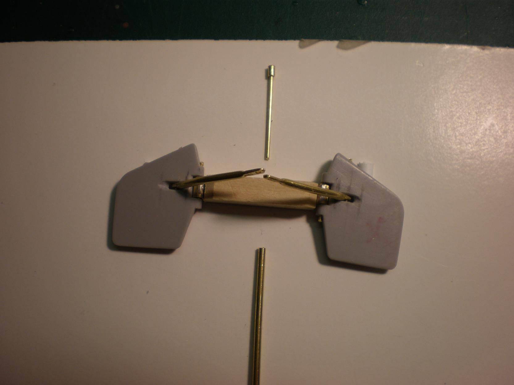

                                Anyway, I did little tweaking on the previously added control arms on the forward planes.
                                Shortened them, "coined" the ends, and bent them so they'd meet up in the middle of the sub.
                                Also drilled 1/32" diameter holes in the ends to accept a 1/32" diameter pin.
                                They're currently mounted to a piece of basswood to hold them steady while I piddle around with them.
                                Then took a really short length of 1/16" i.d. brass tubing, 'bout 13/32" long, and CA'd it to the end of the 1/32" wire. This will
                                be the "pivot operating gizmo control arm retainer thingy"!! ( for lack of a better grouping of words!) It's at the top of the photo, above the dive planes.

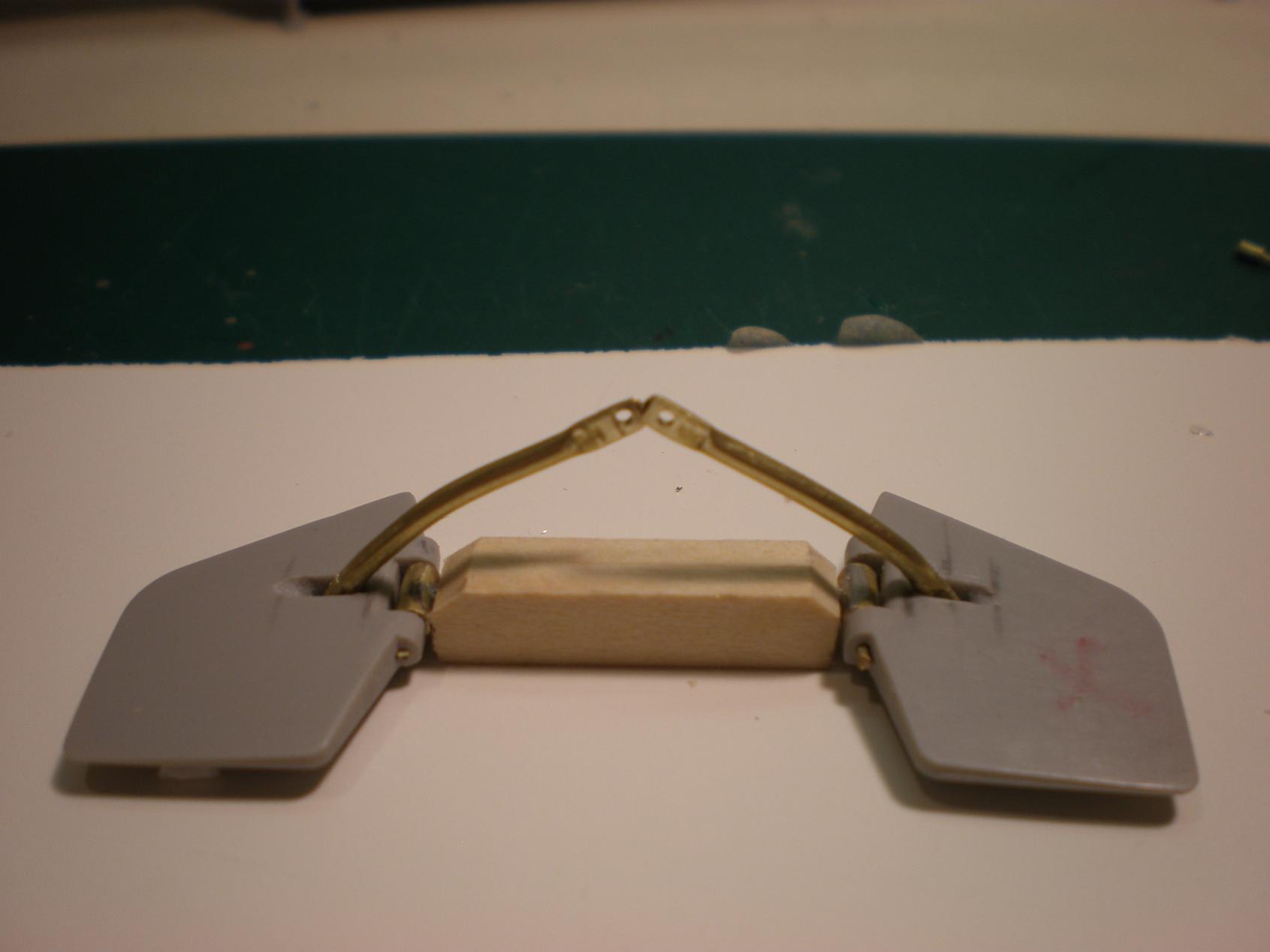

                                Below the dive planes is what will become the fulcrum which will, if all goes according to plan, make the
                                whole enchilada function.

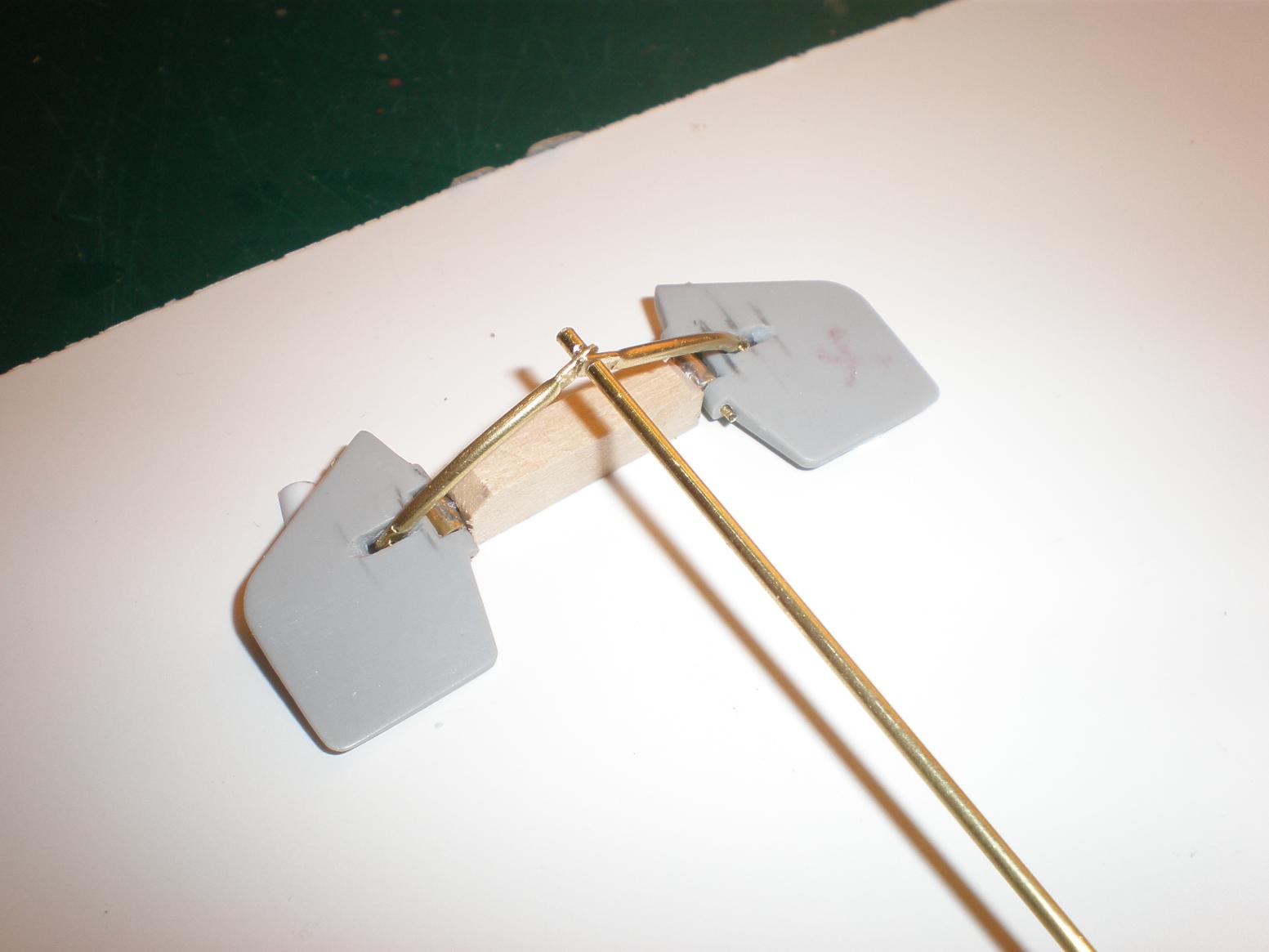

                                Here's the assembly!! Pivot point to be decided upon after fiddling with it a little more!
                                Might could be able to wrap up this portion of the build tomorrow???
