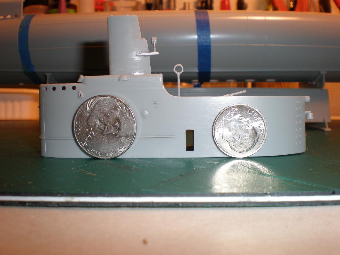

        O.K., guys! Here's the "stark reality check"!
        "Kinda" tight quarters in this little guy!

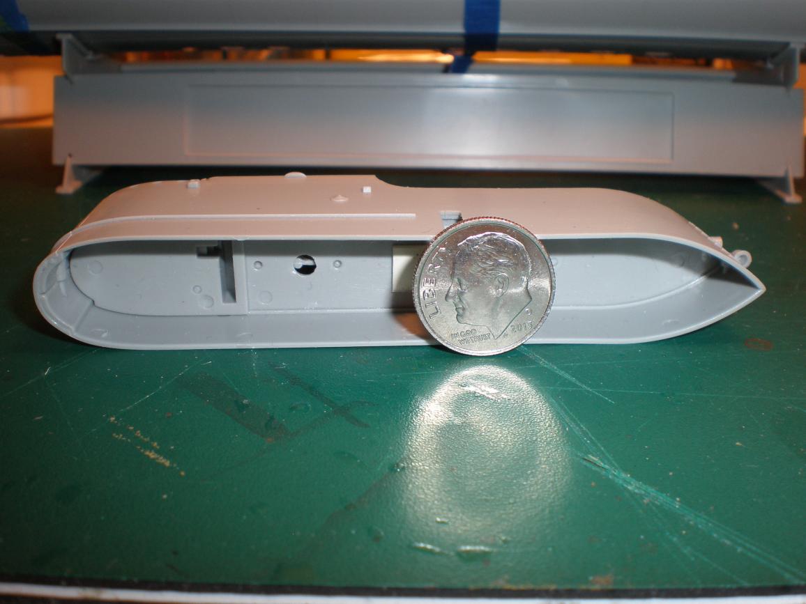

        Here's the "con"! Looks fairly good sized, no??
        Here's the con with a nickel, and a dime for size comparisons...
ID:	90146Click image for larger version
ID:	90147 Say, what????

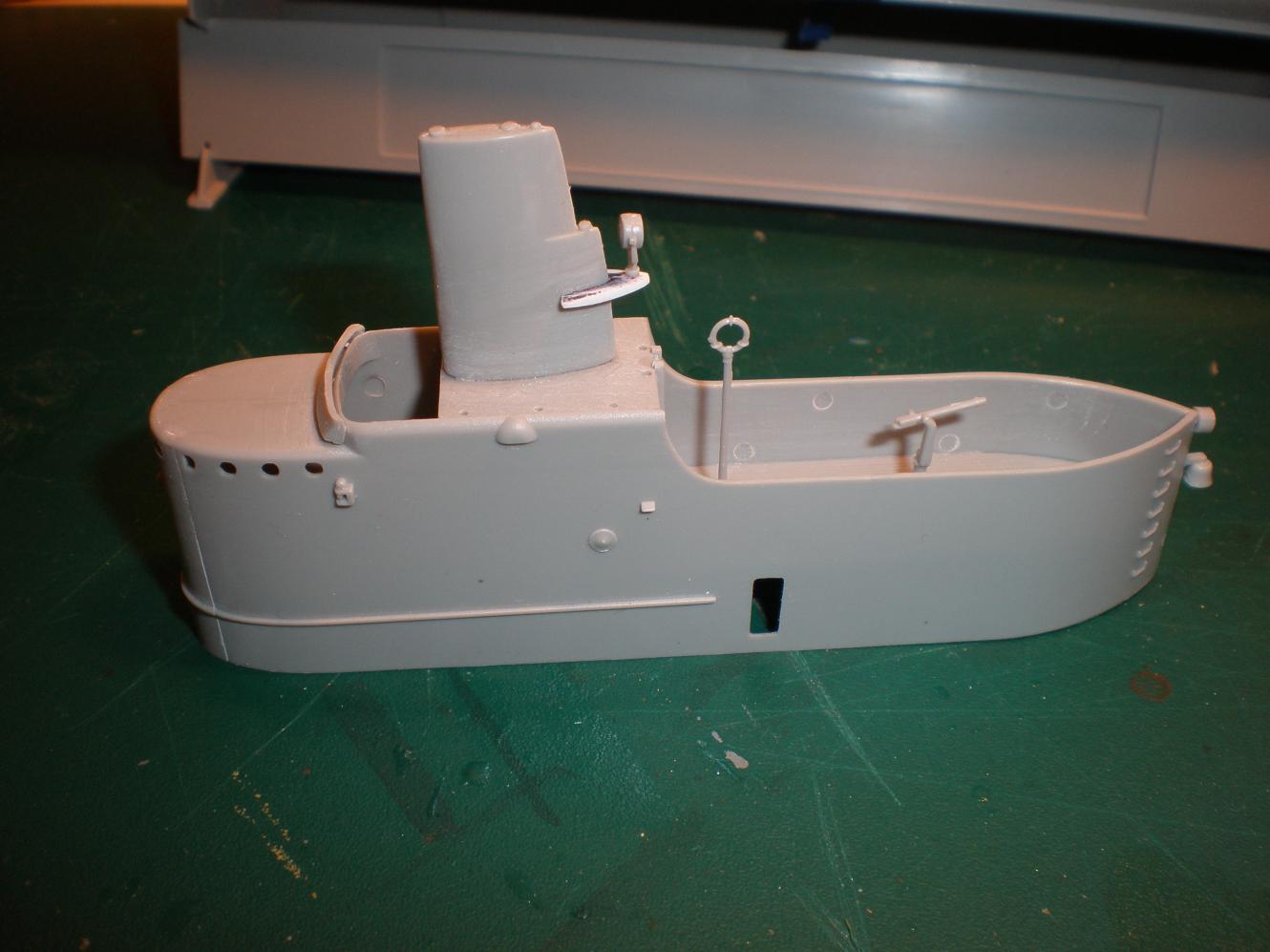

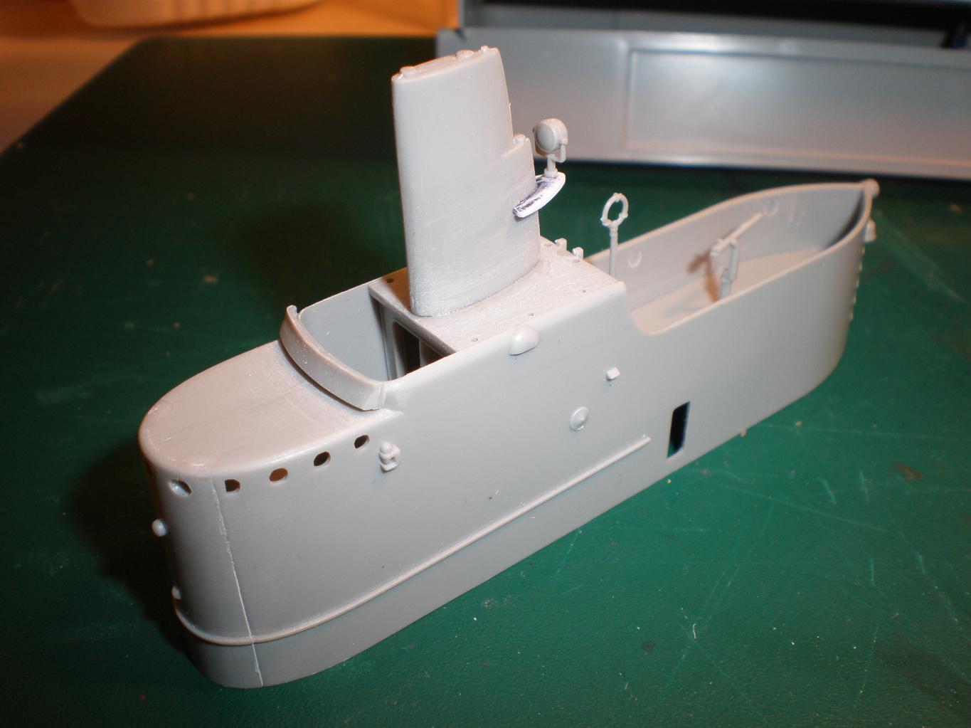

        Here's the con on her side with a dime...
        Therein lies the "problem"! No "sail"!!!
        Overall length of the con, from the rounded forward end to the pointed aft end is 3.75". (3 3/4")
        Inside width, side-to-side, is .531"! (17/32")
        Available height from the bottom of the con to the bottom of the "platform" is .375"! (3/8")
        Welcome to my "little" world!! (LOL)
        But, please do keep the suggestions coming! One of them is bound to be of help to me!!
        crazygary, out!

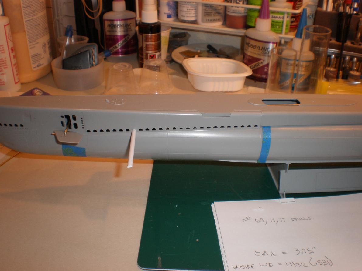

                A few more constraints I'm dealing with!
                The distance from the centerline of the planes to the centerline of the cutout in the deck below the con is 6.50".
                The deck cutout measures 1.187" x .562".
                From where I would guess her surfaced waterline should be, which is right where the deck rolls over
                on to the hull (?), where the blue tape disappears, up to the bottom of the con "platform", once installed, is .875".
                Another limiting factor is that in order for the float arm to raise enough to push down on the linkages to deploy the planes,
                the float rod length becomes an issue. The shorter I make it, the more rise it will need in order to deploy the planes.
                Too short and they won't deploy all the way, too long and it's less retract!
                I'll tinker with her and do what I have room for, and just live with the outcome!
                Again, a bigger sub would have been easier to deal with, but I digress!! Hah!!
                I'd rather be dealing with these kinds of "issues" than have to make "Y" turns in the pool
                to get her back to me!!
                crazygary, out!

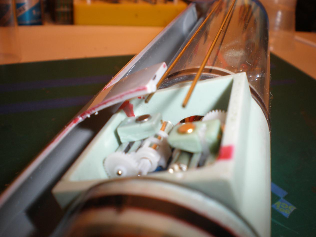

                    Back to the "drawing board"!! The SD "saddles" will have to be dropped so that the SD sits on the bottom of the hull as the Gatos'
                    prop shafts are somewhat lower than the centerline of the SD. Also, the centers of the 2-prop setup on the 1 1/4" SD
                    are roughly 5/16", or so, and the prop shaft centerlines are a tad over 13/16". "Houston...we have a problem"!
                    Will have to wait and see if aquarium tubing "drive shafts" will handle the mismatch. If not, I'll have to look into doing something
                    creative with gears. I'll also want to epoxy in some homemade stuffing tubes to aid in keeping the shafts from stressing out,
                    as I may be doing!!?? (LOL) And to that I say: One tequila, 2 tequila, 3 tequila, floor!!! Gotta love that cactus juice!!
                    crazygary, down but certainly not out!! (Yet!!)
                    " Film at eleven!"
                    • crazygary
                      • Sep 2012
                      • 610
                      #130

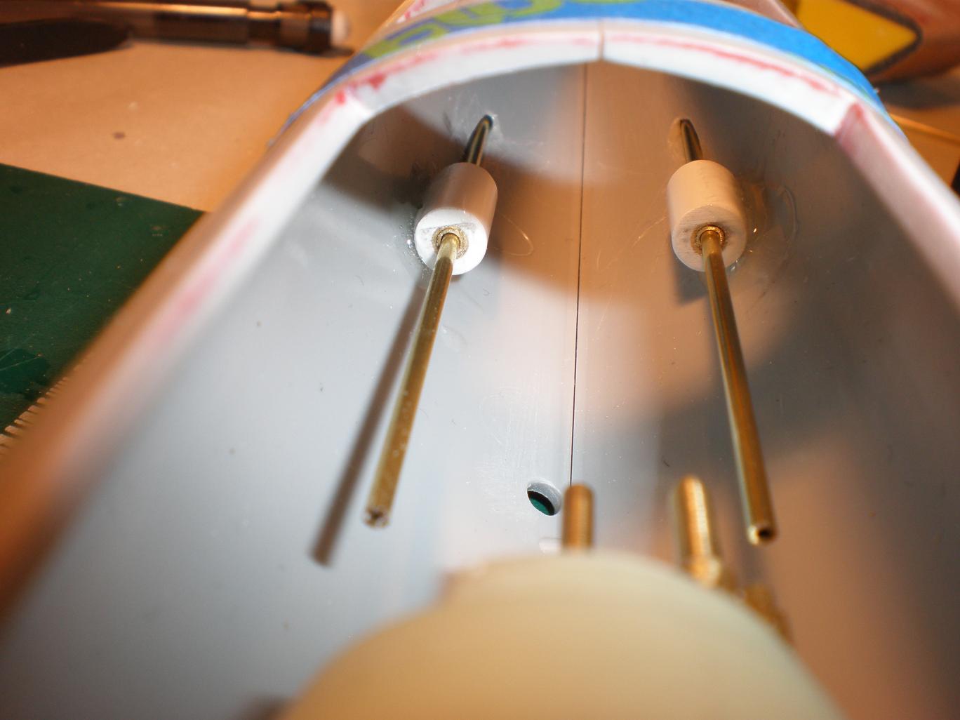

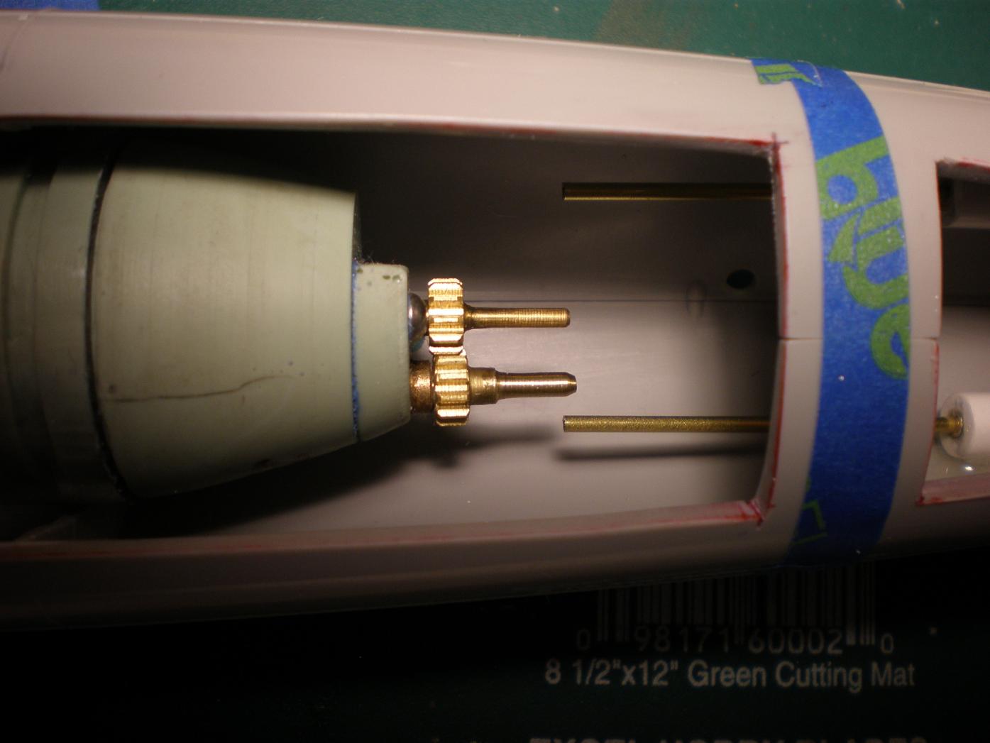

                      Managed to come up with, what I hope is a viable solution to the prop shaft
                      mismatch "problem" I mentioned in my last post.
                      The 1 1/4" SD has a drive on the centerline, as well as an extra drive capability
                      for a 2-prop setup. The mismatch looks to be more than a piece of vinyl tubing
                      will be happy with, without putting way too much side pressure between the prop shaft
                      and the inside of the hull.
                      I made up a couple of supports, with "bearing" surfaces which should eliminate the problem.
                      They're short lengths of 1/4" diameter styrene with an 1/8" core. These are about 7/16" long.
                      I inserted 3/8" long pieces of 1/8" o.d. brass tubing flush with one end, then inserted 3/32" tubing,
                      of the same length, into the 3/32" diameter i.d. of the first piece of tubing! Why 2 pieces??
                      Because that's what I had on hand, and, I don't think you can find 1/8" tubing with a 1/16" bore!?
                      As my propshafts will be made from 1/16" o.d. brass tubing, this was a "no-brainer"!
                      I then beveled the ends of the styrene supports to "match" the angle between the prop shafts and insides of the hull,
                      and secured them to the hull with thick bodied CA. This was accomplished with the prop shafts fully inserted from the external
                      struts through the hull, and then through the supports.
                      Most commercially available u-joints and/or dogbone couplings were too big for my needs, so,
                      into my model railroading "junk box" I went, and found some of these, which will work like a champ:
                      Of course, the ones that I have are too big, so these are on order!
                      They will allow coupling between 1/16" diameter shafts of any length. They're made from acetyl (delrin, if you will)
                      and have very little weight to them, but plenty of strength.
                      The "cups" are about 7/32" diameter and have a 1/16" bore. It's been my experience with these that the bores
                      will provide a bit of a "press" fit with the shaft, so no need to glue them.
                      The "wingnut shaped" parts are the other component of the drives. You pick the length
                      of shaft you need, glue the little "wingnut" shaped pieces to the ends, and there ye be!! Instant couplings!!
                      These are available through North West Short Line, and come in many different size configurations!
                      Absolutely no affiliation, other than being a long-time satisfied customer!
                      That is all....
                      You will now be returned to your regularly scheduled programming!! Hah!!
                      crazygary, out!

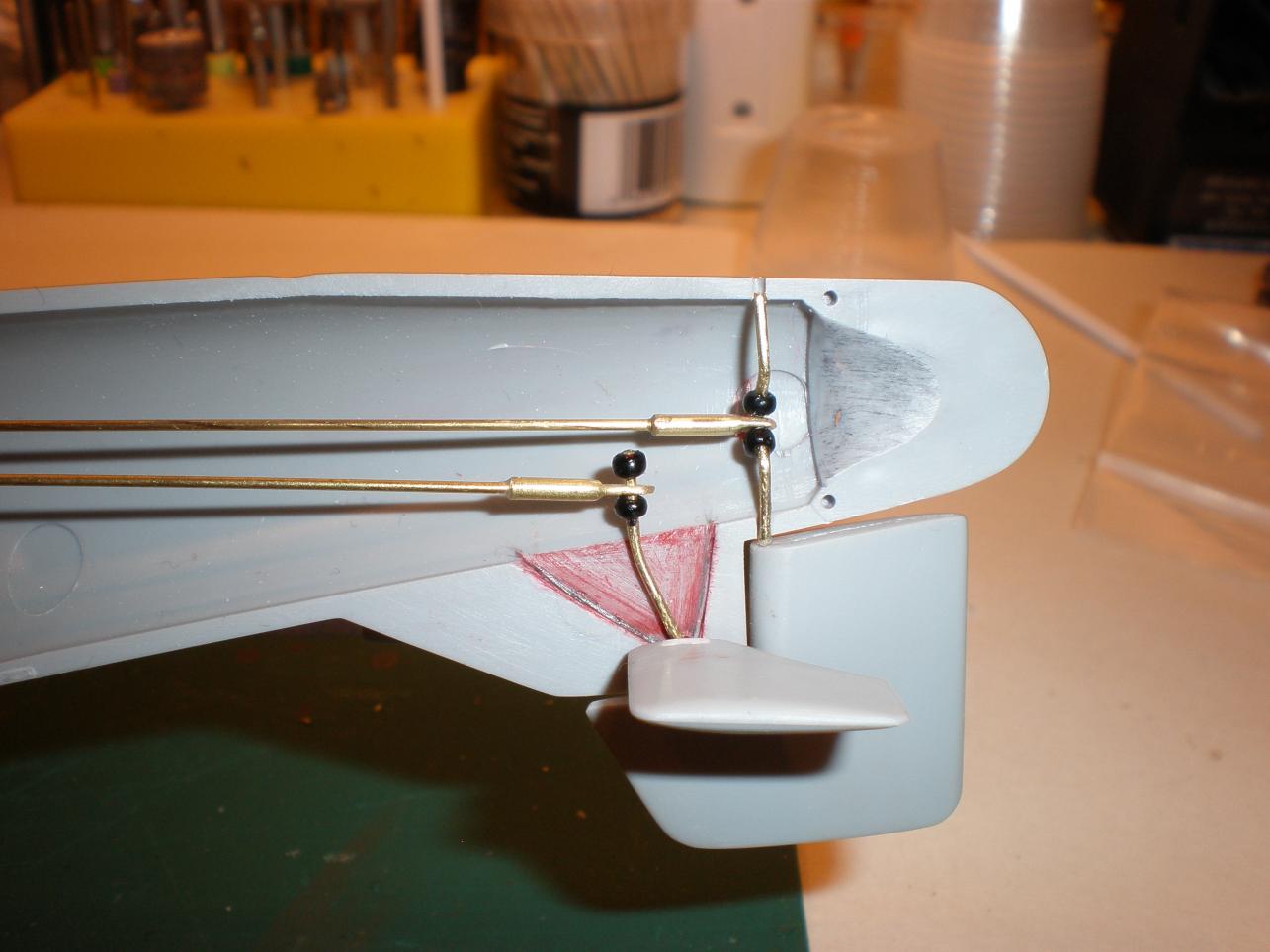

                            The rods are 1/32" diameter brass rod. The ends are 1/16" o.d. brass tubing, "coined" and drilled to connect
                            to the 1/32" rudder and dive plane "shafts"! The "open" end of these parts are CA'd to the 1/32" wire pushrods.
                            The little black "keepers" are really tiny glass beads and will keep the rod ends where they need to be!
Name:	servo linkage.jpg
                            I still need to make up a couple of magnet holders, and CA them to the rod ends, so they'll mate up with the magnets on top of the servos in the 1 1/4" SD.
                            That "strap" looking thing right above the servo box doesn't need to be there. I found that the hull will stay together nicely without it.
                            Good thing, cuz I can sure use a little extra room above the servo box!! It'll also make SD installing and removing a whole lot easier!!
                            May need to put in a couple of guides for those little rods to prevent them from bending!!?
                            I'll find out later!
                            crazygary, out!
