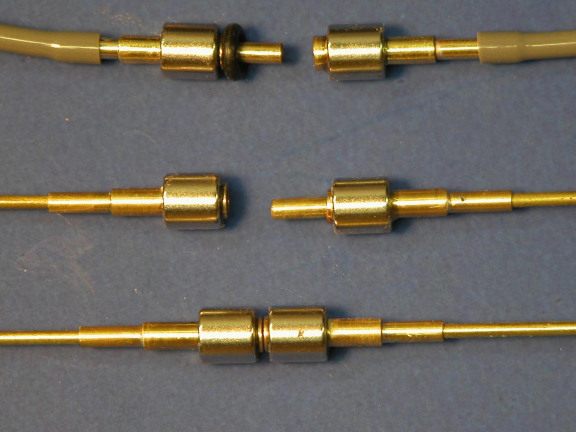

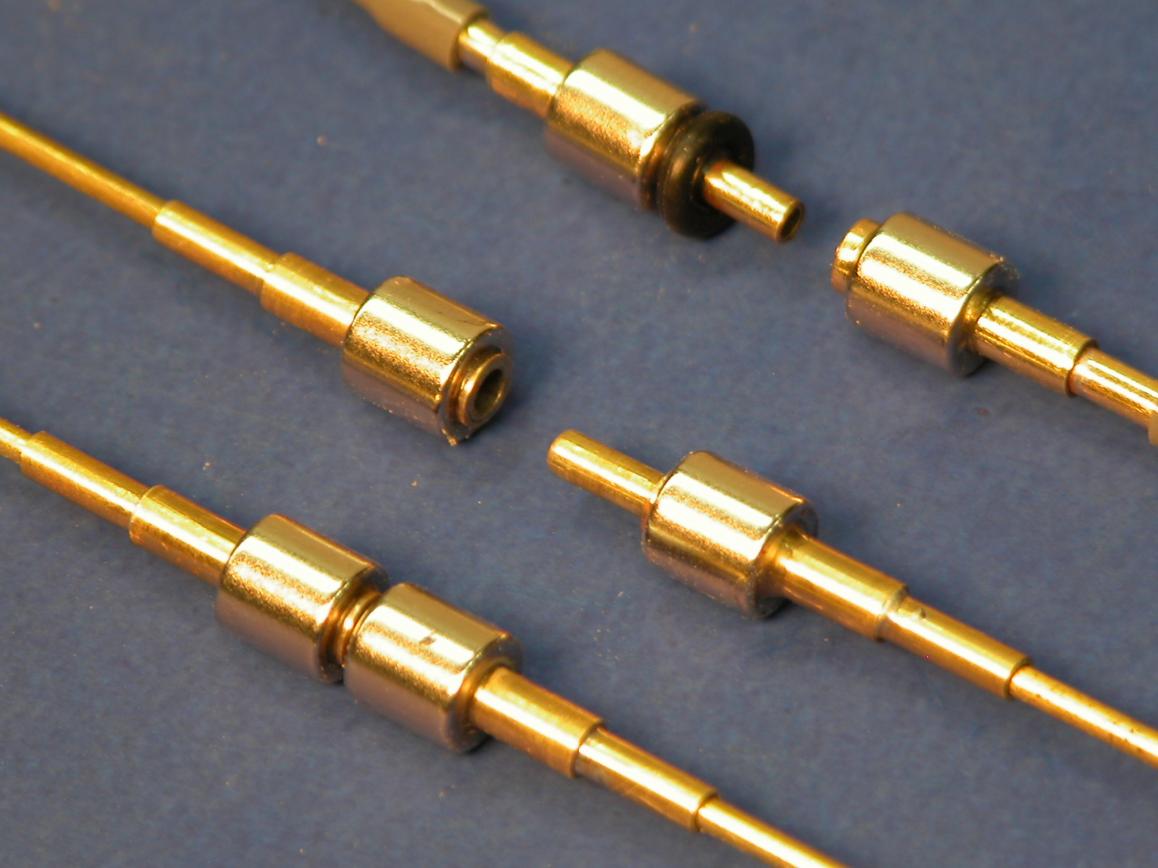

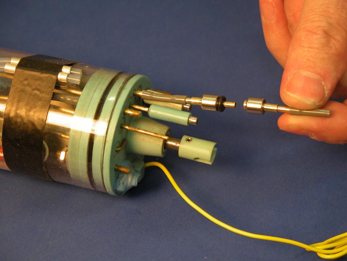

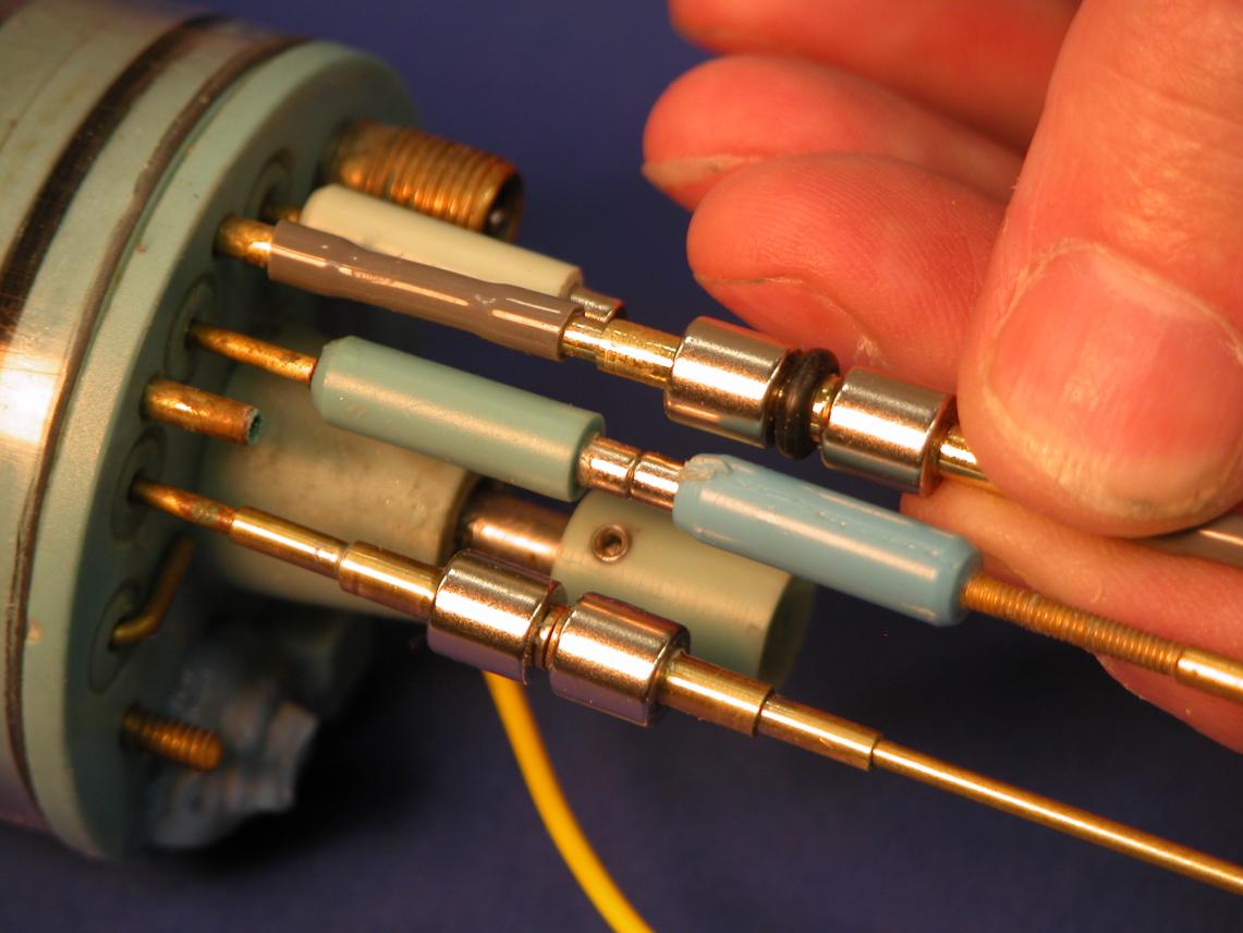

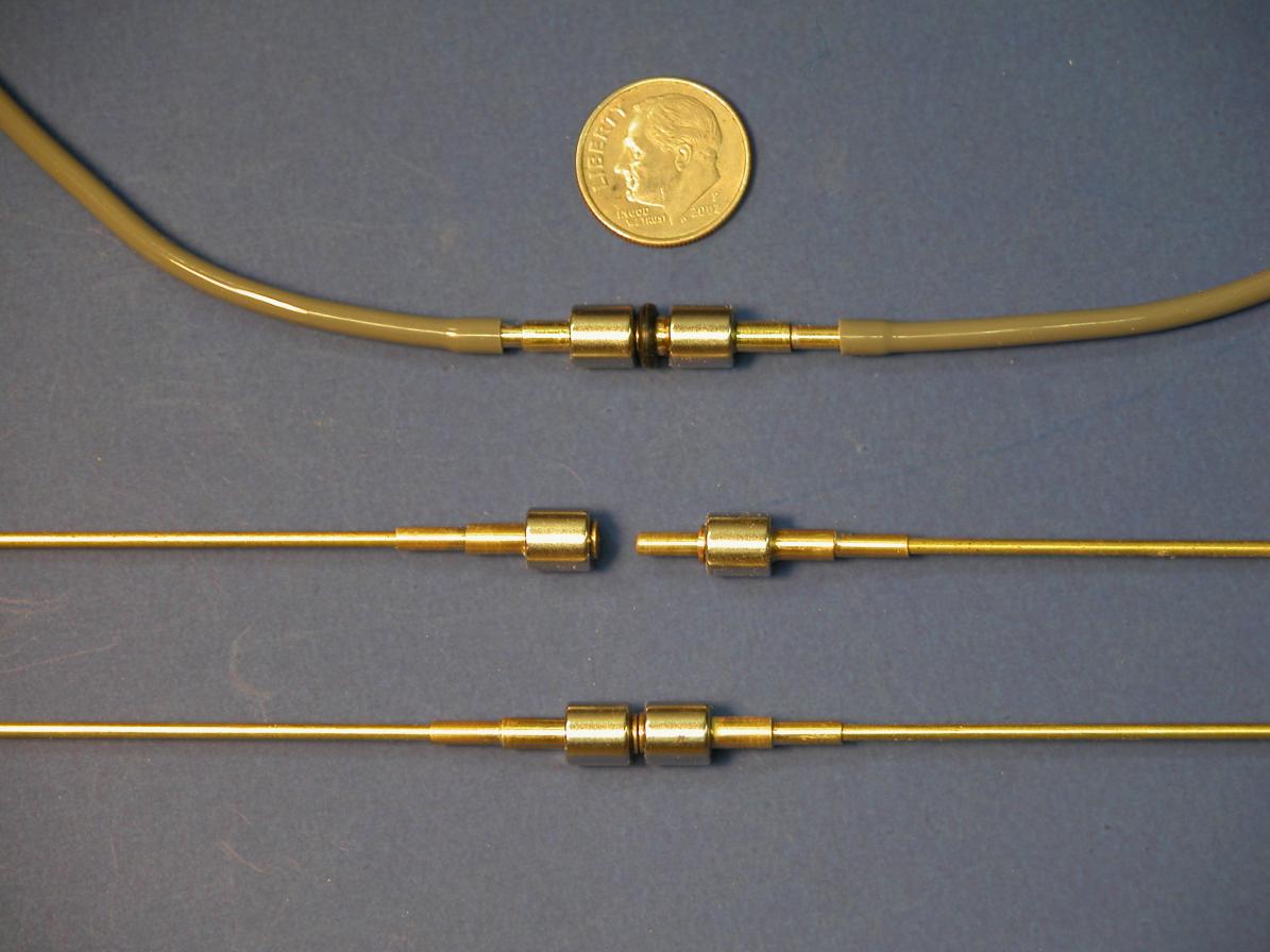

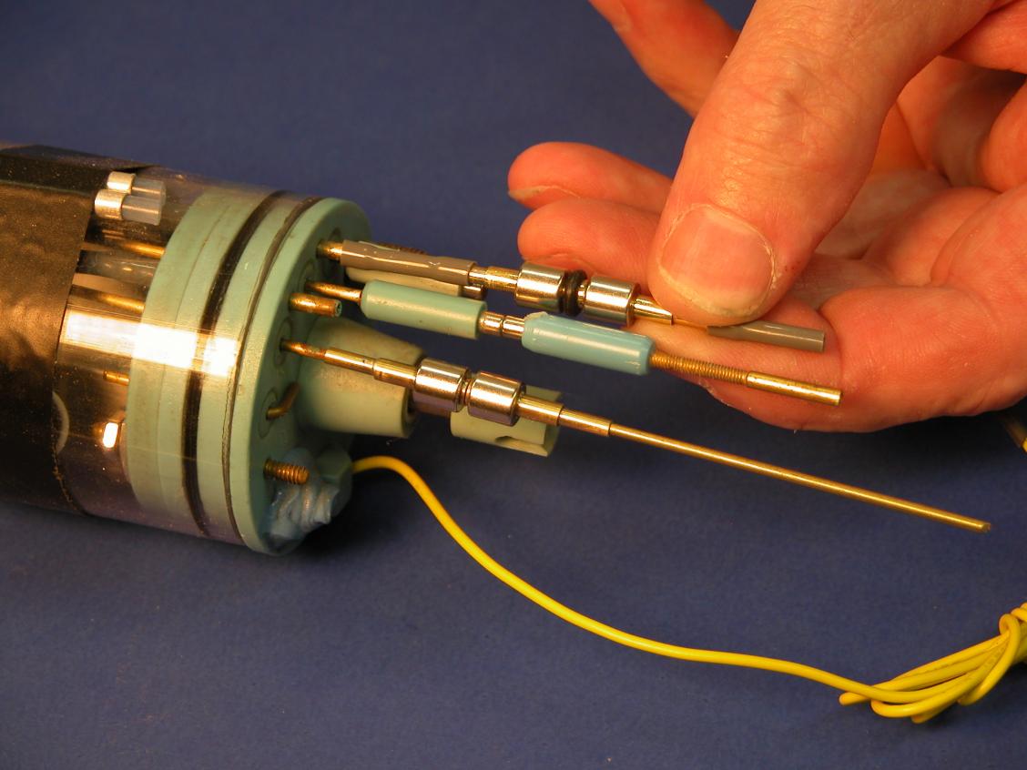

    Right you are, Manfred. In fact, Tom had sent me some samples of what he's worked up in the way of magnetically latched plumbing connectors, as well as a more robust version of our magnetic linkage connectors. Feast your eyes on his work here:
ID:	83672Click image for larger version
ID:	83673Click image for larger version
ID:	83674Click image for larger version
ID:	83675Click image for larger version
ID:	83676Click image for larger version

      That's slick!!
        • 14010
        #123
        Originally posted by MFR1964
        That's slick!!
        Take a bow, Tom!
        Here's our source of those and all sorts of other plated magnets:
        Gaussboys Super Magnets - Your source for high quality neodymium rare earth magnets. Custom shapes and sizes available. Now accepting bitcoin.
          • 1659
          #124
          Thanks for the link David, it will be most usefull in the future, you never know when i need strangely shaped magnets.

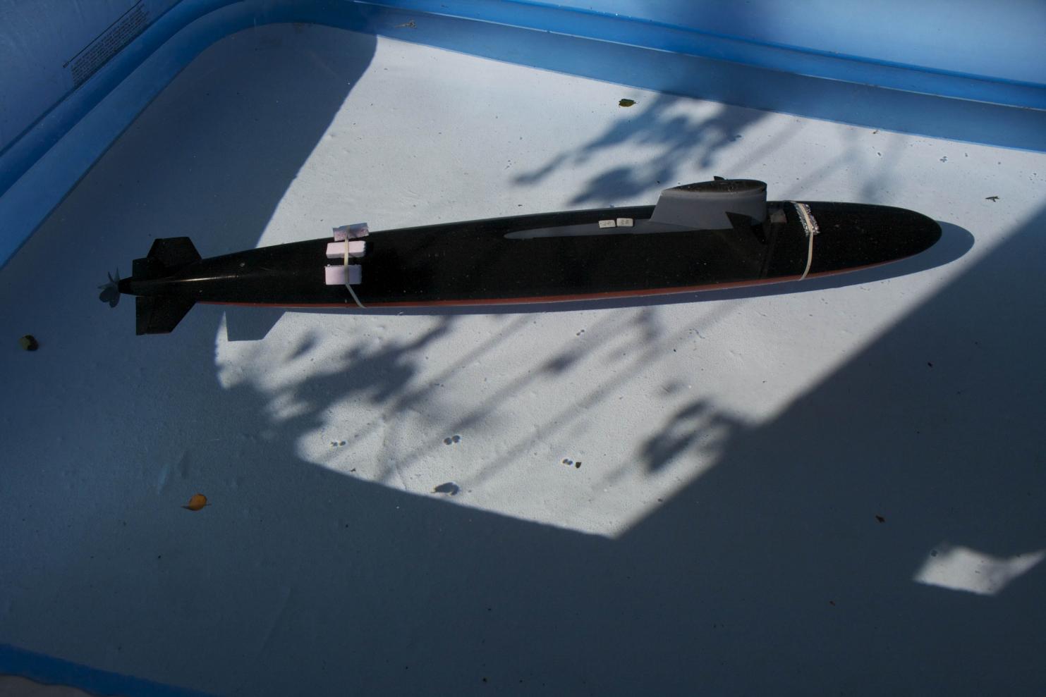

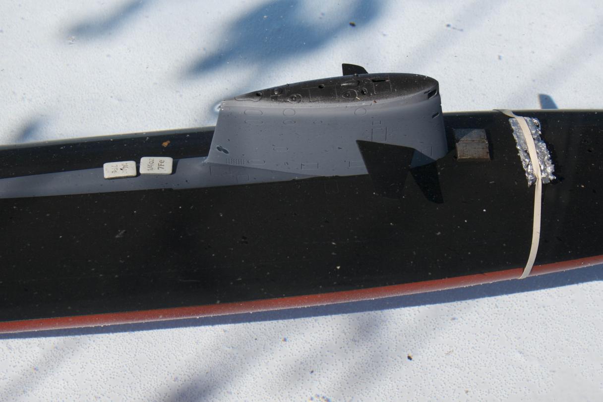

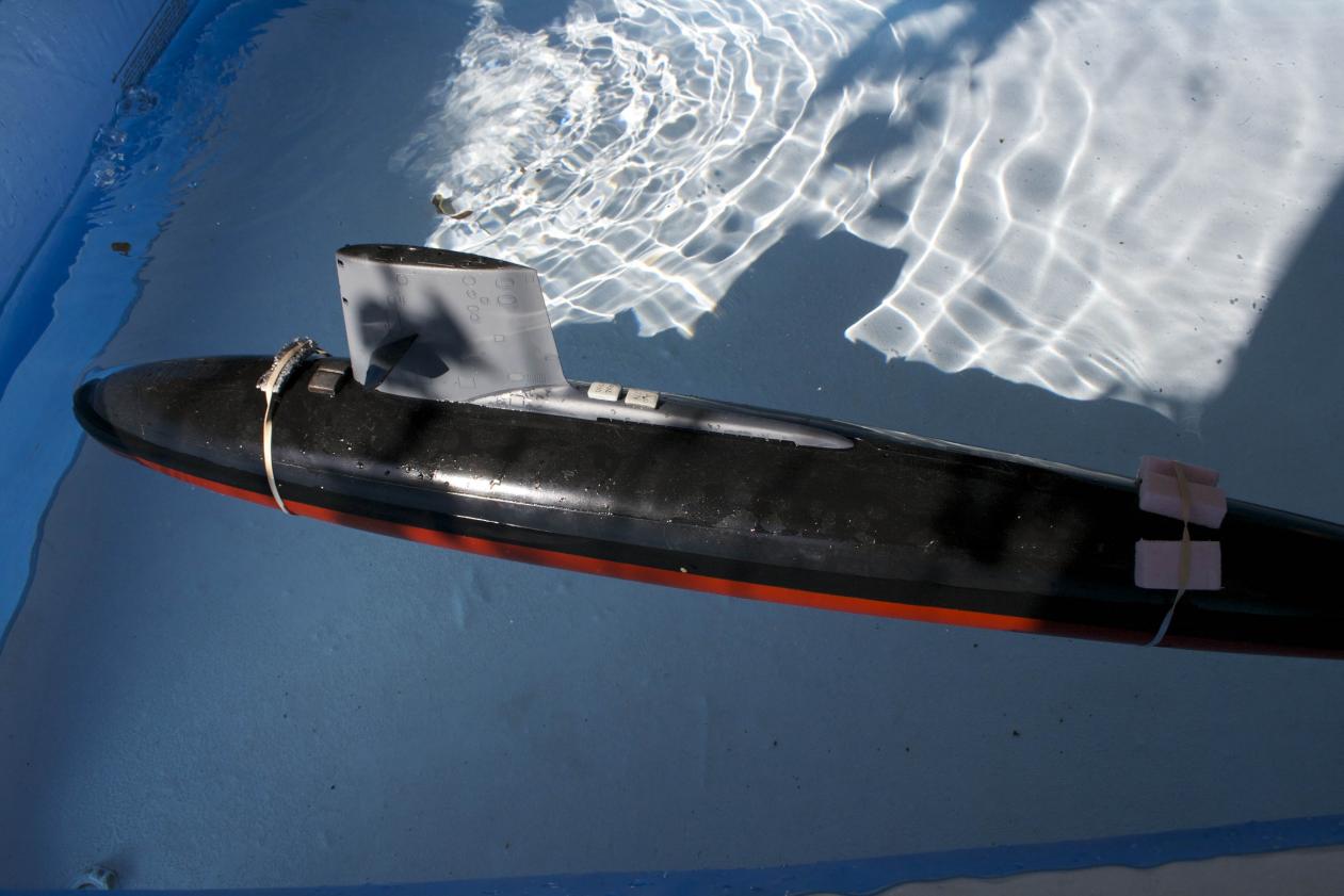

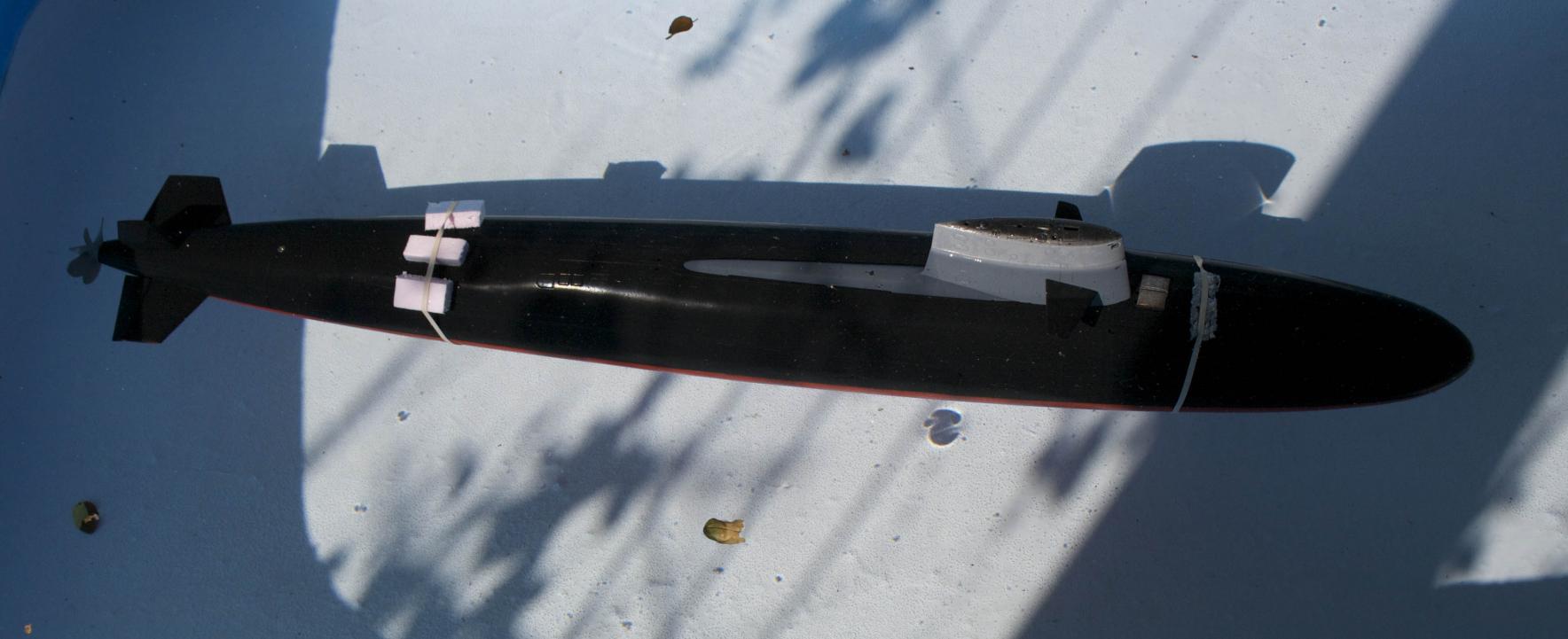

                  The big pieces of lead are placed in the sub. So a little was in the front and a bit of foam is in the rear. I moved some weight around and shaved off an ounce and a half of weight.
                  with it leveled off, it was still a little high in the water. Added 1/2 oz. back on the sub near the center of balance.
                  That was just enough to bring it to the top of the sail. I think that is a good spot.
                  That worked. It settled nicely.
                  The video is last, there is a reason.....and I blame Manfred.
                  Upon blowing out the ballast tank. Again the rear was very high. (and I bent the prop)

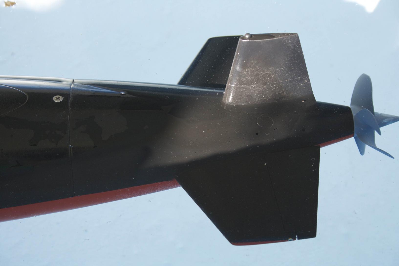

                  You can see that completely emptying the ballast tank the sub as a whole rises high.
                  I will need to complete the trimming in the solid walled test tank (tub)
                  I will get that sound for you Manfred.

                      You bent my prop ..... you ****!
                      Plenty of reserve buoyancy in that SD -- you'll learn to goose the pump to get just enough water out to float the boat at the designed waterline.

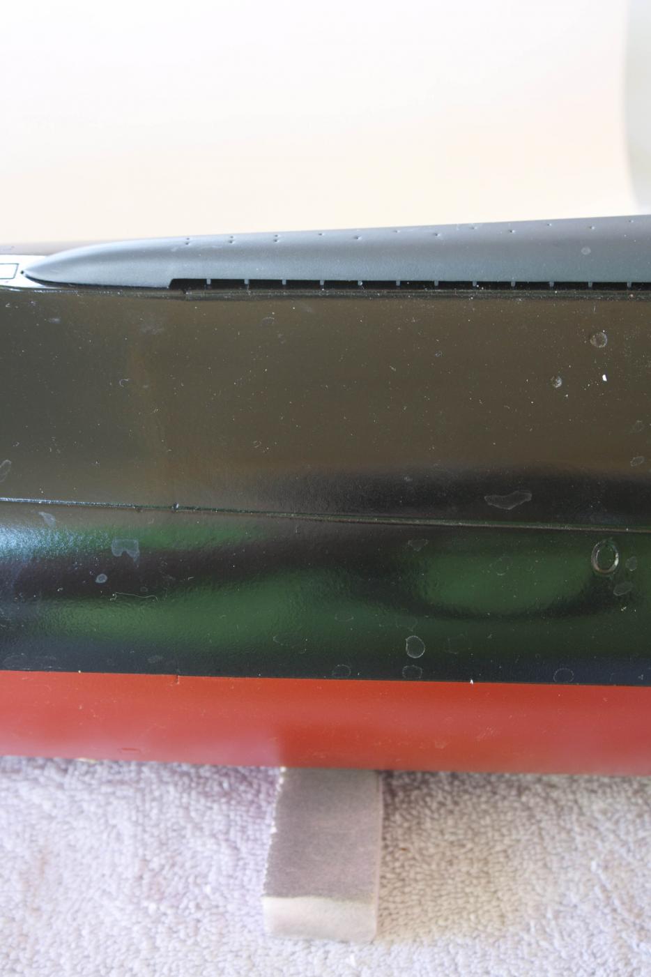

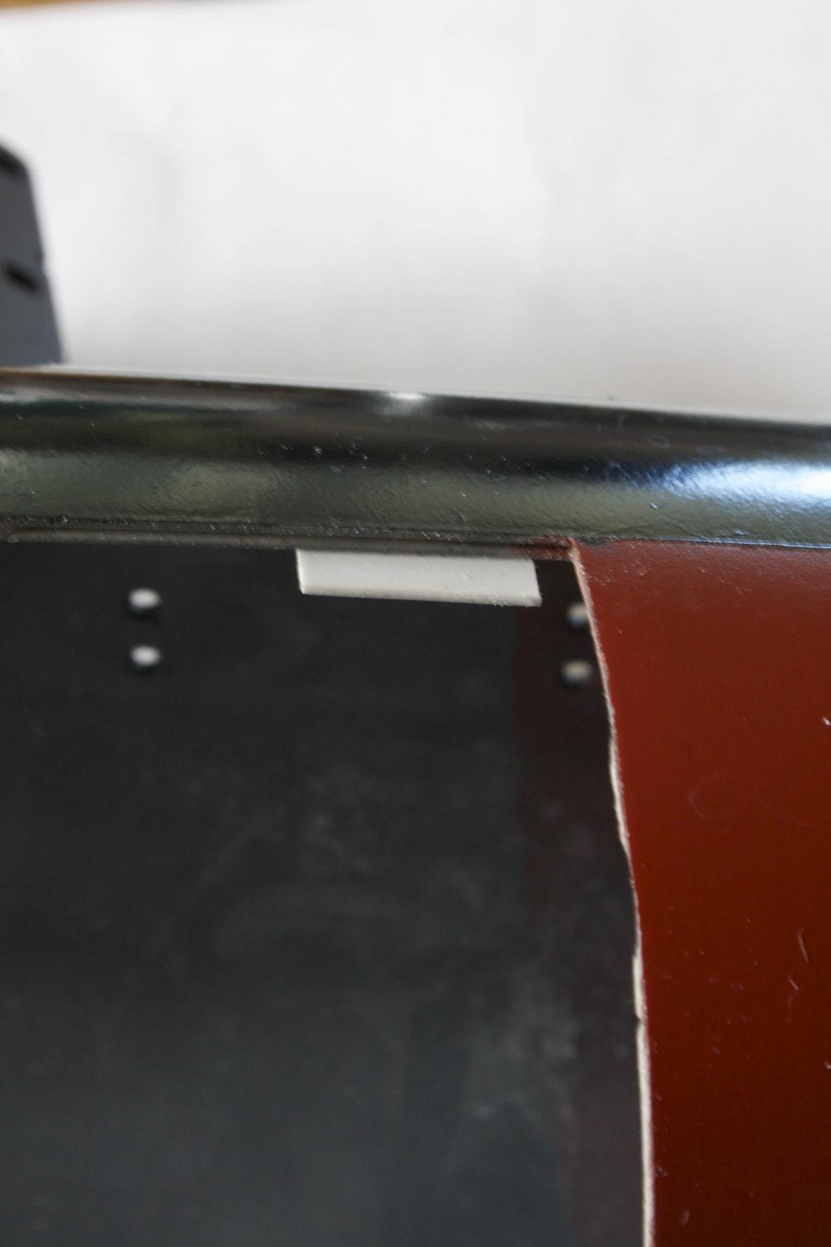

                          Thanks guys, I am still chuckling about the puncture to the kiddie pool. It was time for a new one and if anything it brought a certain joy to my wife that it will not be set up on the patio. Anyways, I have been annoyed at the alignment of the front of the sub. One side or the other will pop in rather than stay on the track. I looked through the pictures of David's build and I saw one that I think may have been David's solution.
                          I added some curved tabs to the top portion of the hull.
                          That made an immediate difference. This morning when i put it together there was no fighting the alignment, it just fell into place.

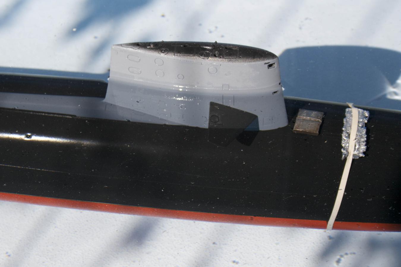

                          As a side note, I balanced my sub and it comes up a bit behind the sail. This is in the air so is this considered the center of gravity? or just center of balance dry?

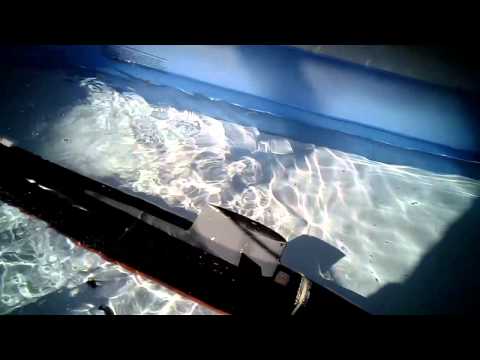

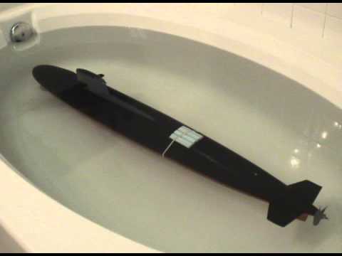

                              Vindication......
                              Maybe the pool today after I sleep.
                              Now Manfred, the ball is in your court. Type XXIII video in the wet.
                                • 1659
                                #135
                                Excellent Tom!!!!, a nice whoosh the second and third attempt, you're now officially releaved from mess hall duty.
                                I only wonder why i didn't hear the woosh the first time, did the float kept stuck to the inlet?, or it simply levelled the pressure without the sucking noise?
                                As for my XXIII, first some retracting stuff, testing the SD and take the plunge into the test facility, in that order.
