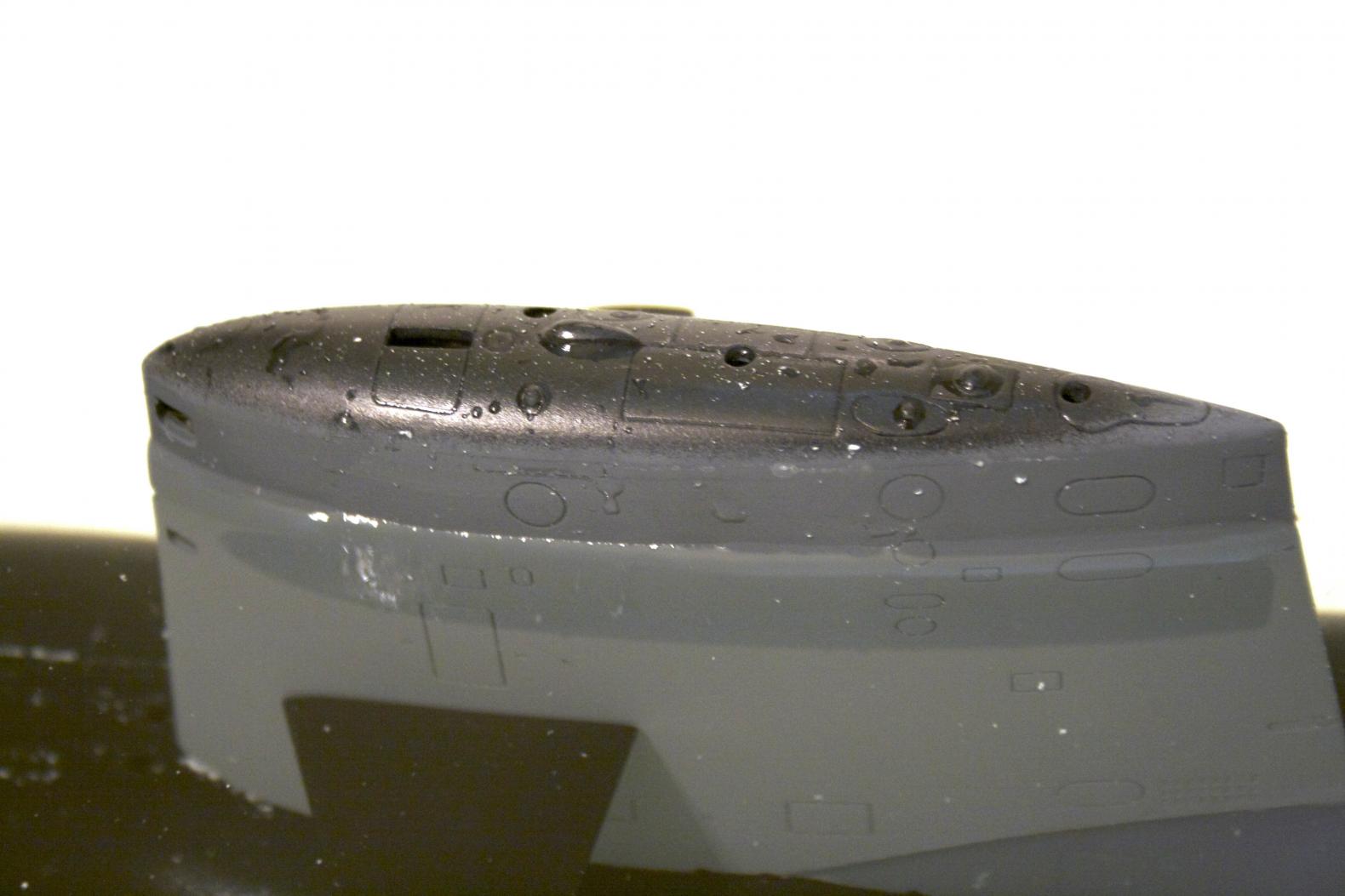

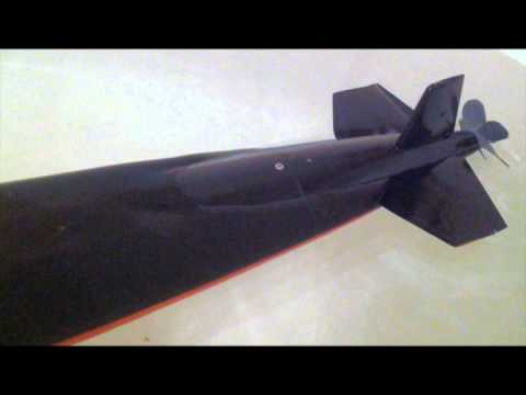

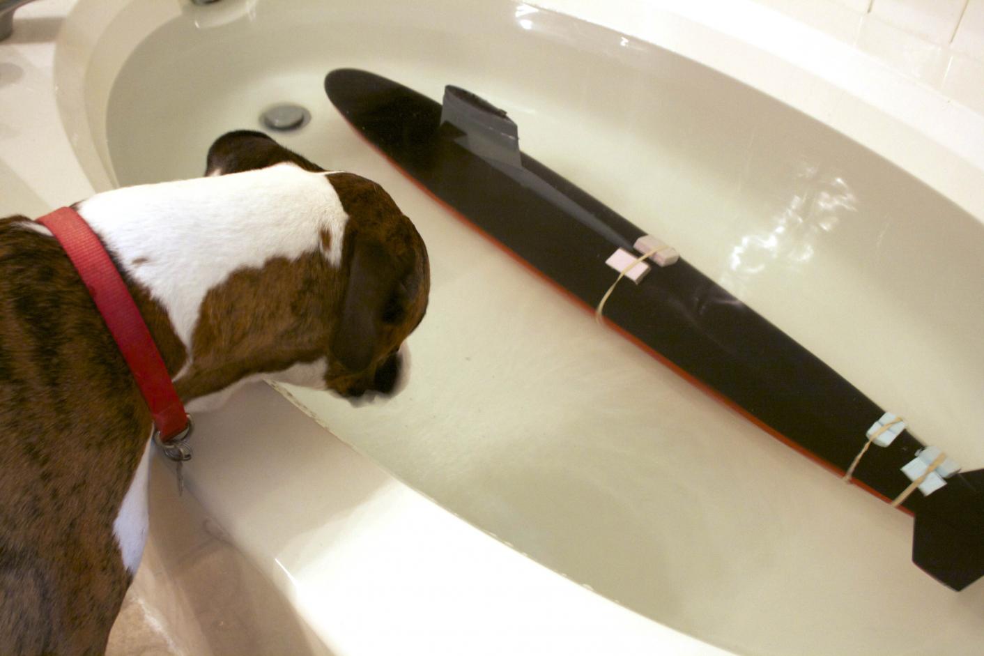

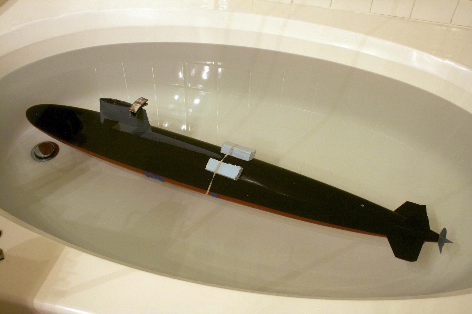

          No pool time yet. It might be fine for some, but it bothered me the way the aft was light on the surface, even though it is level submerged. The other issue is diving air will get trapped in the aft end. Even putting a 1/8" hole did not alleviate the problem (although I have more I can do like taper the inside of the hole and place a light coat of vaseline). Here is a quick video.
          When I added enough weight to the aft end, the air escaped properly through the sail.

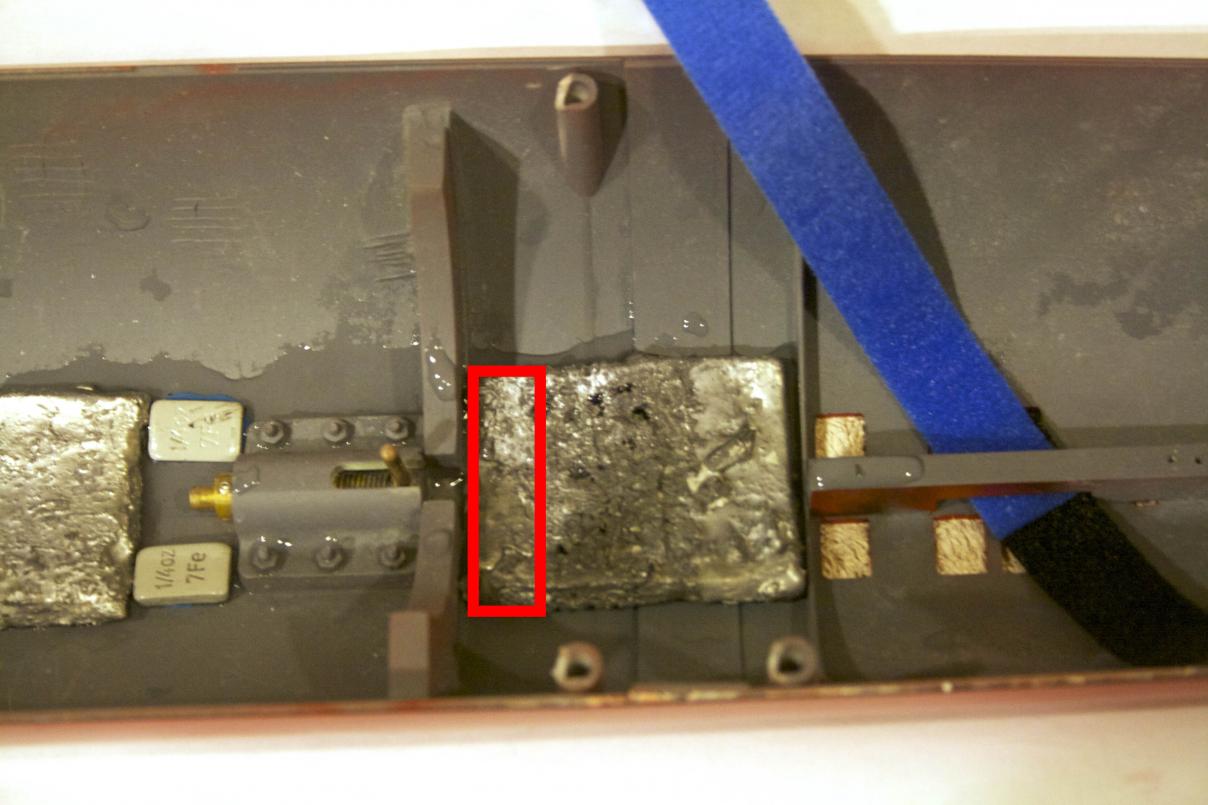

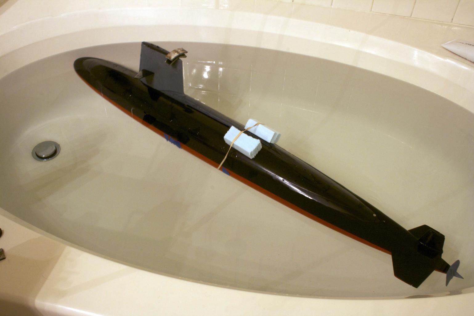

          I actually woke up at night thinking about this, so I decided to shift some of the weight around. First I needed to remove the weight, then cut 1/4 of the aft most weight. This slice I placed under the wtc towards the aft end. Tested in the tub. There was a significant improvement, but still bothered me. So I switched the weights around.
          Doing that made a huge improvement, but I needed to add some more foam to give a lift and level it submerged. I also needed to add weight in the center of balance to bring the sub lower.

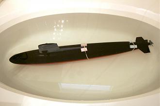

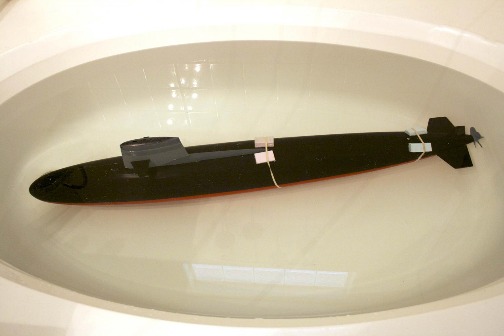

          Bringing the sub up, it leveled really close to the proper waterline with a touch more to spare. Re-submerging it verified the weight added did not change the balance.
ID:	83833Click image for larger version

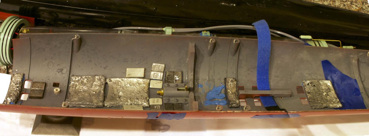

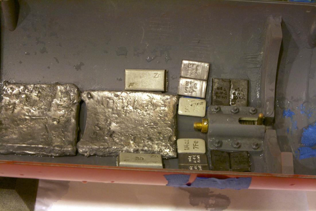

          For fun I tried to make a panorama of the interior weight distribution so far (I have exceeded the original weigh put in so forget that post).
          I will affix the float and weight. Then test again and make some modifications or adjustments. The reason I think I will need to make adjustment is the foam may not go in as one big chunk in that exact location.

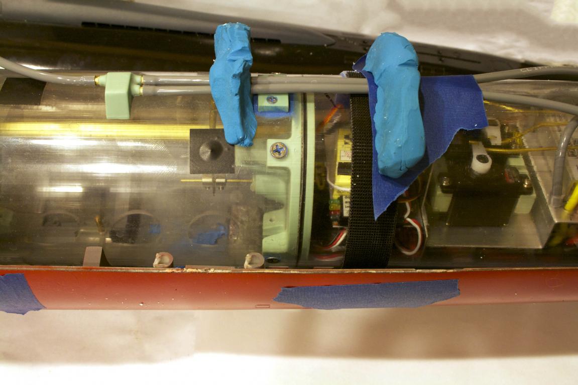

            The foam was too big. David recommended using clay to find the distance between the sub-driver and the deck.
            That helped a lot. There will still need to be a bit more fine tuning with the foam.

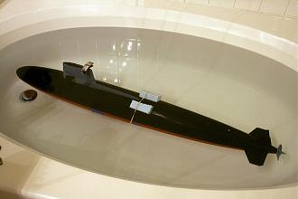

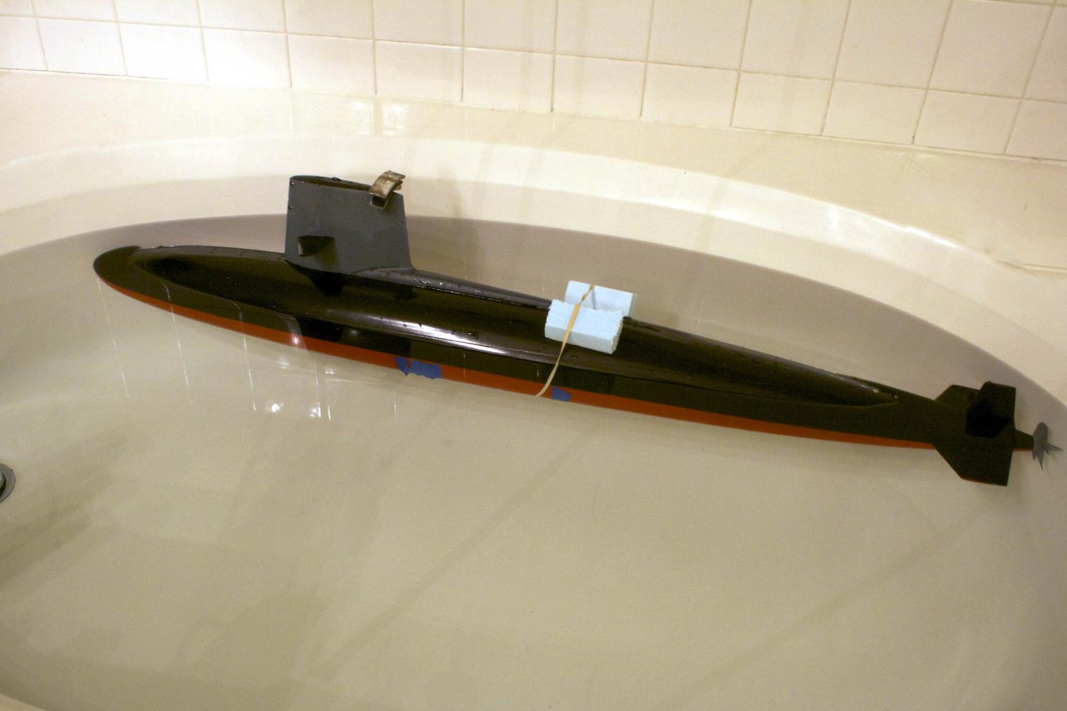

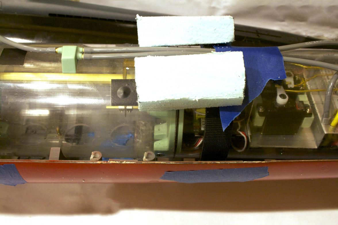

              I shaved the foam from the last test down to make the halves come together. Today no additional weight will be added, just enough foam to make it level submerged.
              That seems to be O.K. with just a small portion above the water line.
              Surfaced the aft was a bit high so I juggled the foam a bit and tested again. Much better.
              Then Zoey decided there needed to be some waves. O.K. we are done.

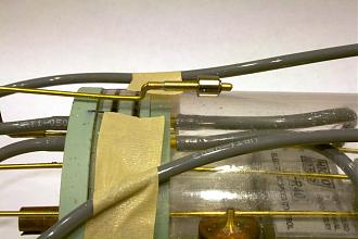

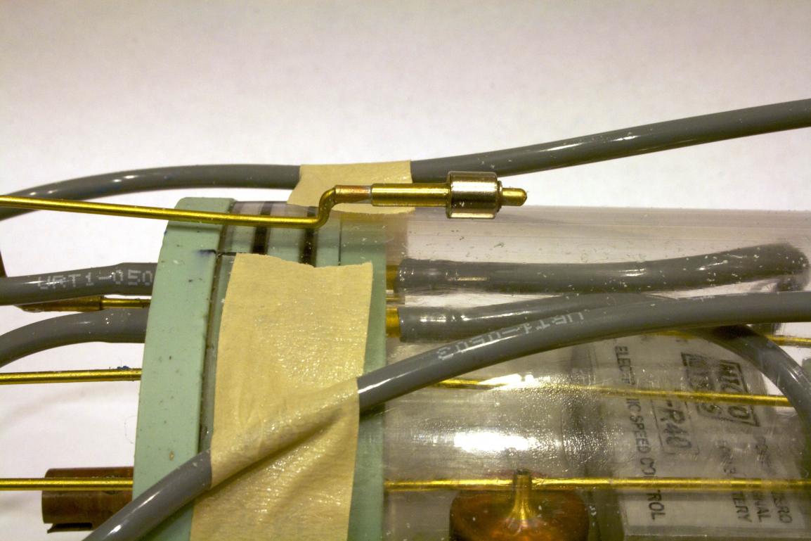

                            On top of the sub-driver, I added the stronger connector for the sail planes.
                            The air hoses are temporarily taped, I am going to add some aluminum tubes for the air. The hose seems to get in the way.

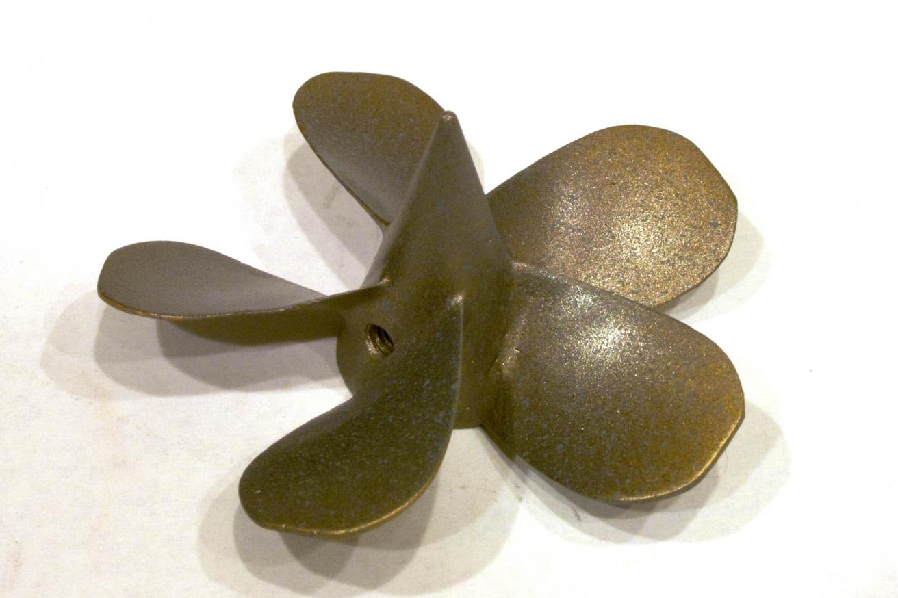

                            Prop was weathered. Sam used gold on his rain gutter regatta boat, so I sprayed the prop at the same time. Then I used light coats of bronze to darken it. Then holding the air brush further away did ultra light coats that put little splatters of gray.
                            Will seal this with a final clear coat.

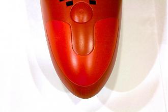

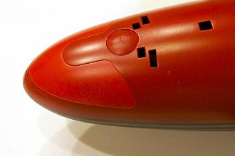

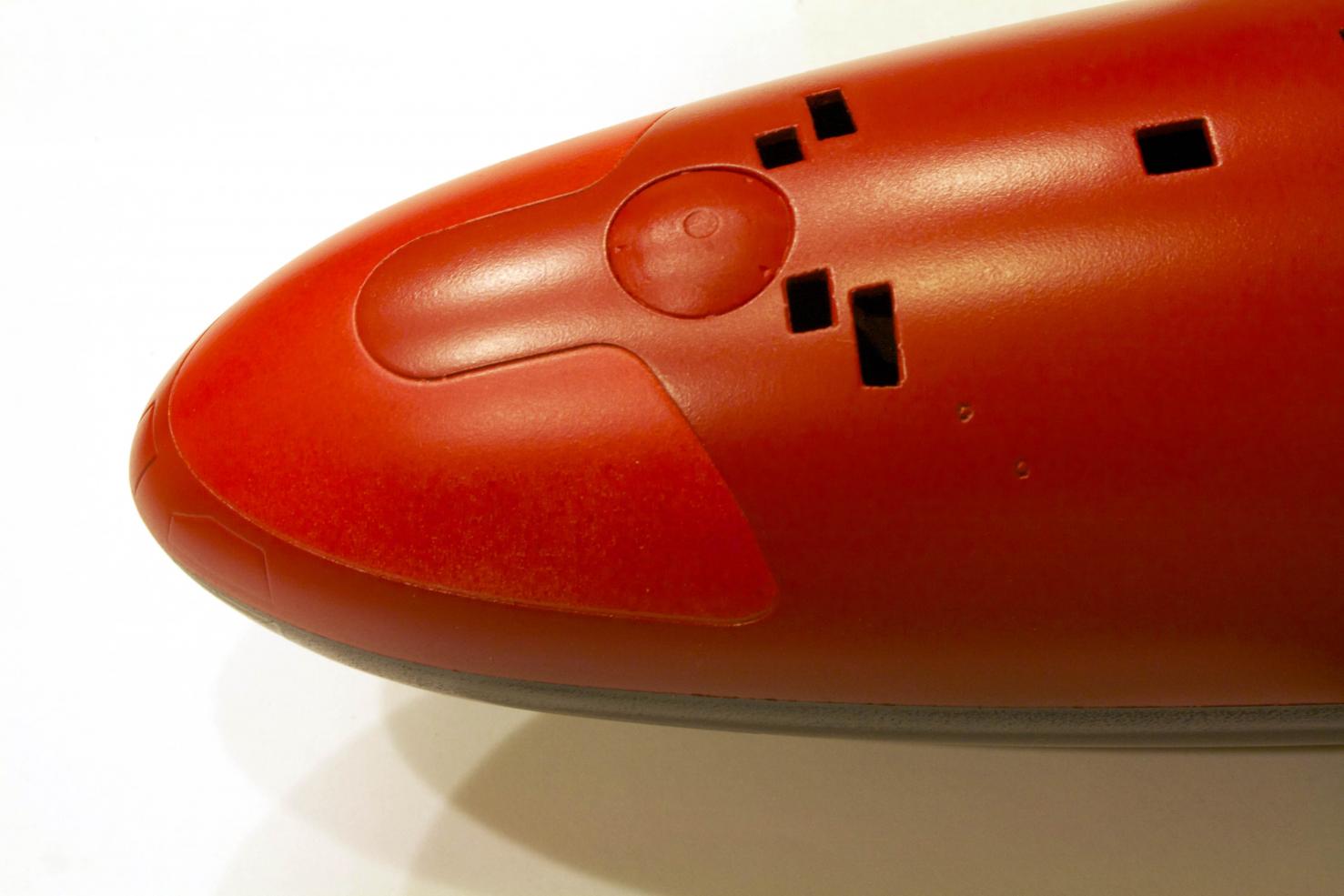

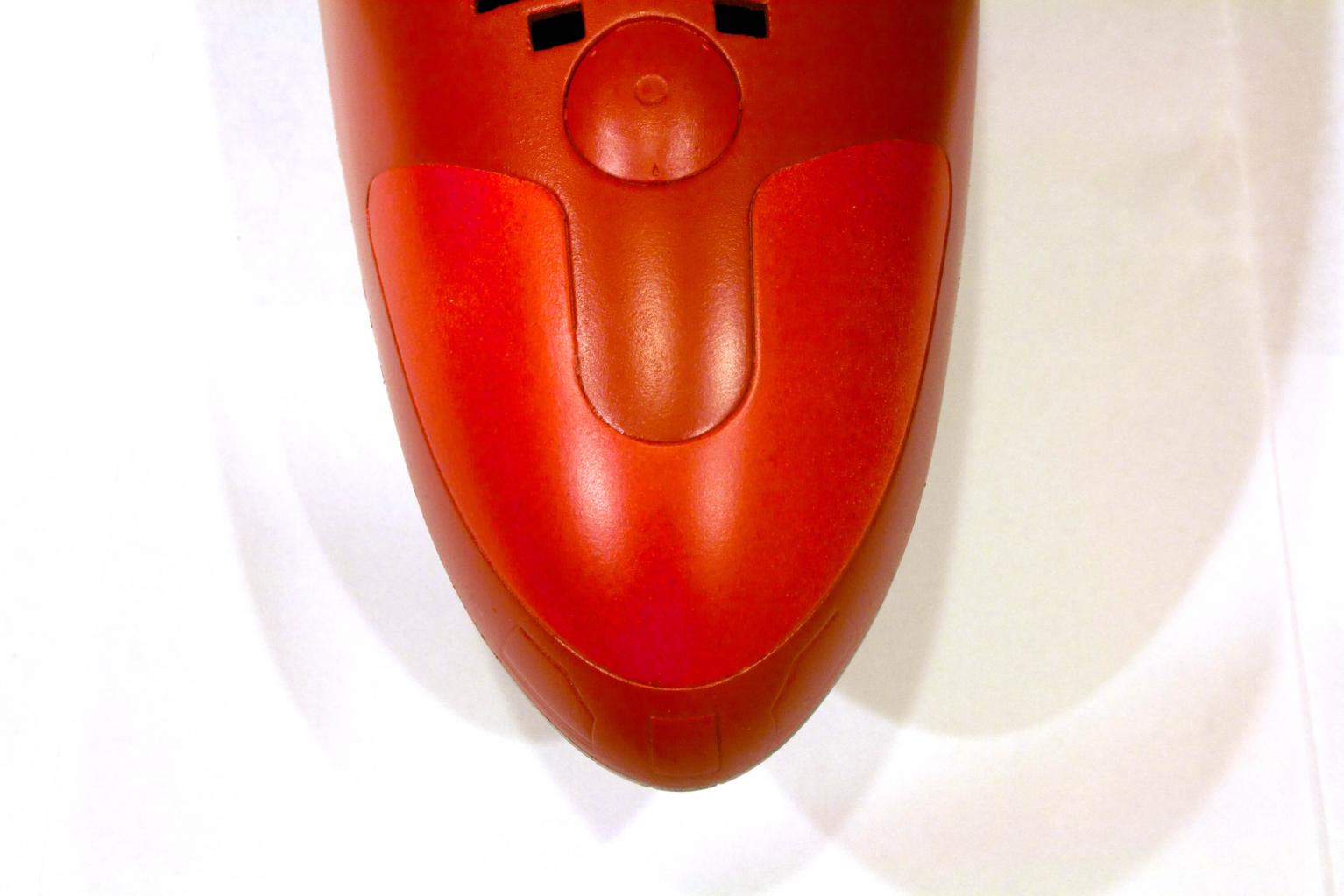

                              The hull was panted black and then sprayed with Rustoleum Satin Paprika. This was done purely for my taste. The color is not a harsh red, but it is not the muddy brownish red of the red primer (which I hear is more accurate). After all was dry, I masked the sonar area off and painted it a titanium white using art store acrylic. Let that dry. Then to finish it, I sprayed light coats of the Paprika over the white. It gave just enough of a difference to make the sonar area stand out..
ID:	84036Click image for larger version

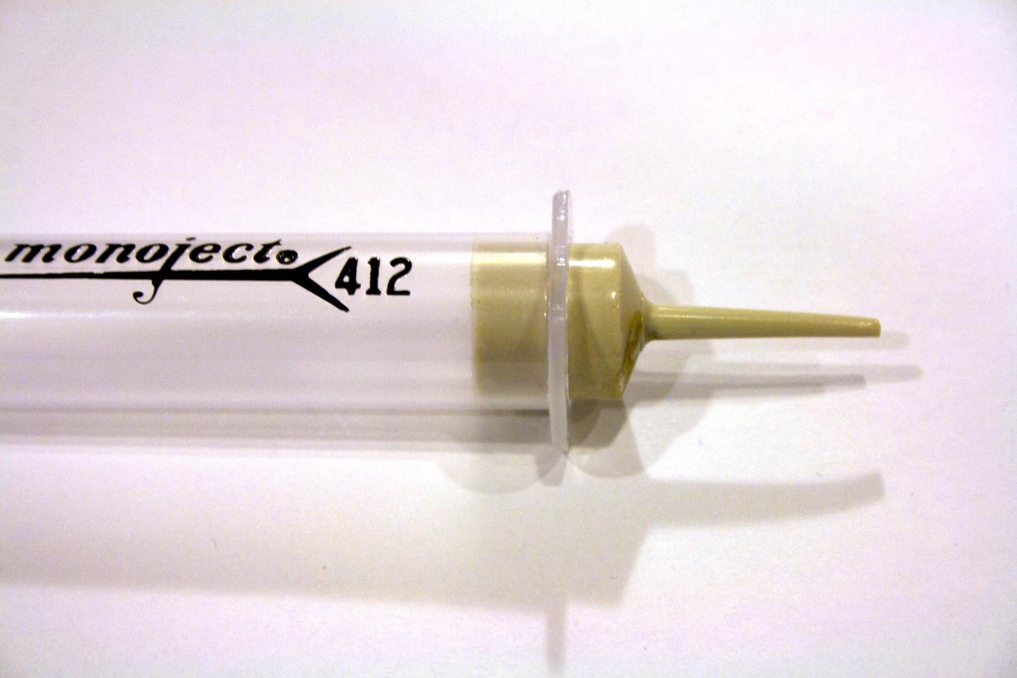

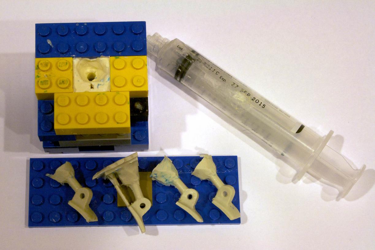

                                To hold the aluminum tubes I modified the holder used on the Gato to support only one tube. Then made a mold. I will have one tube on each side of the sub-driver (providing it will fit).
                                To fill the mold made from the master, I used a syringe. Then I thought what if I left the extra resin in there (since I made too much). The resin does not seem to permanently stick to the plastic in the syringe.
                                The plug did come out. Now, I could turn this, add an o-ring, and have a piston.....hmmm, things rattling in my brain.
