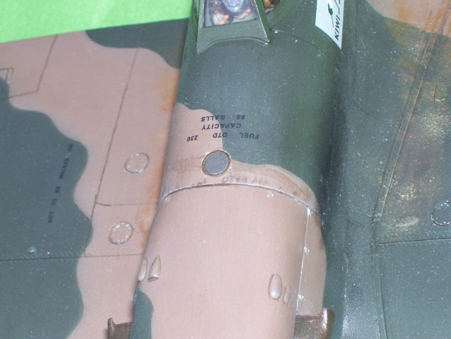

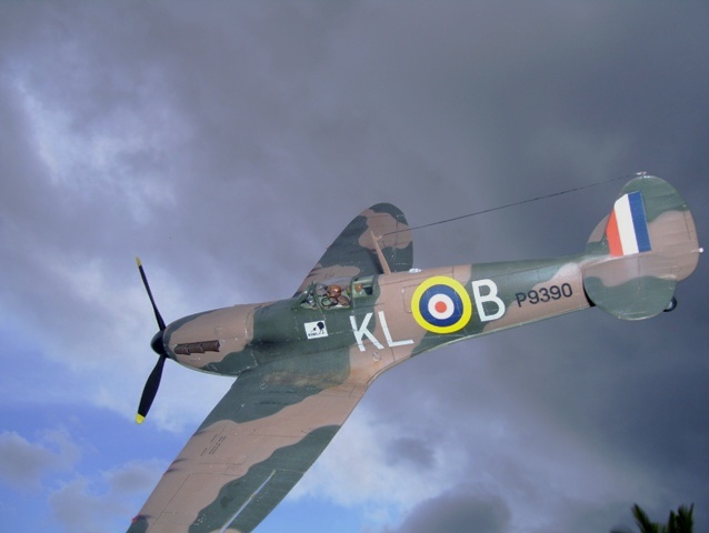

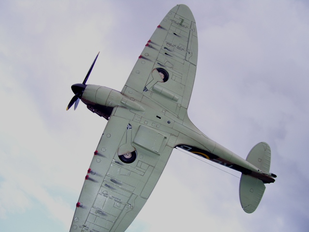

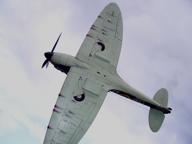

                  It's something I have been using for a while now only down here it's called pledge. One of the best kits I have done with it was my 1/24th Mk1 Spitfire

                  And on my subs too. It helped with the rub down decals on the Akula and also for the hull decals on the Skipjack.

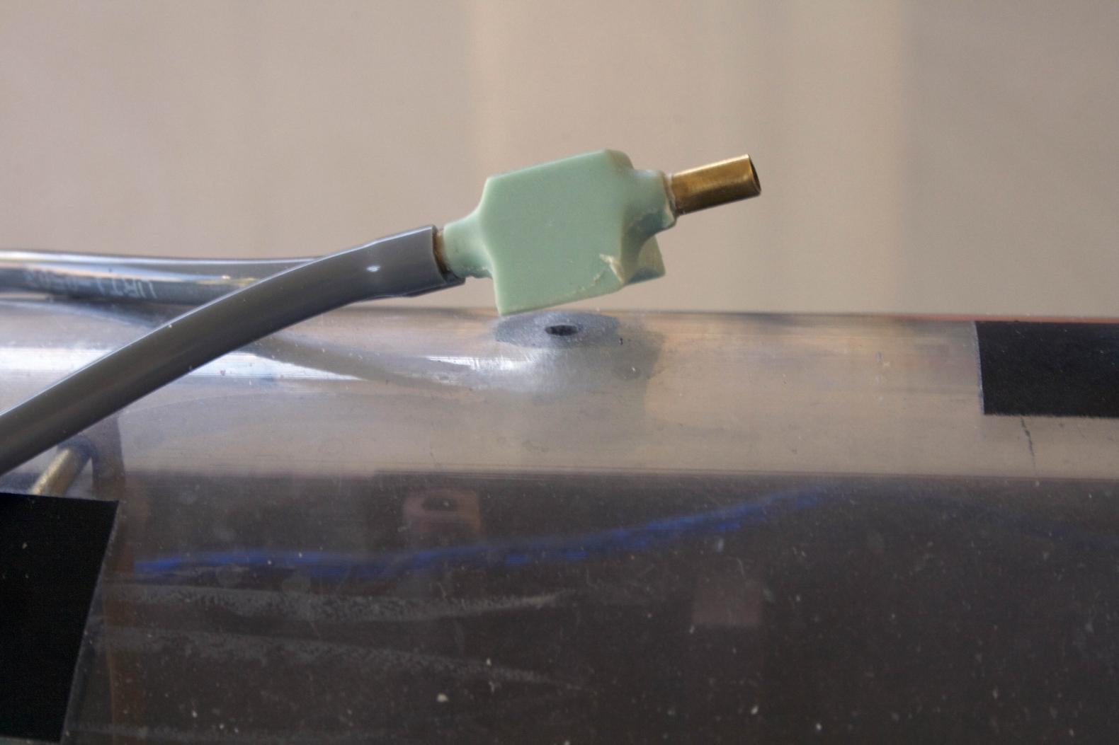

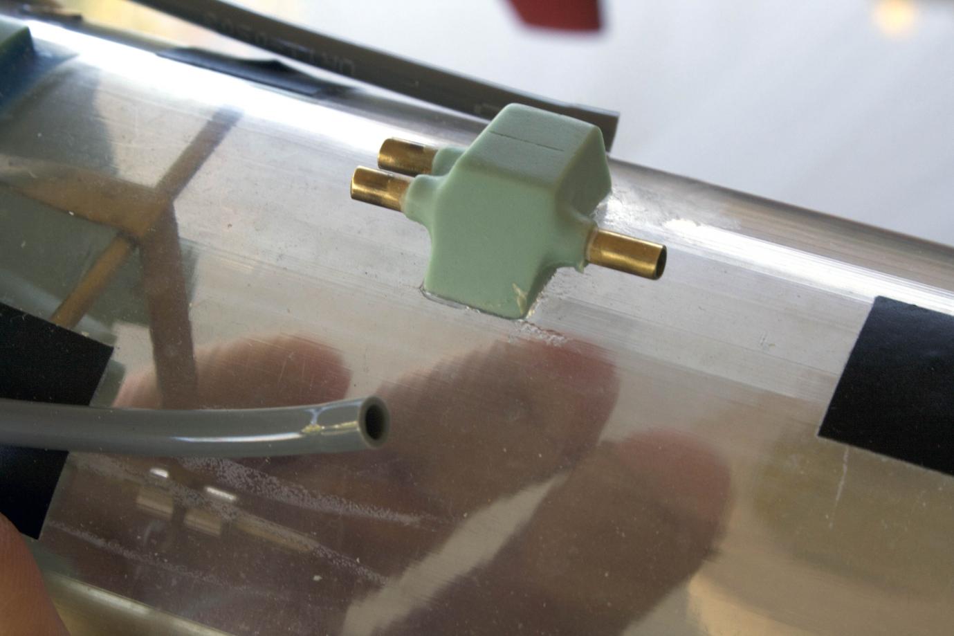

                    I did a very clumsy thing. Grabbing my top hull to work on it and apparently forgetting that I connected hose to the sail, yanked everything off the counter. My cat like reflexes (cough, cough) stopped a majority of the impact.
                    Damage was limited to the very corner of the rear plane, bent prop (again), and this....
                    None of the damage was panic worthy. Frustrating, only in myself. The broken tip is small, so I might not bother with it, the prop was easy enough to reshape, and the manifold was reattached with CA. Once the initial affixing was done, an extra bead of CA placed around the edge to seal it was applied.

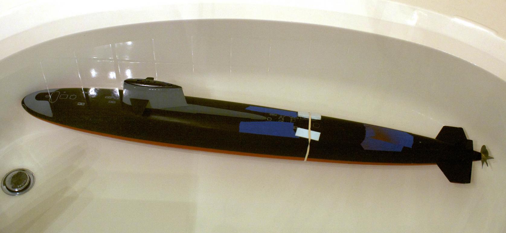

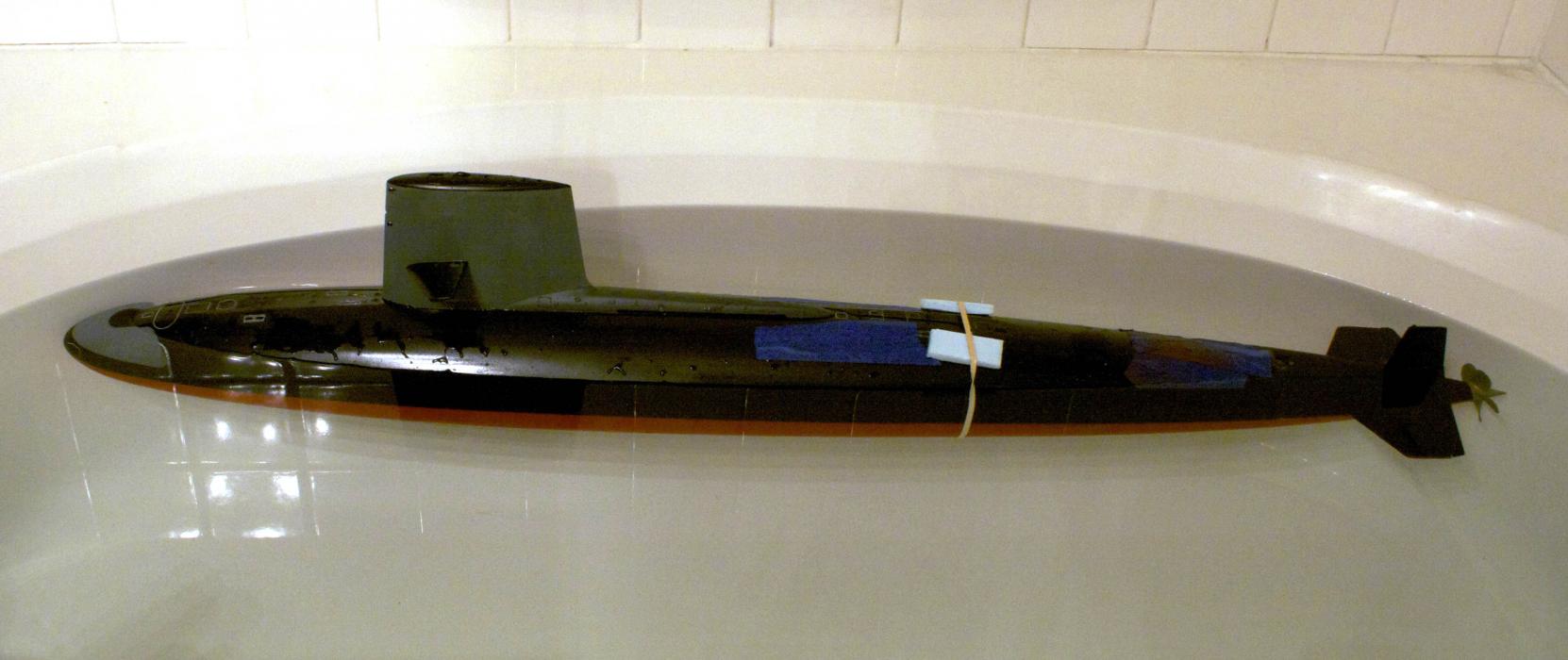

                          Final tub trim time. Say that fast three times.... Placed blue painters tape on the exterior of the hull to mark where the foam is on the inside. The thinking here is to avoid stacking foam on top of each other and respecting the limited space between the SD and hull. I had pre-shaped some blocks of closed cell foam to counter the additional weight from modifications.
                          Placed the sub in the tub and proceeded with a dive.
                          Then with ballast tanks blown.
                          Next stop grandma's pool!
