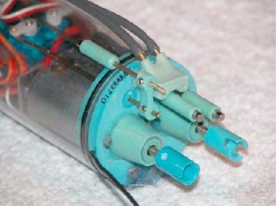

    The dumbbell is a resin piece, I believe it is this:

      OH! I was wondering what that little doohickey was for. Thats the first time Ive seen that picture. The puzzle is slowly coming together. Thanks

        OK, I'm a dumb-ass: It's marked, 'dog-bone'. What I meant was 'dumb-bell'. Duh!
        [ATTACH=CONFIG]24074[/ATTACH]
        Dog bone works too...

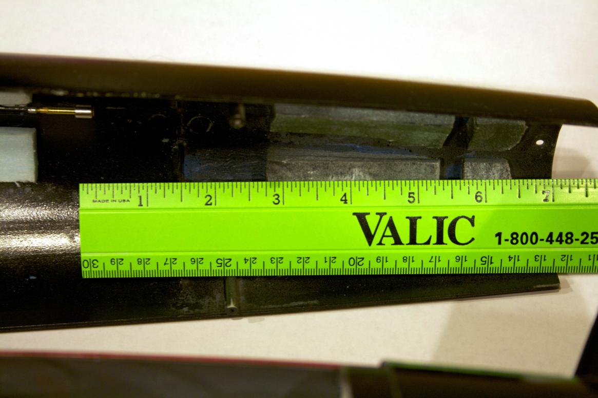

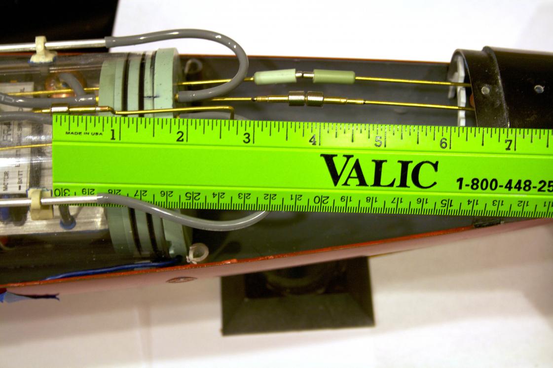

          Amazing what a good night of sleep does. I was about to cut open an access hatch, then it came to me to measure from a fixed point to the end of the magnet. I used the aft seam as my point of reference.
          It was 6 7/8" then when I measured the top section, it was 1/4" too long. So the magnets were connecting on the back side and would work for awhile then slip off. The next picture was the rod already shortened.
          Reassembled the sub and it connected! I then used the End Point to adjust the throw. Down 87% and up 50% seemed to give me plenty of play. What a relief. I will have to sail it in the pool this weekend.

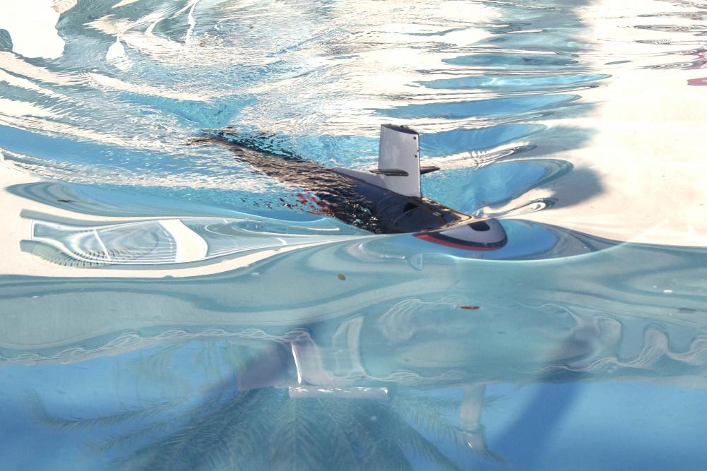

                          Rudder respond'ed' very well with the new magnets. (Had to put the ed in single quotes because apparently if the letters d e d are put together you get this ded )

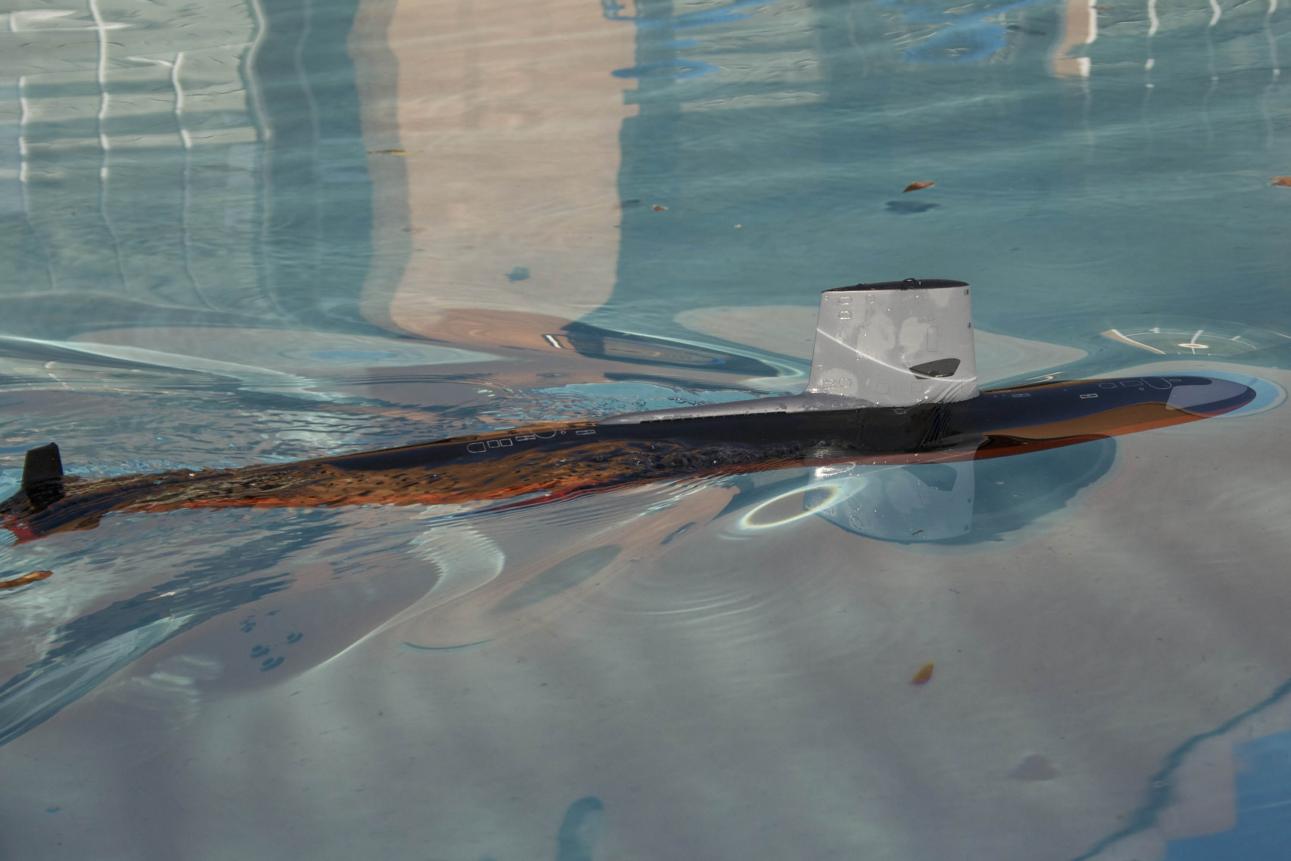

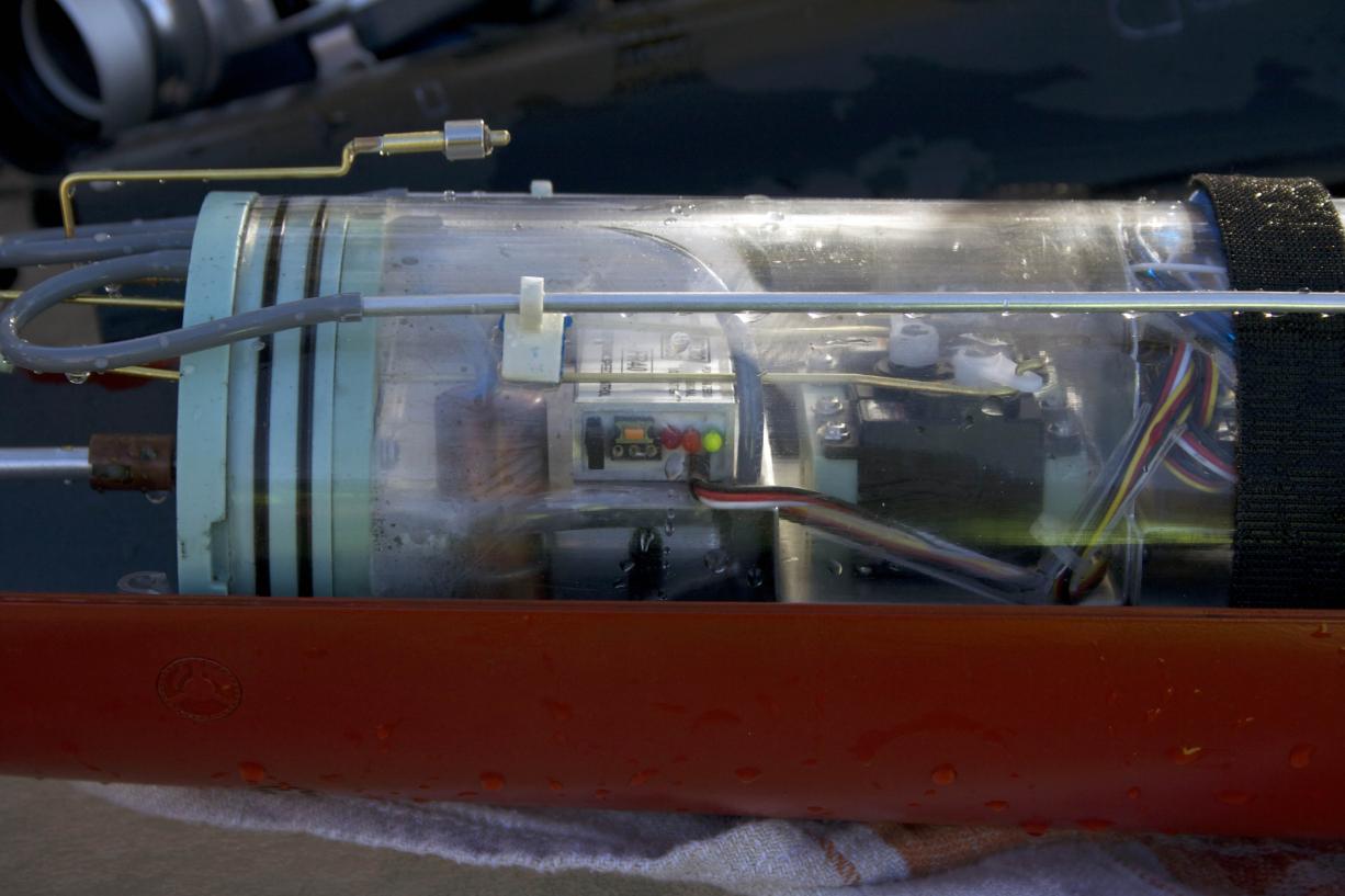

                          Playing around for 10 to 15 minutes, I noticed it was tough to keep level.

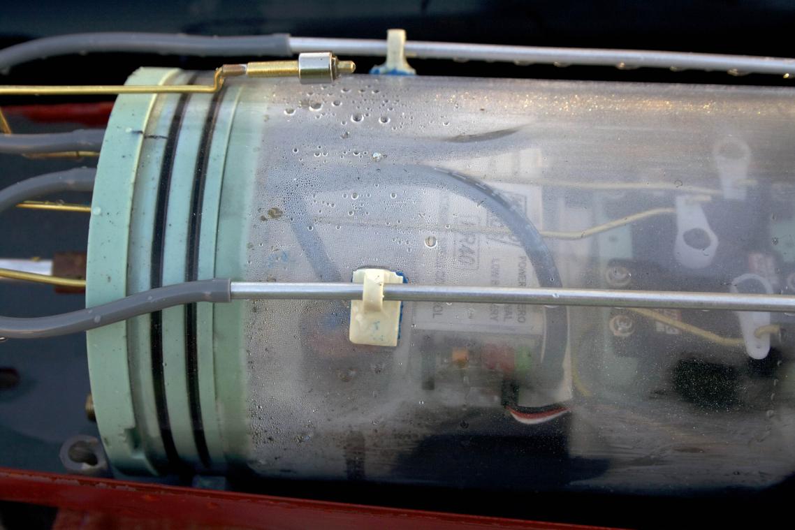

                          Brought it out of the water. There was a fine mist on the cylinder. The issue for running funny was the connector to the leveler disconnected when I did a quick reverse.
                          After about 45 minutes, the sub was running with the aft end down. This time the cylinder condensation/spray was noticeably greater with a small amount of water at the bottom. The reservoir was drained by blocking the air intake forcing. Some water came out (it did work), but not a tremendous amount of water came out. Indicating to me that the water was not entirely from the SAS.

                          The battery compartment had just a small amount of water - a couple of drops. There was a noise in the drive train. I will open it up after everything dries out.

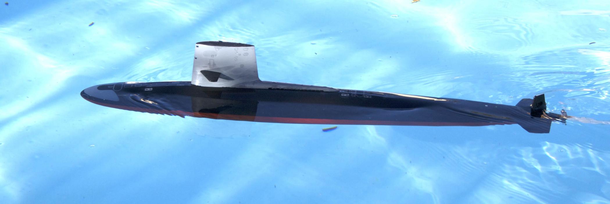

                            The moisture build up concerns me, as time goes on that has got to take a toll on the electronics. As much moisture as there was, I am beginning to think water is getting in somewhere else like drive shaft. If it is still from the SAS, I think I can fix that. So, tonight I will pressure test the sub-driver and look for bubbles and vacuum test too!
                            Because both Sam and I drove it, we made many emergency stops. On reverse the leveler seems to work against you and lifts the aft end up. That made the prop so much less effective (a lot of air being churned up, but little response) - I do not know if there is an effective solution to this. I did find that aside from disconnecting, the planes would move on the rod. I thought everything was tight, but I will check again.
