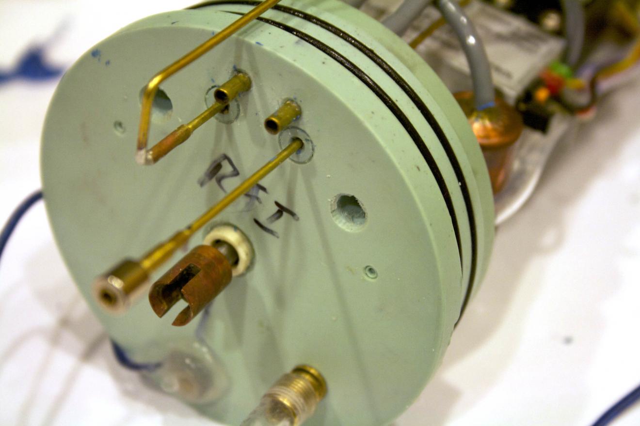

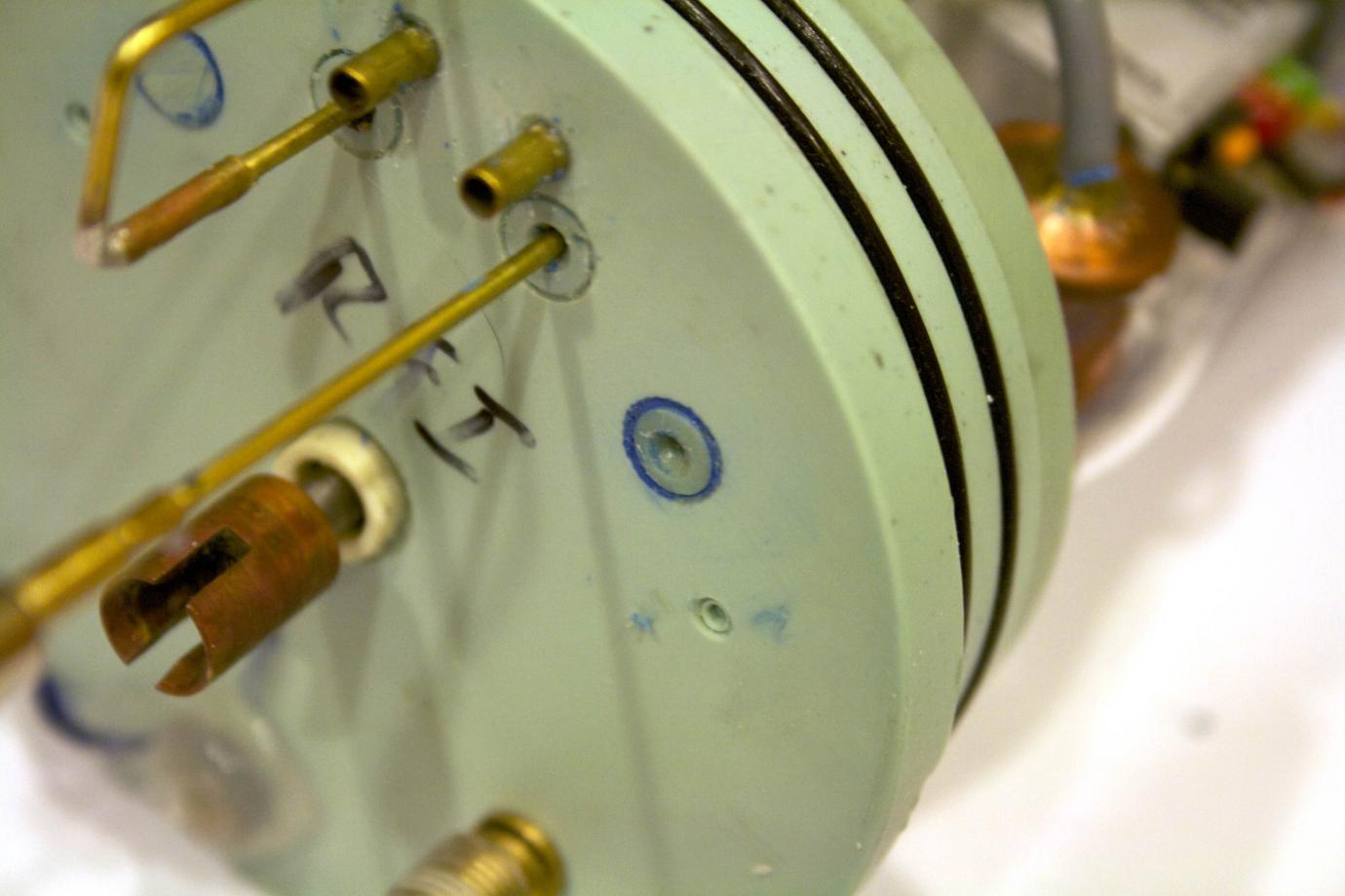

      It was a time to replace seal. The leak was coming from a seal in use and I am going to replace the un-used seal with a blank.
      Push the seals out. Usually relatively easy. These two were.

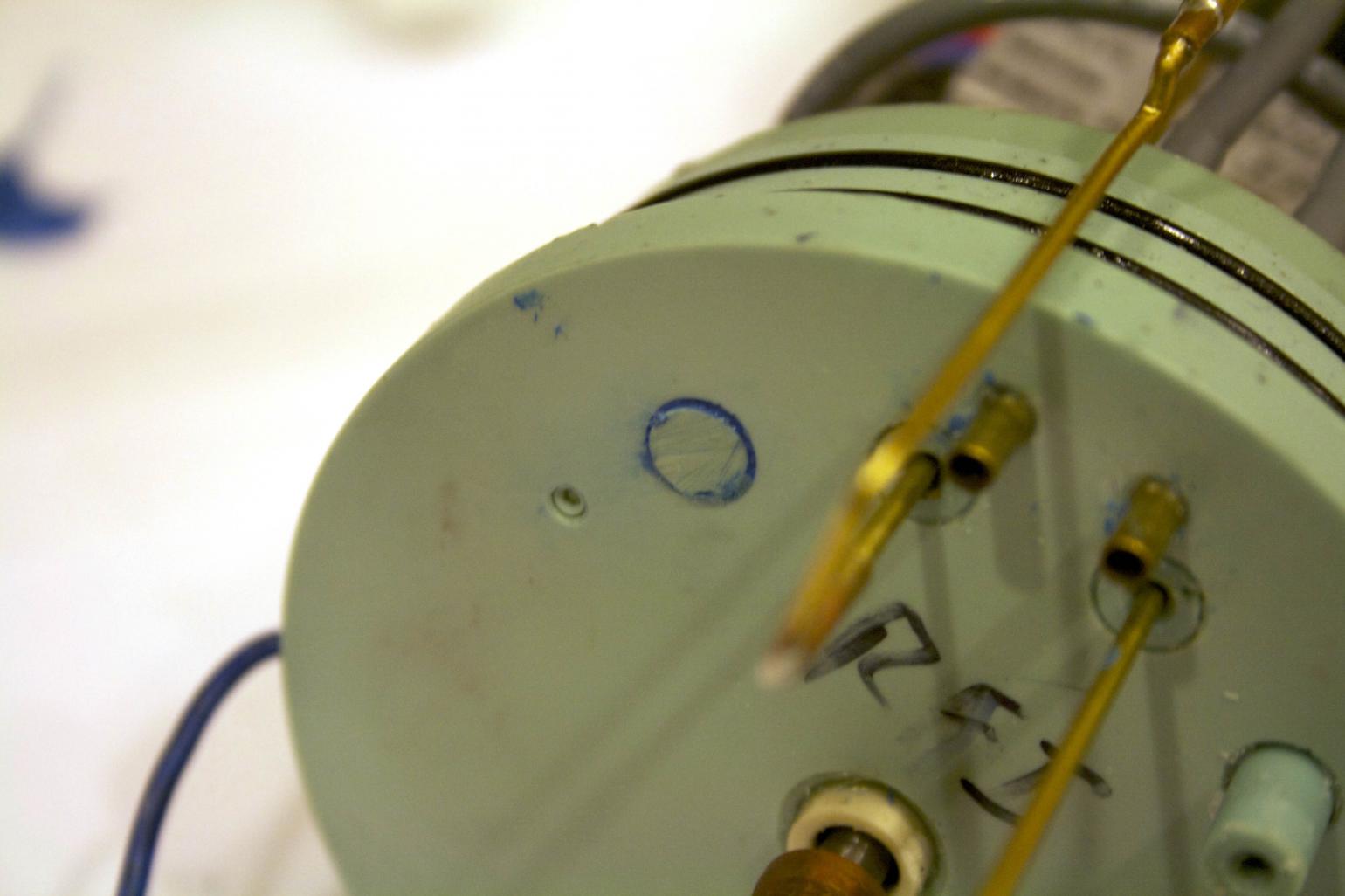

      Clean up the holes and remove the old silicon.

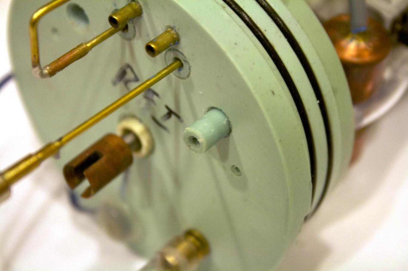

      The blank is installed.

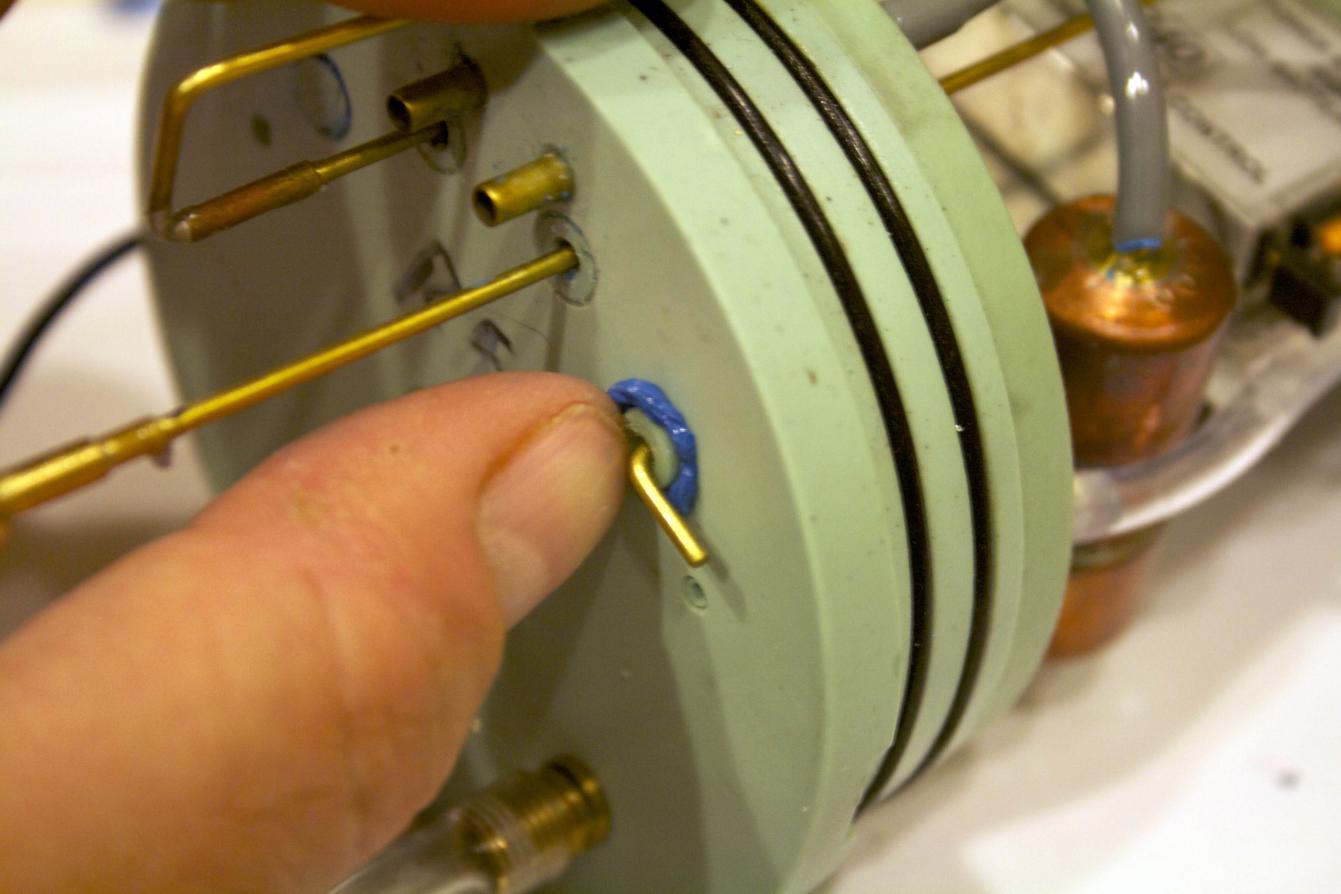

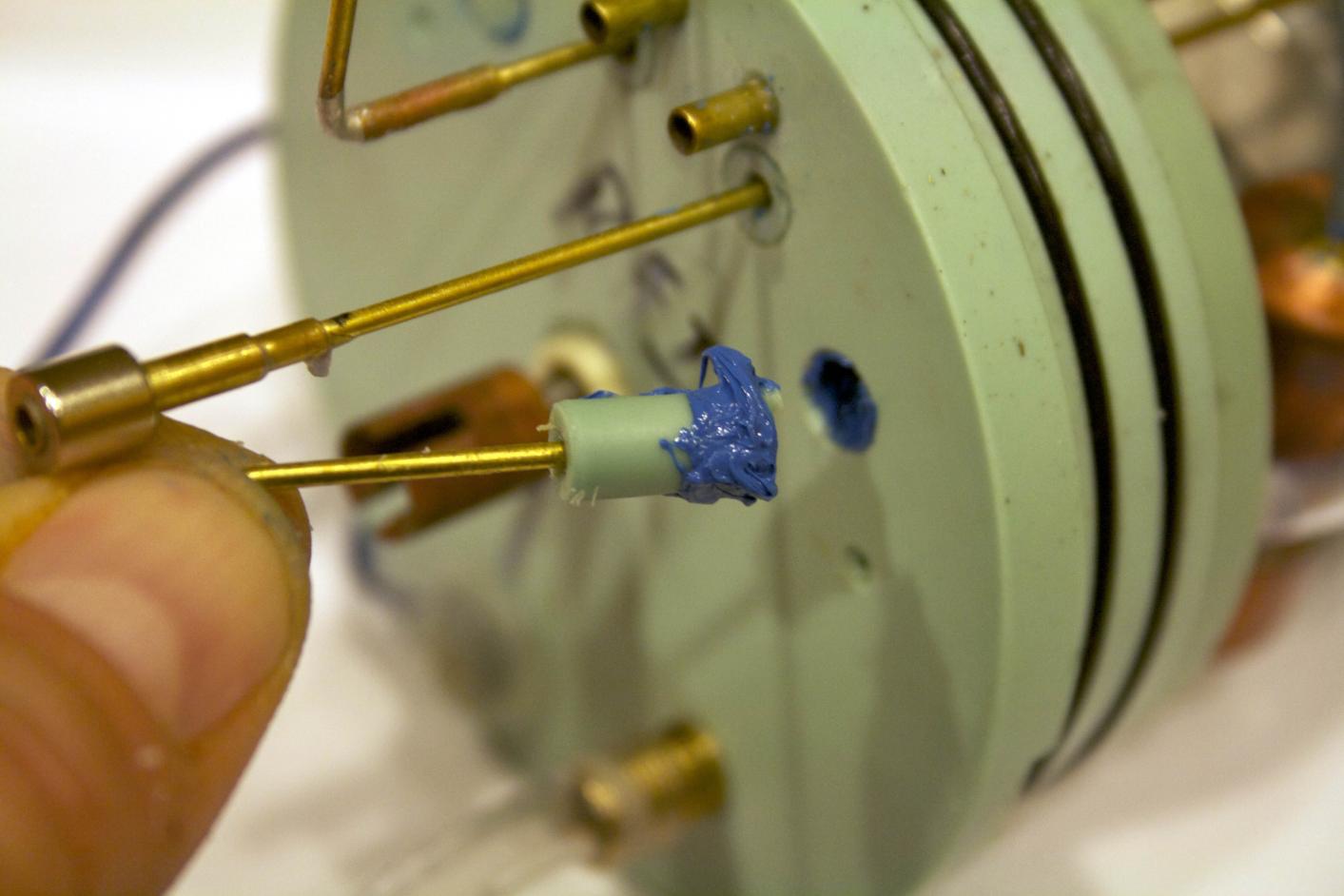

      The un-used seal is now going to be replacing the leaky one. I guess I should have documented the steps for the plug being put in. So here are the steps.
      A bead of silicon around the seal and a layer inside the hole.
      Slide the seal in with a twist. this will help ensure a could seal (but not always possible sometimes it just slides in and you cannot get a grip to give it that twist)
