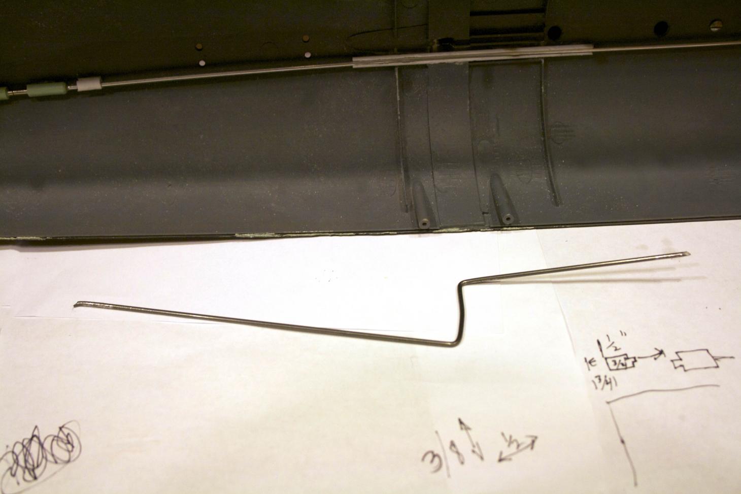

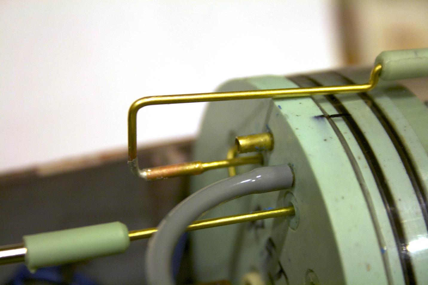

    A lot happened and I am not sure what I did was correct or the best way. If someone who has done this can share how they did this step, i would appreciate the knowledge.

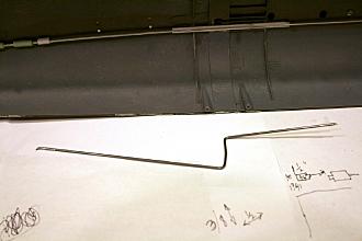

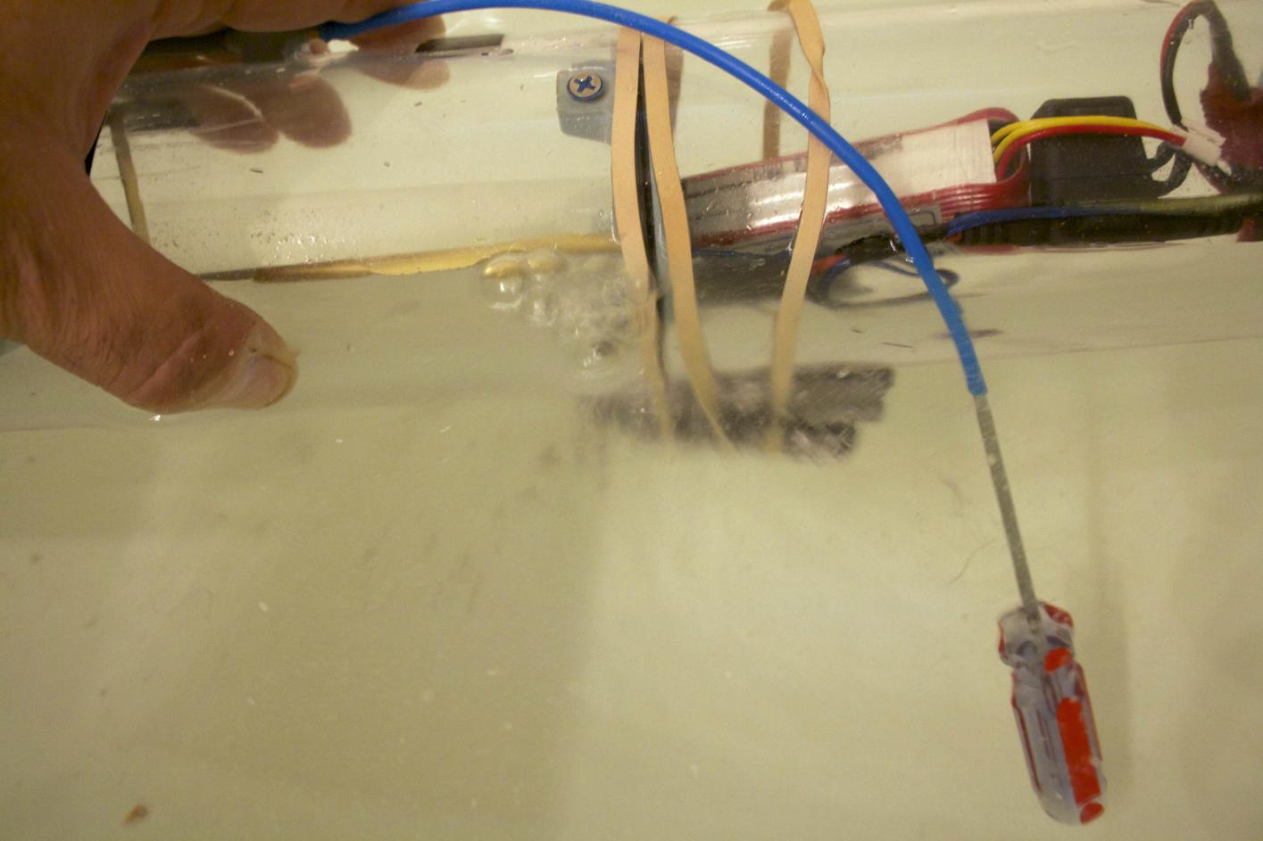

    I needed to know how much distance I have from the top of the cylinder to the upper hull. What I did was bend a wire that would go through the stand hole and line up with the cylinders that the top of the wire was flush with the top of the sub-driver. Also, where the wire exited out the bottom of the hull, I wrapped with painters tape (masking tape would work). Marked the point it exits with a pen. The top of the wire has a sharp point and when I pushed the wire up the tip would dig into the plastic and scratch. I also marked under the hull on the tape around the wire the point it now exits the hull. So when I pulled the hull apart. I measured the distance on the tape between lowered position and touching the top of the hull it was 3/8". The mark left on the plastic by the point was my reference point. With this I was able to see how far apart the top hull Klik-on was from my reference point I needed and an estimate of the offset.

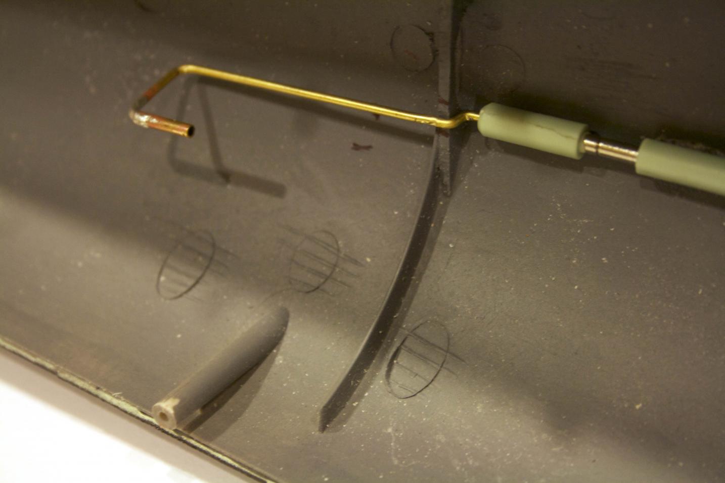

    A lot of measuring. The Klik-on needs to be raised 1/4", which is just about what my z bending pliers make it. As proud as I was about how it came out, there was a problem. That arch or brace I put in is in the way. I can dive, but surfacing will not happen because the rearward travel is blocked by that brace. Marked the area that will be cut away.
ID:	83526Click image for larger version

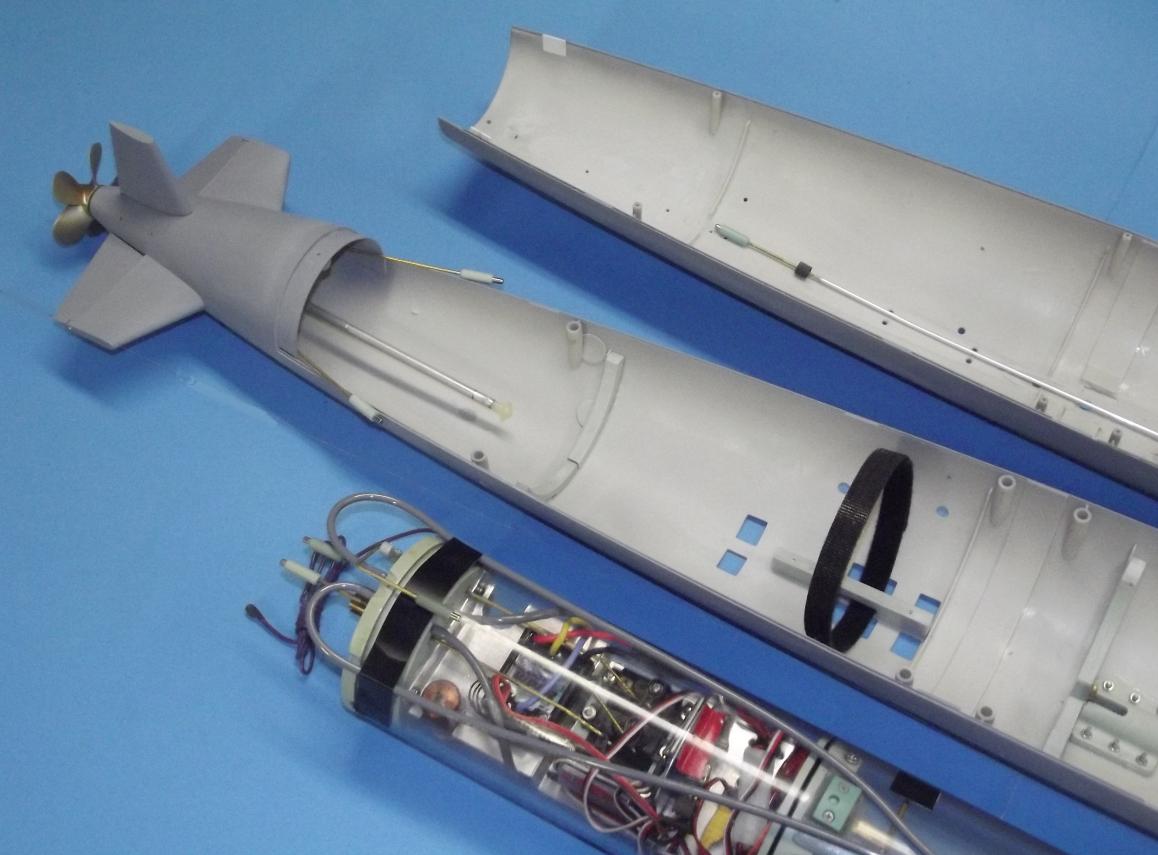

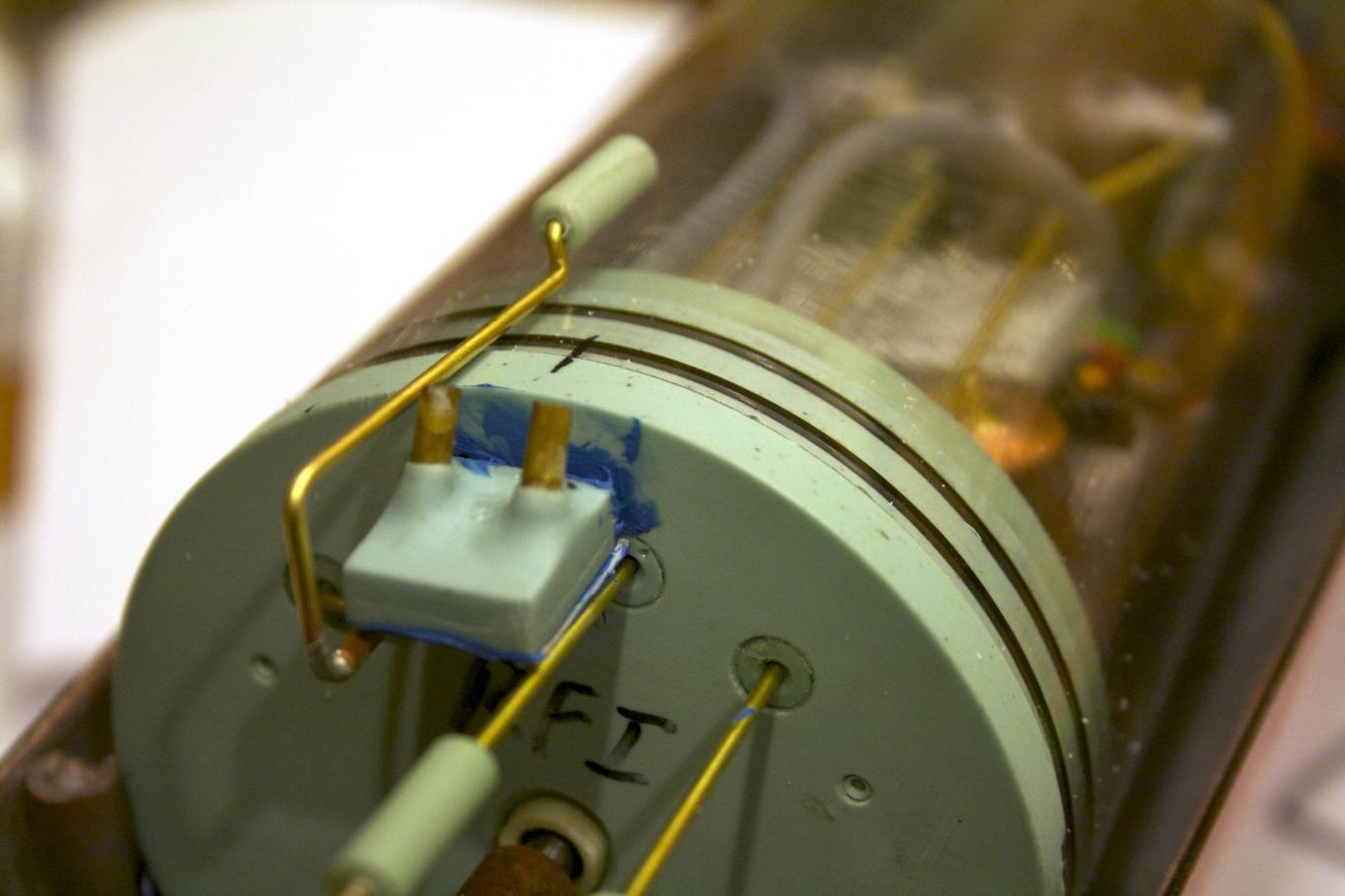

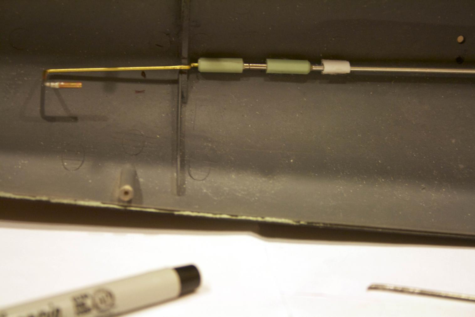

    Slid the top hull on and peeking through the cracks checked the way it lined up. Tacked the pushrod with a little CA. Then quickly closed the hull up. I moved the sail planes until I felt the magnets meet. Set it aside to let the CA dry a bit. Opened it up and put more CA around the pushrod I made to the one coming out of the WTC. Closed the lid again and felt it connect again.
    Another view.

      Put a piece of wax paper atop the SD, place a soft piece of clay on the wax paper, put a piece of wax paper atop the clay, and mash down the upper hull. Remove upper hull.
      Wa-La! Annular distance established.

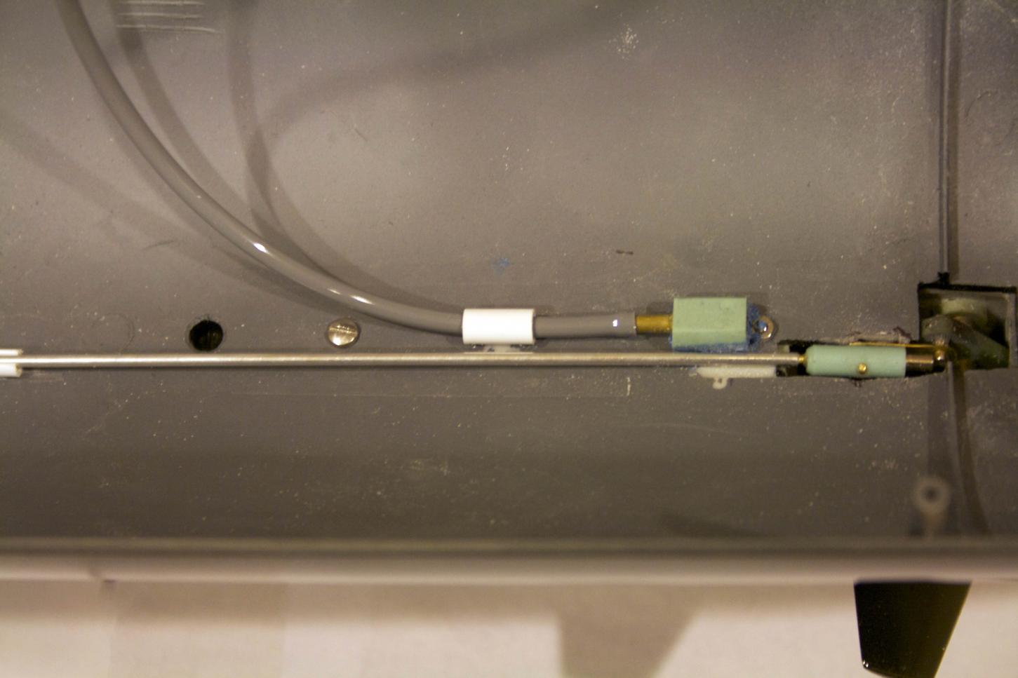

                  Began to install the air hoses.
                  Then as I was attaching the hose to the aft end cap, it broke off.

                    Hey, fumble-thumbs:

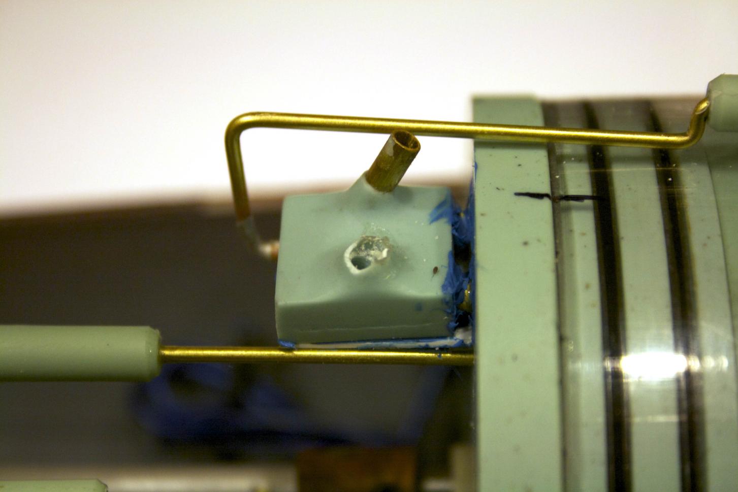

                    You'll find that you can't use the motor-bulkhead SAS manifold -- it sticks up too high and will hit the upper hull when you attempt to push it down in place. Don't use the manifold, rather run the flexible hoses straight to the induction and discharge nipples.

                      David that is encouraging that you like the WIP. It means a lot coming from you. A heads up earlier to not install it would have been better :-), but the information is out there for someone else not to mount the SAS manifold. I make mistakes and I post them (well mostly, I didn't post about the wind knocking my sail off the table and crud stuck to the sail or that periscope box was slightly too big because I assembled it with the fore and aft walls on the outside instead of the inside plus that latch - correctable, but would be a time consuming thing that I will fix later) Which is why I recommend waiting until she gets her maiden voyage before following what I did.

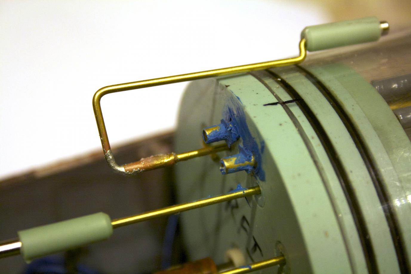

                      Taking the manifold off was not a big deal, it took a careful prying it away. I love RTV silicon, especially this blue stuff. I took some Acetone and carefully cleaned the surfaces and then picked, pull, scr@ped the rubber off.

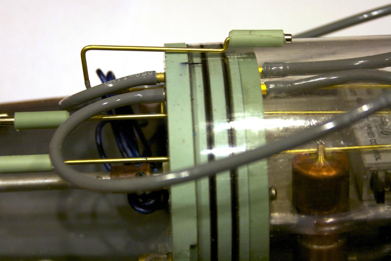

                      Cleaned the sail pushrod off and realigned it (applied some CA, slid it on, then sealed the hull and moved the sail plane until it engaged. Let the CA solidify. Ran one hose (the other one will go on later after the pushrod connection dries completely).
                      Just cannot think my fat fingers pulling the hoses off these nipples will not eventually knock something else off. I might need to build a couple of connectors to make the process easier, but again the motto get it running first than add do-dads comes to mind.

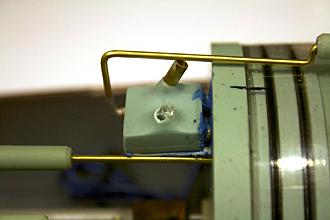

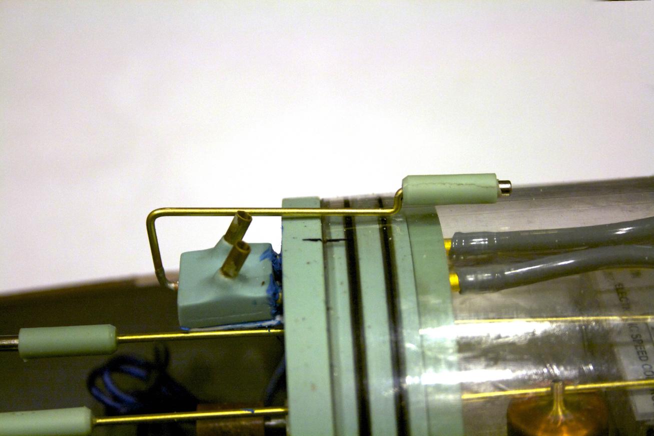

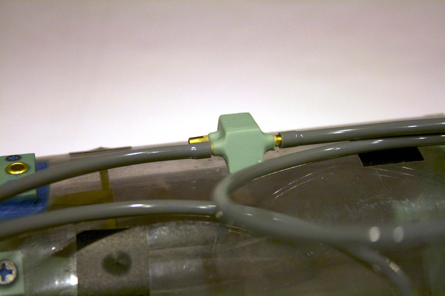

                          Finishing the hose connections.
                          The sail connection gets a strain relief. In this case it is a larger diameter plastic tube.
                          The air hose will be cleaned up at a later time. I have a connector I made, that I will need to test with a SAS system.

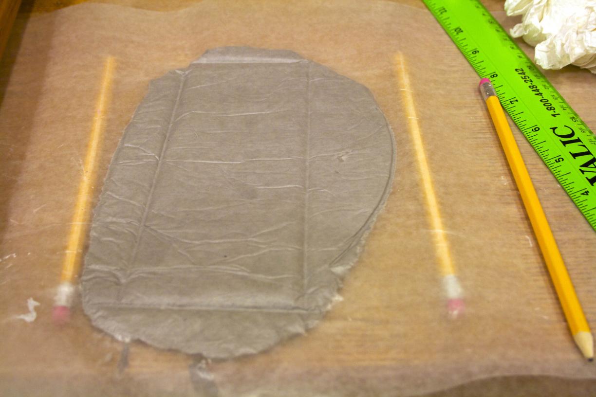

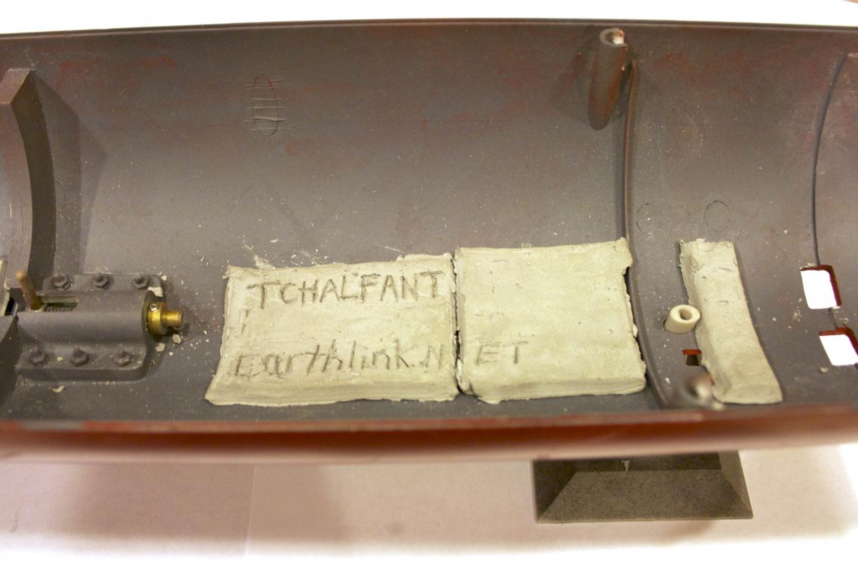

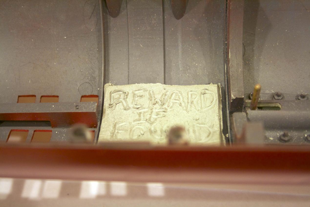

                            The weights needed to be made.
                            Rolled out some potters clay. It was rehydrated, but a little too much. It was left for a day to ry out
ID:	83624Click image for larger version

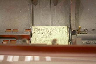

                            Once it was in a useable condition, I measured and trimmed the clay to fit. As a whim, I carved a message and info into the clay.
ID:	83628Click image for larger version

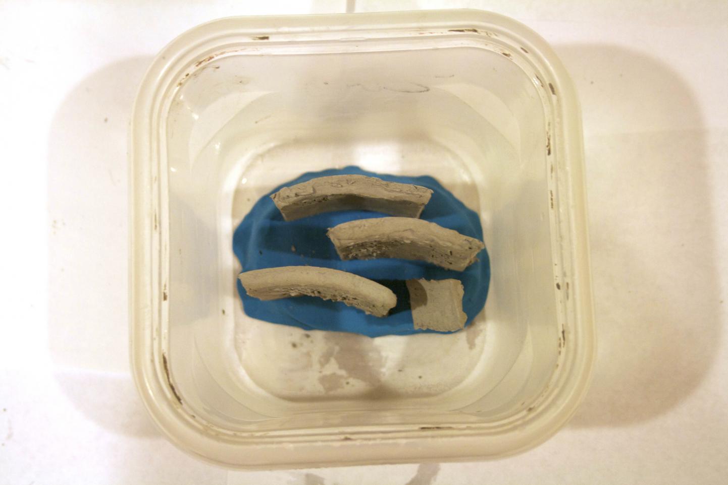

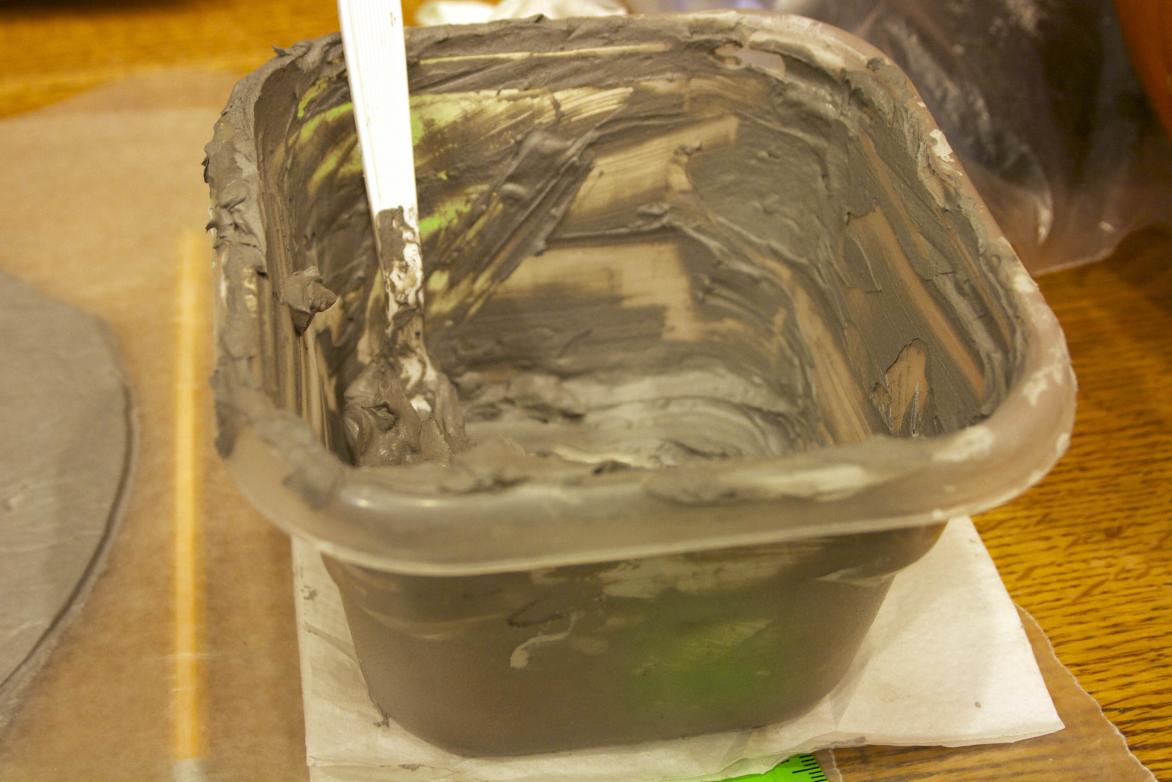

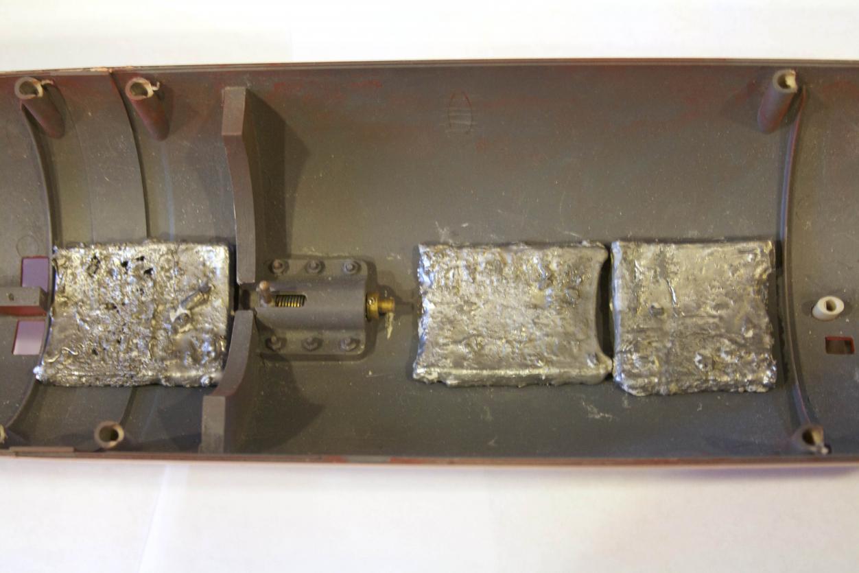

                            Once dry, I put modeling clay in the base of a disposable plastic storage tub. Then stuck the clay pieces into the the modeling clay. I used plaster to fill the tub. I did not take pictures, but the process was once the plaster solidified, I dug out the modeling clay and soaked the plaster block in water. The potters clay will rehydrate and get soft again. Using a long toothpick or a bamboo skewer cleaned out the remaining clay.
                            I really rushed this last part. I put the plaster block in the oven on low for 4 hours (usually let it dry for a day or more). Melted some lead and poared in. Unfortunately the moisture cause steam and bubbling. There were no legible letters, but I had weights.

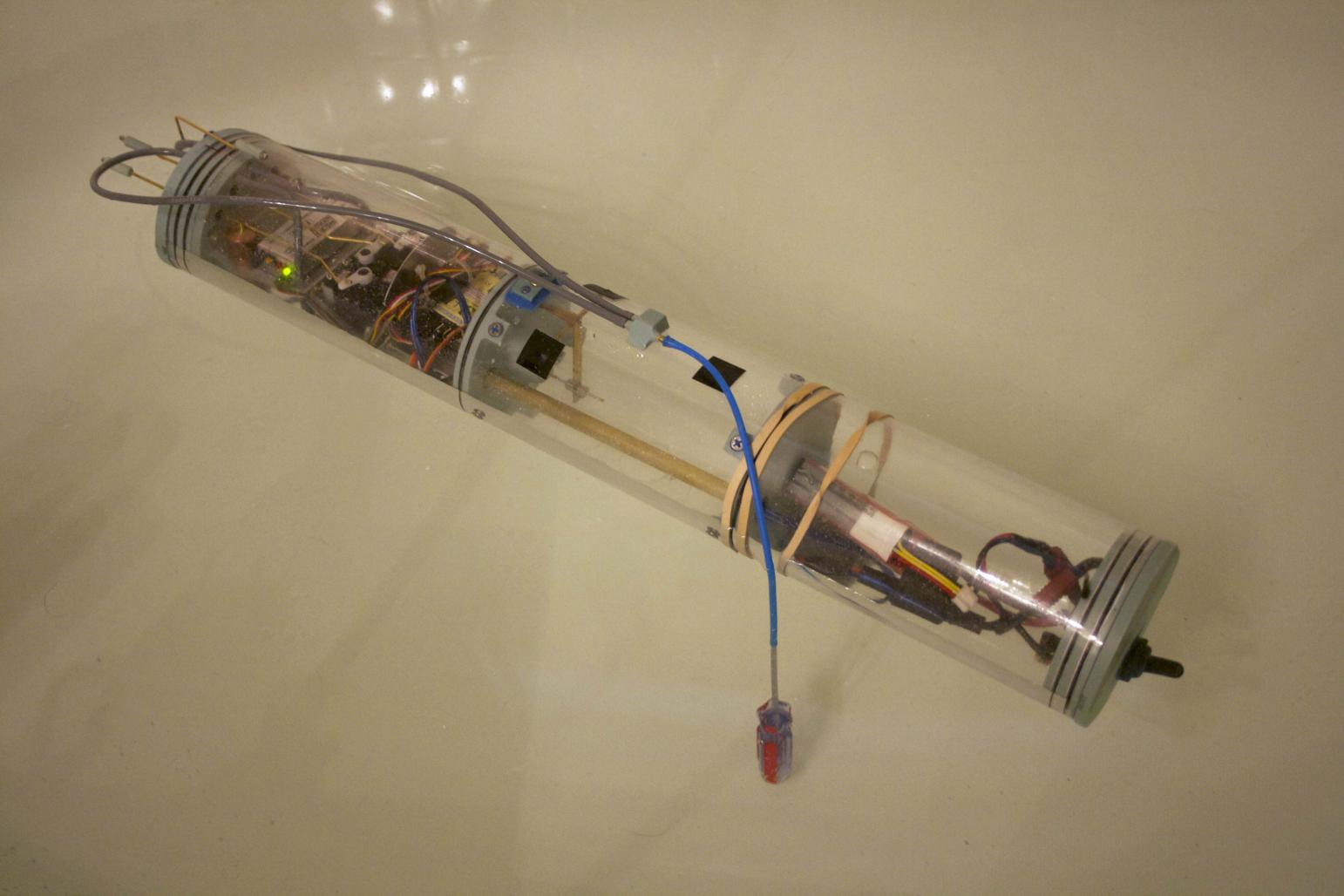

                            Tested the sub-driver in the tub. Everything stayed nice and dry. The only place that air bubbles showed up was from the side screw in the ballast tank. I will put a little RTV silicon in there.
