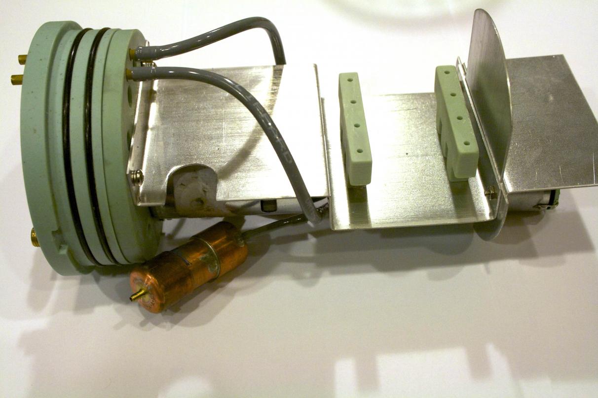

            Looking over the Sub-Driver (the name specifically for David's WTC) you will quickly see she is a beauty. Opening the wtc was a little tough, but David built notches into the edge for a flat head screw driver to enter. I did not see any bubbles or weak castings looking it over. Once I got it opened the safety float valve plopped out. That surprised me, but once in the cylinder it does not appear to move that much. There were some areas that I have questions about.

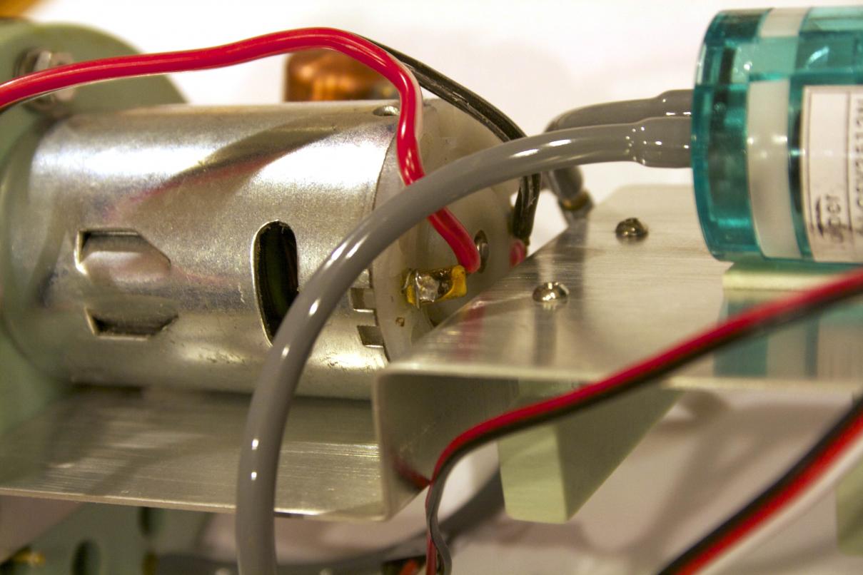

            I noticed there are no capacitors attached to the leads on the motor. Perhaps they are built inside, if not I think they should be added especially since the antenna runs under it. I will read over the cabal reports and postings again to see if I missed something.

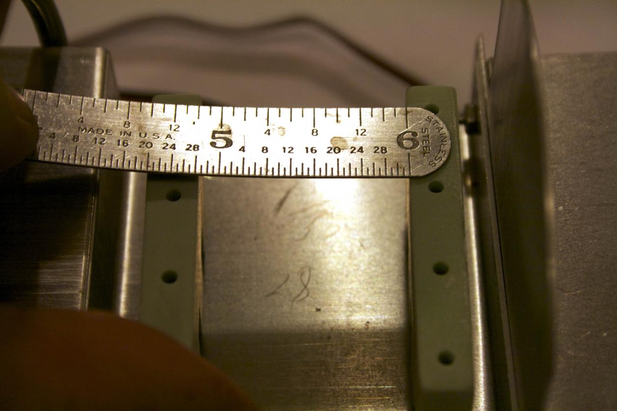

            My micro 9 gram are too small for the current distance, but would they work? If not, I will buy some mini. The space between the brackets is 1 3/32" or 28mm.

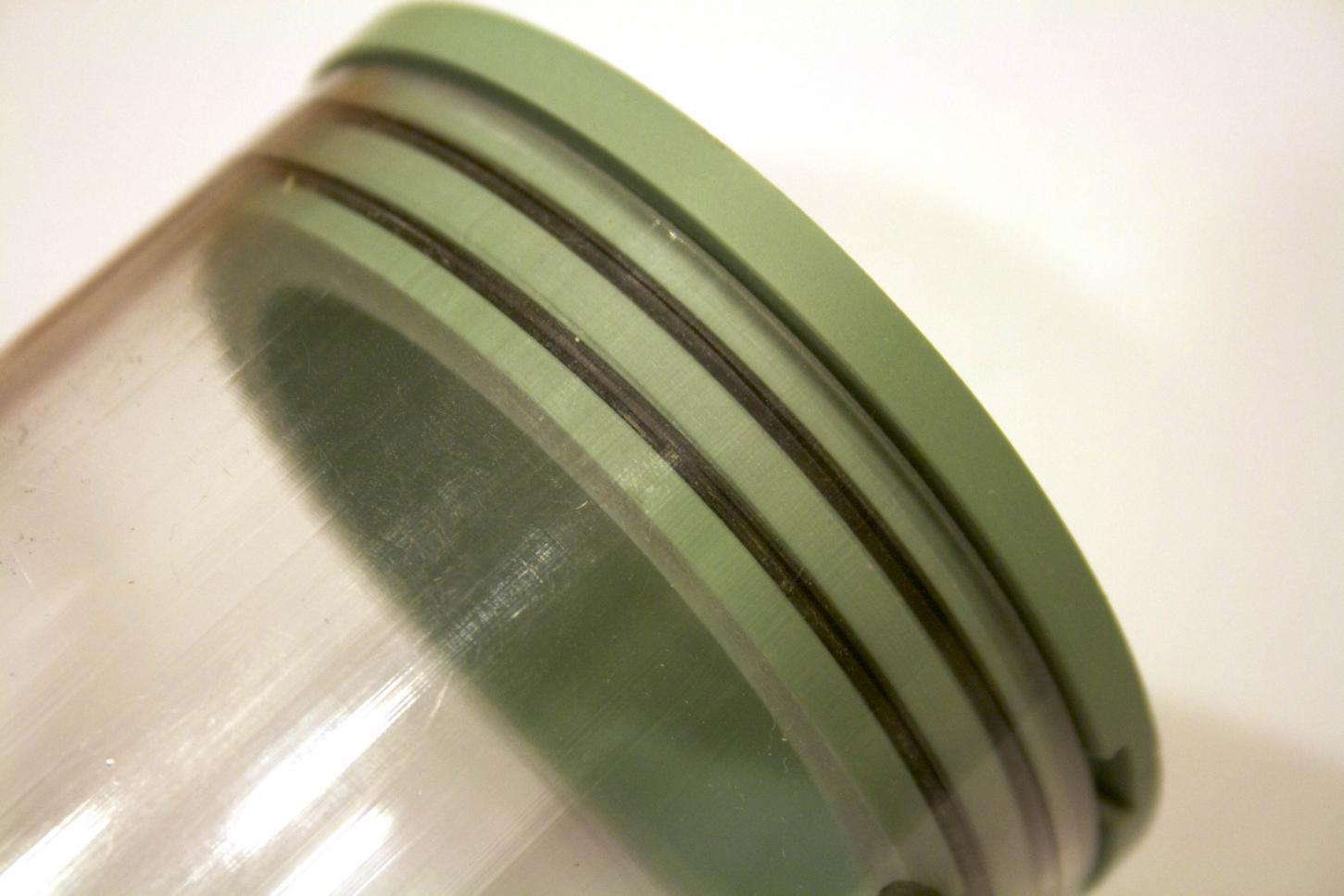

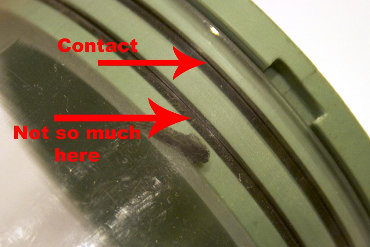

            This concerns me, the o-rings on the bow end of the etc look to have light contact or no contact. I will need to add a wrap or two, three of plumbers teflon tape, like I did on the Gato.

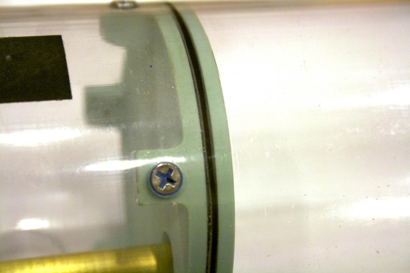

            Another area of no contact with the cylinder. I did not have a switch in my parts, so I will need to order one.

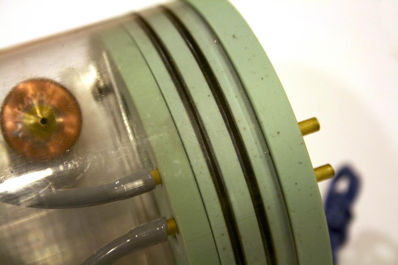

            Aft end has one o-ring with great squish and one with so-so (but ample to seal)

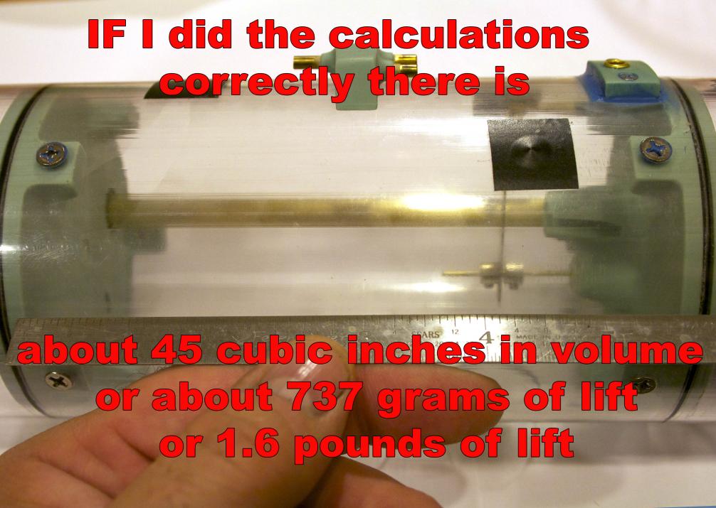

            This baby has lift!
            If, and that is a big IF, I did my math correctly, it looks like this ballast tank has about 1.6 pounds of lift. In Tim the Toolman Taylor grunt "arr,arr,arr"

                Those motors have internal spark suppression capacitors, Tom. You're good.
                Mike found a source in China that would install them at the factory -- it's great to have the clout of the Caswell Company working for us. I could never arrange for that kind of consideration when I was buying them ten at a time, not by the hundreds.
                Spring for the mini's -- lots of force coming off those bigger control surfaces, Tom.
                Yeah, hit those forward bulkhead O-ring grooves with some Teflon tape. Or, send me your address and I'll send you a replacement forward bulkhead (but no guarantee it will be tighter -- each bulkhead has to be custom fit owing to sloppy industry cylinder tolerance adherence).
