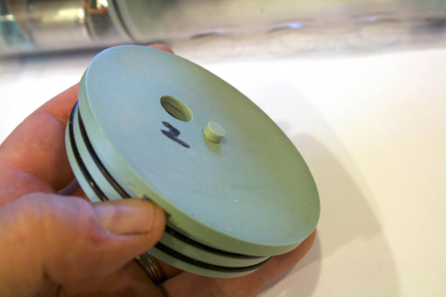

    I just noticed today that the battery room end cap has a plug in the center that is not secured (pushed out to show it). I assume it is for those that want to add torpedoes or have some way to exit sub-driver, cool. Not so cool if I did not catch it.

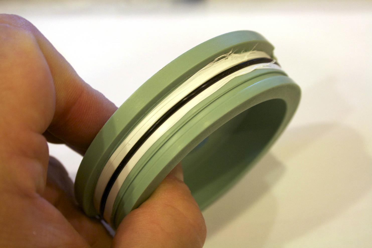

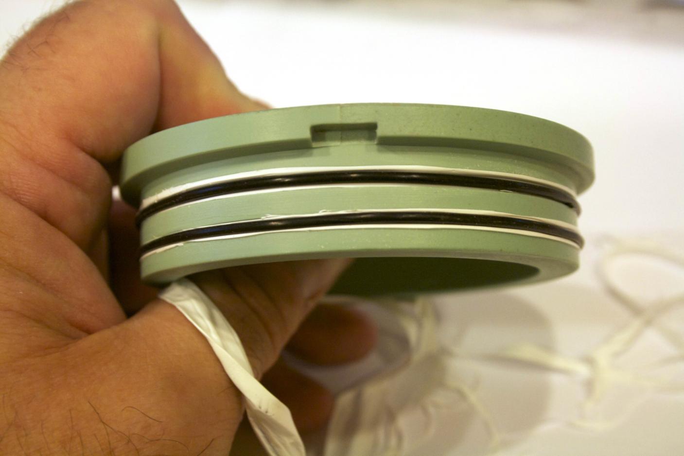

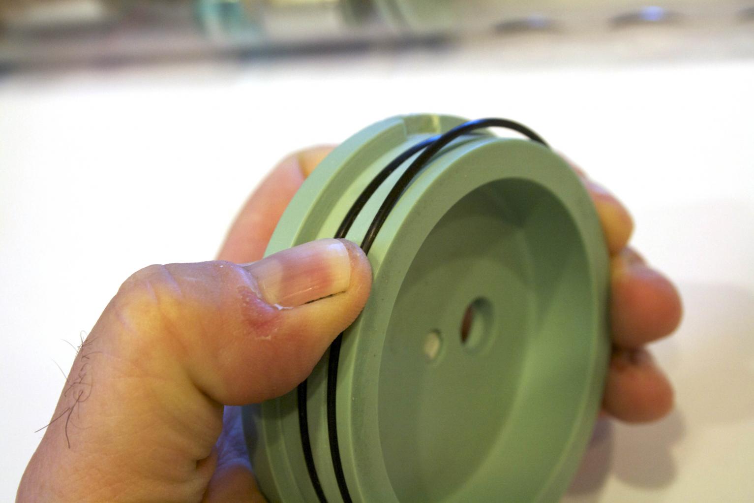

    Earlier I saw that portions of one o-ring did not have contact to the Lexan tube. Today I wanted to take care of that. Removed the o-rings by pinching both sides of the end cap and sliding my fingers to the top. At first, nothing seems to be happening, but eventually you get a small hump at the top.

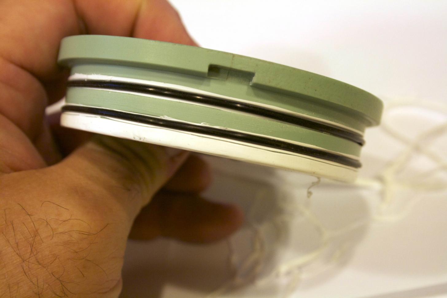

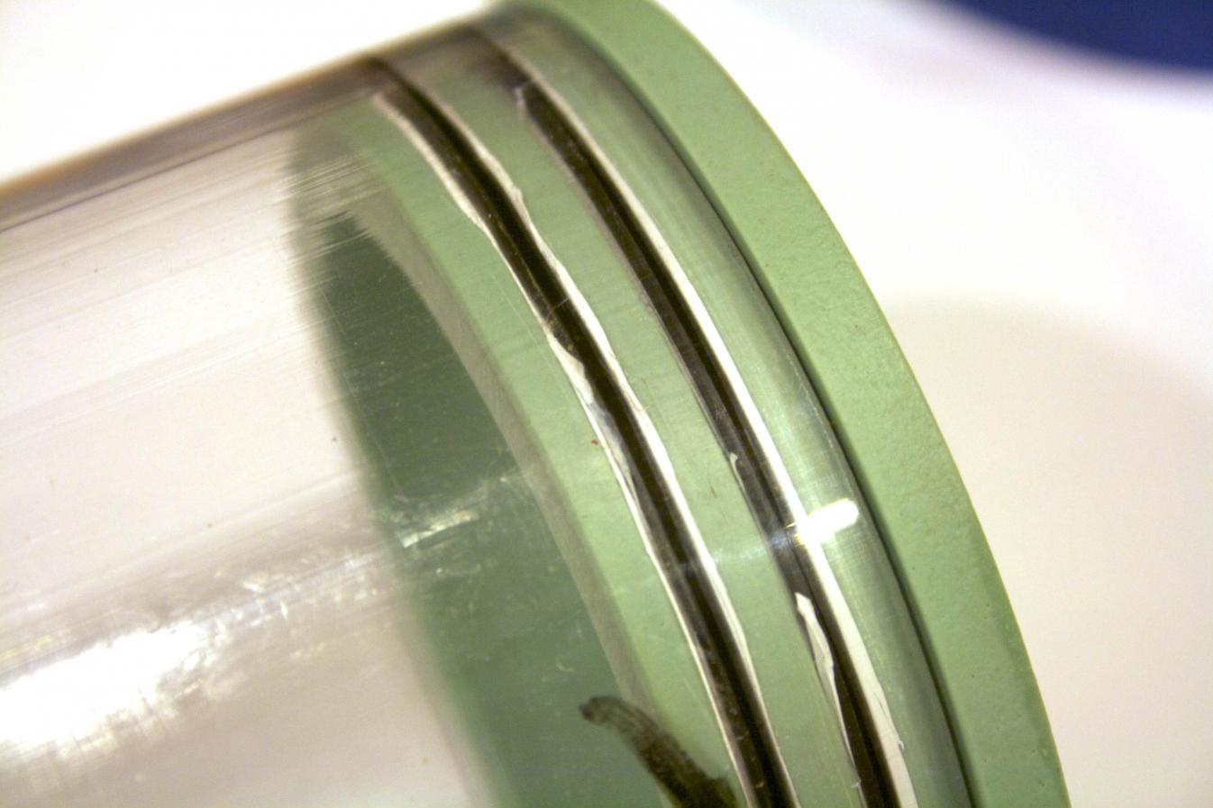

    With the o-rings out, the outer most o-ring had contact all the way around albeit thin. So, on this channel I wrapped Teflon tape 1 1/2 times around thinking that would be enough.
    Then the innermost o-ring I wrapped 3 1/5 times. Using a sharp X-Acto #11 blade, trimmed the extra tape off.
ID:	83230Click image for larger version
    The innermost o-ring's contact is now great. The outermost o-ring probably can stand a extra wrap or two.

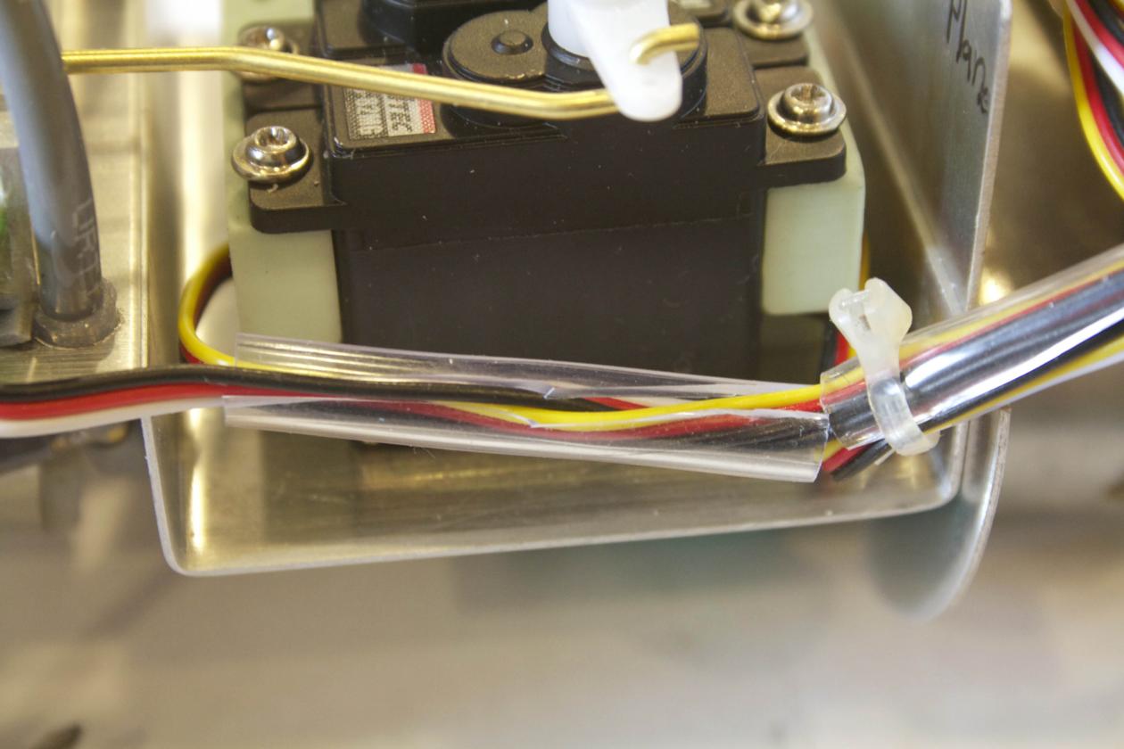

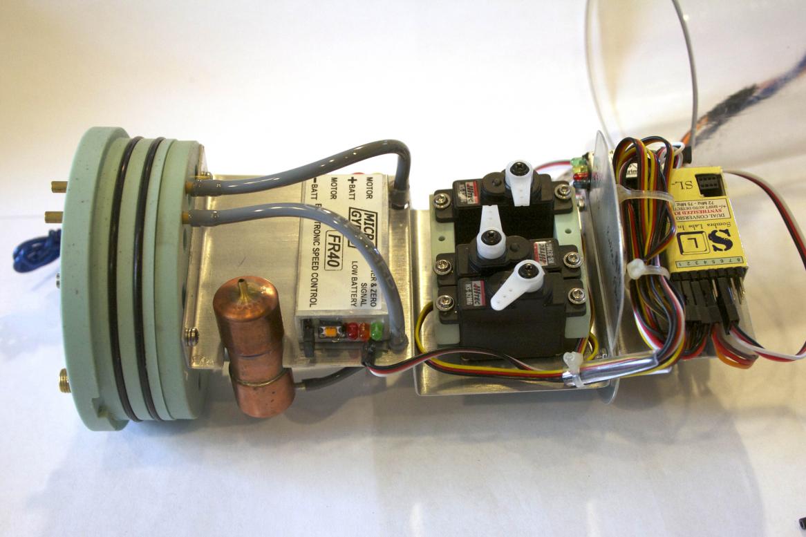

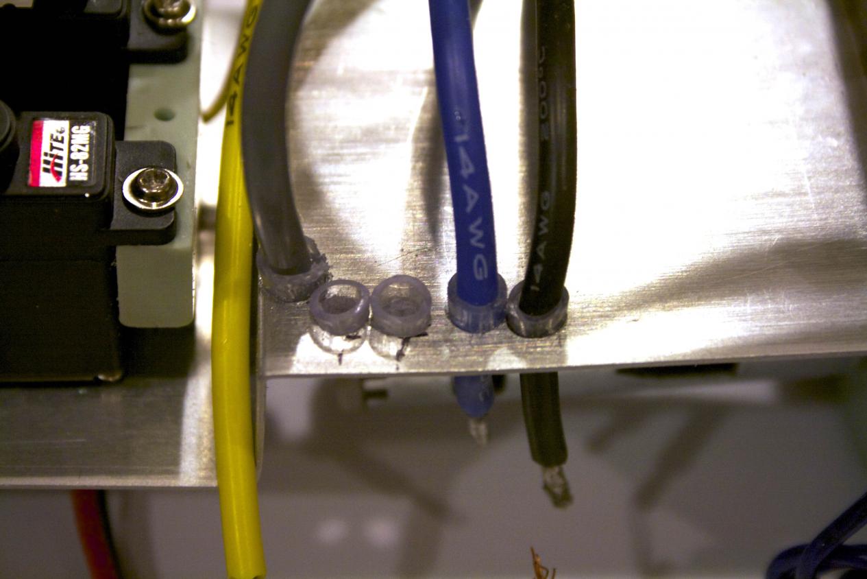

                  The tangle of wires begins. I am learning and playing as I go. Trying to make the wtc look clean, neat, and organized is a challenge for me. On this Sub-Driver I am going to play with different ideas. 10 years from now, i will probably look back and think what the heck was I thinking. One of the areas I am going to play with is routing the wires. This is not necessary for wiring up the Sub-Driver. it is just a detour for me.

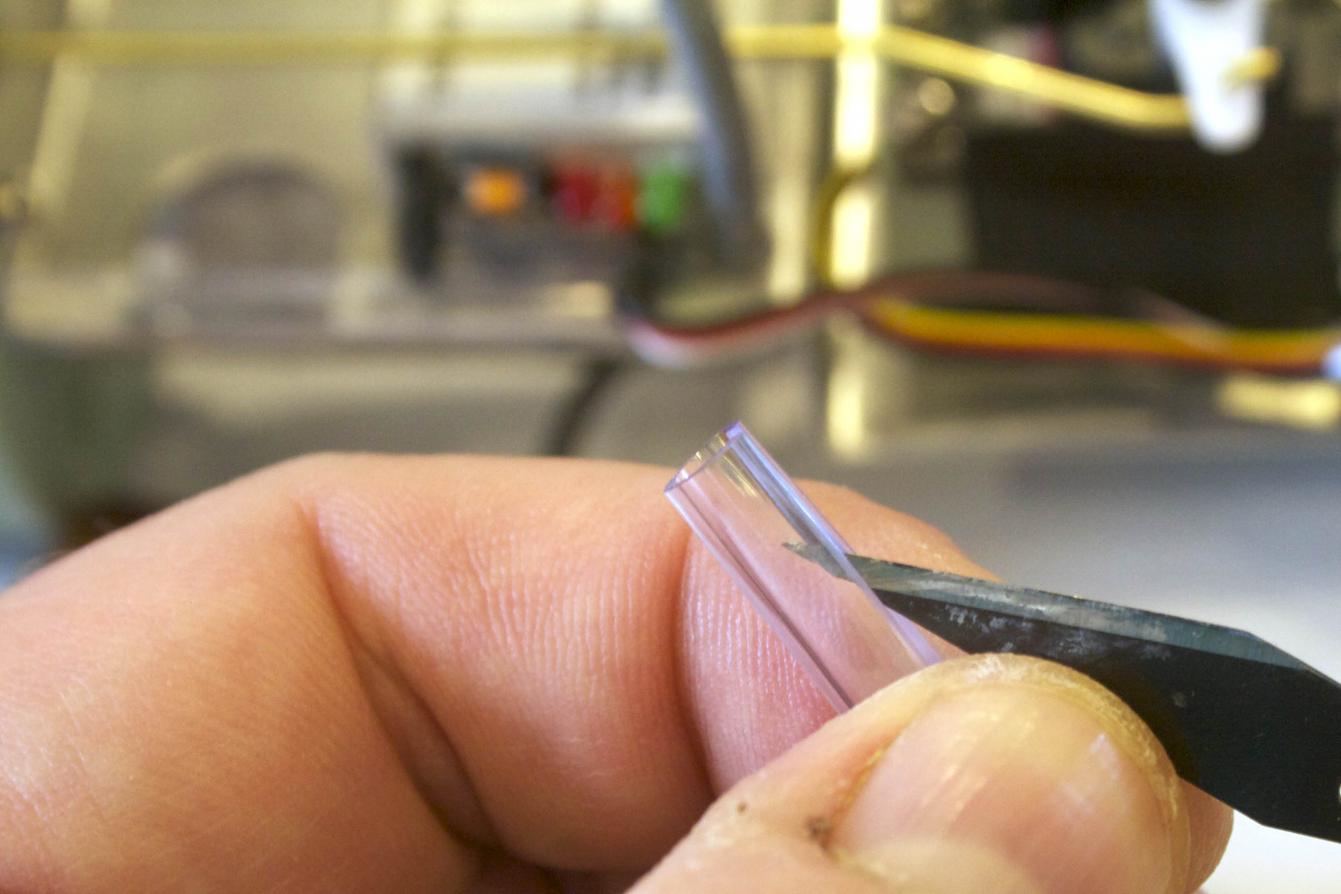

                  We just bought some tubing for Sam's aquarium and I thought, scary I know, maybe I could clip a little off and use it.

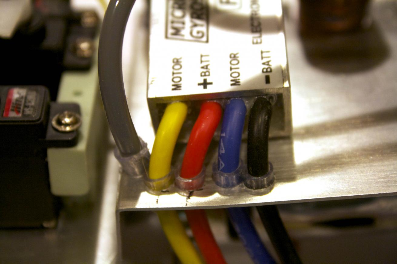

                  The wires fit in the vinyl tubing and made a great protection for the wires going through the metal. It worked for the SAS air lines as well.
ID:	83279Click image for larger version
                  A little bit cleaner.

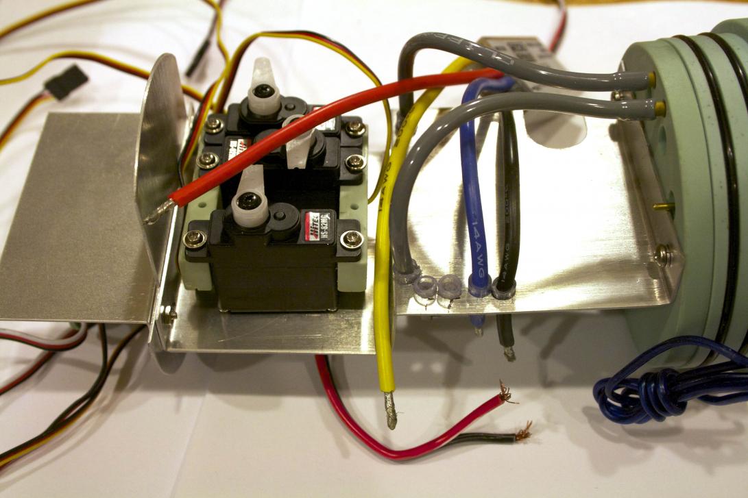

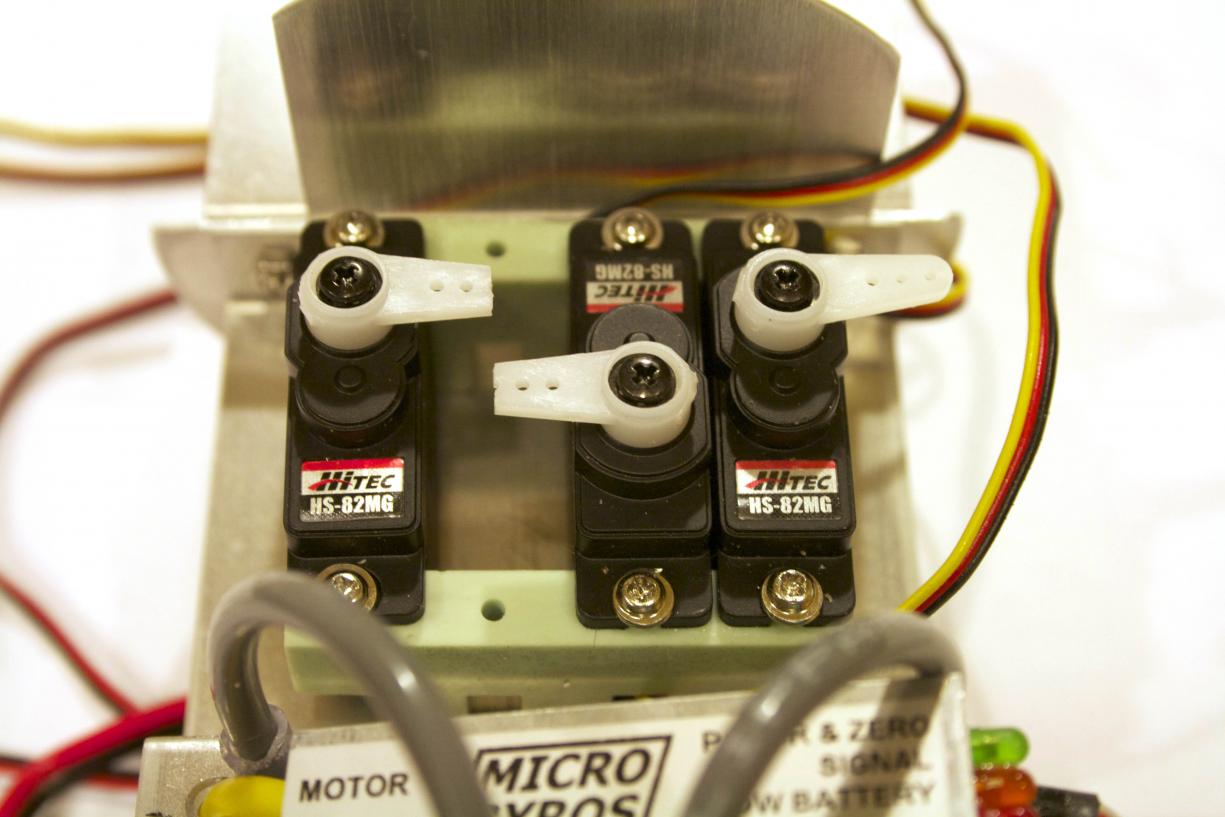

                  These servos have a 28mm base which fit perfectly in the servo tray.

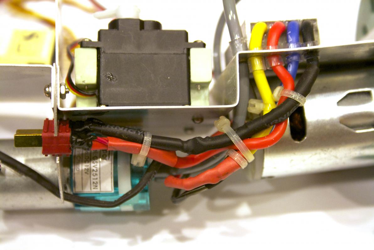

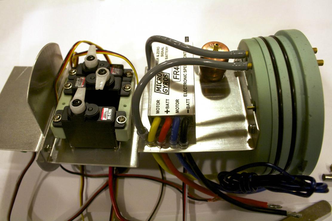

                            Scout's are now selling popcorn (anybody want some?), so my days are filled. I was able to get a bit more done.
                            Bundling and soldering.

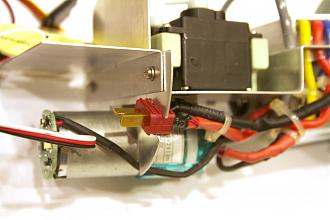

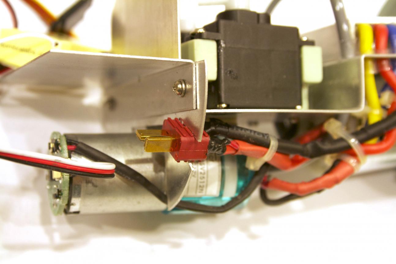

                            Cut out a notch for the Dean's style plug to fit into.

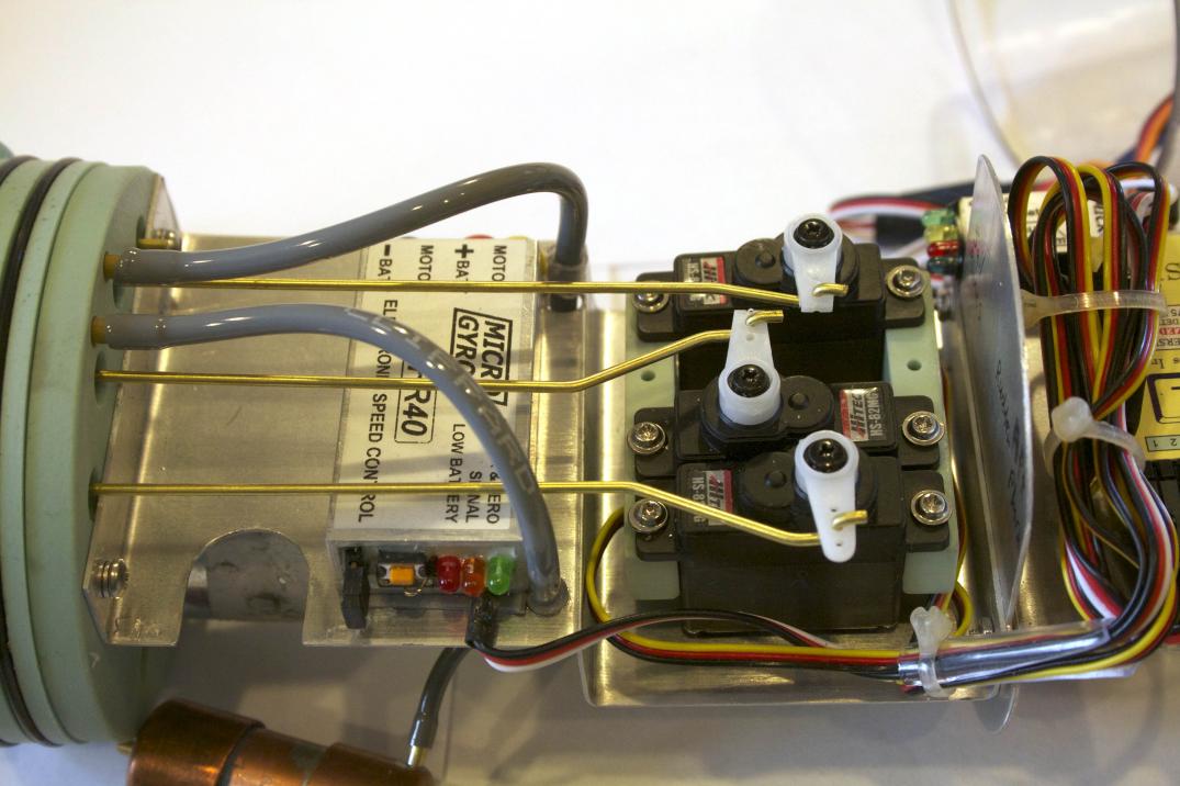

                              I put a LiPo 11.1v and fired it up. Oh my goodness - the power, it surprised me. Note limit speed to 50% on the radio.

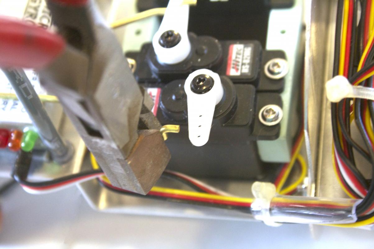

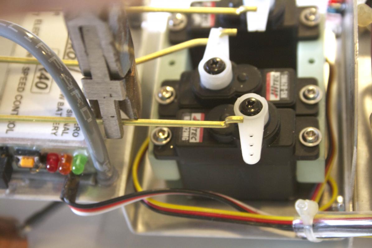

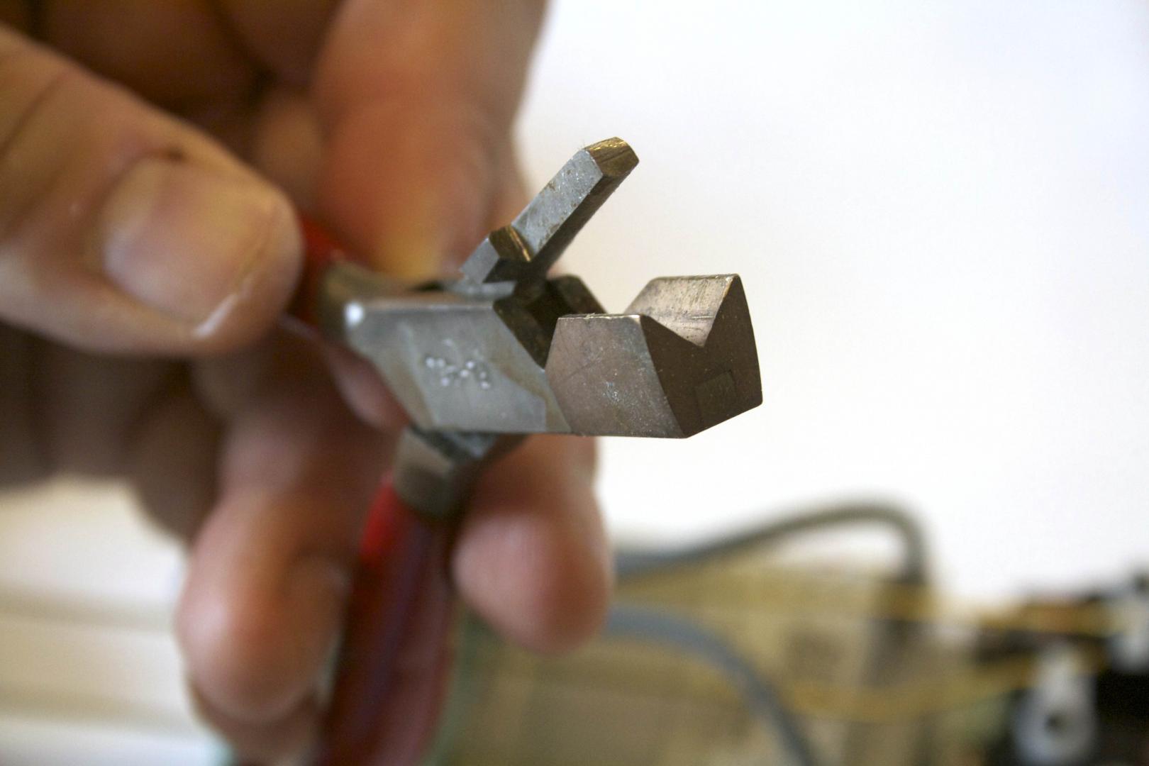

                              The Bow Closing Plier was used on the Gato (http://forum.sub-driver.com/showthre...72-Gato/page18) and makes it really easy to bend the wires. This plier is used in jewelry for bending the shank of a ring.
                              Making careful bends to make the pushrods line up.
ID:	83432Click image for larger version

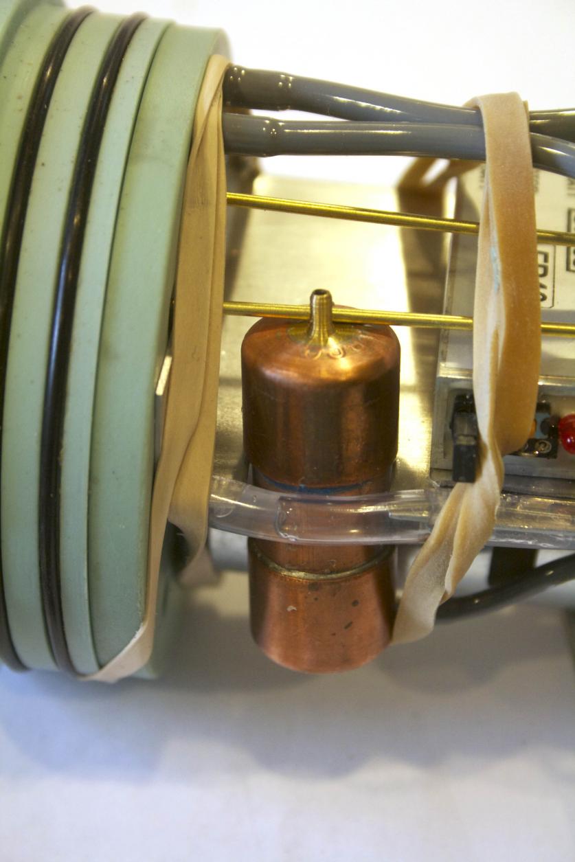

                              Here they are connected. That dog gone safety float valve keeps flopping around, it is beginning to annoy me.

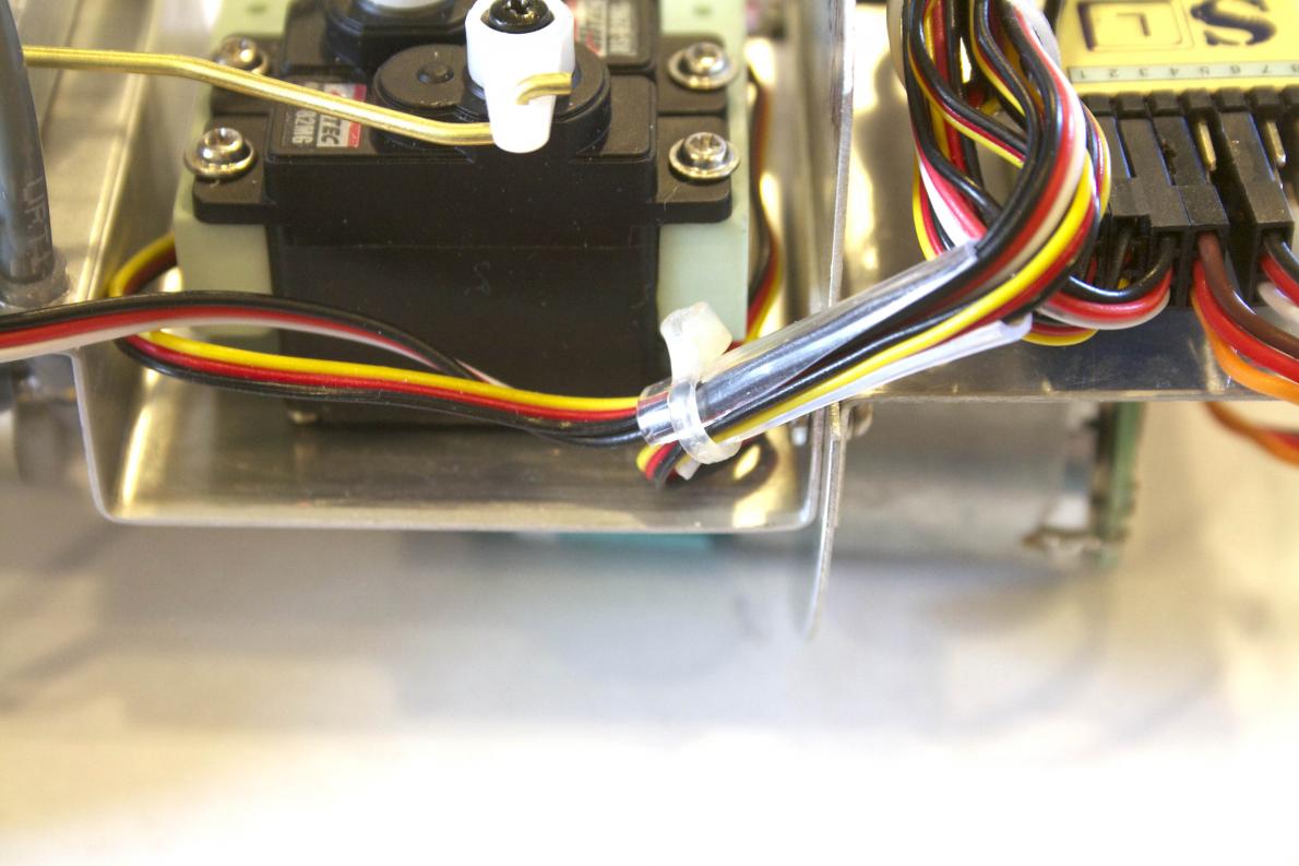

                              Taking some more of the air hose (hopefully there will be some left for Sam's fish) sliced it down one side.
                              This now became the wire harness to manage the servo cables. The bundle stuffed by the receiver will be eliminated later.
ID:	83436Click image for larger version
                              It also will become the safety belt for the safety float valve. If this silicon will hold, might need to pin it.

                                #90
                                Neat Tom, i too like my stuff to be as compact as possible on the rearpart, where did you order those bendingpliers?, i can use that plier also for future projects.
