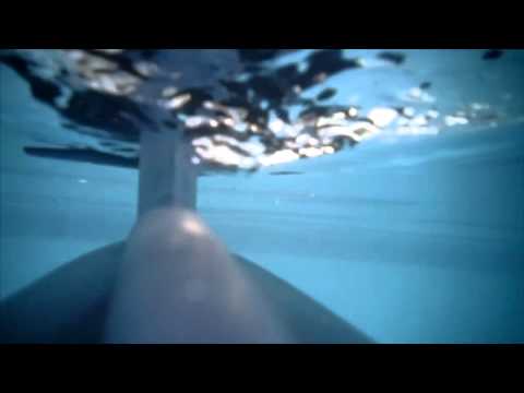

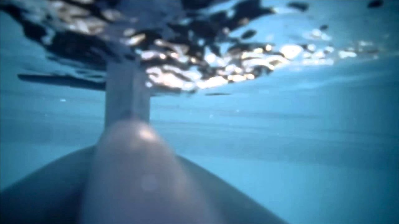

      A video using 3 different cameras. O.K. I am not a videographer. Hope you enjoy anyways.

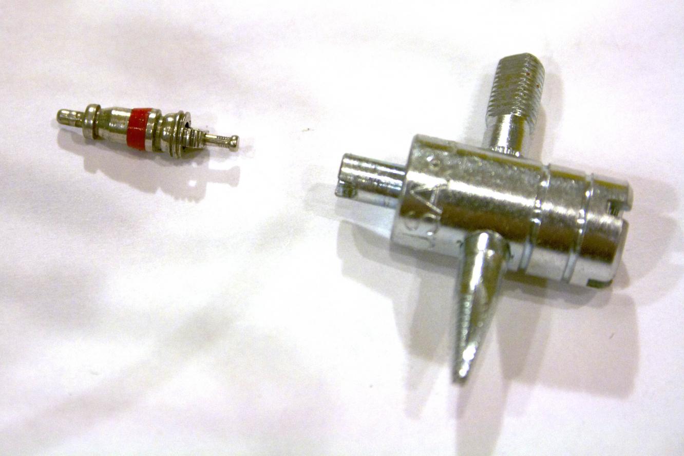

                  This will be very basic to some, but in an effort to help those first timers trouble shoot.
                  First I will try using a vacuum.

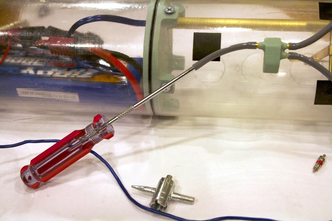

                  The schrader valve's stem is removed by unscrewing it using this tool available at any auto store or department that sells auto, bike, or tires.

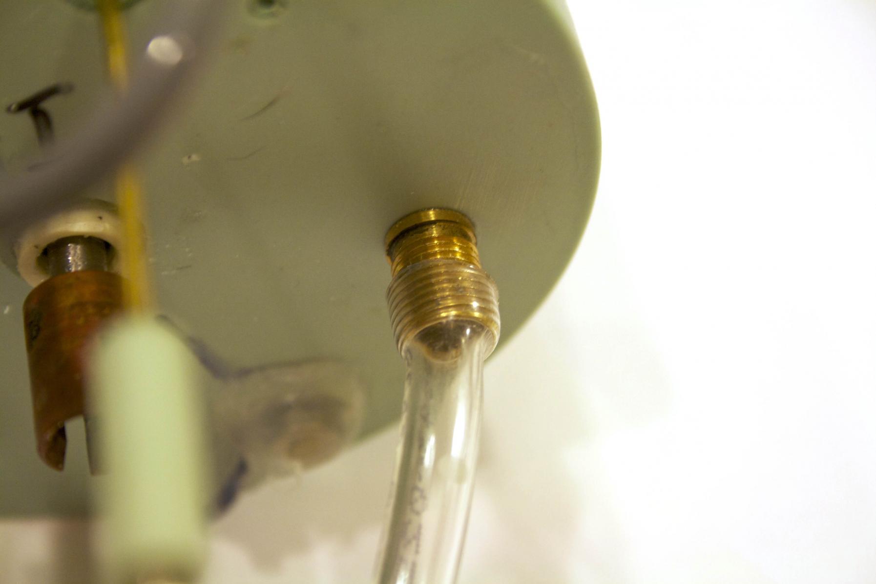

                  Attach a vinyl tube (This tube is 1/4" OD x .17" ID) This will serve as the port to suck the air out or push air in as needed.

                  In this case I was surprised.
                  The battery compartment was leaking pretty bad. It is the o-rings. I had not replaced the one that was nicked and the second one was allowing water to stream in. The amount coming in was at a rate that I could not continue. After I got the unit out of the water, there was some water in the engined room too. So once I get some o-ring replacements, I will do this again.

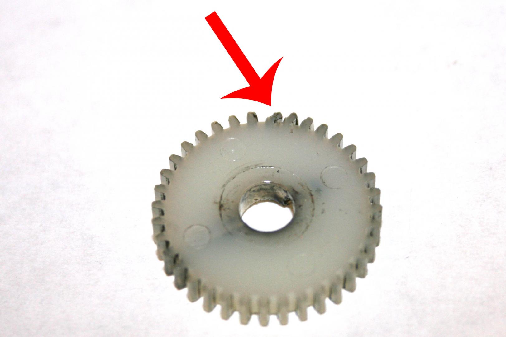

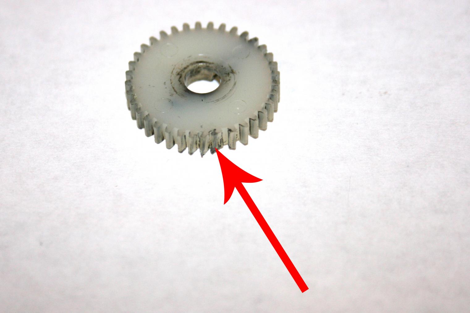

                            Something I heard towards the end of the run was a ticking/growling sound that was in sync with the speed of the prop speed. Since she is in dry-docks, I tried to turn the prop by hand and as it turned it would catch or bind. Opened up the end cap showed me this:

                            Yes, I bent a tooth in the gear.
                              #239
                              Must be a factory defect. If it was an alignment problem, there would be more than one gear tooth worn. That gearbox is usually trouble free.
                                #240
                                Im sure Dave can fix you right up. But , if need be you can buy those from "Stock Drive Products"
