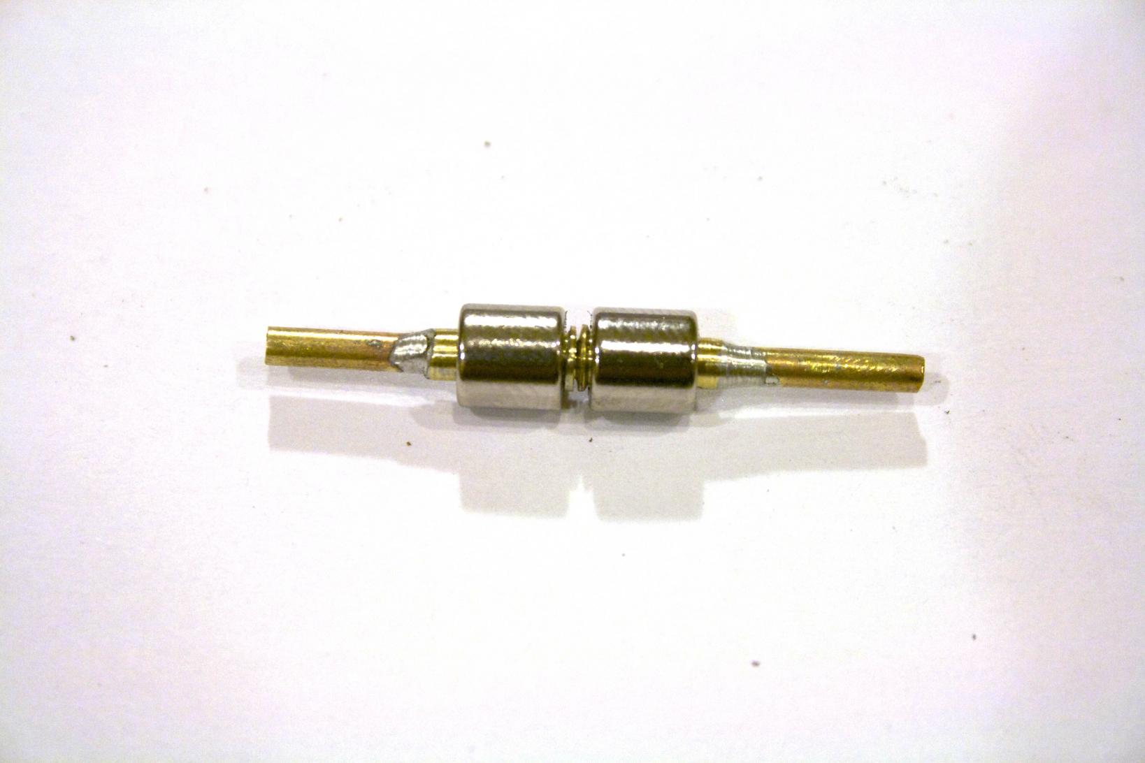

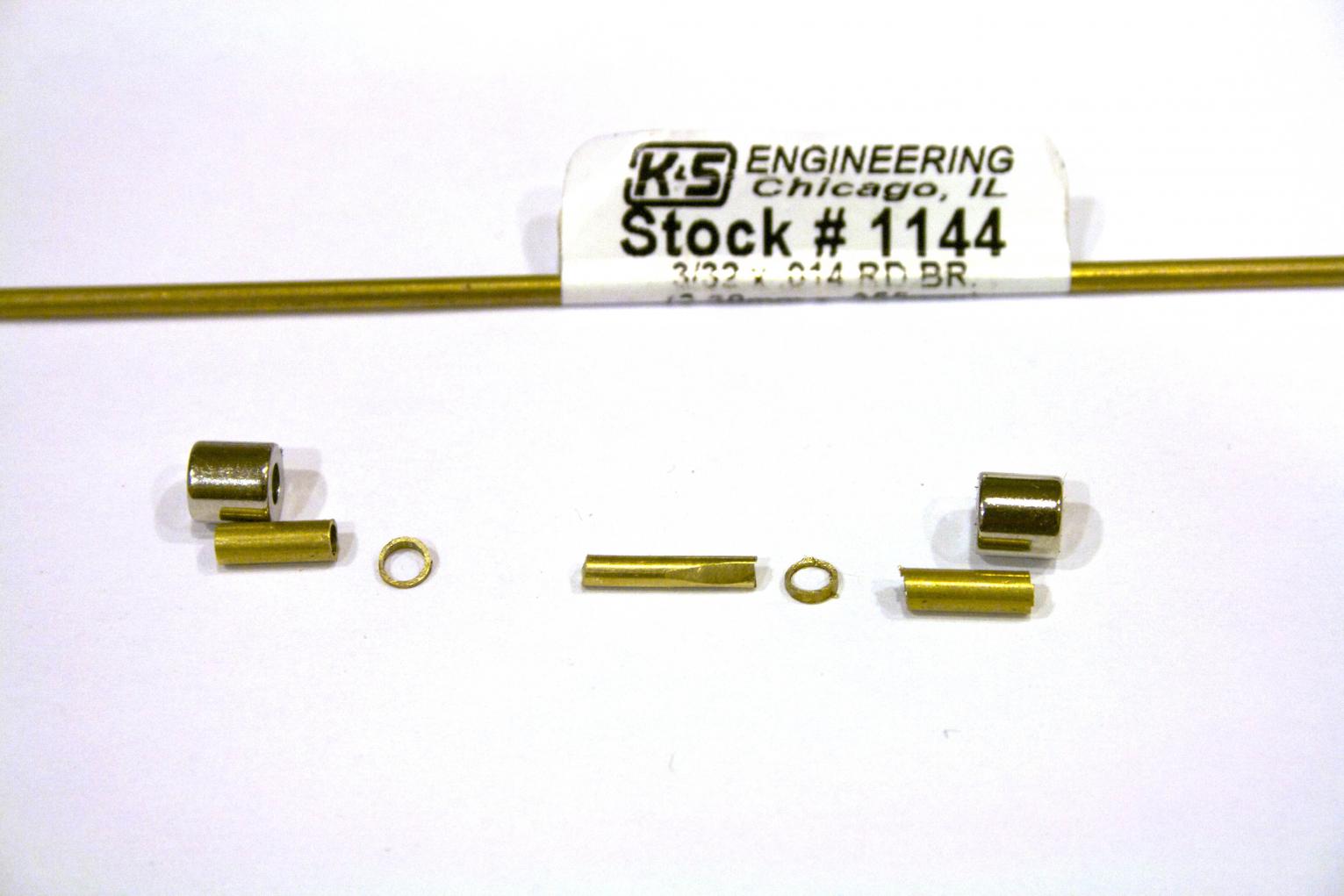

              I needed to make a magnetic connector for the Skipjack.
              The parts needed are:
              Two cylinder magnets
              Two thin slices of 5/32" tubing
              Two 1/8" tubing cut slightly longer than the cylinder magnets
              one 3/32" brass rod just a small section
              Two 3/32" brass tube lengths
              This is designed to fit on a 1/16" pushrod.

              The 5/32" sliver slips on the end of each 1/8" tubing and gets soldered on.
              Cut a length of 3/32" tube and solder so that it is in half way in the 1/8" piece, opposite of where the sliver is soldered. Do this to both 1/8" tubes.
              One 1/8" tube will have the rod inserted in the same side as the sliver and is soldered in.

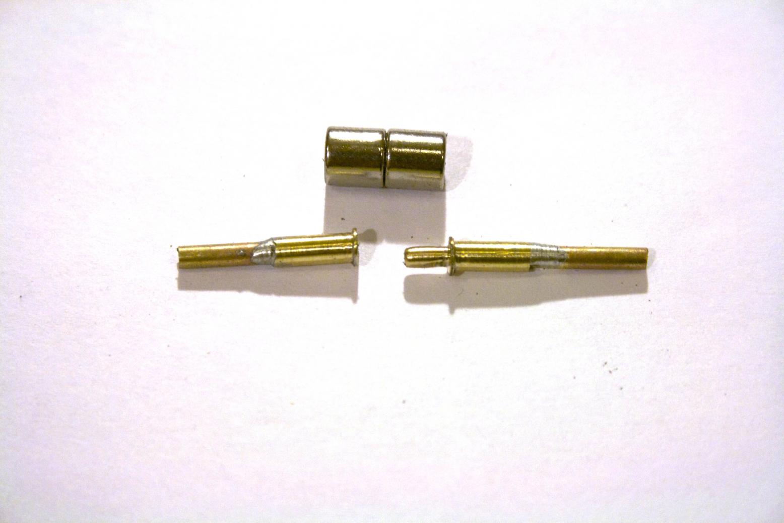

              Put it in a lathe or hand piece like a dremel, even a drill press could probably be used. Anyway, using files thin the 1/8" tube until the magnet slips on. Also thin out the sliver. The thinner you make it the closer the magnets will be and stronger the hold. The purpose of the sliver is a stop for the magnet.
              CA or epoxy the magnets in.

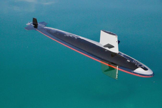

                                Took the Skipjack out for a shake down run after a winter break. Love the way she handles. Took a video too....will post.
