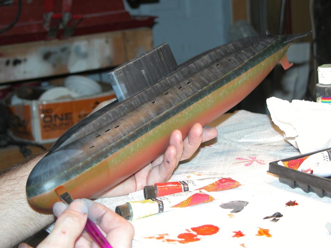

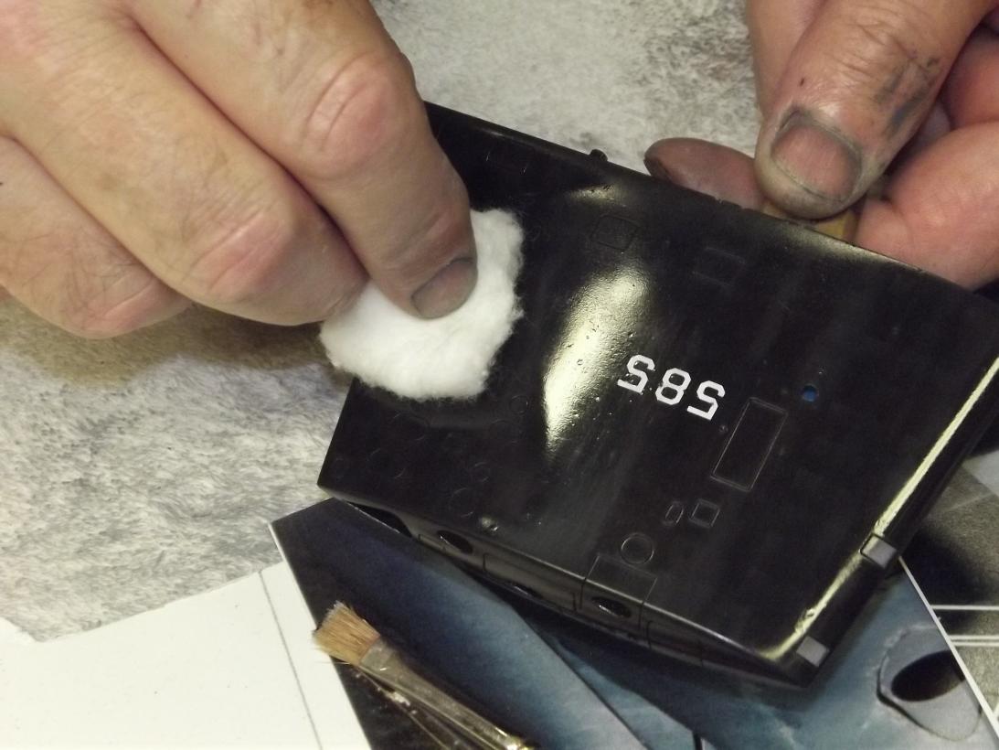

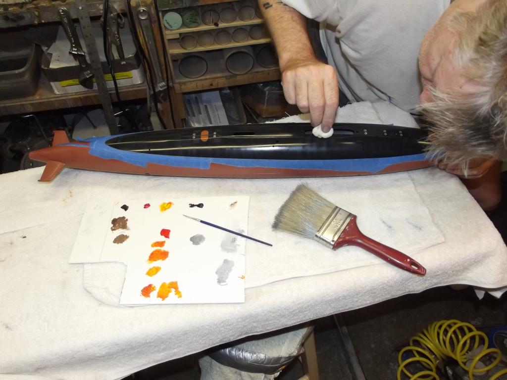

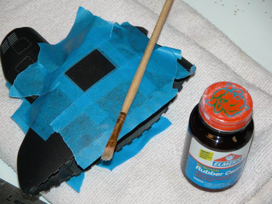

          During the war years almost all the American boats had a black anti-foul coat. By mid-patrol the below waterline area would be a mottled dark gray as the salt water bleached the paint, the mottling effect (at leas three cycles) with tooth past is done with a dark gray, cut with clear-coat to reduce its opacity. First coat goes on after a well spaced amount of tooth-paste mask; you wait for that to dry, lay down a bit more tooth-paste mottling mask and mist coat some more dark gray; finally, you mottle mask a bit more and hit the below waterline areas again with a misting of the dark gray.
          Then, move on to the scum-line, from waterline down. Chalk or Artist crayon a rough band of white at the waterline and pull it down with a rag or texture stick. Then spray on a very light band of green from just below the white to about 1/2" down from the water line.
          No rust!, No vertical or horizontal streaking!

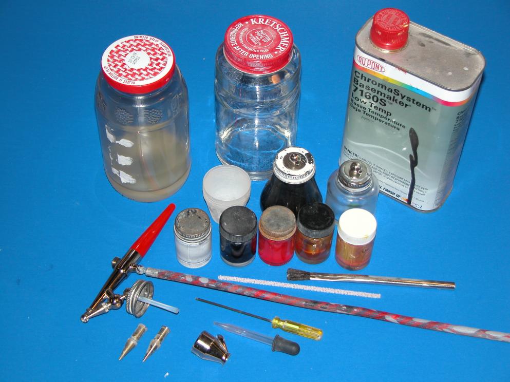

          Play with and understand the properties, advantages, and liabilities, of the different mediums and tools: Exploit artists oils ability to blend and feather and streak; use the water soluble acrylic paints to produce hard-edges and washes; and employ the robust, high opacity car paints for the major color foundation. Experiment with house-brushes, rollers, sponges, texture pads, artists pencils rags, cotton balls, crayons, even chalks.
          Find a hull you're not using right now and go to town -- make it your college from which you will earn a degree in Fine Weathering. Then you will be a Frig'n Weathering God .... just like me!

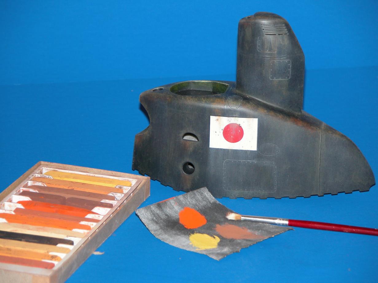

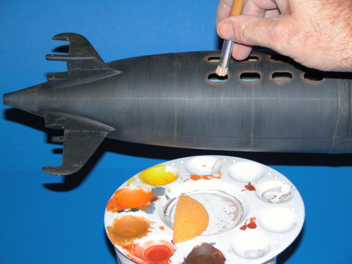

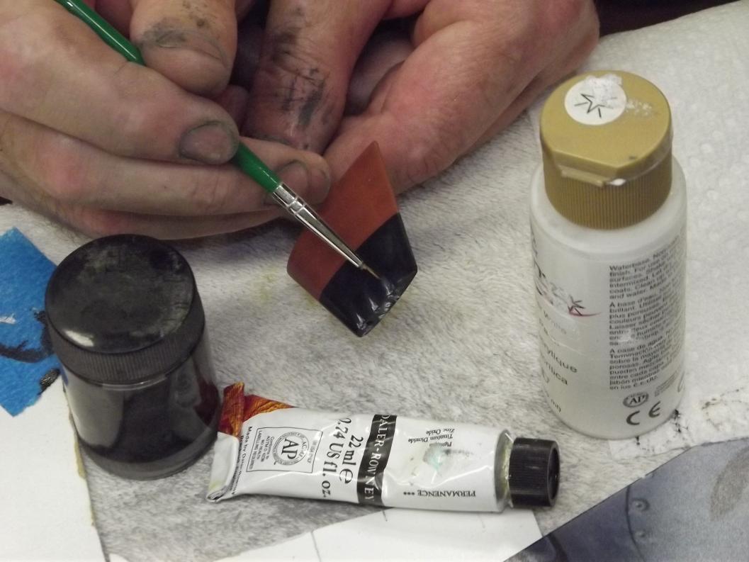

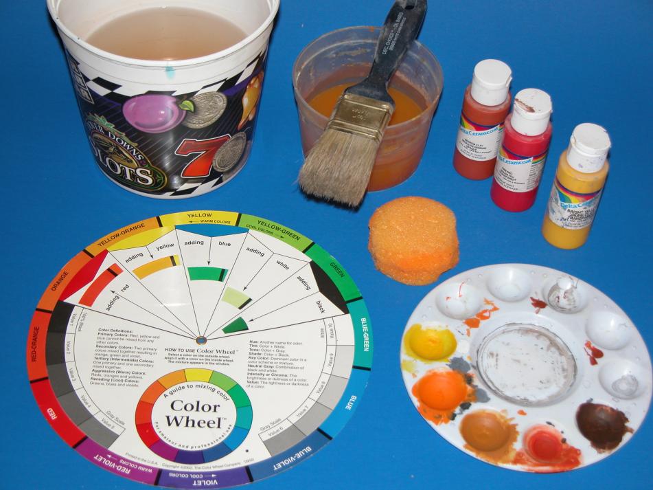

              Mix red and yellow to get rust. Steal the Wife's make-up kit. Lots of good oil based finely ground pigments in that kit. No rust below waterline, and represent it very, very lightly! Make a small paper cut-out of a man to the scale of your model. Put him next to an area you will weather. Does the size of the rust patch/bird-poop run/grease stain/deck spill look appropriate for the size of your pulp crewman? Think scale, and think gravity!
              Think like gravity when doing the streaking. Streaking is the result of rain water catching oil and other crap and carrying it down the sides of the upper rudder, sail, and hull -- all surfaces that have a vertical component to them and are above waterline.
              The initial streaking is heavy handed and done with a dark to light gray dry-brushed onto the model parts with a big-ass brush -- sometimes a 4" paint-brush, no less! Fast, purposeful downward strokes hitting the parts just hard enough to get just a bit of paint onto the model and streaked down. The medium is water soluble acrylic. The more subtle, translucent streaking (representing engine exhaust stains, access cover-door run-off, and bird-****) is done with oils and a softer brush.

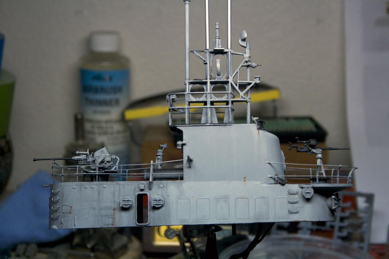

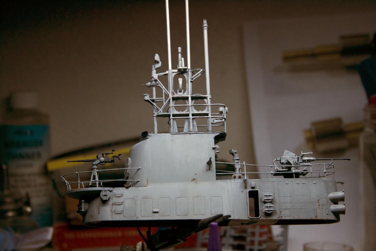

                          I have been quiet for a spell, not because of slacking off, been working on paint.
                          A big thank you to David for the new gear for the WTC! You ROCK!
                          Here is what I have done so far......
ID:	68215Click image for larger version
                          David, I would like your critique.

                                Good. Very good! Less is more; you did not over-extend the rust runs, and the vertical streaking is just percept able. A most credible presentation. I hate you!
                                And your dark wash brought the small-arms (if a 40 and 20 can be described as 'small-arms') out beautifully.
