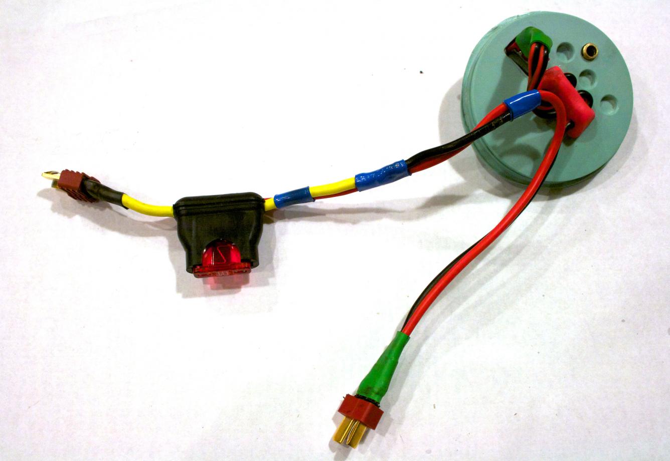

                    No lake, yet. Still hunting down the locking ballast servo. Will redo electrical connections and re-test. I do not like my fuse as well, what do ya'all use? There has got to be a smaller more compact way.
                    Ooooh, would this work??
                    http://www.newark.com/littelfuse/015...binations_None
                    You can see how clunky the fuse I have now is....

                      The old style 'cylindrical' fuse is a bit smaller of profile. Try that.

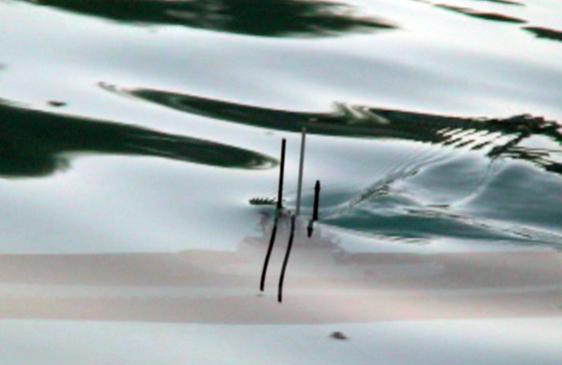

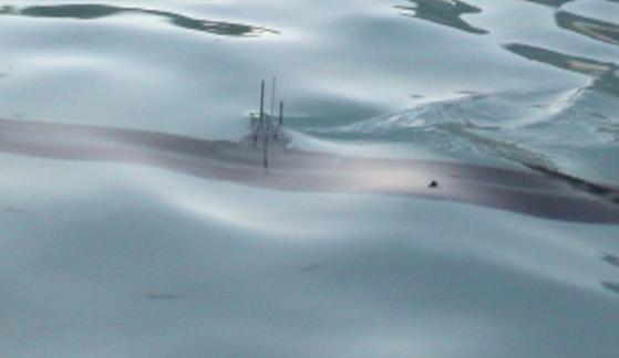

                        Sorry about the vague messing up, it is still getting corroded and I just need to be heavy handed on the application of vaseline.
                        May not be scale, but it is fun!
                        Here are some shots of me cruising along (not doing the tight radius turn)
                        I like the glimpse of the sub between the waves.
                        The white periscope is styrene, it was to lower the weight above waterline and stop the listing as it was using SNORT.
