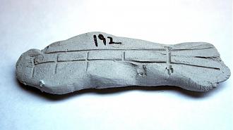

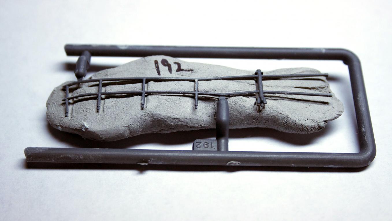

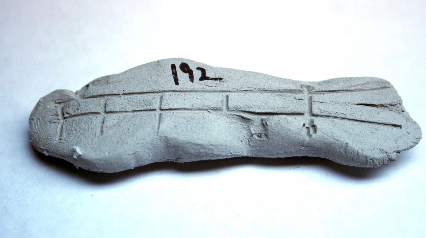

                  There are curves in the railing on the conning tower, so I was not sure what you meant David when you said to trace the railings. To create a guide to make the railings, I filled the inside of the railings with potters clay.
                  Removing the plastic part, you can see there is a nice channel to put the wires in.

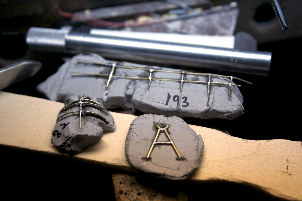

                  This is quite the learning time for me. I can solder with a torch, but soldering with a soldering iron is tricky. Practice and time will help I know, but please pardon my mess. Here are the parts I made. There are blobs of solder that I will need to clean up. I am tired and will do the fitting and clean up tomorrow (maybe), my biggest desire is to get her in the water for more tests and learning how to control the Gato better.

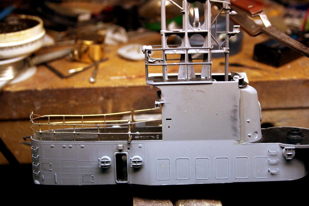

                        I re-did the railings tonight because I did not like the first ones and the joints got better as I went along.

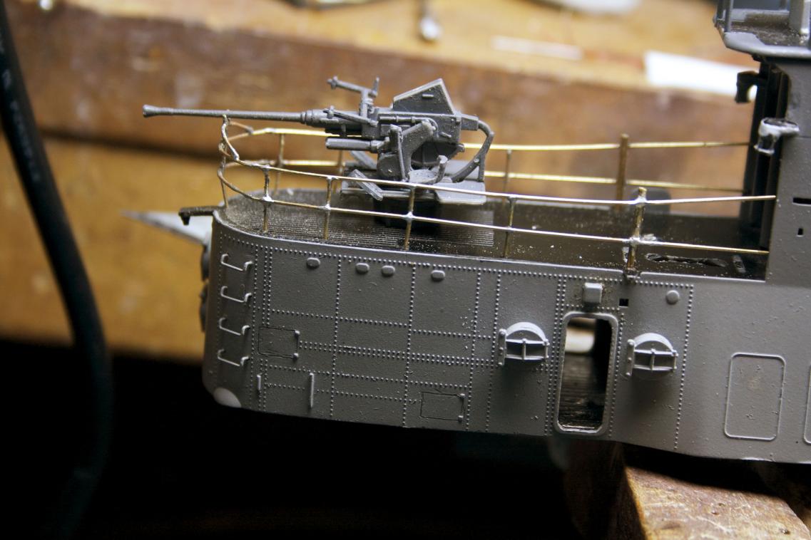

                        Placed the gun in and the barrel rested perfectly.

                          Fair job on the railings. Me? I made the entire sail removable with origional plastic parts and have not suffered any breakage there yet. Consider doing that on your next kit assembly job.
