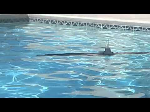

      The adjustment to the throttle was a great suggestion, thank you. I do not think I can take a break. Here is video I put together.....
      I gotta figure this out..... Any tips or trouble shooting tips you can offer chime in!
      First, that was a real nice job you did with this short video. Second, while lipo batteries are top of the line, you may want to consider a standard battery pack until the electric draw issue is worked thru, drain on non lipo batteries are not as critical or expensive. (I'm sure you know that already ).
      I know it may be a lengthly process for you, but you may want to also consider pulling the electrics apart and re-assembling things there within the motor compartment, so as it doesn't (excuse the expression) look like as you pointed out, a rats nest in there. This to hopefully better identify an area which may be of concern, and where a hot wire is indeed touching the metal equipment tray or maybe a positive to negative within the connectors/switches, as previously pointed out. These issues can become more prevalent with multi function sub-driver equipment instalations, and until you become familiar with electric diagnostics, well let me say keeping it all as simple as posible may be the less of the two evils. At that point re-connecting the various electronics can be an easier prospect in attempting to determine an electrical component failure or breakdown, this IMHO. I'm sure some may feel otherwise and I respect that, but as a beginner which I consider myself, primarily because I don't have of a real firm understanding of various electrics, I try to make every effort to adhere to the KISS theory. ( KEEP IT SIMPLE STUPID ) theory. Btw, don't forget to determine if any of the servo's are binding, or anything else such as motor output shaft to prop shaft binding which may create an excessive electrical draw on the battery. All motor components should operate as freely as possible. However, this issue does have the earmarking of something shorting out.
      Good luck, I'm certain you will eventually work thru this minor setback.

        Nice vid, and don't tell me that pool is in the backside of your garden, i'll eat my hat if so.
        Find the little bagger which eats up your battery, like David said look for the hot parts, or use a multimeter to measure the drawn current, by taking away each electrical part step by step you can find that current sucking bagger.
                Good hunting.
                Greetings Manfred.
                No, that is not my backyard. I have a small inflatable pool (about 2 meters x 3.5 meters) on my patio. This is my mother-in-law's senior center - the pool is open 24 hours a day and they do not mind me testing the sub there. Good thing too! Because with the last test and the sub not coming back up, it would have been a disaster in a pond.

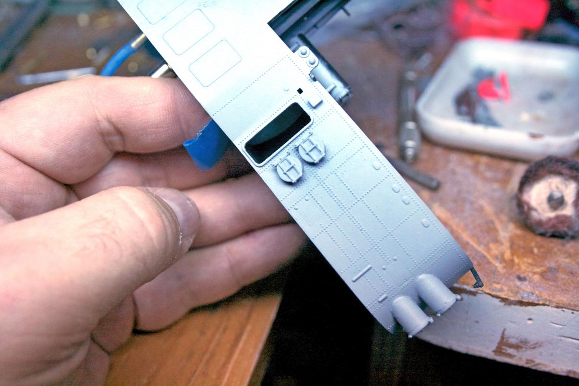

                        Waiting for fuse and I am bored. So I thought I would make a detail for the conning tower. The conning tower barrel, not the whole barrel just enough to give the illusion of one being there. Checking out references.
Name:	Balao Conning Tower.jpg

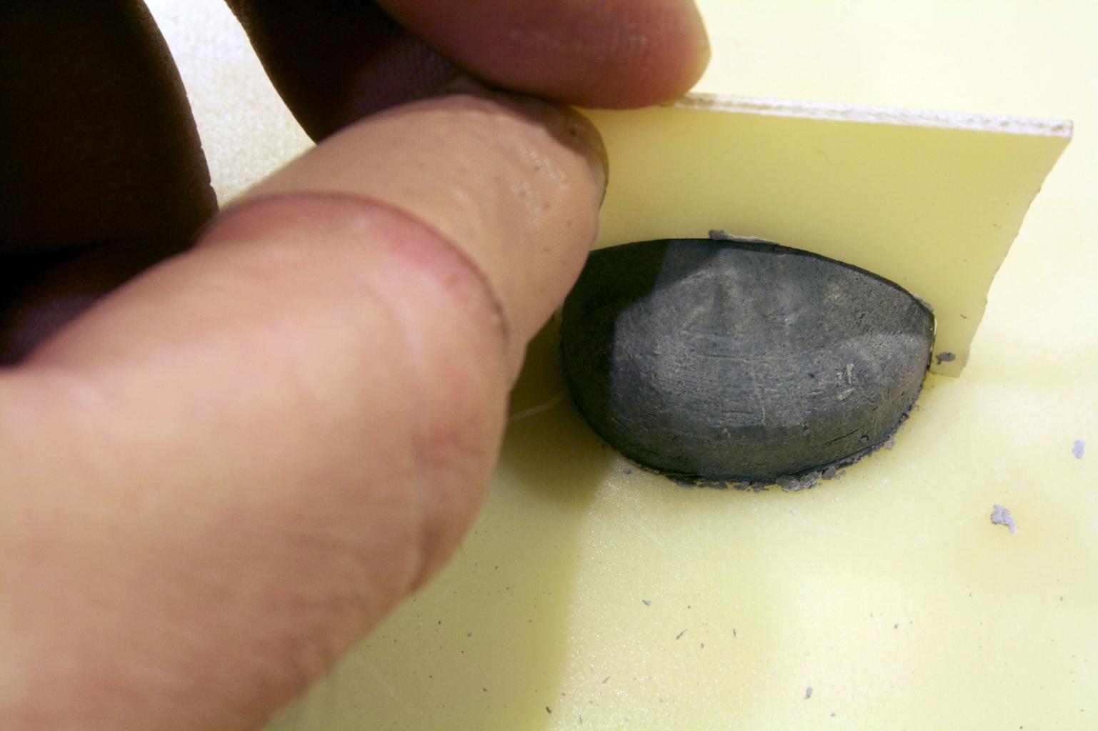

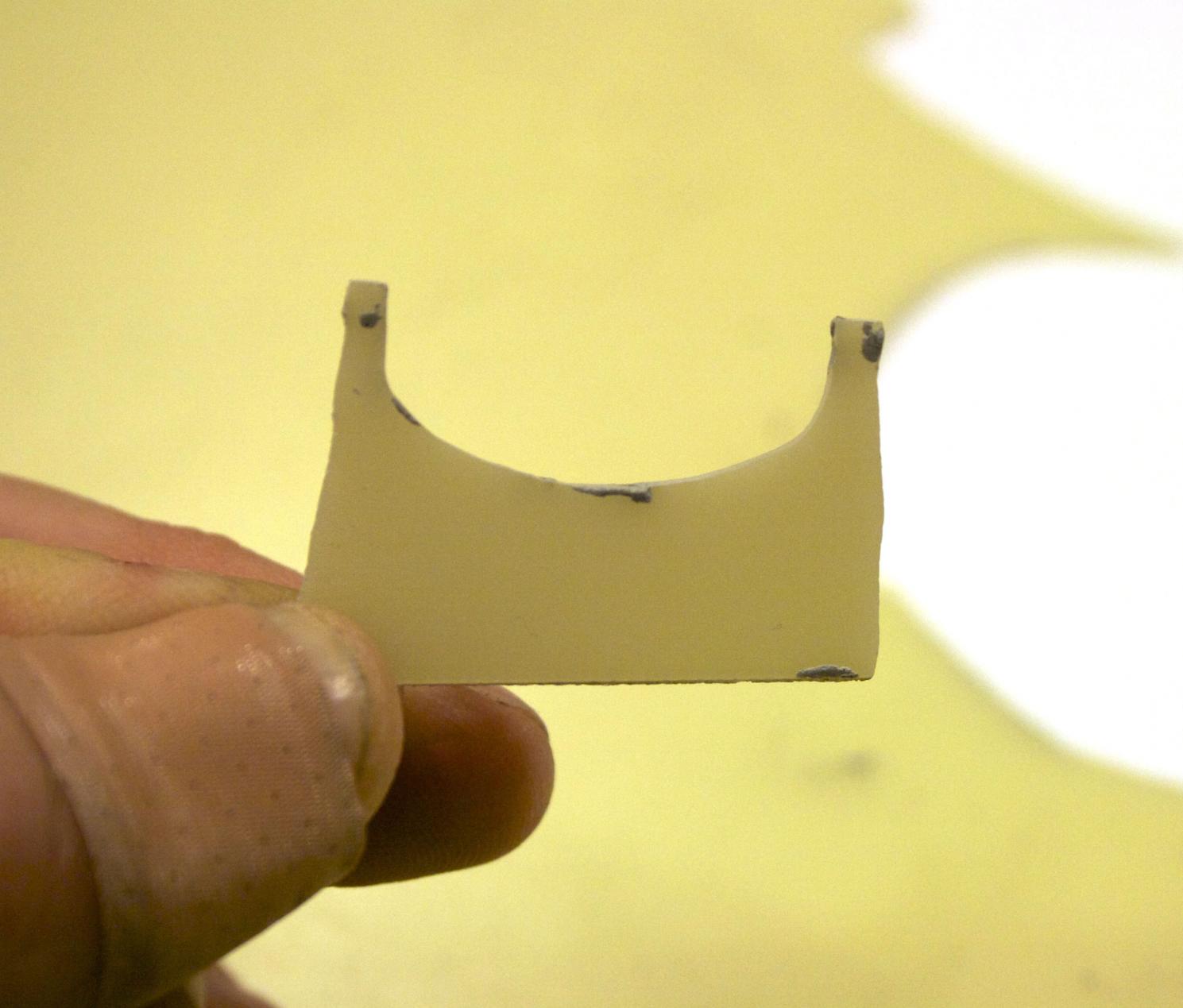

                        Cut out a pattern

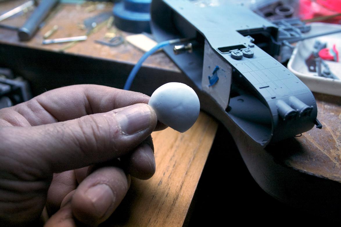

                        shaped some clay using the power and let it dry.

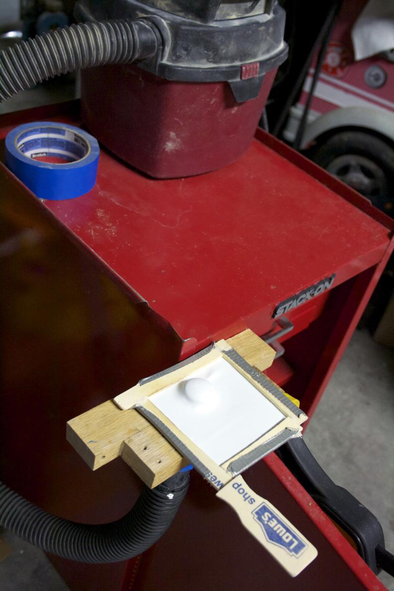

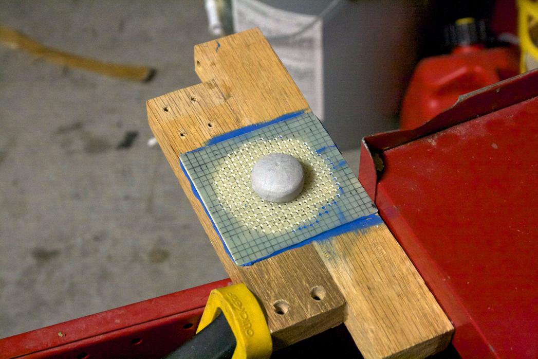

                        The last time I vacuum formed was when I was 7. It was a time when toys were good and dangerous. I have not vacuum formed since, so this was a fun first.
                        I glued a couple of oak scrap blocks together. I took some of that stuff I made my hull bulkheads out of and drilled holes on a grid I drew out. Cut out two different size holes. One for the hose on the bottom and a larger hole for under the plate. Glued that perforated plate to the oak that I drilled out with a hole saw.

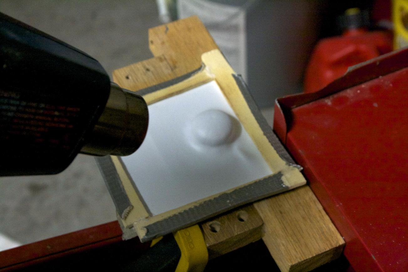

                        Heated the plastic in a make-shift frame. Turned on the vacuum and allowed the suction to bring the plastic around my clay plug. Then used the heat gun to bring in the edges more.
                        It came out nice enough.

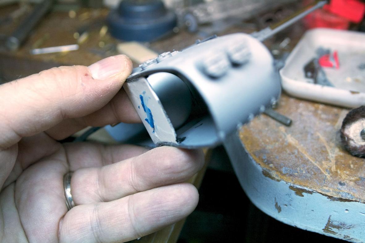

                        It looks good in there
ID:	67189Click image for larger version
                        I will paint it and glue it in.
                        Also drilled some larger holes to allow air to escape the conning tower.
                        Now I just need to put in the tubes for the ammo and the do-hinky pipe that David described in an earlier post.
