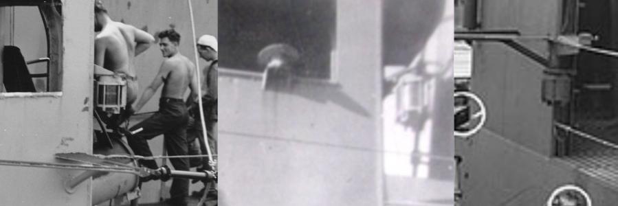

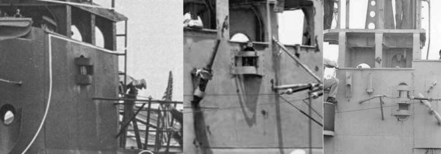

        There is so much variation among the subs for port/starboard running lights. Some had them on the side in an opening like
Name:	Side Lights 1.jpg
        and others had their running lights further back like these
Name:	Side Lights 2.jpg
        That I am having a hard time selecting what sub I want to model this Gato after. I may even go for the all black finish like the '44 Barb or Mingo. There is still time to make that decision. The aft running light seems to be the same on all (like the Revell has it right mostly). The forward running light has severe variances from in front of the conning tower below the venturi to on a jackstaff in the bow, so that will come with a final decision of which boat to do.

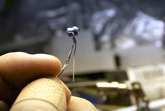

        I began to work on the aft running light creating a housing in brass. I will get photos on another post.

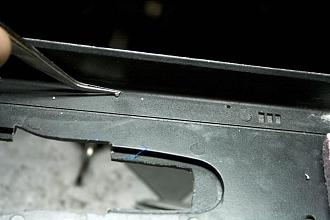

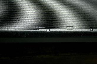

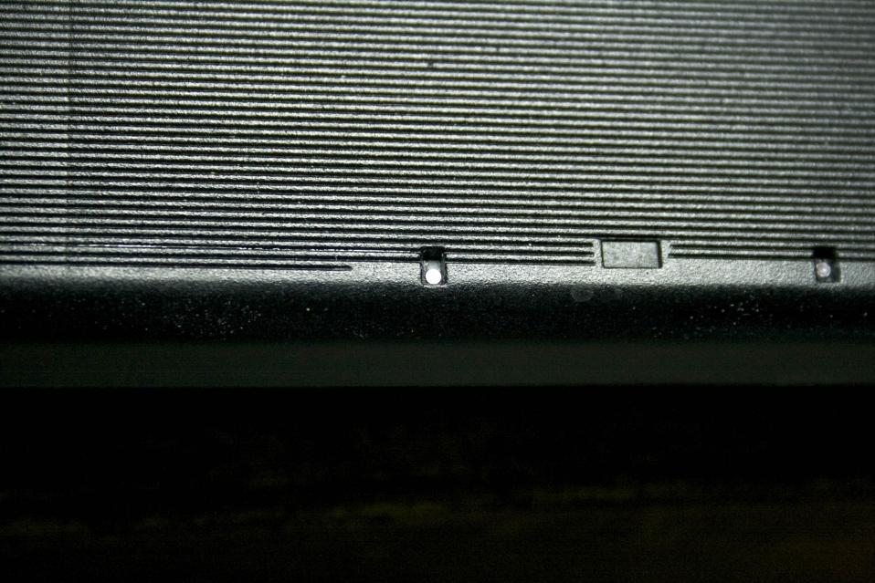

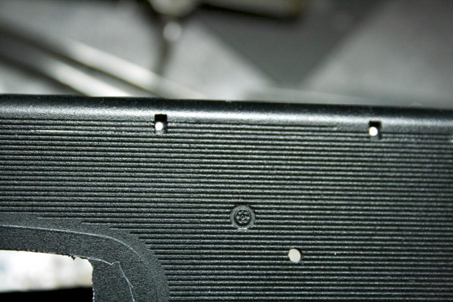

        The deck railing is a standard look (most sub pictures have them in place) and when on a patrol they could be removed and stowed away. I wanted to have the option to have them on or not. Being a Magnetaholic, I drilled 1/16" holes in the rail recesses and marked the top of a 1/16" disk magnet just prior to installation. This helped me keep track of the polarity and to keep them all aligned in the same direction.

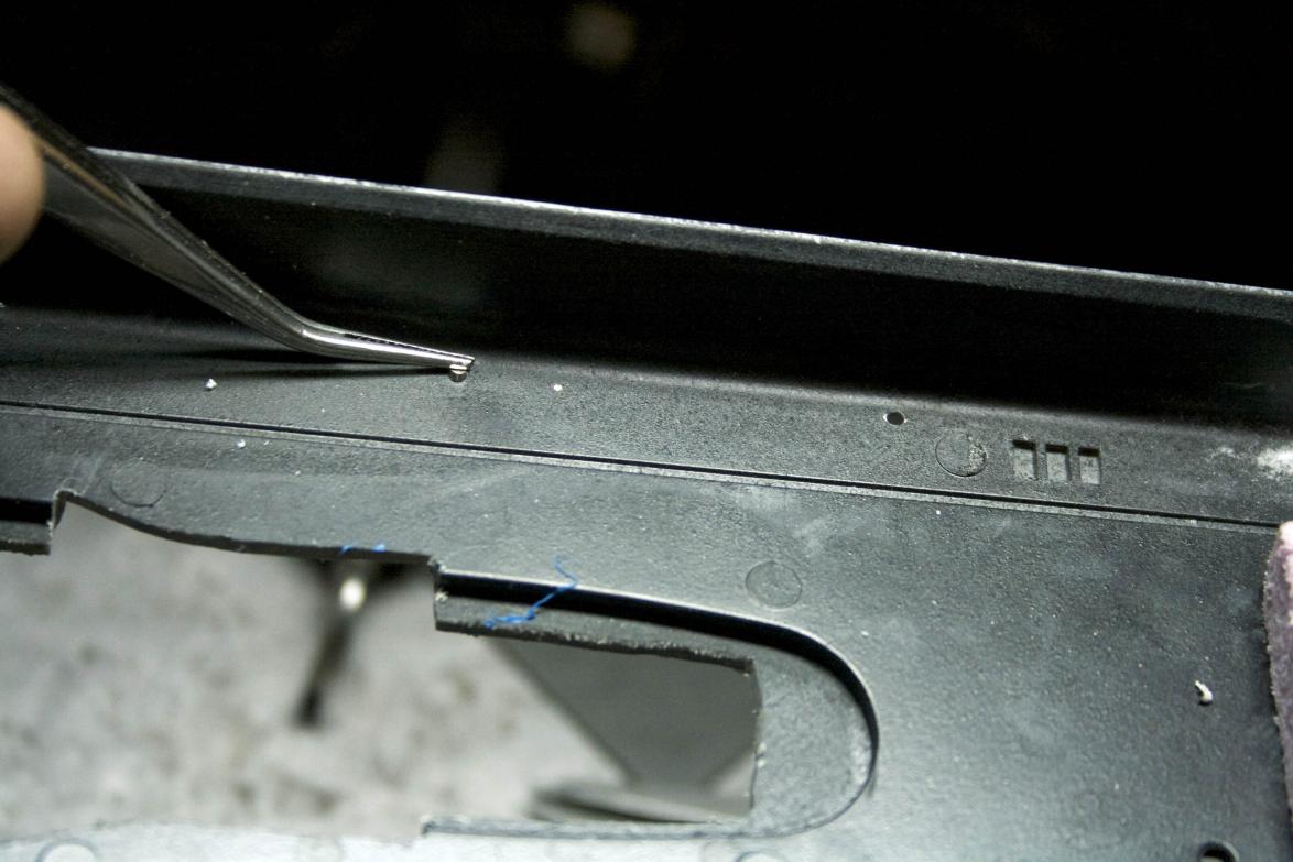

        Then using tweezers, slide the magnet in place.

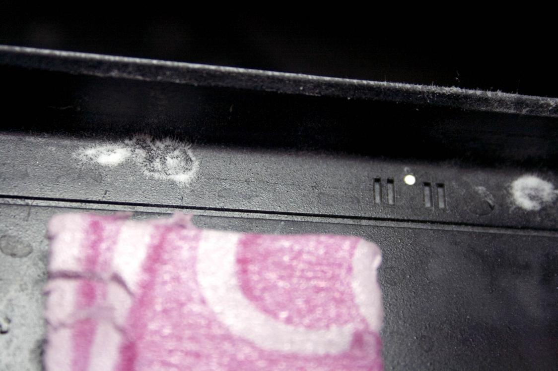

        Drop some CA and baking powder to secure and support the back.
        The thickness of the deck's plastic that is drilled out is about equal to the magnet, so the magnet is mostly flush on the deck railing recess.

        I will need to seal these and paint. Then work on rails.
