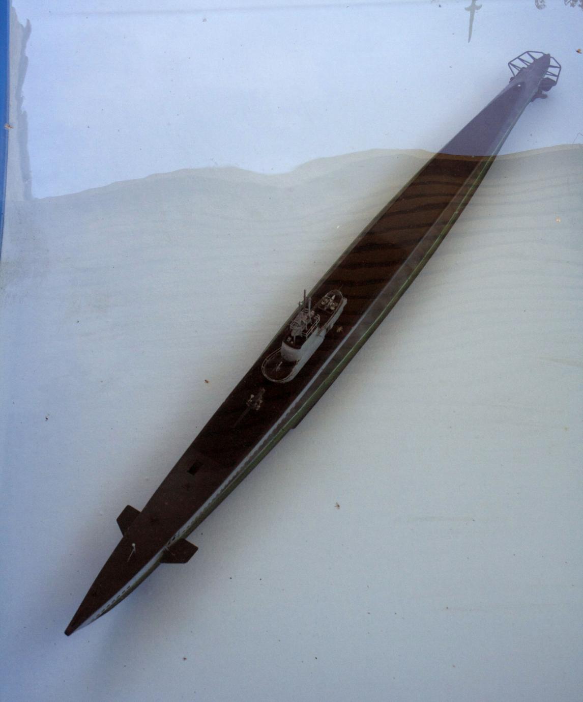

          To test out my theory about trapped air behind my foam, I placed the Gato in the pressurized polyvinyl chloride hydro test tank (aka inflatable kiddie pool) and emptied the ballast tank. She sat a little high, so I gently shook the submarine underwater to see if any bubbles came out (broke off the 40 gun barrel - we have the technology to fix her) and if the Gato would sit better. She did! She sat at the proper positive buoyancy. I left her there to sit. When I came back about an hour later.......
          She had settled to the bottom of the pool. I trimmed her from this state adding foam to the bow, mid-section and aft to get her to the proper trim. Tomorrow I will test her at the big kiddie pool. The key will be to let her sit and get cozy with the water and emit her gas - such a proper lady. It's a working theory.
            • 13961
            #275
            Now, that's something I never considered: displacement changer over time. Are you confident that the mechanism at work here is air trapped in and around the foam?

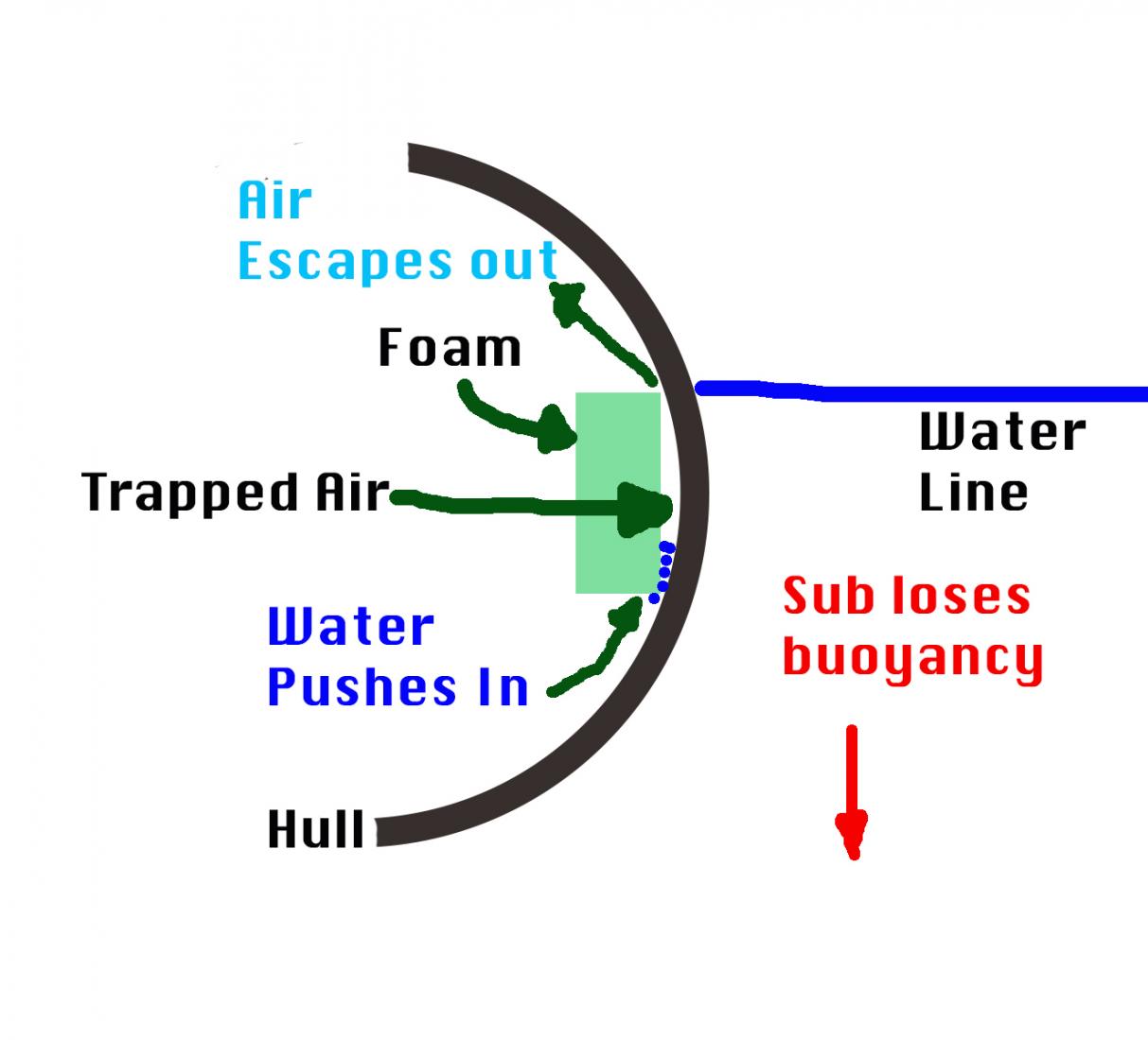

                    As far as the foam absorbing, I do not think so. Here is a crayon drawing of what I think is going on.
                    I think by my poor installation of foam and not shaping it to fit closer to the sub, I have trapped air behind my foam. As the sub sits in the water the air slowly escapes and changes the buoyancy of the sub. It is trimmed perfectly for the first few minutes, but as time passes it slowly fills those vacancies with water.
                    I might be able to weigh the sub after a while and see how much additional weight I have.
                    Theory needs to be tested.
