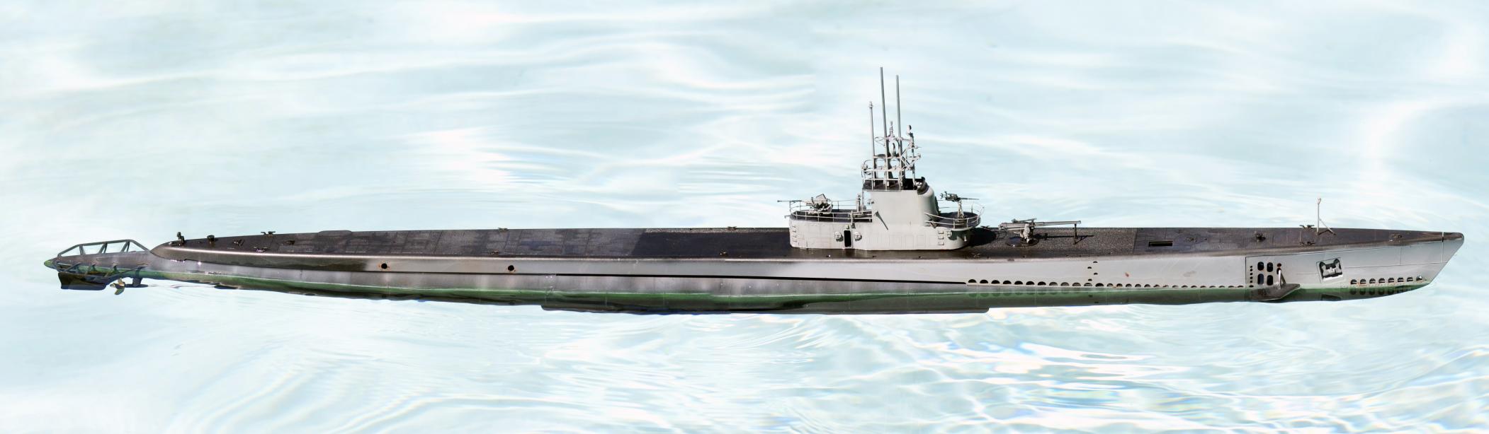

                  Got some more pool time in.
                  The good news after an hour or so of running her, she did not sink or rest at the bottom! The not so good news is it took some tweaking to finally get her to dive. Then it ended with her acting erratically And me breaking the barrel of the 40mm and the bow light support, grrrrr. All fixable (again).
                  Some of the erratic behavior is chattering servos and speed controller surging. Rear going down (very end of day). This time I think I need to re-calibrate the ADR2. All stop and the Gato was level. move forward and the aft would go down and bow up. The one other thing I noticed, when going in reverse, the rudder's click-on connector would disconnect. I may have to replace it with my connector.
                  Sam got some sub time in too! Did a fine job.
