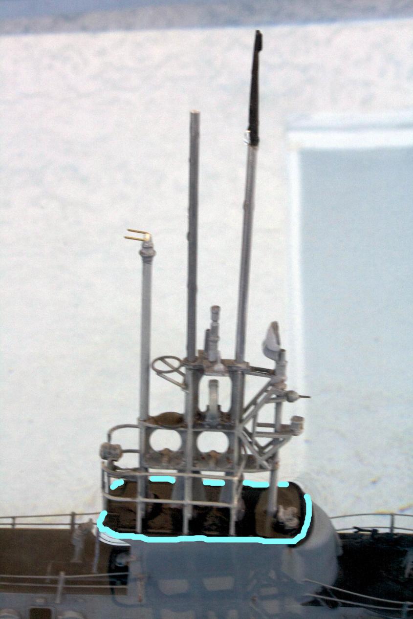

    Good job Trout. Will make a cool desktop image.
      • 3758
      #332
      Thanks Scott, (in a wispering voice so you know who does not hear) I will practice with a different photo.

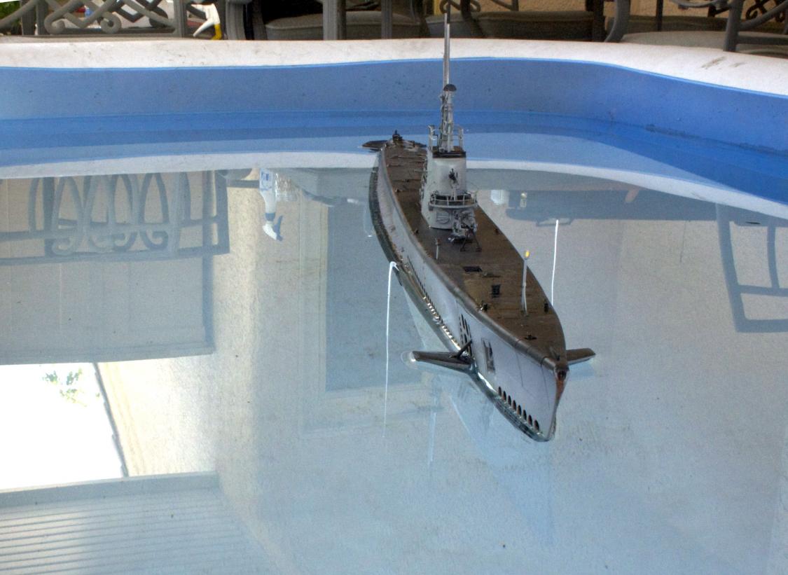

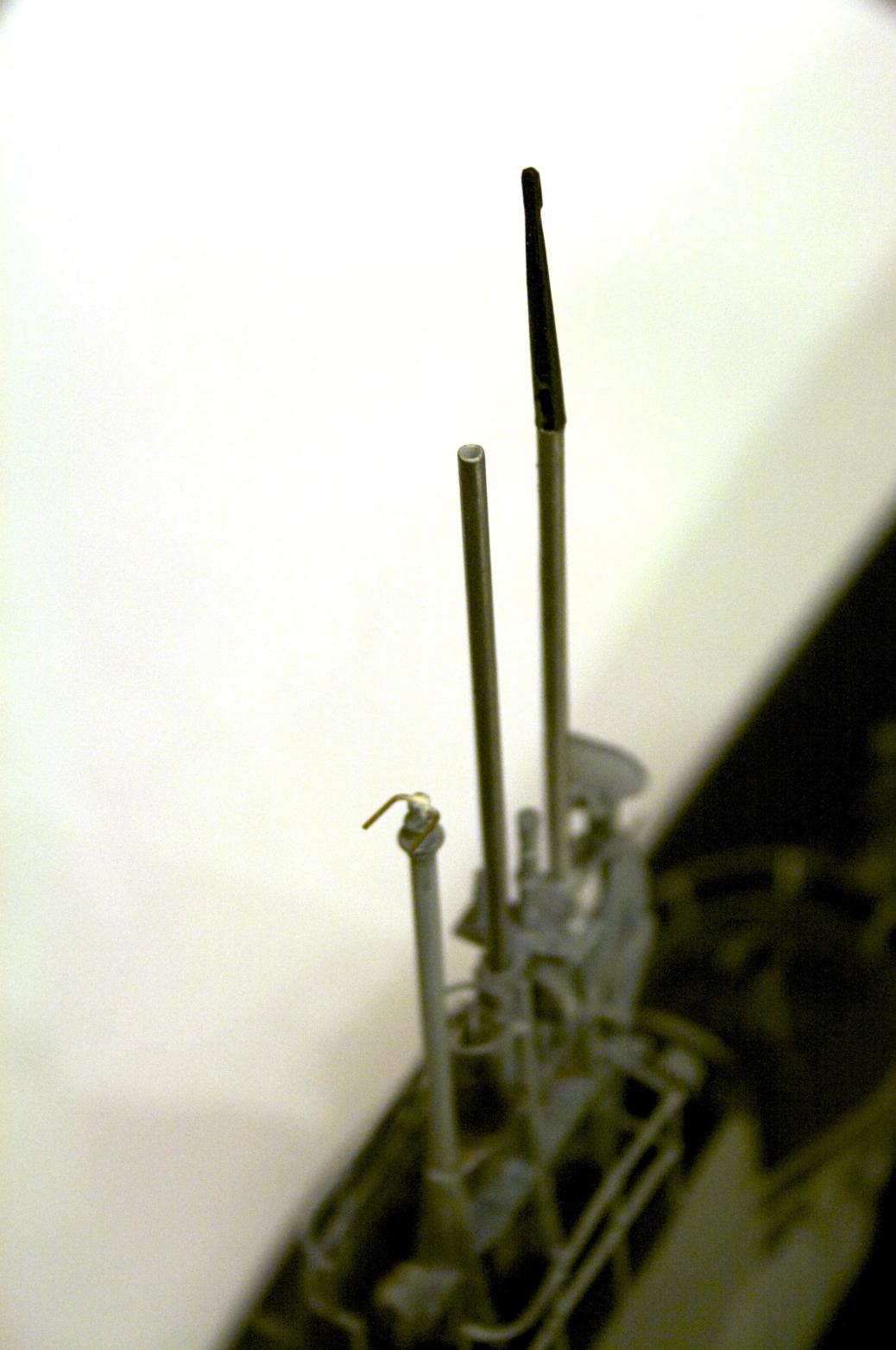

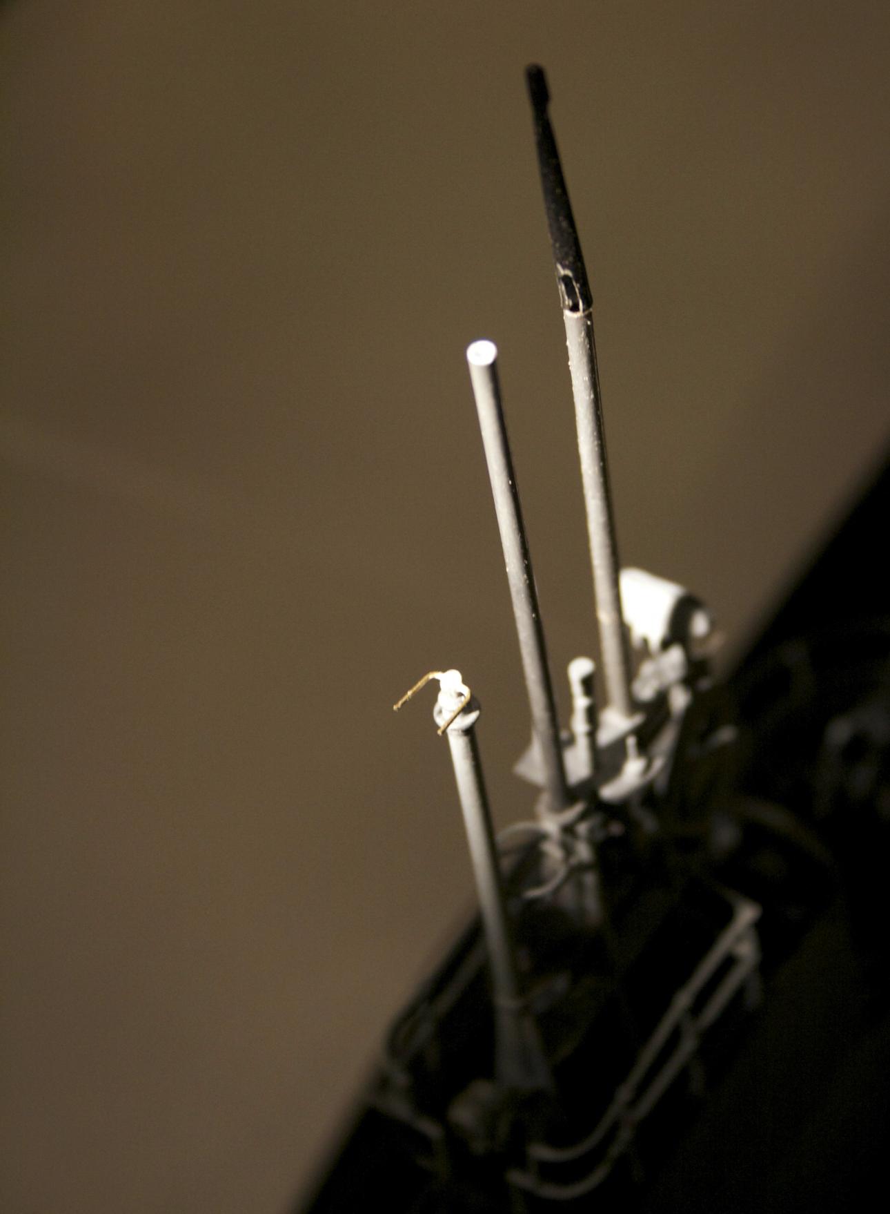

              It is Spring service on the Gato. In between builds and getting some small stuff off the plate.

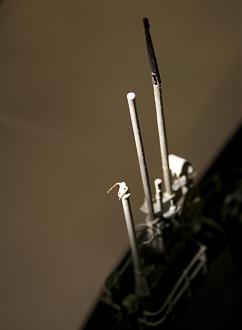

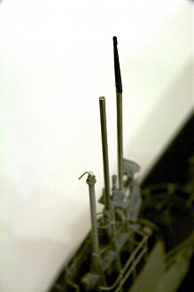

              The Gato's periscope shaft is used to bring air into the SNORT system to empty the ballast tank. Leaving the top of these tubes open looked incomplete. Earlier I posted about casting a new periscope and carving in the air intake.
              So tonight tested the periscope and to see if the opening would whistle (my fear) or be very restrictive on the air intake. Out came the inflatable test tank.
              Fortunately it did not whistle and it was only slightly slower on bringing air in.
Name:	Revell Gato Periscope 01.jpg
ID:	77088Click image for larger version
Name:	Revell Gato Periscope 02.jpg
              The air intake is pretty well hidden. Shining a spot light on the opening reveals what was cut out. The tube to the aft, is the other scope shaft, but it will be removed prior to sailing. It is a good protector for the periscope. I ran the sub for 40 minutes no issues came up other than it is slightly buoyant. I also took that riser from underneath the 20mm (although some boats had them, I never cared for it.

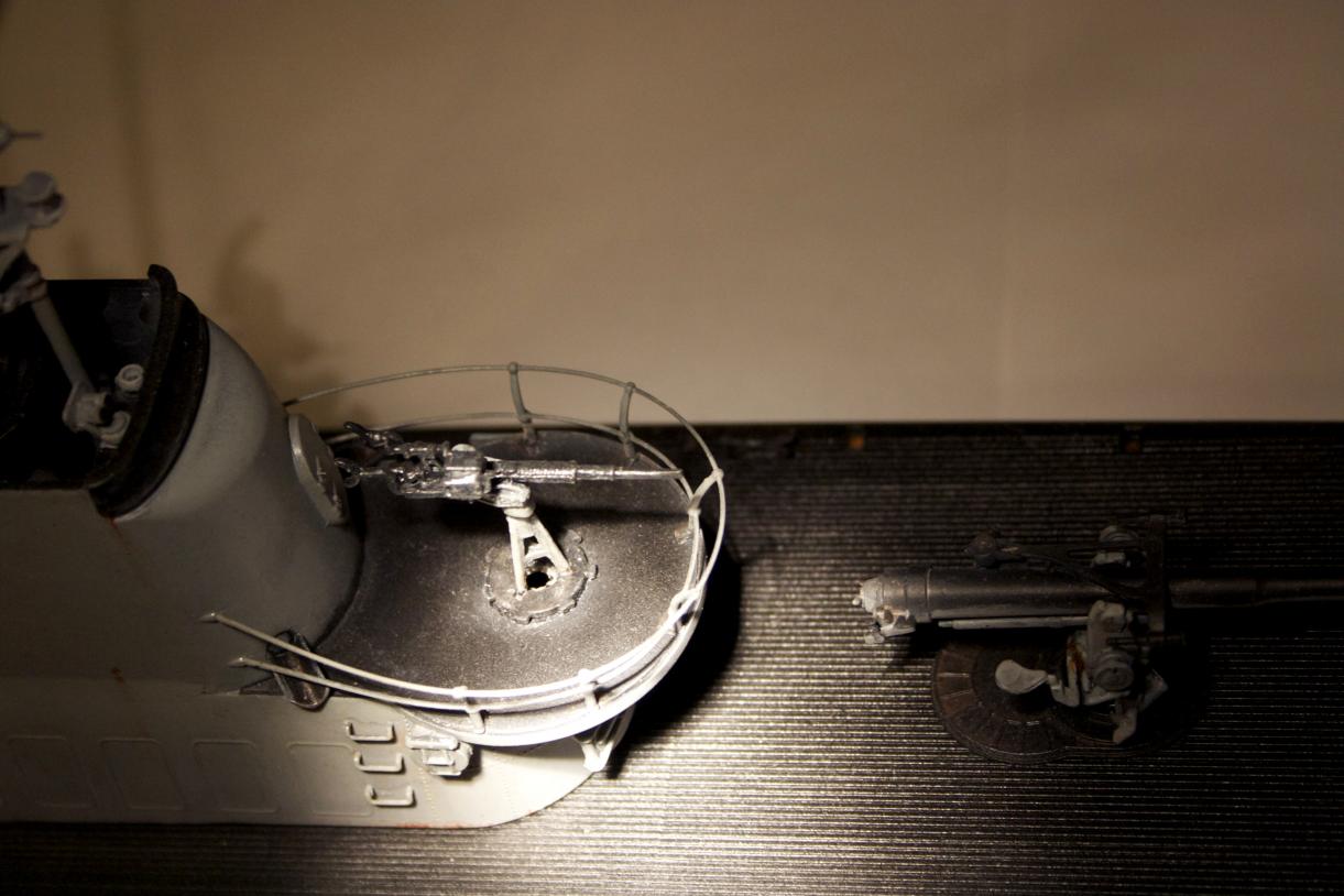

                I failed to add the photo of the gun.
Name:	Revell Gato 20mm Deck Gun.jpg
                She is tested and ready for another run in the pool.

                  Damn! Since day one I've caught a determined bubble up in the sail which would only get out of there with an extreme down-angle. Now I know where it came from! Thanks for the tip, Tom. Time to punch a like hole under my Oerlikon.

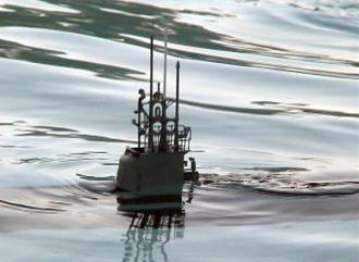

                    Spring prep on the Gato. Time to head to the lakes tomorrow. It rode high at first, but after a short while of just sitting in the water, she settled down.
                    Ran through all the paces for about 45 minutes and no hiccups. What changed? I used a different battery. It was one of my original ones. Cut the leads on it to match the connectors I am using and tried to match the weight of the ones I was using.
                    The air way through the periscope puts a slightly longer fill time. It must still be constricting a tad bit, but I like the look of having a periscope.
                    I am going to see if I can get some underwater shots.

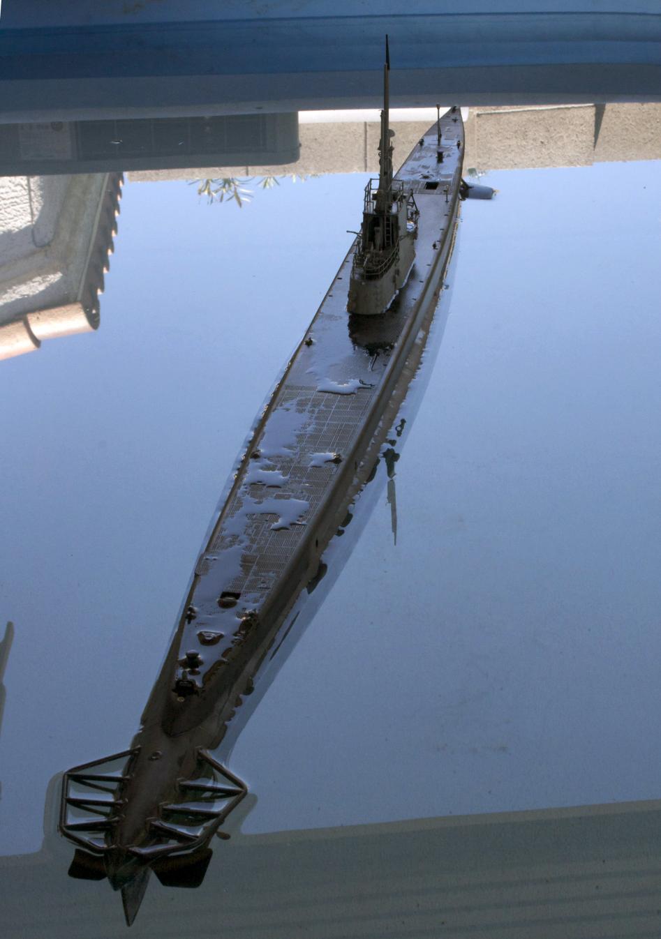

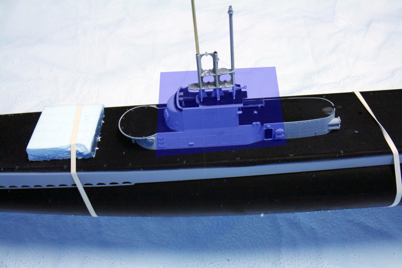

                        You are correct, I am not running the SAS, but I am running the SNORT system. My next Gato will use SAS.
                        Here is a photo of where my Gato sits currently (with gas tank filled). It will sit a little higher when it is empty (i know that is a duh statement).
                        The blue highlight is where the waterline is.

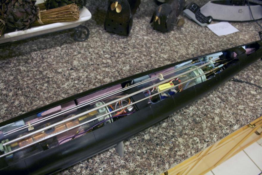

                        When it is set up like this, the forward motion needed to submerge is very little. The down side is it also has little lift if it gets in trouble. I have run her with about 1/2" to 1" of sail above waterline and runs pretty good, more speed needed of course. With decks awash you are fighting positive buoyancy IMHO, it works, see below photo. That is the minimum I would go.
                        Here is where I trimmed it originally. She ran great until I went beyond 3' or 4' then she became slightly negative. There are other issues that played into that like trapped air behind my foam (I did not shape the foam to fit the hull).
                        And here it is sitting higher in the water
                        This is the highest I would recommend, I had an empty compressed air tank here. That said, I still could maintain periscope depth!

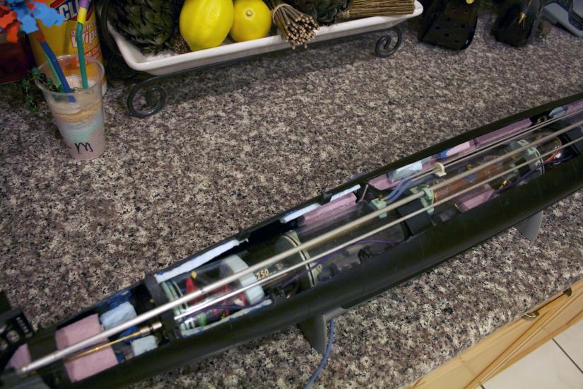

                        You will get there. A lot of my weight and foam was added to overcome or minimize the tilt that happens as you empty the ballast tank of water.
                        Here are embarrassing photos of what my foam looks like.
ID:	81230Click image for larger version
                        You can see a lot of small chunks above the waterline. Instead of having the foam under the deck (which I do have some), I kept as much as possible just above the waterline. It still serves the purpose for submerged trim, but also (my thinking goes) when the boat tries to do its tip, it immediately will need to fight the buoyancy of the foam. Do you know what I mean? Sorry to ramble, I would encourage you to keep at it. You will be rewarded with one fantastic sub!

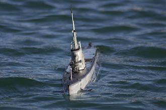

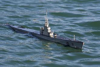

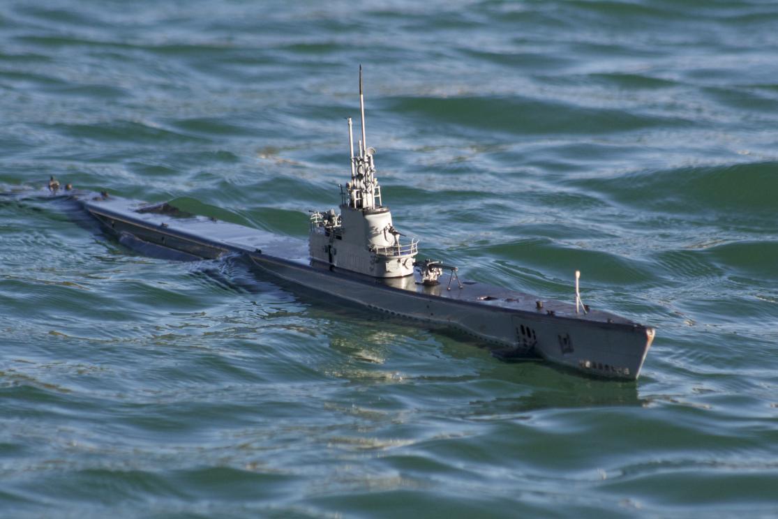

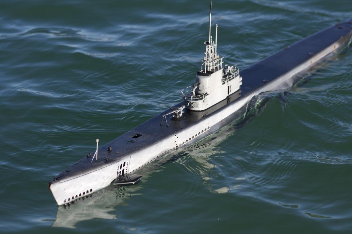

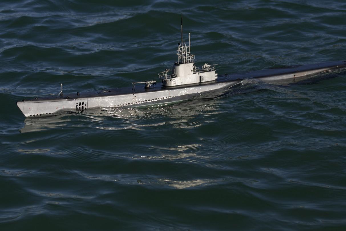

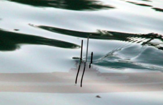

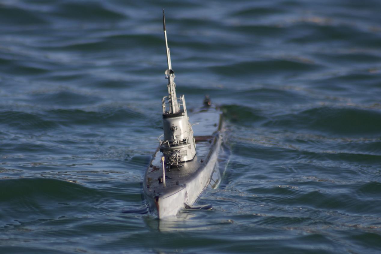

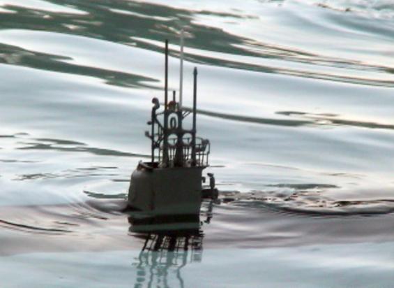

                                I took the Gato out to the open water, no pool for safety. It is interesting the feeling you go through. I lapped around several times and then took the sub close to the rock wall and did a dive. It was amazing! It was nice not to run out of room to run, but also just how cool the sub looks in non-pool water.
Name:	Mission Complete 006.jpg
ID:	81719Click image for larger version
Name:	Mission Complete 005.jpg
Name:	Mission Complete 003.jpg
ID:	81721Click image for larger version
Name:	Mission Complete 002.jpg
                                After several runs submerged, it was time to video the run. Unfortunately, we did not get that much good video footage. My son (soon to be 9) was filming and was having trouble following the sub once it submerged or kept at periscope depth. I would need to surface until he acquired it again. Next time I will let him run the sub and I will film.
                                Maybe the next post will be a summary of what I would do different and what I will keep in future builds. What a great submarine!
