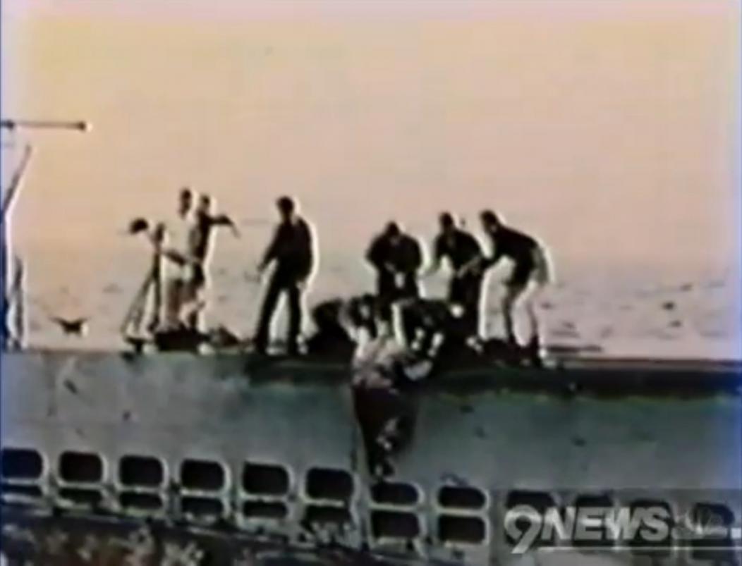

        Searching a different route, I came across a video of a rescue of a B-29 crew. After the advertisement there is a news report about it, when this video finishes, there is a full length video (about 8 minutes) of the rescue of the crew in its recommended play list. http://link.brightcove.com/services/...d=672454611001
        Here is a capture from it.
        Notice the rust below the waterline!
          • 13983
          #259
          Nope, I see rust running down on the black tank-tops. The waterline is about a foot below where this picture crops out. Looked at the video (nice catch, by the way) and did not see any of the boat bobbing up showing off the below waterline area.
            • 3758
            #260
            O.K. I will concede on this one, David.

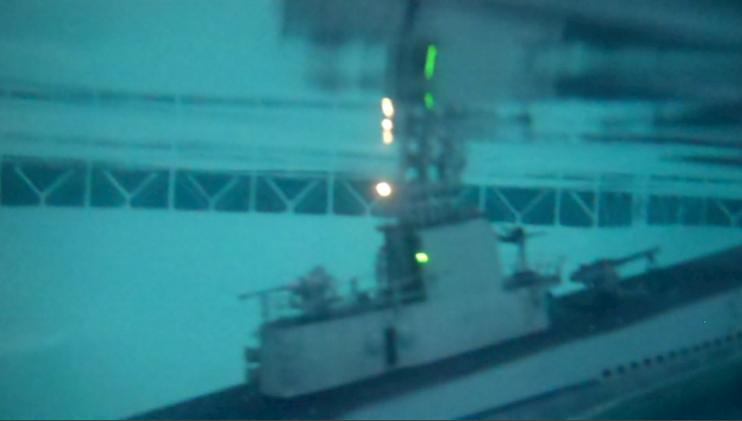

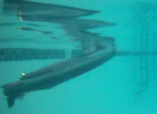

                                When I arrived at the pool, the first run was frustrating because she would not dive. So I took her out of the water and did some adjustment to the bow planes through the wFly TX. When I replaced the stripped gear, I must not have gotten the arm on exactly as before.
                                Then I did the second run and that is what you saw filmed. It was fun. When she behaves she is outstanding.
                                The third run was going to get more underwater film - then it happened almost right away.......
                                Wait for it.......
                                That is not me surfacing..... that is me cruising along slowly. The aft end seemed to lose its buoyancy (my first thought was water leaked in). Interesting was watching the sub as speed was added and see the leveler bring the rear up for me to a semi-level position. This mission was cut short.
                                Pulling out the sub, to my relief the WTC was dry (which is a very nice thing). No weights were floating around no foam lost......What the flip happened?
                                Working theory.....lets see what you think.....In placing the foam in the hull, I must have gaps that have trapped air, the longer I am in the water the air slowly leaks out until it gets to the point of changing the positive buoyancy to Davey's Locker homing beacon.
