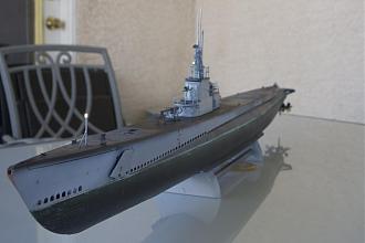

                            Here is what it came from
