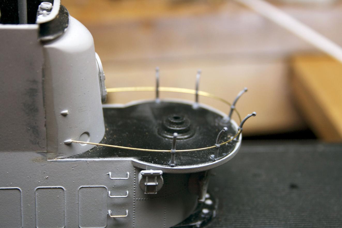

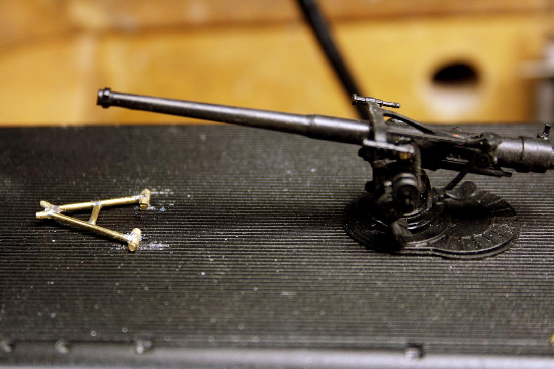

      Worked a little more on conning tower railings. Got the lower rail installed.
      The threading went easier than expected once I drilled out the holes with a .018 drill bit. It gave enough freedom that using tweezers, could pull the brass through. That being typed, I broke one of the stanchions before even threading the brass wire and it is making it hard to get this right (in the picture it is the one furthest away....it is glued and in position), I will let it set overnight and see what can be done tomorrow.

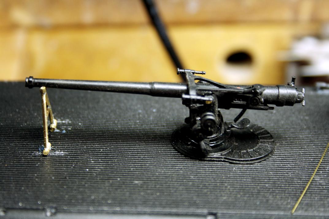

      Also added to the deck the barrel brace.
ID:	67897Click image for larger version
      It holds onto the barrel with, of course, magnets. One under the barrel in the hole and in the bottom of the U on the brace. I may have to uninstall it and put a pin under each hinge to fasten to the deck.- will see.

        I found braided fishing line wire best for the forward railing -- flexible, strong, easy to thread through the stanchions and face of sail. Got that pointer from Brian Stark.
        You're doing fine work here.

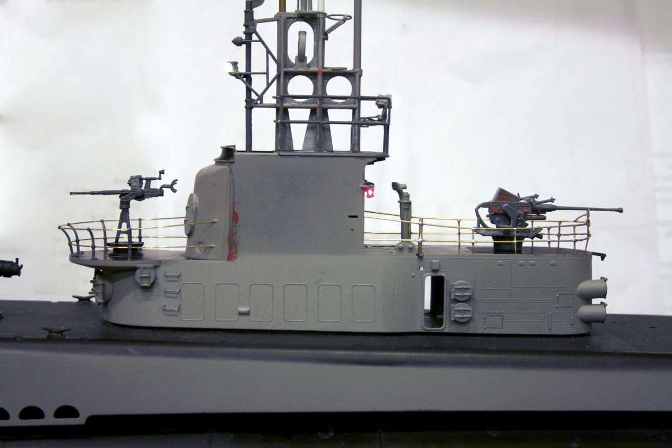

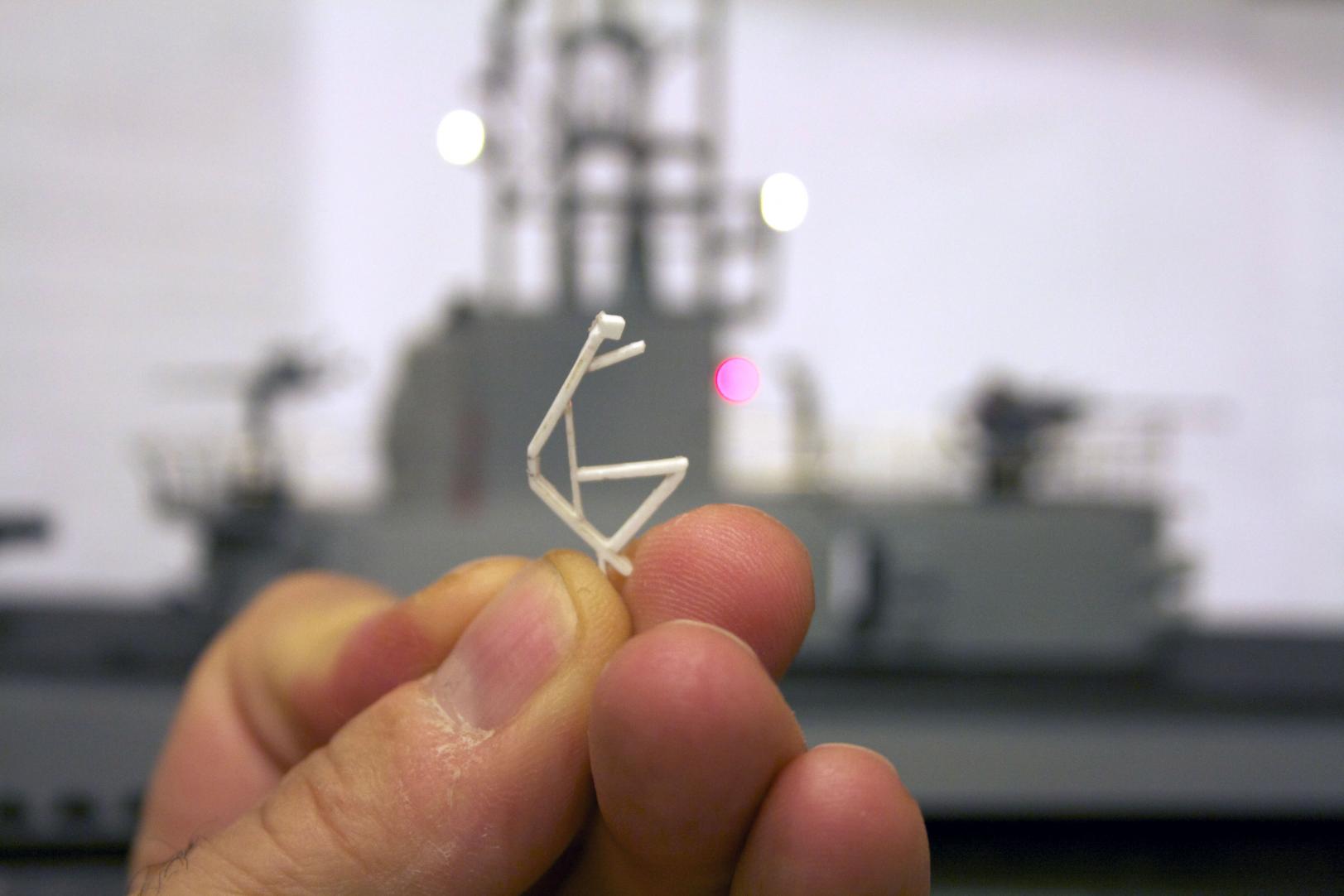

            Here is the deck wiring done for the conning tower.

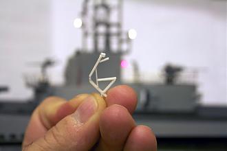

            and a replacement part for the one I lost

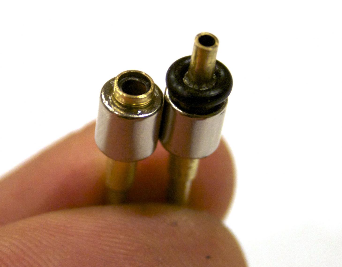

              Since my conning tower is removable and has lights, it has caused a bit of grief on how to make the connection. I tried to be creative. The first way was with pins on each side of the conning tower that had a matching pin/receiver on the deck. When the conning tower and deck were put together, the pins made contact and lights on. That worked for a while until the pins started to move and not make contact. So I am on plan two.
              I love how Apple computers power connect, it is a magnetic connector (and you know I love magnets). So I took a broken power supply and broken magsafe (the port on the computer) and played with that. If I can get the two sides to connect and create a seal around it, no corrosion and good contact every time.
              Last night I cast a resin housing around the connector and got everything soldered up..I have created a RTV seal and tonight I will do the same for the other side. Then test in the water and see what happens. It is fun to experiment.
              The only problem I am having is, with all the magnets, a slight wrinkle in the space time continuum. The sub works fine, you just have to be careful within 3 feet of the sub.

                  • 3758
                  #203
                  Scott, Great to hear from you. Simple answer - no magnets. :-)
                  Actually, your phone suggestion is the kind of connection I was trying on the first plan. The problem was without creating a spring to keep contact, it would loosen up and break the flow of electrons and when dealing with springs you have that push force to contend with (unless you want to string the spring to pull). I did not want to start playing with springs and since I have tons of dead parts or continual supply of dead parts with magnets, I went that route. You are always thinking Scott!

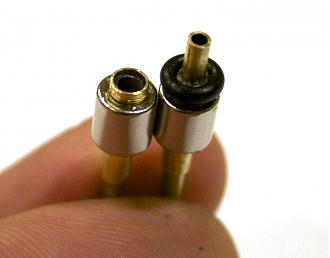

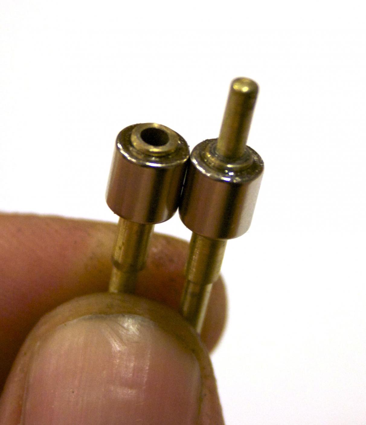

                    I can attest to Trouts good use of magnets. Here is an example of what he did with some barrel type magnets used for mechanical and pneumatic hook-ups:
                    Now, that is the out-of-the-box thinking that advances this Craft of ours.

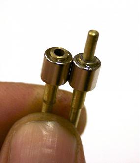

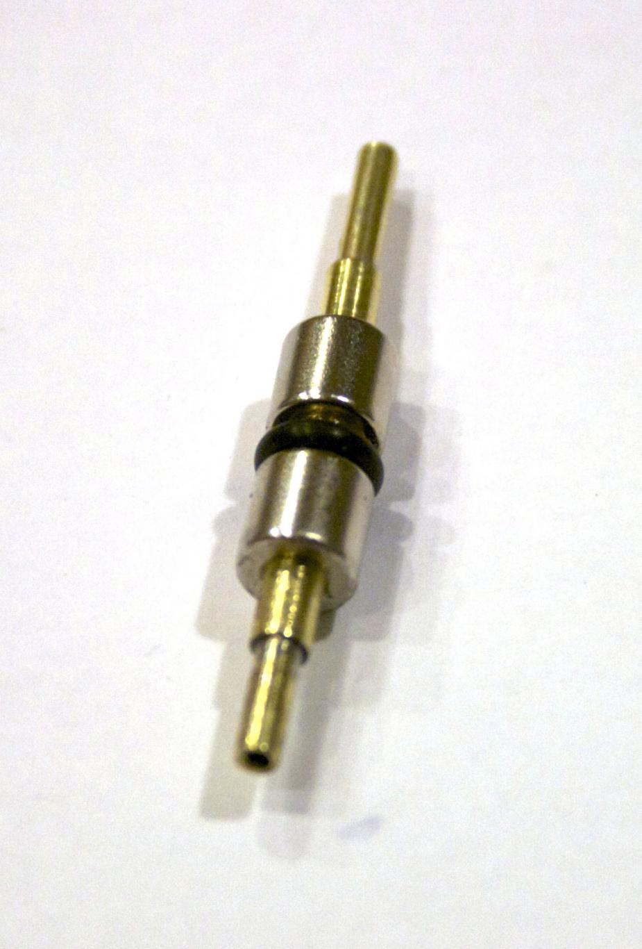

                      These are on my Gato and working very well. The connector works very well for the standard SNORT, I have not tested it (yet) with the SAS. When I get a real lathe, and I am working on that, then I will jump into more testing and development.
ID:	67980Click image for larger version
ID:	67981Click image for larger version
                      The connector that is just a magnetic connector works great in my bow planes. It does not disconnect or slip off.

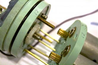

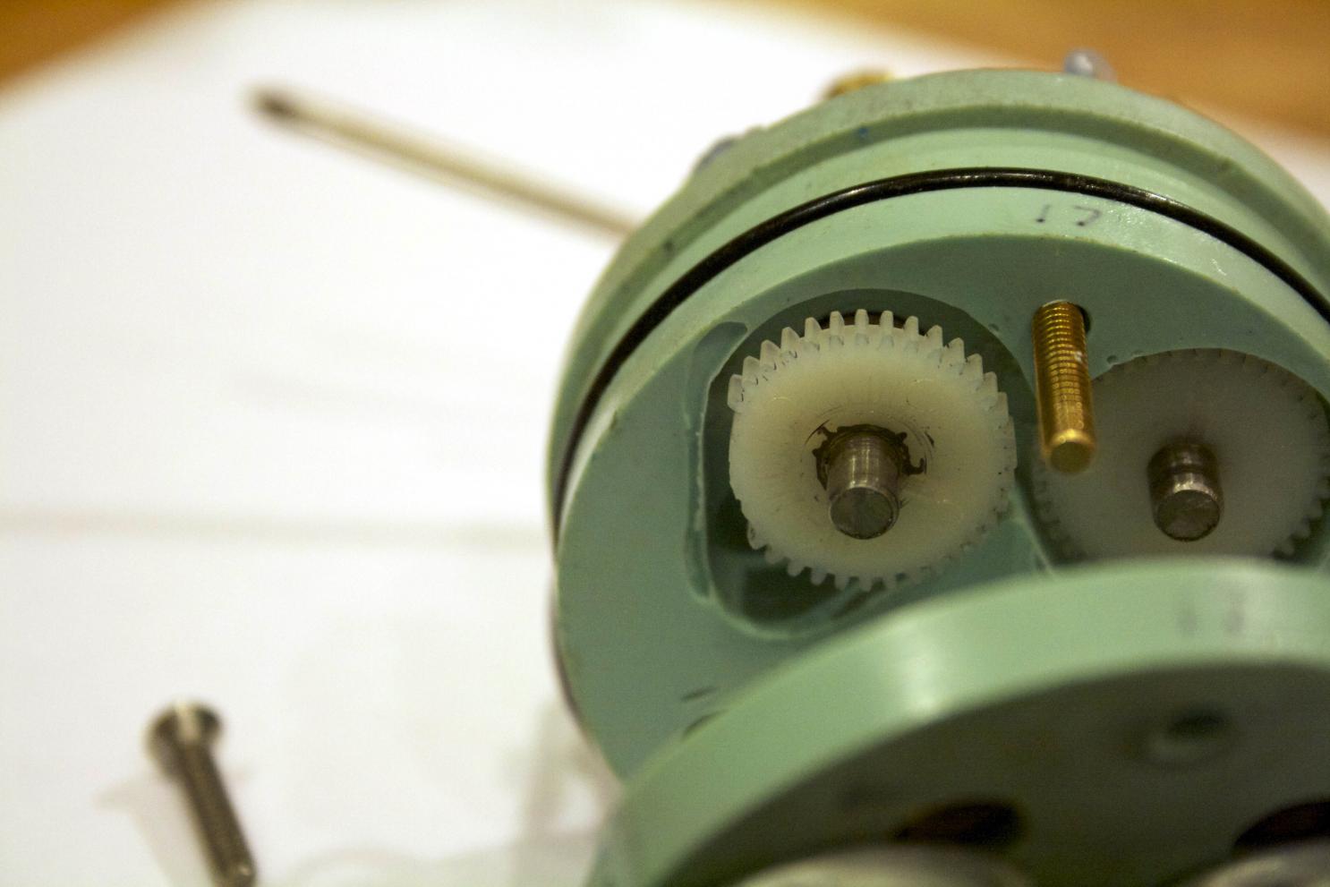

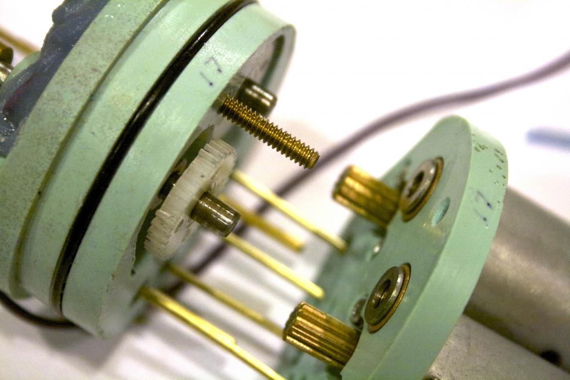

                              Tested the movement of all servos - no lock up on ballast, forward planes work, rear planes work, rudder now works, low pressure pumps sing just fine, and throttle was responding O.K. - wait ......one prop was not moving. ****ake Mushroom.
                              Dry dock for the sub.
                              Interesting I had a bit of water in the battery compartment (I know how that got in - I added a foam piece to hold the battery in - it flexed the tube enough to reduce the gaskets contact) and in the engine room (very concerned about this one because it has NEVER leaked - will need to re-pressure test the WTC)
                              Turning the one prop, it felt O.K. as it turned until 3/4 of the way through, it spun with no resistance and came to a hard lock/stop. A little jiggling and it would begin to turn until the same point came around and a replication of the symptom. I remember something like this from my slot car days back in the 60's to early 70's. Stripped gears.
                              So for you sickos that slow down when there is an accident to see the gore continue on.
                              Still going to continue looking aren't you.....
                              Still want more?
                              Conclusion:
                              Looking at my props for damage, there is not much there except for one blade on the port side. Some scratches on the edge, this same blade barely touches my skag (which it did during the build, but I thought I took care of it permanently by moving it out) it is a slight touch that normally I would not notice. However, I must have tagged a wall/pool floor in my sub driving education. This caused damage to the gear (maybe not all at once) and it began to tap the skag as well. So, some mixture of tagging hard surface, skag tapping, and even emergency reverse of prop have come together in a wonderful way to !#@% up my sub. Am I glad it was a pool? H. E. double toothpicks YES!
                              Solution:
                              Pre-dive check - I am doubting myself that I looked at the props closely - I heard the whirl of the motors and said check. Last time for that! Fix contact with skag. Get new gear. Always have propel or get SAS installed (or both)
                              David, where can I get a new gear?
                              and what are the specs? and what is the procedure?
                              I STILL love this hobby and my Gato! LOL
                              Last edited by trout; 07-08-2012, 04:25 AM. Reason: Spelling errors and laughing at Sh1take mushroom getting censored
                                • 13985
                                #210
                                I'll prepare a replacement gear for you and will mail it off right away. Give me your mailing address. Loved the write-up. The horror ... the HORROR!
