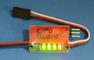

    What lipogard are you running? The ones I have have a soft/pulse feature that limits the power to the motors so you can get it home and not kill the esc or lipos.
    Alec,
    This is the one I am using.

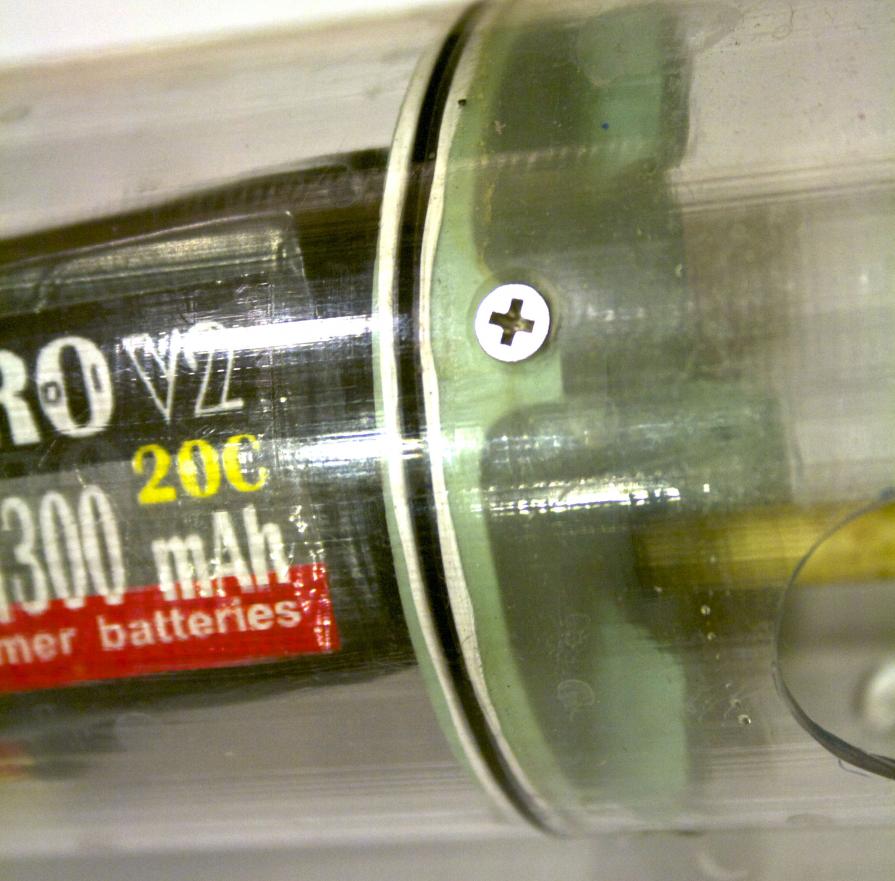

        If you pull the forward ballast bulkhead, remove the o-ring, and tightly wrap anti-sieze tape around and over the o-ring groove, about four turns. Put the O-ring back in, and seat the bulkhead back into the cylinder.
        Minimum vent hole size is 1/8". and bevel the hole from the inside and coat the bevel with a smidgion of grease to break surface tension.
        Go get 'em, Tiger!

              Since my last posting, I was so hesitant to tear the bulkhead out and thought I could use RTV to seal the edges. That seemed real sloppy and lazy

              so I went ahead removed the screws and pushed the forward ballast bulkhead out. Not so bad. Removed the o-ring, wrapped the channel with four layers of teflon tape and put a new o-ring on, greased up the o-ring, trimmed the tape and pushed it all back in. Fear of removing bulkhead gone. Placed the screws back in being very careful not to over tighten it. Once assembled, did a look over and CR*P the gap is worse!!! Do not panic, I again told myself (seems I tell myself that a lot with this build) and think this through. So pushing around the tube, if I placed my finger over the area with the gap there is a nice seal...... Backed off the neighboring screws. The first screw did not make a difference, but the second screw, when backed off the seal was made and even better than before. I tried a variety of ideas from loosening the opposite screws to shift the entire bulkhead down and tighten the bottom screws to flexing the tube and tighten the screw while holding the tube while good contact was made, all of it failed. The only thing was to back off that one screw. Conclusion, that screw (although lined up) must be flexing the tube possibly by the countersink being crooked. Whatever the reason, it was time to test and see. Here is the offending screw....

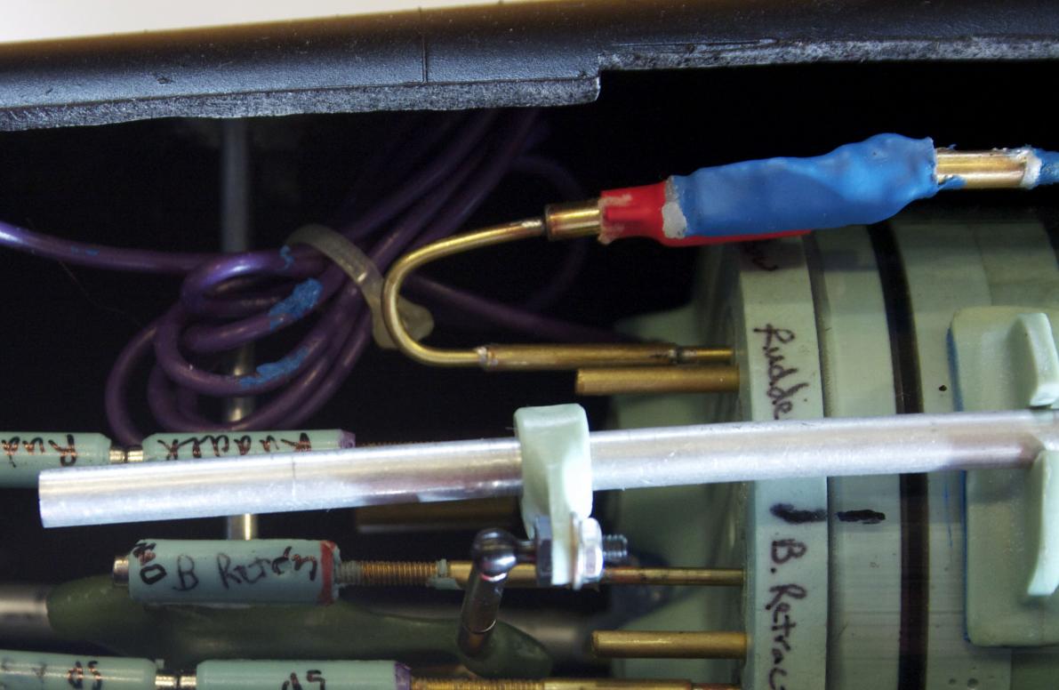

              The old ones would slip (red and blue thingies)
              Click image for larger version  Name:	Old_connectors.jpg Views:	1 Size:	90.0 KB ID:	66952
              And I was playing with some holders to prevent slipping and disconnect. It was just getting more complicated.

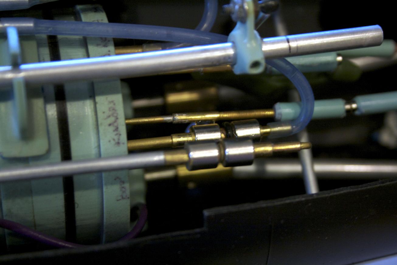

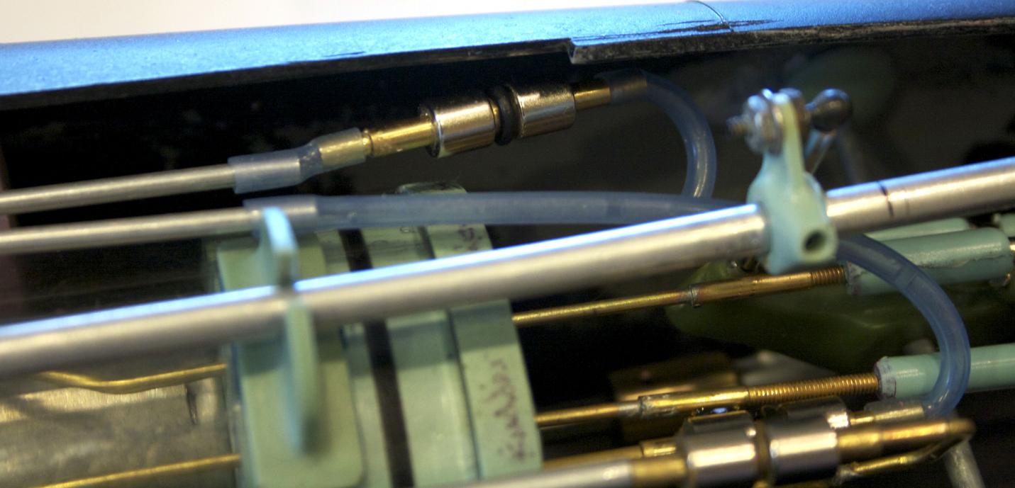

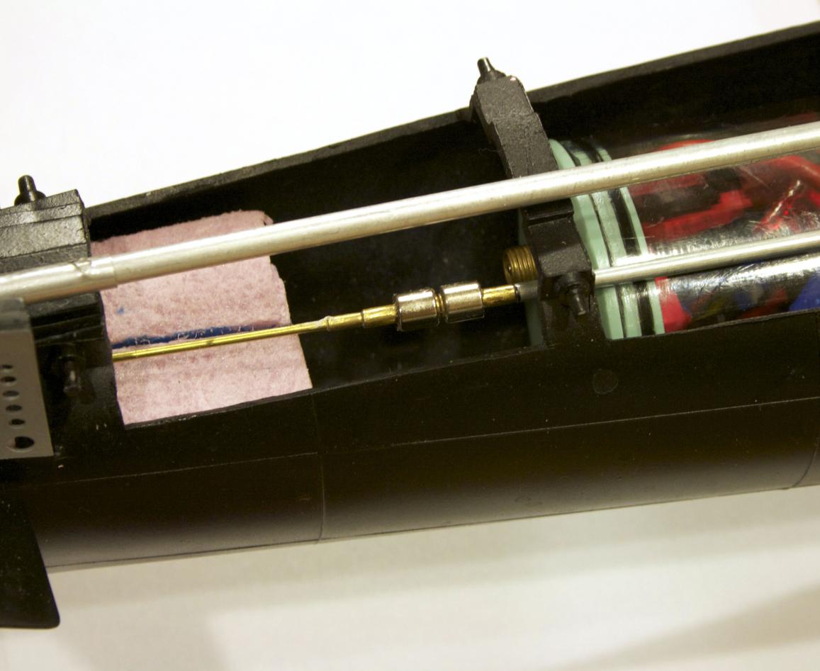

              Then I cam up with the new connectors. It fulfilled my two needs quick disconnect and not slip or disconnect in use.
              Taking apart and assembly is really easy. The quick disconnect holds and does not separate. Here is a teaser and David has shared with me that he will be writing an article on it.
              Click image for larger version  Name:	Quick_Disconnect_4.jpg Views:	1 Size:	85.1 KB ID:	66953 Click image for larger version  Name:	Quick_Disconnect_5.jpg Views:	1 Size:	87.3 KB ID:	66954
              Click image for larger version  Name:	Quick_Disconnect_6.jpg Views:	1 Size:	94.1 KB ID:	66955
              David has the rights to this idea and is going to incorporate them in upcoming connectors (An assumption on my part - David will have to share that info if he so desires)
              (NOTE: The bottom two images are the new connectors I made instead of the red/blue magnets mentioned earlier)

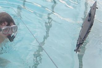

                    She sat in the water with a list again. So I took her for a drive anyways. If I installed hydrofoils, I think I could get her keel off the water. This is fast and the sticks seem a little hot (can that be adjusted on the WFly?If so where?). A small bump and she wants to RUN! Turn radius is not too bad, but what do I know.
                    Well let's take her down..........down.........I said take her down.......funny she would not do that. So, time to bring her in.
