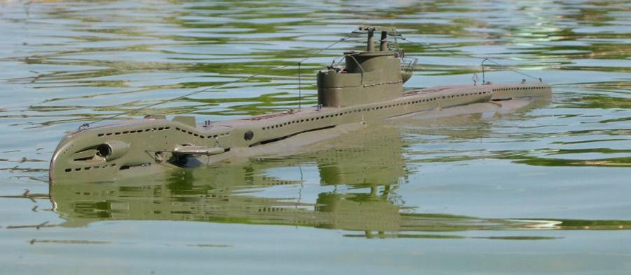

                    #99
                    I found a picture of a great Tally-ho model.
                    I didn't realize how popular the Tally-ho was, compaired to other T-class subs, when I started mine.
                    This one is the only one I've found that is close to the correct Color tho. (altho it's probaby a little too Olive color, at least it looks that way on my monitor)
                    The aft hull is close to the correct humped shape also.
                    I would like to know who made this one if anyone has Info about it?
                    Click Pic:

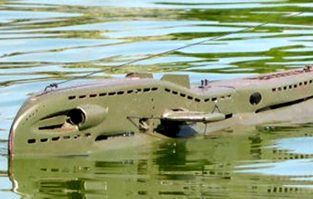

                                #105
                                Mike,
                                In this picture of a British T-class model I've found several errors and problems.
                                The one I'm curious about tho are the fixed vertical fins, on top of deck, above dive-planes.
                                I don't think any of the T-class subs had these but it's difficult to tell since in all pics the DPs are in up position. I saw a picture of a S-class that appeared to have them. Did all S-class have those short fixed vertical fins? And maybe some of the T-class?
                                Very strange that they were needed there, unless they were a safety-bump-stop for the bow-planes ???
                                Click Pic:
