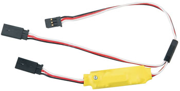

                    I found the yellow one at Tower and the black one on eBay for half price.
                    I like the connector layout of the black one better, so I ordered 2 of those.
                    Has anyone used either of these Y-cable Reversers?

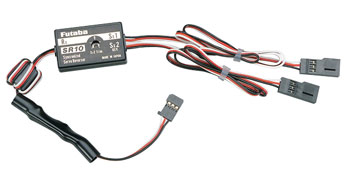

                          I found another type servo reverser. It's sort of the Cadillac model, made by Futaba. It also has a signal-noise filter circuit, which i think I'll need.
                          It's larger than the others but I have enough space in the 3.5" SD.
                          I got one on eBay at a low price so thought I'd give it a try also.
