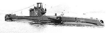

            The things I'm trying to find out about are visible in center of this picture, on hull below the ADF antenna. I've been told by a British submariner that they may not be Exhaust, but he was not sure what they are.

              #186
              If I'm looking at the same thing you are looking at (that's a lousy photo by the way) then those are torpedo tubes.

                #187
                :D LOL
                Mike, as I stated previously, it's the thing on hull, *aft of torpedo-tube*, directly below ADF antenna.
                Yes, when lousy photos are all we have to work with, it makes things very difficult.
                I used that pic since the item in question is almost in center of pic.
                I've already dabed on some putty and carved it to shape (what I think is a correct shape). There's just some things I'll have to guesstamate. :)
