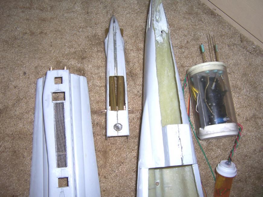

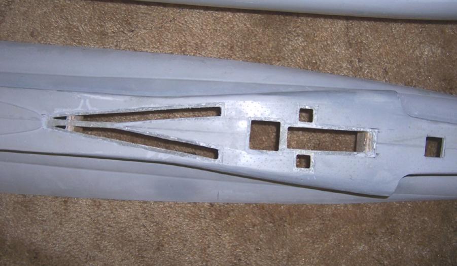

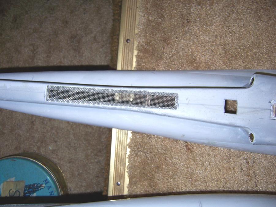

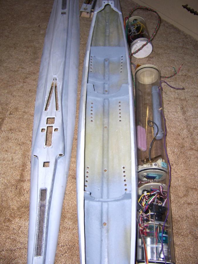

          Work in progress Pictures: (Limey monster)
          1st pic launch tubes fabrication is started, in removable bow top
          2nd pic ledges around holes are visible that screen will fit onto
          2 of the holes have screen laying in them (8 screens have been cut, with only one cut finger).
          4th pic shows shaft-struts/tubes and stern torpedo-tube
          the last pic you can see 3 of bulkheads added to hull, for regidity, battery bracing and SD seats
          I'll start drilling those Hundreds of small holes in deck next. :rolleyes:
                    Correction!
                    There were Not 'Hundreds' of small holes, There were *Thousands*. (at least it seemed like it)
                    My Dremel tool was getting Too Hot, so I had to quit before finishing. Devilish
                    Almost got 'em tho. :)
                    Rick L.

                      One thing to bear in mind - air will struggle to vent through these holes - to small, i found that a little bit of forward motion when diving moved any trapped air out through the stern tubes.
                      • toppack
                        • Nov 2008
                        • 1124
                        #161
                        Yes, I figured the little ones were there 'Only for Show', not to be considered good vents.
                        I had planed to put a hatch (door) on 9 of the T-tubes, including the 3 stern tubes, sealing them. I have some of the door-plugs partially made already.
                        That may be a good idea to leave some open, a least with a hole there somewhere, if I put in the doors. But I was thinking the large screen covered holes in deck will be enough vents in cover? Do you Not think so?
                        There Is a large ballast tank in this SD, and When she Blows she's Really gonna Blow. :) So I could be wrong?
