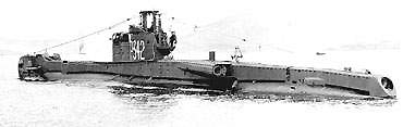

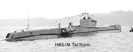

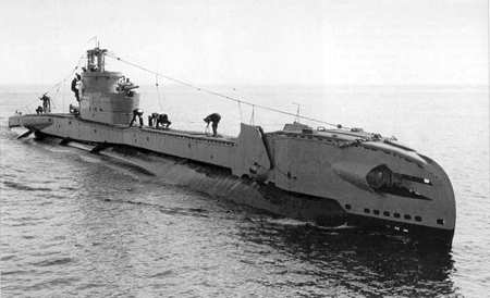

            I figured out that the T-class hull is going to need a major modification to make it have same shape as original boats.
            The superstructure-deck needs to be about 1/2" higher at the flank-torpedo-tube area. That's why it has the incorrect triangle shape to those tubes, which should be round and higher on hull. That section of deck should have a distinct Hump-back apperance, not flat on top like the hull kit is.
            See Pics:
            I can either: (1) leave it incorrect,(2) cut loose the deck in that area, move it up and arch it, filling in at sides or (3) I can build it up to correct height and shape with bondo or FG-filler, which is what I think I'll do. I can drill large holes in deck, which will lighten it some and give something for it to bond to. I think I can just cut loose the aft end of the area that the tower sits on and bend it up, to get it to the correct angle. Needs to be moved up about 3/16" at rear.
            I'll be doing a lot of sculpting fore and aft anyway, so might as well do that also.
            We're having Fun Now! :D
                Where did you get this idea from? Every boat was different. And almost every boat went through a morphing process. I defy anyone to look at any British boat of this period and determine there was ONE style. or one shape of the forward end. I have dozens of photos of T Class where the superstructure is completely level.
                If you are going to do one boat, then pick ONE photo of it, and copy that, then claim that moment of time, because I can almost guarantee it will have changed a year later.

                  #83
                  All the good pictures I found of T-class, showing that area, are like those I posted above. And none had triangle shaped flank tubes. Most photos are at wrong angle to see the humped shape, In the 2 pics above it is clearly visible, along with round tubes.
                  I'm trying to make mine look like the majority of them looked during the war, not a later conversion.
                  And specificaly the way the Tally-ho looked during the war.
                  If you have a picture of one that did have triangle shaped tubes and flat deck, I'm curious which one it was, and when?
                  Here's another pic that shows the front of tower base is lower than rear and that the stern is very much Lower, The flank-tubes pointed down slightly as did the upper bow-tubes:

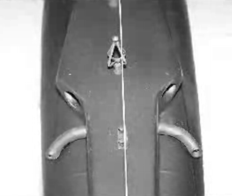

                    #84
                    Mike,
                    I really appreciate the video added to website about Dwayne Hill's T-class. I've been studying it closely.
                    There are a few things I don't understand about it tho.
                    The first thing I noticed was the large curved pipes behind (blocking) the flank T-tubes.
                    Do you have any idea what those are for?
                    Click Pic:
                    Rick L.
