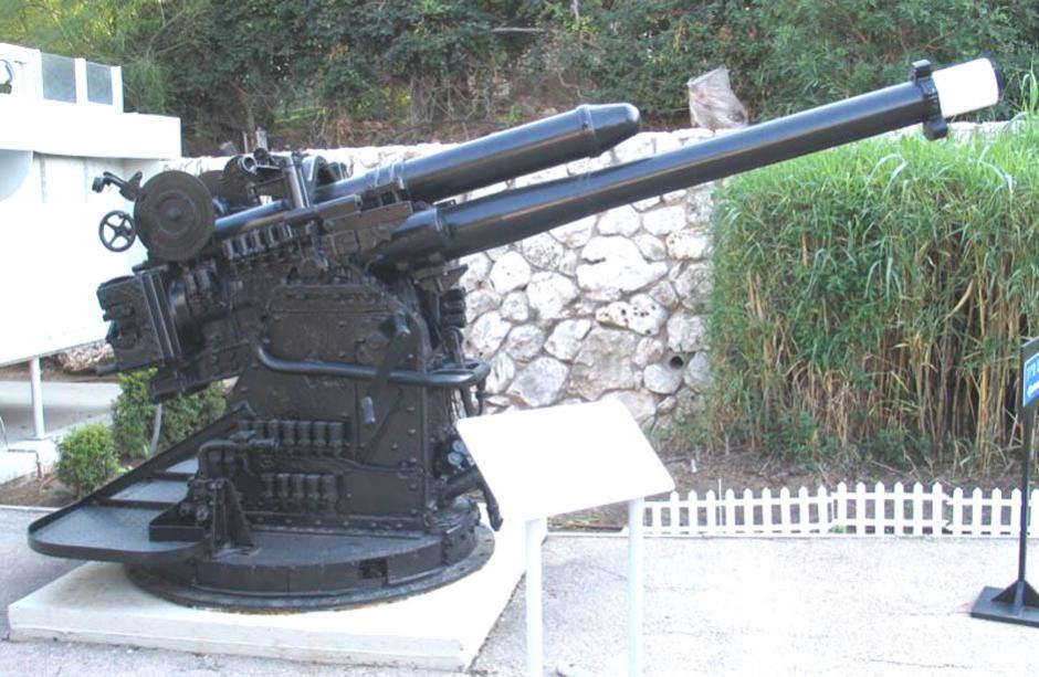

        I'm not sure which version of the 4" gun the Tally-ho had, mid war, but I think the Mark-XXIII would a good one to model. I also found some pictures of one that is in an outdoor museum somewhere, but some details I can't see, since it appears that some of it's parts are missing.

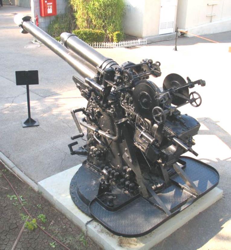

          Here's some pics of 4" gun I found. I think it's a mark-XXIII?
          Sure are a Lot of Levers and Knobs on it. :(
          Does this gun look like the drawings that you guys have?
          If so, is anything missing from this one?

            * Is the 4" gun pictured above the same as drawings you have?

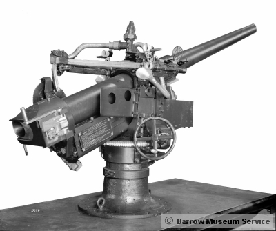

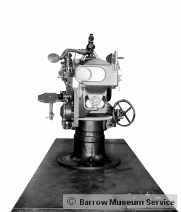

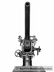

              Here is some more information on the guns
              Mk XII gun on HMS Thorough, 1954
              The Mk XII variant was developed for arming submarines from 1918, Mk XXII was developed to arm submarines during World War II. These submarine guns fired a heavier 35-pound projectile from late 1944[1]. Mk XII and XXII equipped :
                And more 4" guns - HMS Thrasher
                I've looked at Lambert's Plan of the XXII gun and it is so detailed that I don't think it will be much use. I'm not sure what the front shield looked like on Totem, and that, and the barrel will probably be the main consideration when making a gun.

                  Yes, I'm not sure what the large tank is for (above barrel) on the mark-XXIII, but it's certainly Not on most T-class guns? The Tally-ho didn't have a shield over gun, most of them did not.
                  I think I have enough Info to build it now. :)

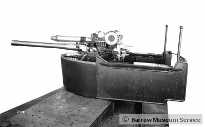

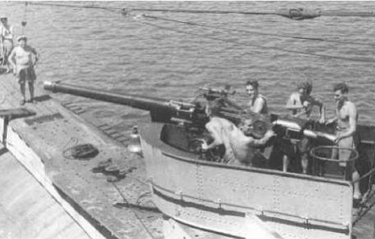

                    More pics of 4" mark-XXII Gun:
                    I think this is the 1939 design, without bell shaped muzzle (on end of barrel).
                    Note, last one has vision-blocking shield.

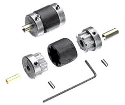

                                This is the Heavy-duty type coupler that I like for 3/16" and larger prop shafts. It has the quiet and smooth operation of a rubber coupler and splined connections for no slip at high torque. It will handle high-torque high speed reversals that some couplers won't. Robbe #1446, but I found a batch of an industrial version of the same thing at a much lower price.
                                This is what I'll be using in the T-class and Nautilus projects.
                                Click Pic:
