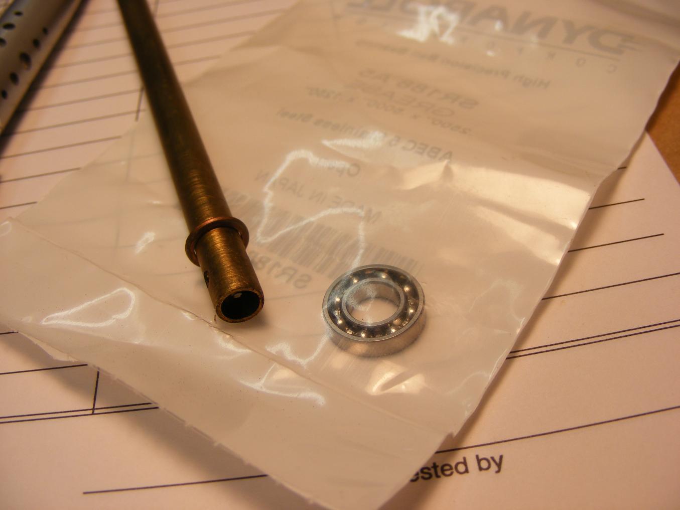

      If you will recall, the original rear bearing came with an extended inner race, for lack of a better term. That race was just perfect for allowing the first prop to push up against it to take the thrust load. However, since that bearing was sealed, I opted for a open bearing. They , however, were not available with an extended inner race. So my solution is pictured here. A thin copper washer that will go between the first prop and the rearmost bearing. I was looking thru my junk hardware collection that I have accumulated for just such a purpose. This time it paid off. The washer had to be a good fit around the shaft to touch just the inner race and not to touch the outer race. Otherwise we would have had unwanted drag. Why am I telling you what you already know? Because I am practicing my Typing.Click image for larger version

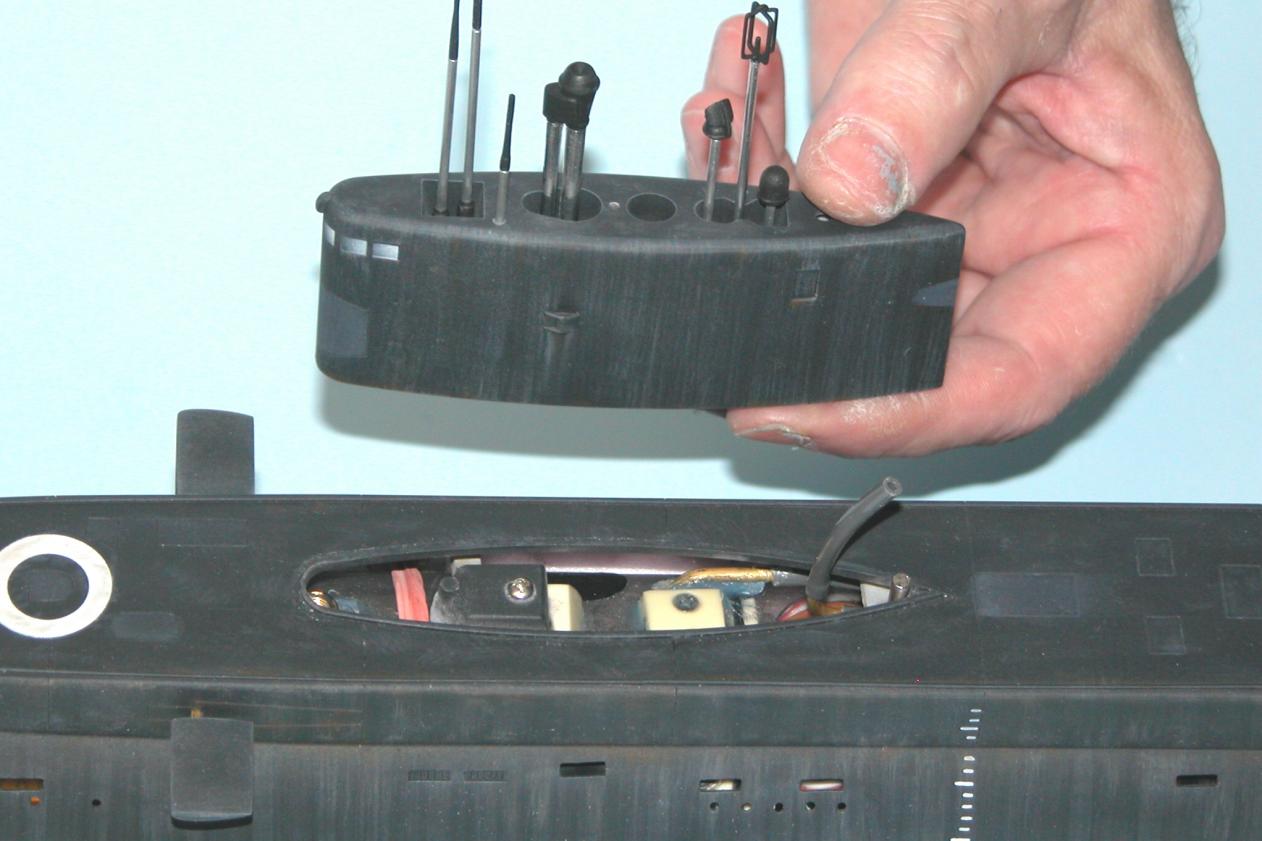

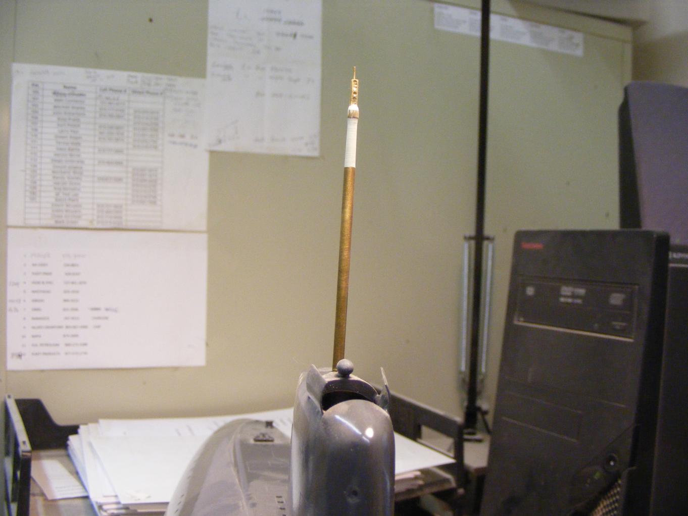

        Here we go with the periscope. It is removable. Since it has a good friction fit above and below, itll stay put. Later I will make a radar mast. Now, on with painting the scope.Click image for larger version

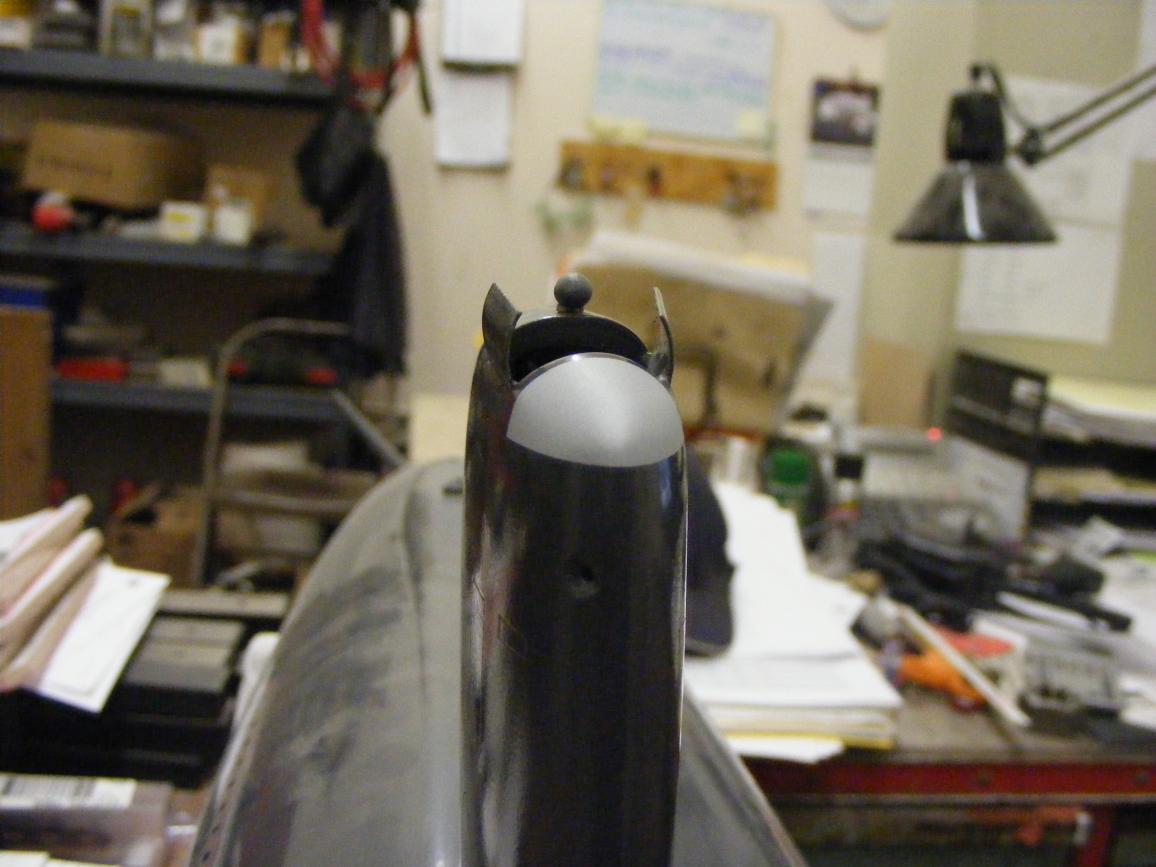

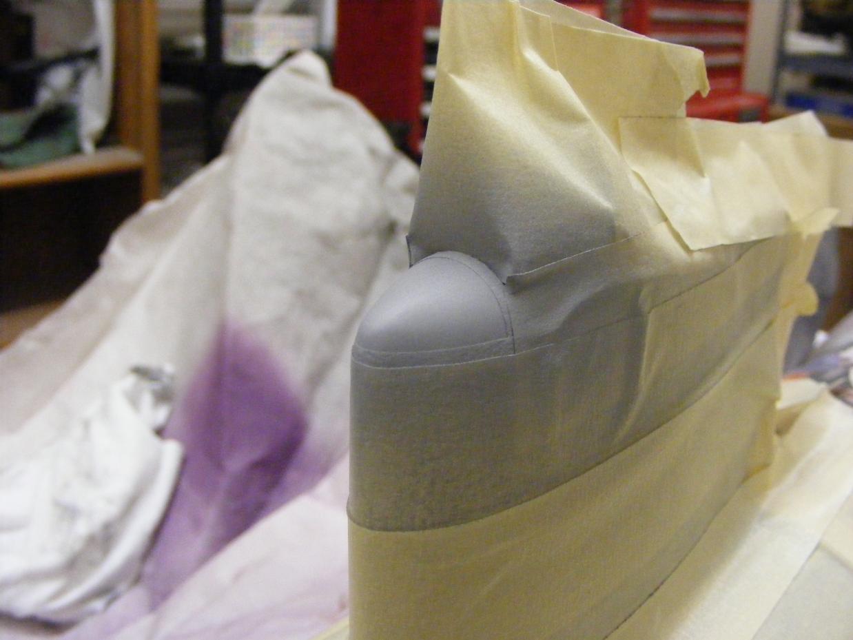

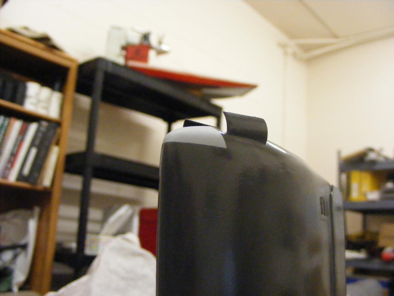

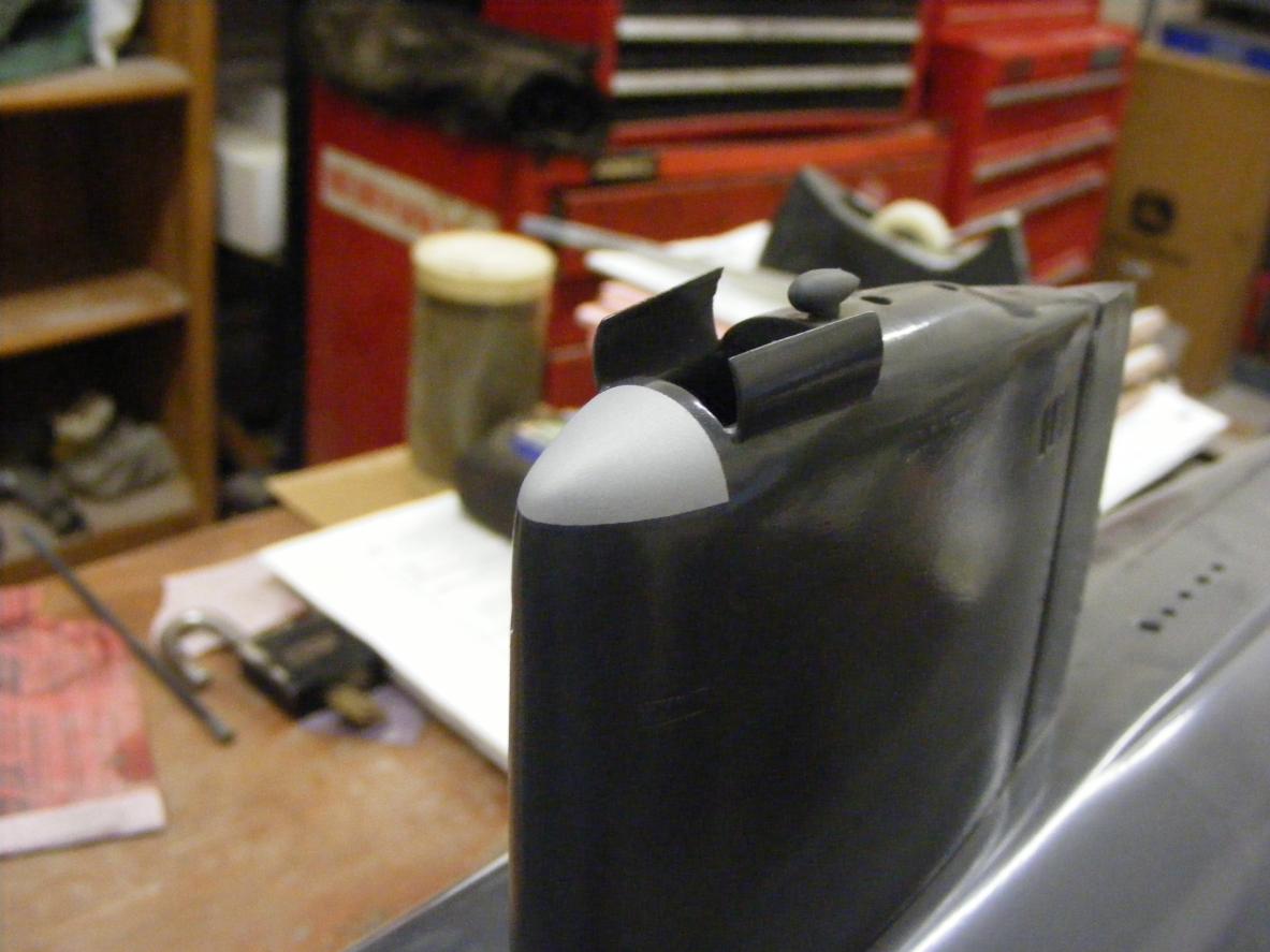

                      And that little segment is, the representation of the Observation dome on the top front of the sail. Trying to reproduce plexiglass is difficult. What I did was to take flat white as a base and add to it .............Alluminum. As it darkened up I was hopeing that the alluminum would show thru and give the impression of transparency. Well what I ended up with was a medium gray. Oh well , it doesnt look bad. Next I will tape off the silver metal frame around the outside and up through the middle. After the boat is flattened with clear flat I will go back and spray the dome with clear slightly doped with grey to darken it slightly. The airbrush comes in handy for all this.

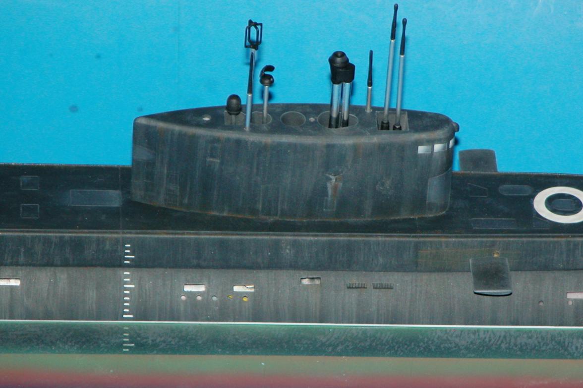

                        faking windows:
ID:	68484Click image for larger version
ID:	68485Click image for larger version
ID:	68489Click image for larger version
ID:	68490Click image for larger version
ID:	68491Click image for larger version
