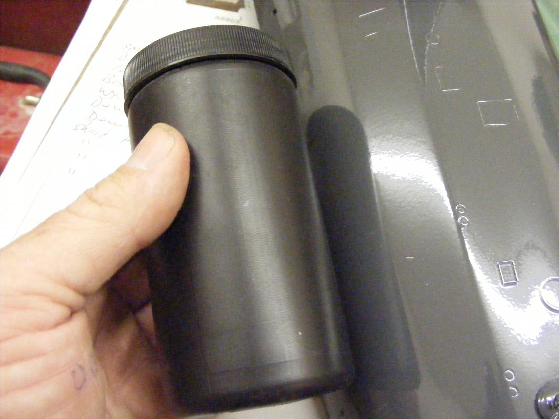

    It looks a little more grey than I wanted.
    Its VERY shiny...are you going to dull it down?
    Also the paint work on the sail looks a bit uneven - or is that the light and camera angle?
    J
    sigpic
      #302
      Thanks, The pictures dont do it justice. They were taken with flash. Its actually much darker than it appears. Its not black to be sure but a dark, dark grey. It is too glossy, thats for sure.

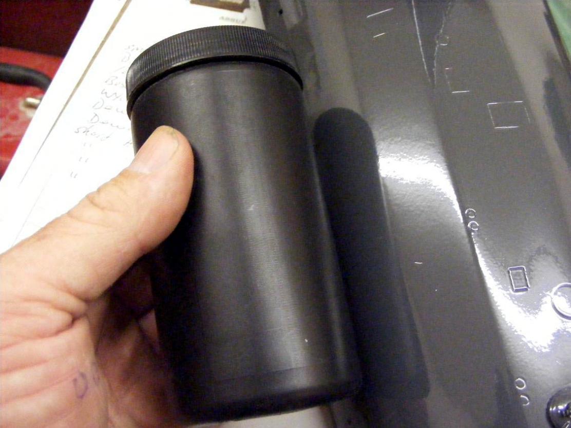

                  Look, Here is a picture, without the flash, of the hull painted Charcoal Grey next to a oil sample bottle that is truly Flat black. The flash makes the hull look too lite.Click image for larger version

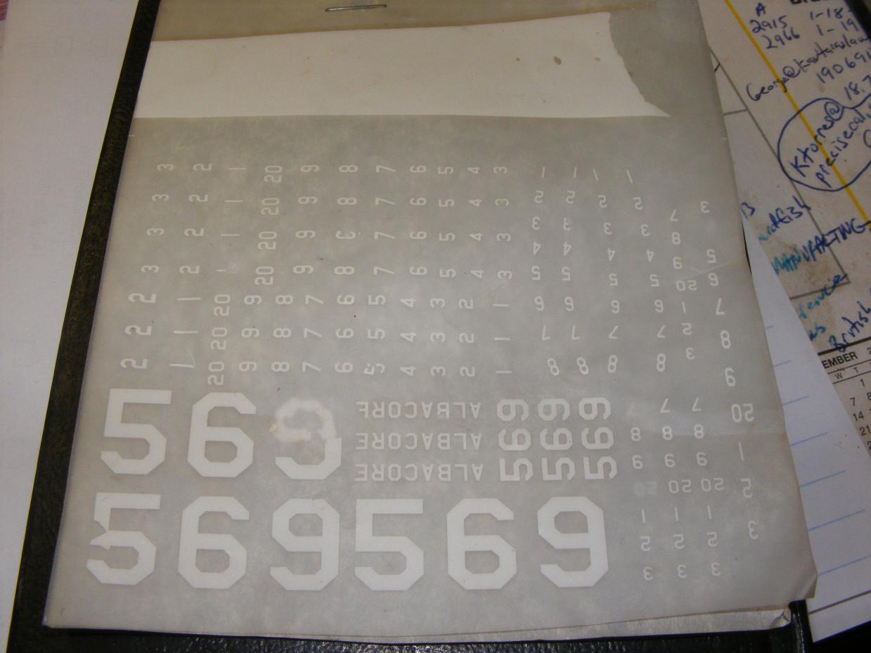

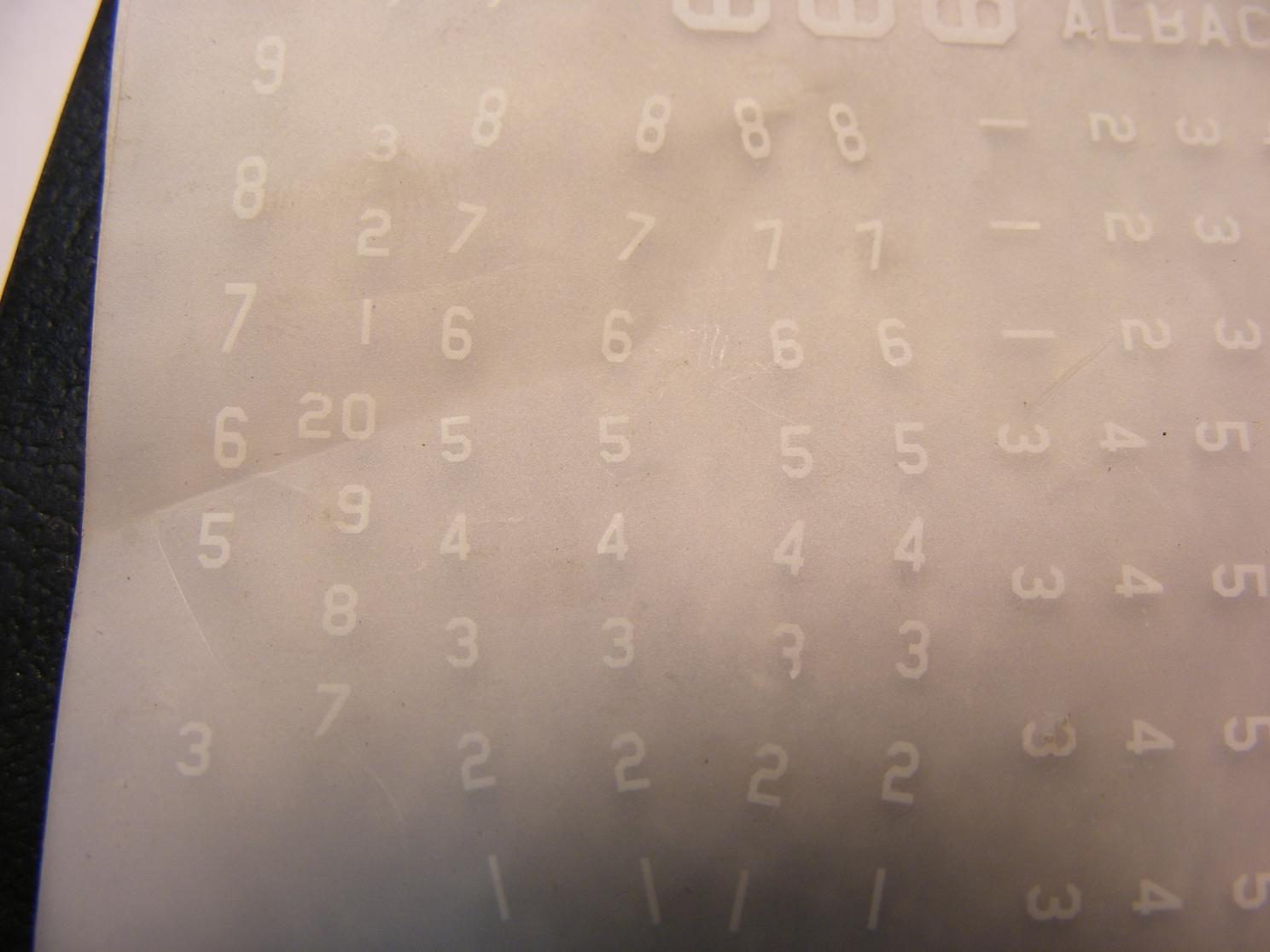

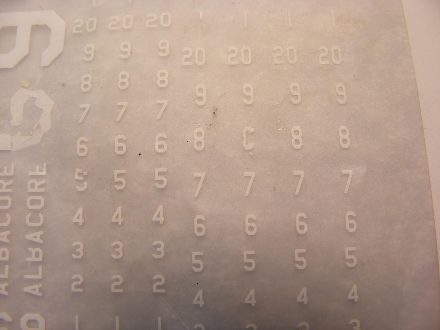

                            Ive had these dry transfers around forever. They came with the original Subtek kit. What a mess that was. Im trying not to remind myself. It really tested my metal. The large numbers are too big for the sail. So I think that Ill just leave them off. The only thing usefull are the depth markings. I just have to look at my pictures and try to figure out what goes where.

                              #314
